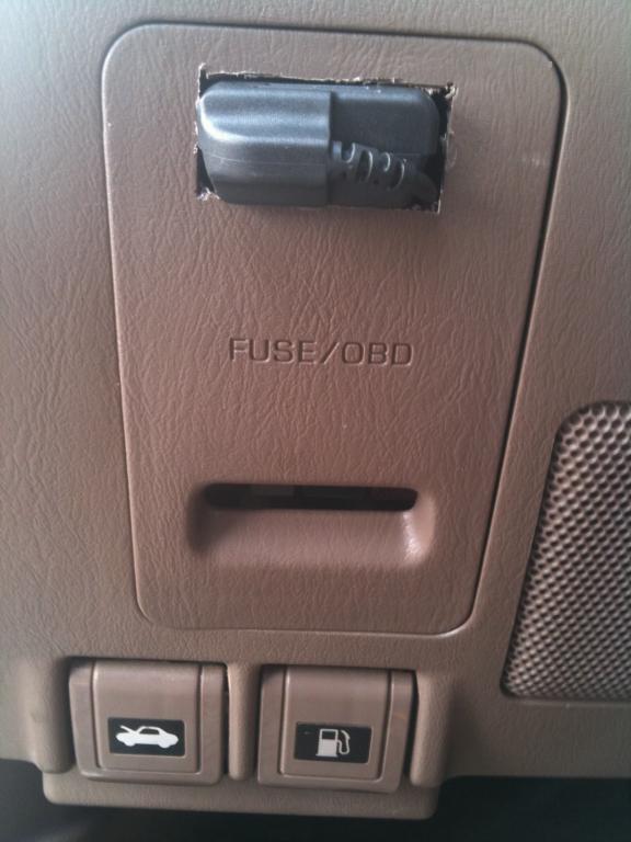

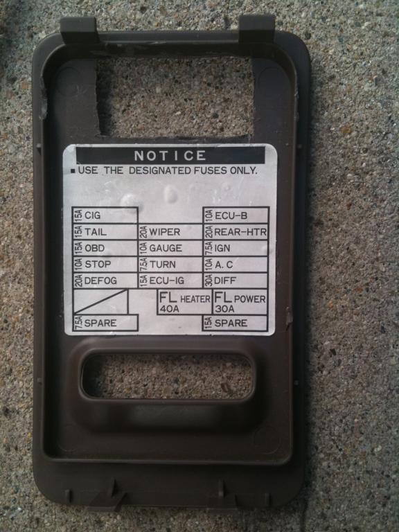

Anyway I thought I would share what gauges I customized and how I cut my fuse dash cover for the plug to fit.
First the cover, this was a test fit and the edges have been cleaned up a bit.
I was able to peal the diagram sticker up and then re-glue it after making the opening for the plug.
I didn't think I would like the suction cup arm but it's not bad. I bent it and put it as far down as possible so the arm is wedged between the dash and the windshield for a firm fit that should hold up to off-road abuse.

Obviously I didn't know it could turn. Turn How Exactly? To Where?
Anyway it's just a cover and I was planning on buying another one from the next Oak Interior 80 to be parted out incase I ever got rid of the gauge.
Your OBDII Plug has two mounting positions. Remove the screws that secure the plug, turn the plug so that it's facing down, and screw them back in. You are able to close the fuse panel with your Ultragauge or ScanGauge still plugged in.;)
Also put 2 nylon spacers on the screws, between the connector and panel, and it will work even better.
