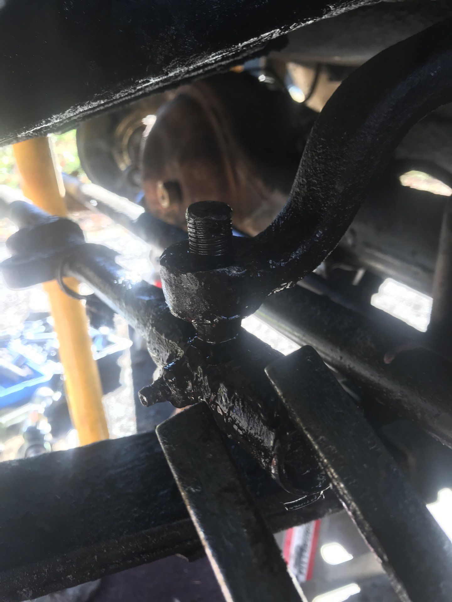

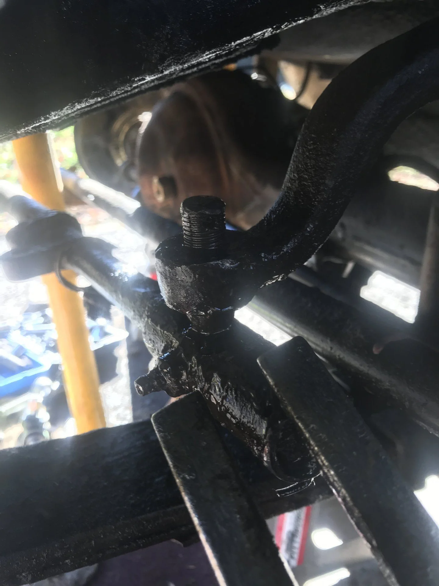

The worlds most stubborn tie rod end. Been fighting for 3 days now, got the rest of them out, been coating it with copious amounts of deep creep. Any advice? Tried a puller but it broke, tried a pickle fork but it’s not working too well.
Torch on the pitman arm and a puller. Once the puller is good and tight whacking the outside of the arm with a BFH should pop it out. Careful not to heat the rod end or they CAN explode! Or try disassembling the end so if it does get hot the grease has somewhere to expand to.
My problem is that I’ve soaked it in so much Deep Creep (flammable) that I’m afraid everything will catch on fire/explode!
Add a whole lot of each until that bugger pops. I remember feeling pretty beat by the time mine finally gave up.
Wipe an much of the grease off and you can before hitting it with some mapp. Should be fine.....Probably.
Nah, it’ll burn off fairly quickly. Just keep a fire extinguisher handy, but you’ll be fine. Get the pitman arm glowing.
Actually, now that I’m thinking about it, when I put high steer on my 60 ages ago the ball ripped out of the drag link end. I ended up taking off the pitman arm and throwing it away.
You're saying just to rip that sucker off?:steer:
Air hammer with ball joint separator attachment from harbor freight. I have been amazed how fast it pops tie rods, ball joints, etc.
