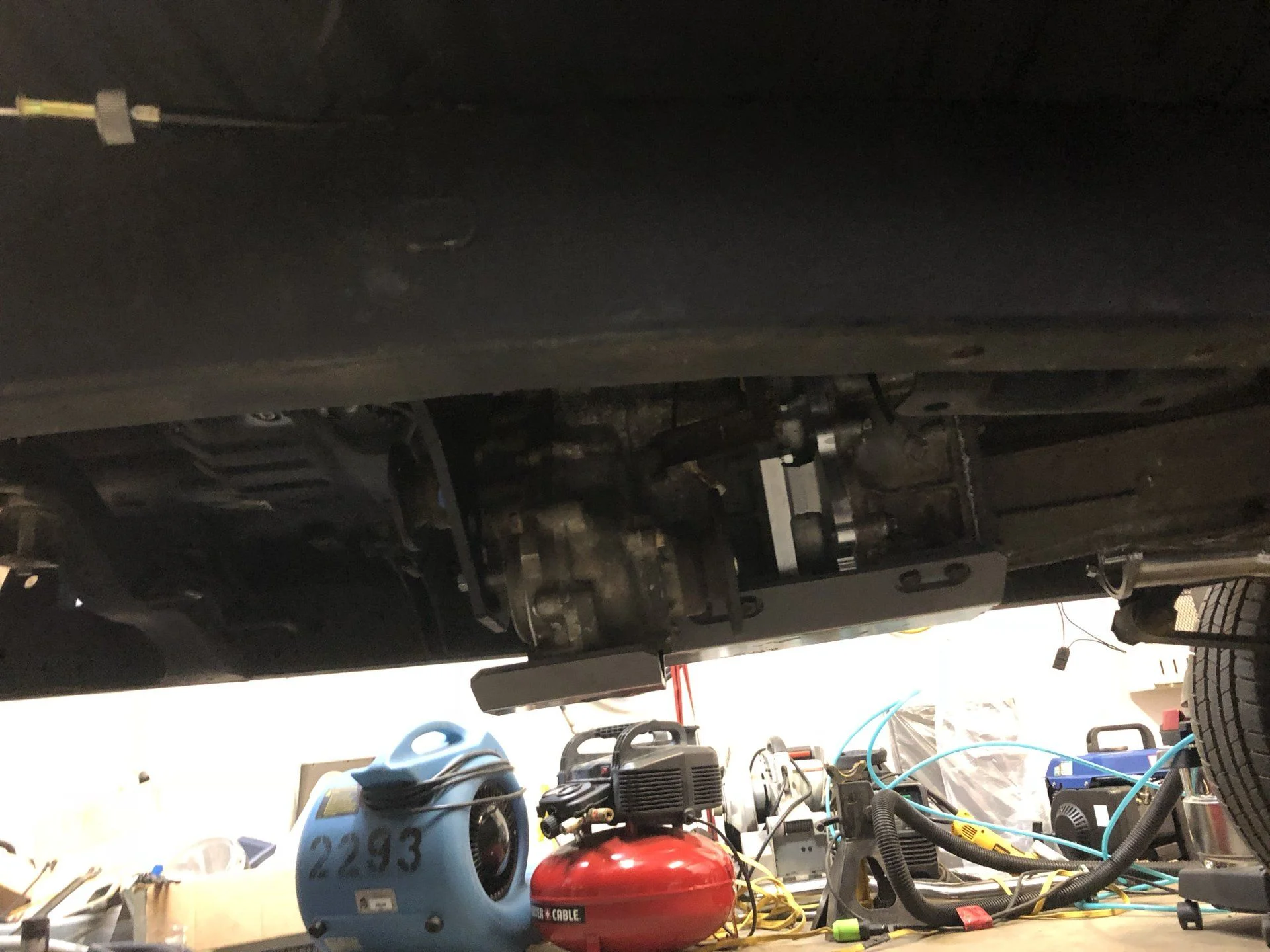

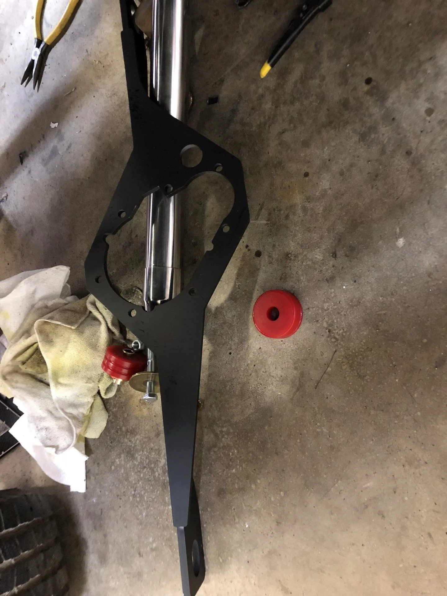

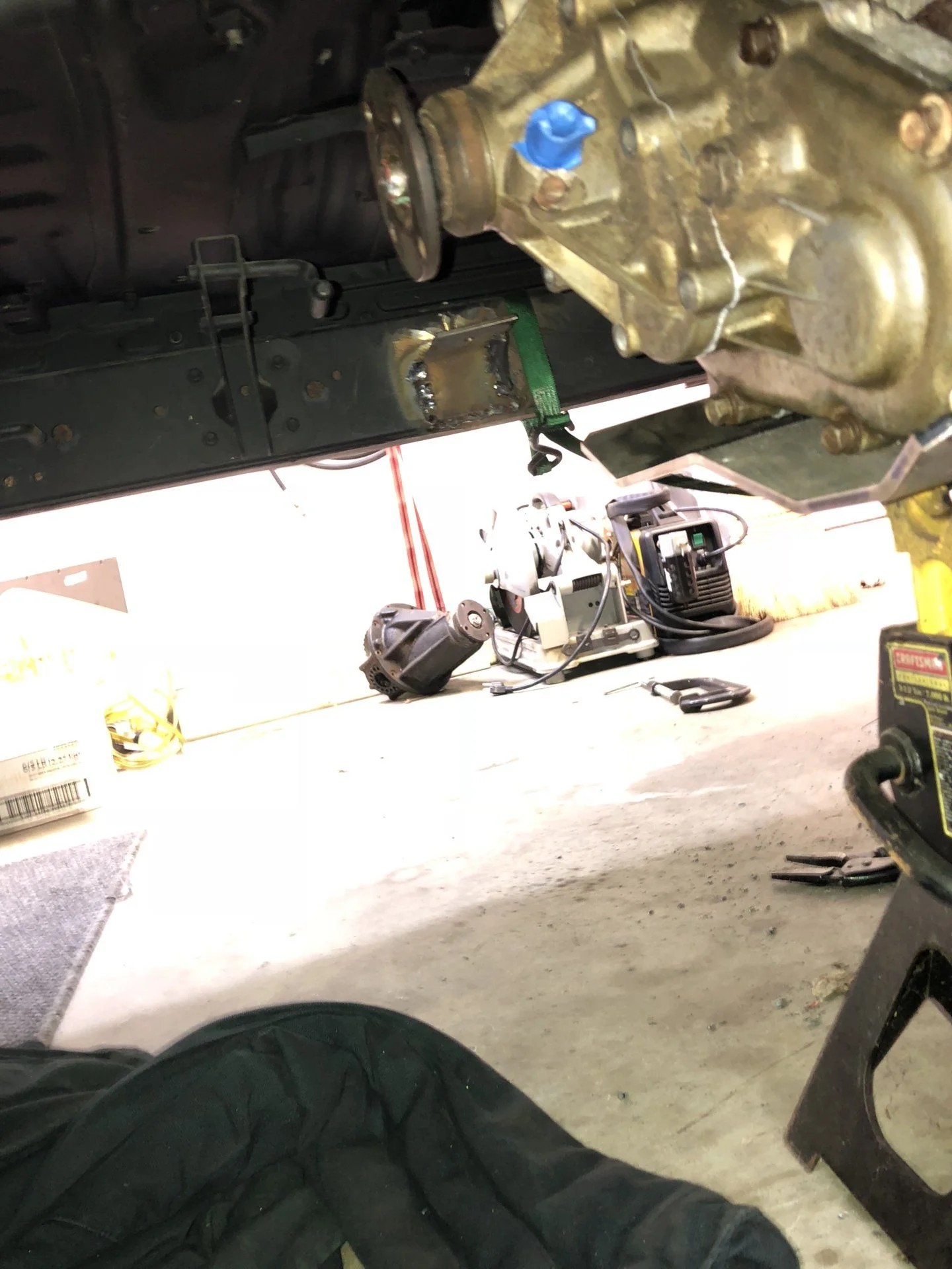

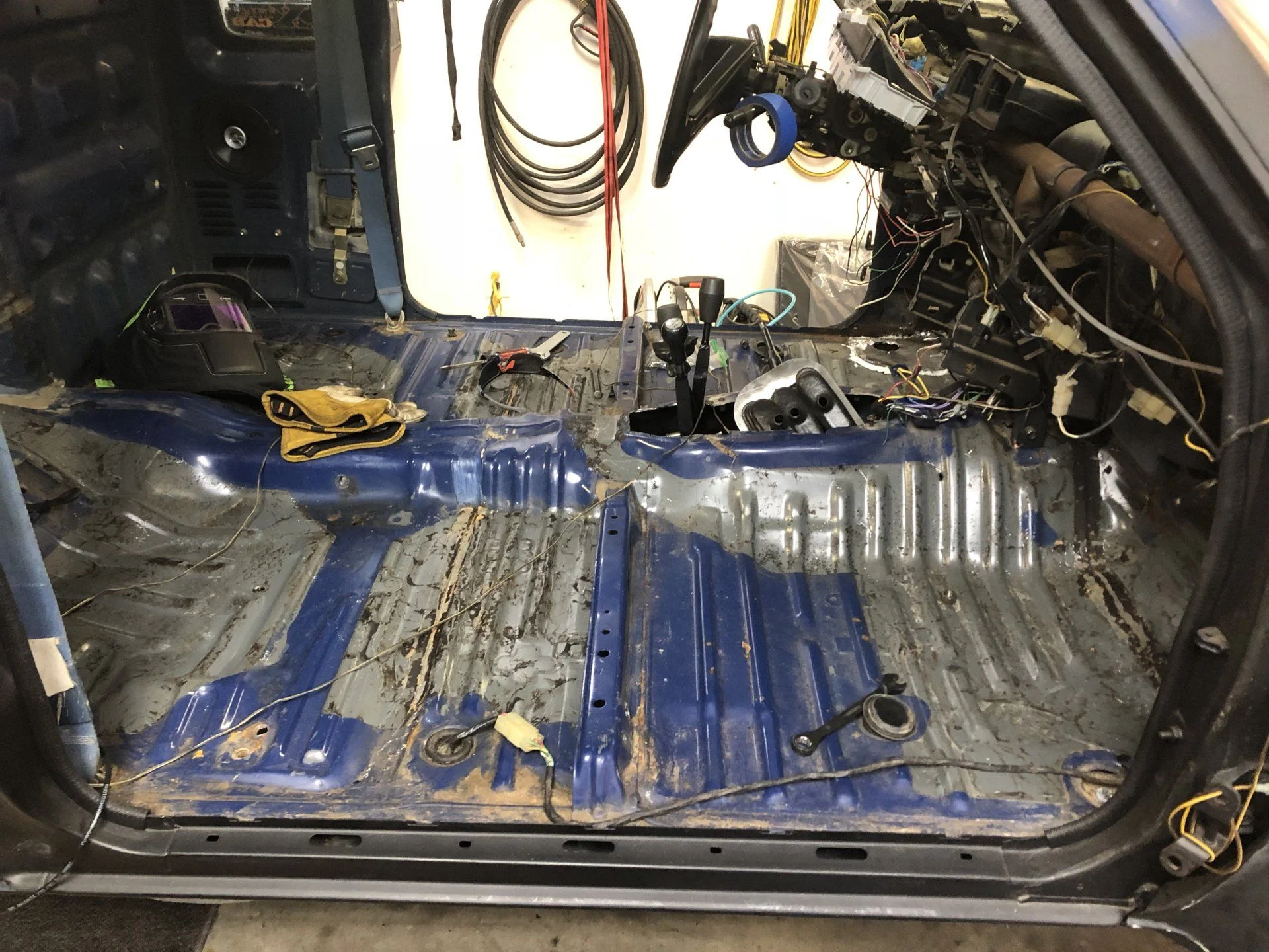

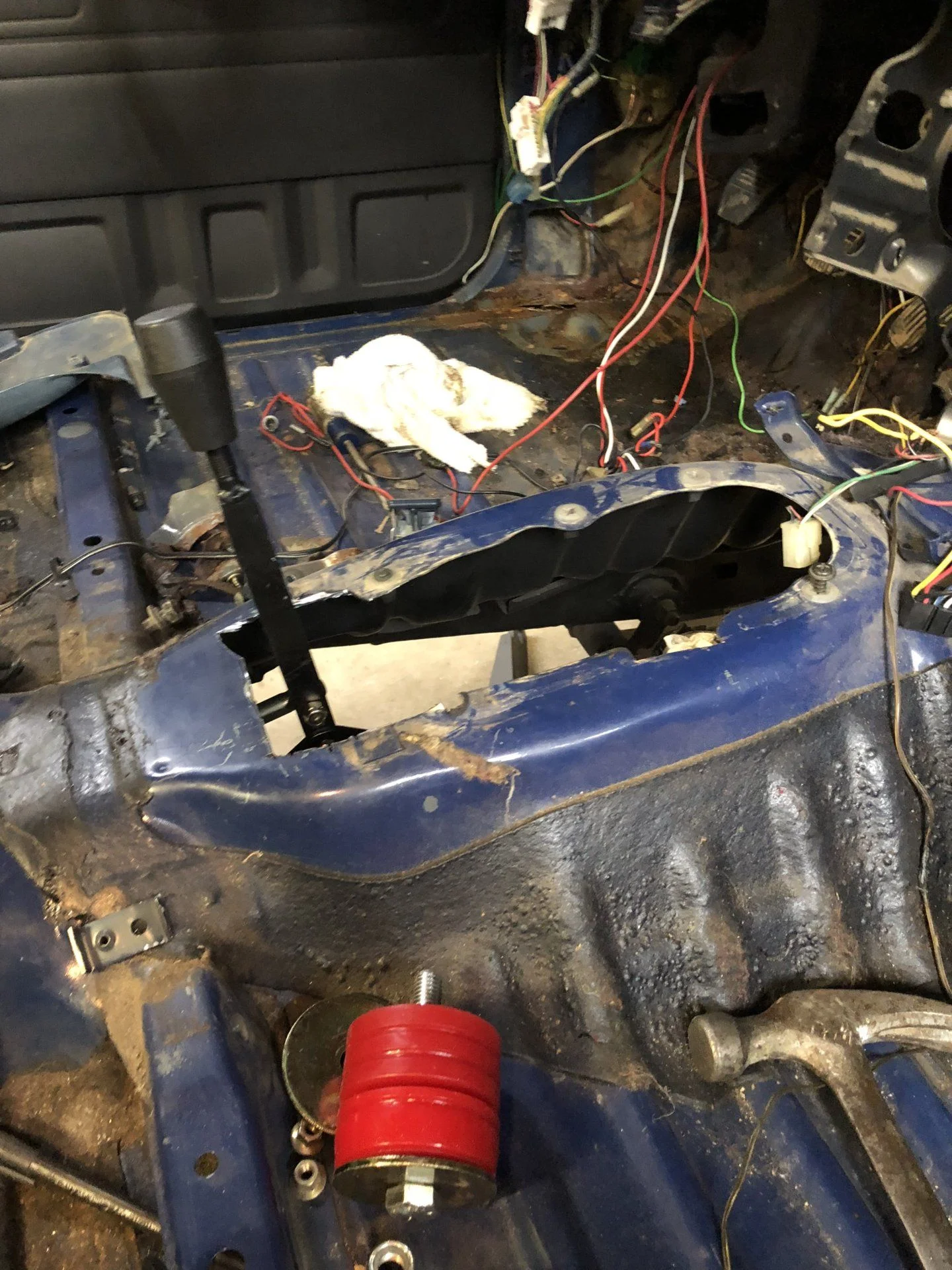

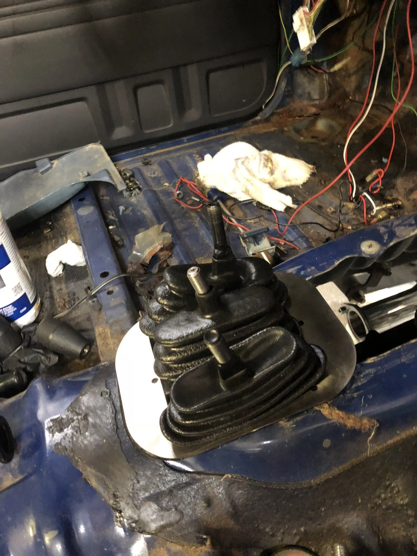

Welded in the mounting brackets onto the frame for the transfercase mount, and got the bracket painted and started cutting on floor for the triple sticks. Was only able to cut it to see how far back i need to cut, now to clean it up and cut the rest of it. Now a couple tips for you all that are wanting to learn to weld, don't start welding on things upside down, its hard. and a t shirt, shorts, and flip flops is not proper welding gear ahaha, make sure you get a heavy jacket, was welding those mounts in and i had a towel covering my legs and the towel caught on fire so i went to go hit it against the ground and throw it off of me, and ended up throwing the tip of the gun on my arm, and have a nice old burn the size of about to fingers. Don't do what i do :)

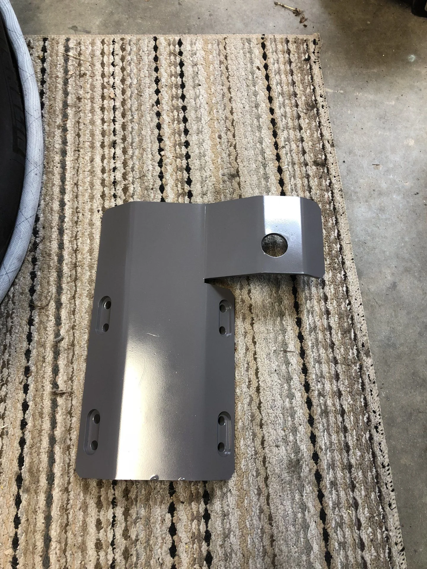

Even with all the days we missed this past week we had today off and I'm not complaining cause it gives me time to work on the truck, finished cutting the floor for the triple sticks, painted the skid-plate and finished up all of the transfer-case mounting, stripped the floor from its insulation and fixed the rust spot by the body mount. Stripped it all up because I'm going to raptor-line the floor of the truck.

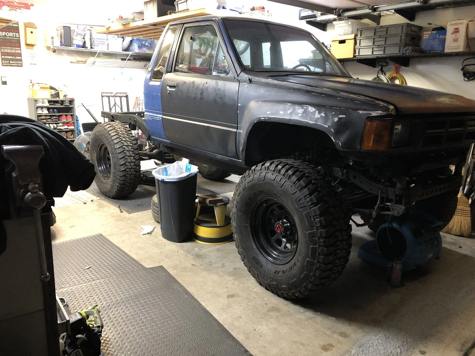

They look like 16.5" mtrs to me! Glad you bought them. I had a set of 35" mtrs back in the day and I loved them.

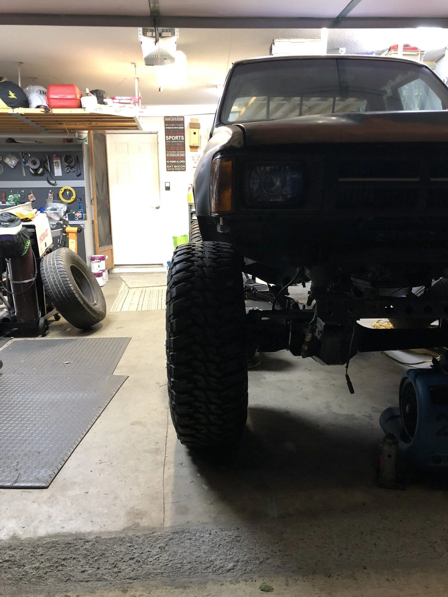

Yup 37x12.5R16.5 changed completely how the truck looks. and with just the 3 inch body lift doesn't look like i need much more of a lift, or to move the axle forward.
A word of caution about those wheels. You can NOT air them down without popping a bead, please believe me. Plan to put some weld on beadlocks on those wheels if you want to air them down, or source a set of H1s.
Those wheels will get you by, but you really can't go below ~20-25psi under any circumstance without popping a bead. I had a lowish tire on a 16.5" rim, turned around in the street to be able to fill it, and the tire came off. Fortunately I was in front of my house.
