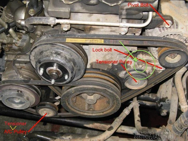

I am not sure if the picture is clear, but I only had one drive belt, and it was routed incorrectly (over the idler pulley). The one belt was also not OEM, frayed, and probably only moments away from failure. It sounds stupid right now, but I could not figure out why everyone was talking about three belts -- I thought my rig only needed two. Fortunately I ordered OEM belts, and the drive belts came as a set. I then saw the rusted belt channels where the second drive belt should have been.

Does the bolt for the alternator tensioning bracket (12mm bolt behind idler pulley) need to be loosened to allow the change in tensioner length to allow the alternator to swing? I'd never recalled touching it before on previous 80s but just found on this one its stripped round and while I got the pivot bolt loosened easily and lock bolt loosened and can access the adjustment bolt it's not moving. It would seem that while you tension by adjusting that bolts length that that would still want to cause the bottom bolt I referred to to want to rotate to compensate. But it is stripped utterly smooth by a PO; and if you saw my other post ( https://forum.ih8mud.com/threads/how-to-remove-acc-belt-idler.806434/ ) than you'd understand why I can't even get that idler off to get this stripped bolt if it is somehow important in tensioning the belts (I'm sure I'd need it off to remove the alt. outright for brushes or replacement). But I've found no mention of this bolt ever needing to be loosened in the FSM or in posts.
To modify a previously posted picture by another member, here's the bolt I'm talking about
