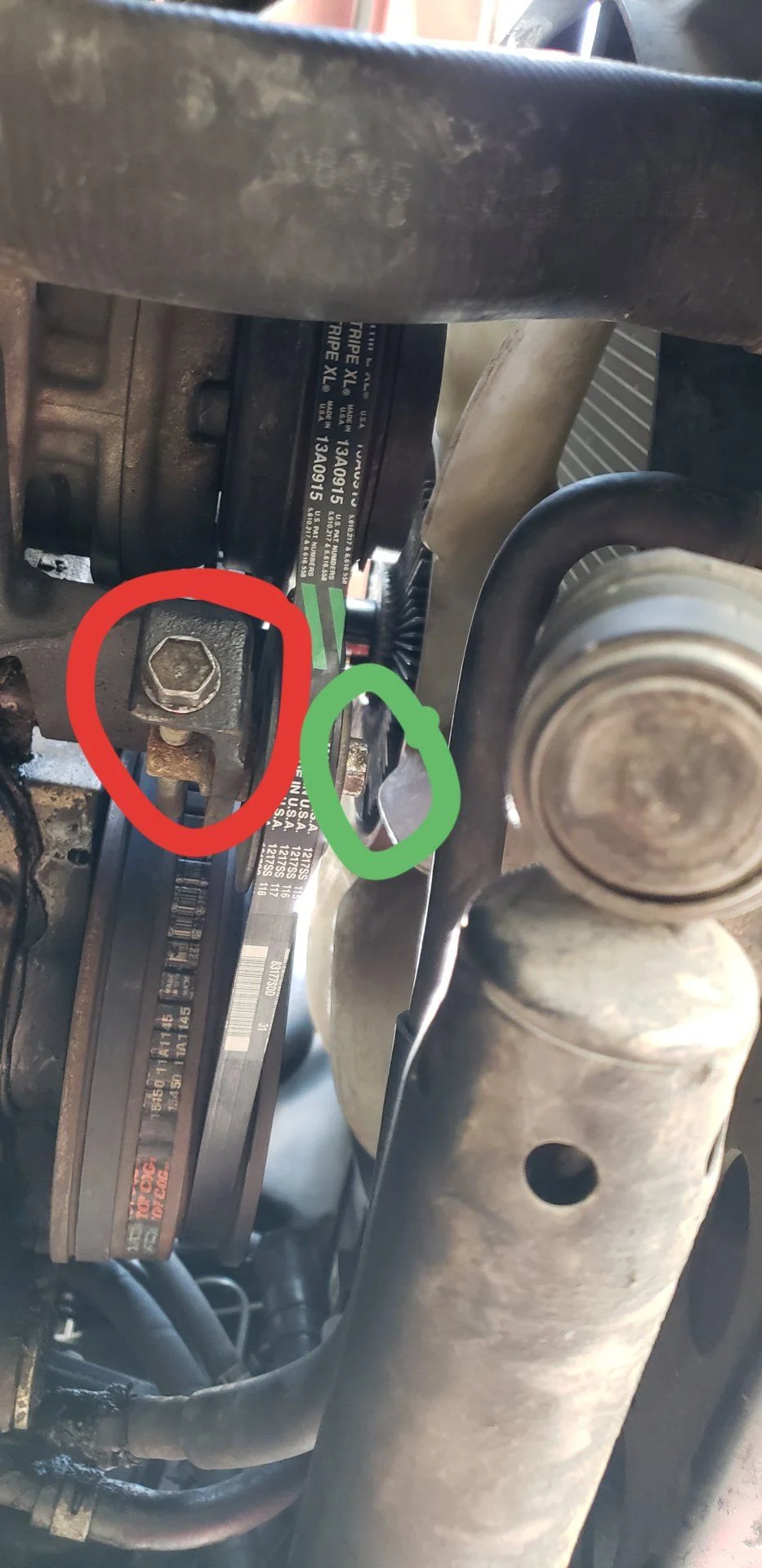

The AC belt didn't take long at all. I'll list out my steps so hopefully it helps someone or clarifies a question for someone.
Warning! This is how I did it, not necessarily the correct way to do it.
1. Remove the small plate above the steering damper, it's held on by 4x 12mm bolts. It comes out by rotating the drivers side forward once all the bolts are out.
2. Loosen the bolt circled in green in the picture. It should be 14mm. I didn't remove this, just loosened it.
3. Loosen the bolt circled in red. The more you loosen it, the closer the pulley gets in between the AC and Crank Pulley. This makes it much easier to install the new belt without struggling. My adjustable pulley didn't want to move so I smacked the bolt a little bit and it moved fine after that.
4. Remove old belt (if you still have one)
5. Put new belt in place. I looped it around the 2 bigger pulleys from above and then got it around the smaller one from below.
6. Retighten the bolt in red until the tension is correct (whatever that may be) I just went until it was tight but didn't seem stretched.
7. Tighten the bolt in green.
8. Test your work.
9. Reinstall the plate, it should go in reverse of the way it came out.

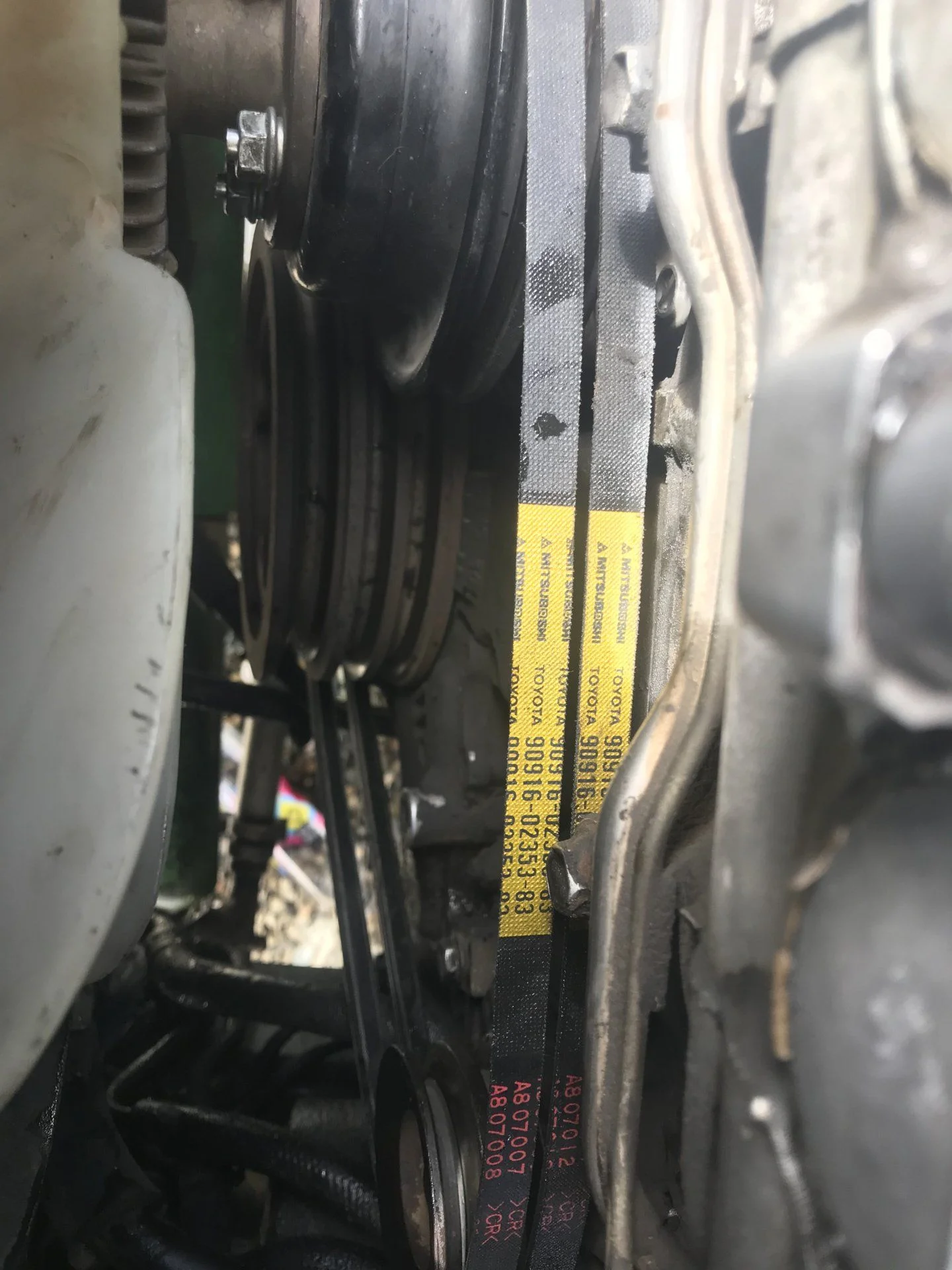

finished mine in about 25 minutes including changing the upper radiator hose. Even managed to get the markings to line up together.
I'd be interested to know if they stay lined up. I'd guess that even a VERY small difference in seating depth in the pulleys due to slight variations will add up after several thousand (or million) revolutions.
