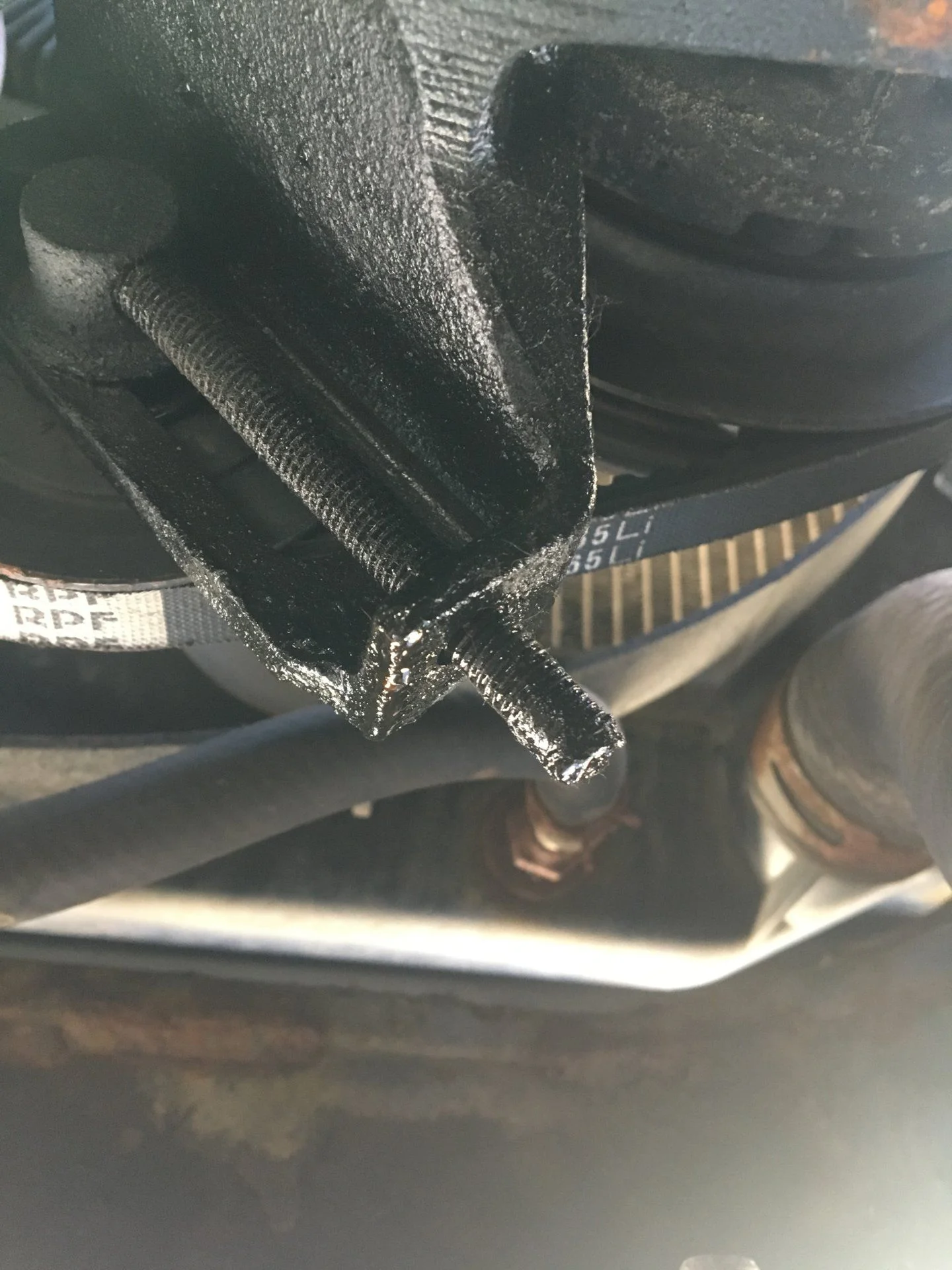

Hi All- could use a little help, was trying to tighten my ac belt per the thread an looks like the adjustment bolt was Maybe installed backwards and now the bolt end is snapped off. Thoughts?
double nut; un-screw
make sure locking nut (center of pulley) is loose first.
At least you have the nut well lubricated.
It’s a 97. Thanks for the advice on the double nut - I’ll give that a try. As for the lube there’s a slight chance that I’m losing a little oil.... it’s making a really strange noise (trying to attach a sound file) intermittently. Can’t detect a pattern. Thought it might be the a/c belt but it makes it even with a/c off. (Assumed it would freewheel fine and only possibly slip when it got pulled in under load. ).

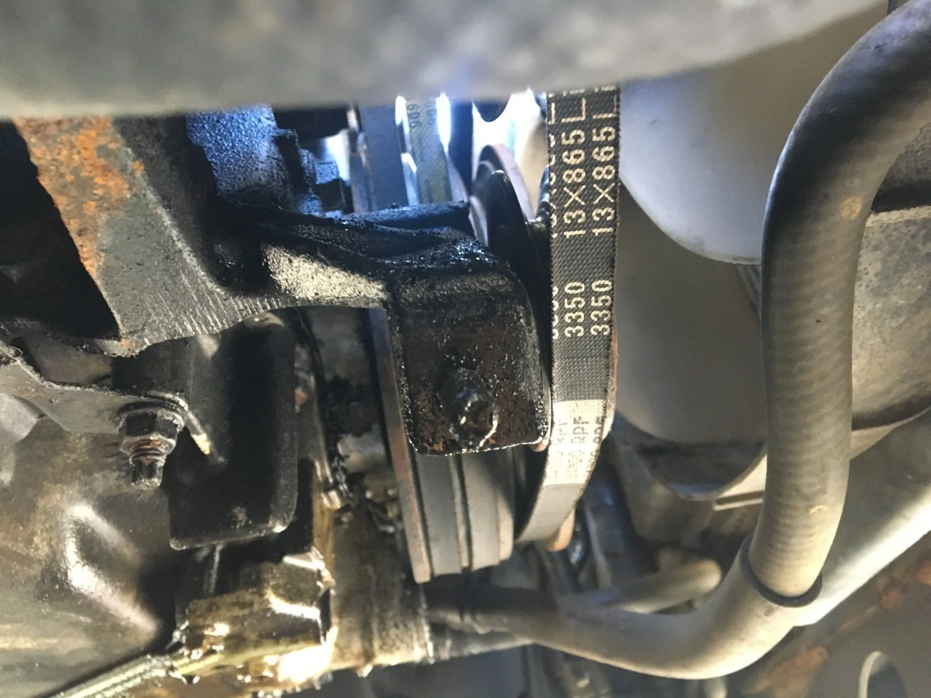

Then slide under the truck with a 14mm on about a foot of extension and find the 1" hole under the AC compressor. Directly in line with it is the tensioner bolt - a very long bolt. Turn it counter clockwise until it comes loose and then insert it for a revolution or two. It helps to remove the ratchet handle and use the extensions only once the bolt is finger tight so you don't drop the bolt. You just 'feel' that it's out of threads, then spin it back in a rev or two.

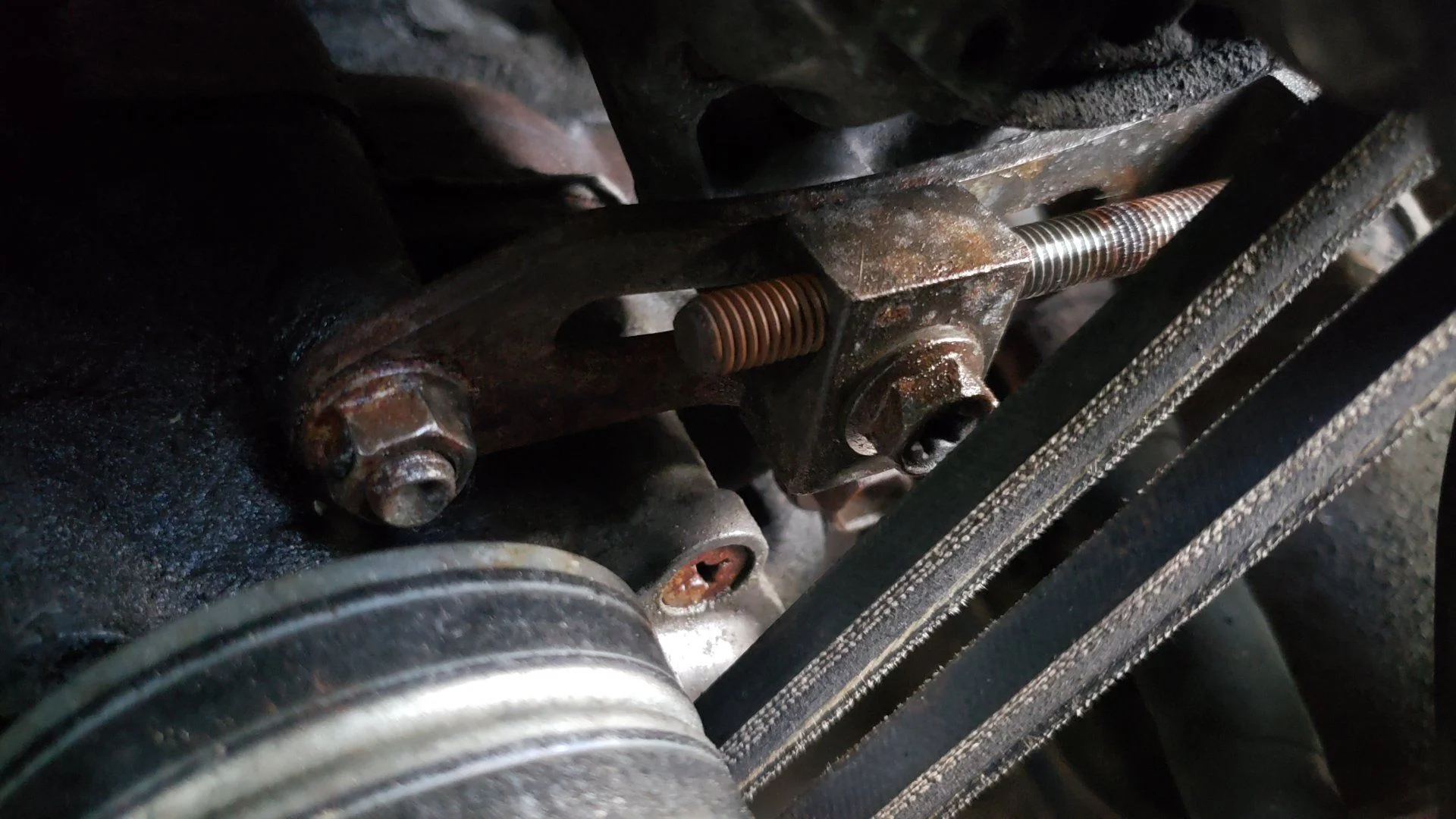

Then the lock nut on the alternator below it - again only a couple turns (12mm). This lock nut clamps down on a very long bolt whose threads you can see while loosening it, which is the tensioner bolt.
Loosen the tensioner bolt counterclockwise (12mm) until it literally comes out of the tensioner. Thread it back in a couple turns. This tensioner bolt is easily accessed with a socket wrench sans extension in a tight spot a stubby would speed things up. The 3 minutes of limited swinging here is what causes most folks to opt for the hour of removing the battery and battery tray.

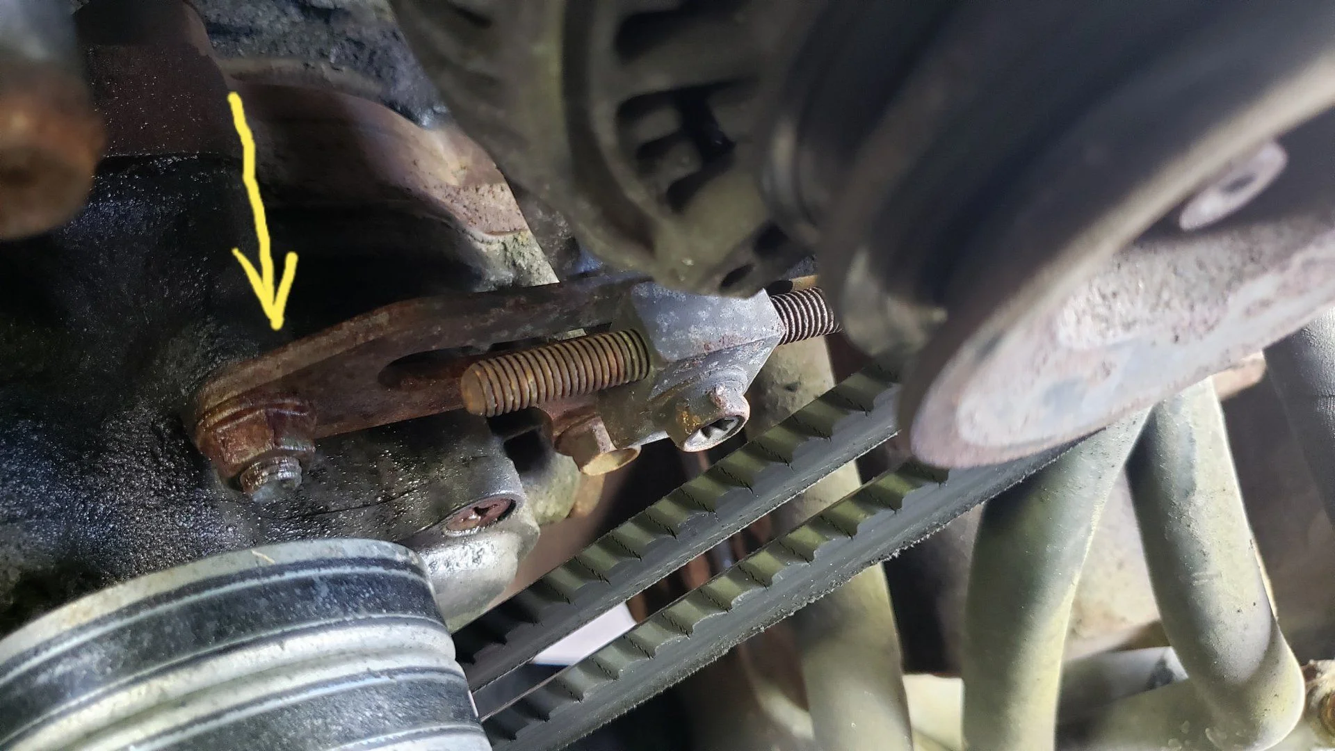

Thanks for the write up it helped a lot. Had some issues with a stubborn bolt, see yellow arrow, that wouldn't come loose.

Anyone going into this should pay careful attention to the post. One thing I discovered as I went was that the alternator tensioning bolt absolutely needed to come ALL the way loose, as stated. Not short of all the way. Just do it. There was no way those two belts were going on otherwise. That tensioner is tough to get at. Takes patience, and a ratcheting 12mm. Some of the time I used a short socket (shorter better), some of the time an offset flat wrench. Had to often hold the socket or wrench head on the bolt, with right hand while working the wrench with the left. Could get a few clicks going. I noticed also, that there is a torx head on that bolt. A 90 degree drill fitting with that size torx bit could possibly speed this process up.
