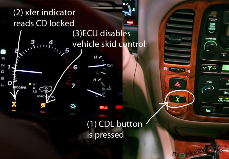

Found this web page that provides a good explanation/fix for the problem - Lexus LX470 (Toyota Landcruiser) 4WD Center Differential Lock Transfer Indicator Switch Problem
Anyone else ever had this problem, where the center differential locks, but the lights doesn't come on? And was the fix the same as this page describes?

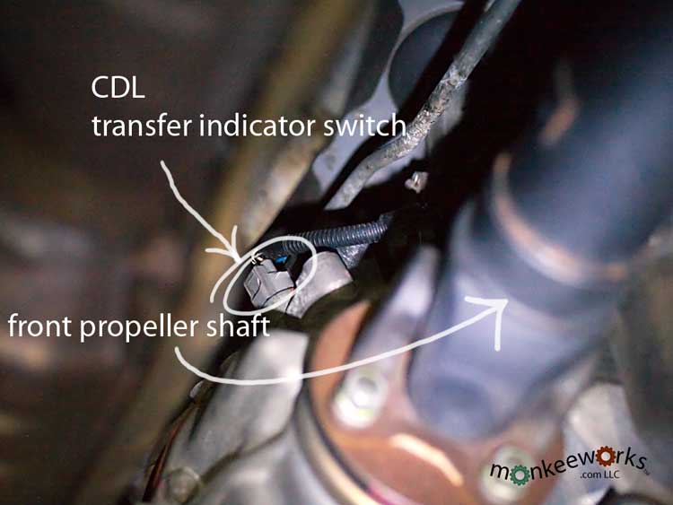

View attachment 536700View attachment 536701
Sorry for pulling this from the dead, but I appreciate the pictures and the notes on them, especially "front propeller shaft". I pulled and replaced a similar switch, but it was near the rear propeller shaft and I was a little irritated the cdl and vsc lights didn't display when I engaged the cdl. Seeing this picture put me in the right direction and replacing the right switch, thank you.
Let's revive this one... I replaced the switch. Still no illumination. haven't had the chance to get this into dirt or offroad somewhere to see if the center diff is indeed engaging or not. I am going to try to jack up one of the front tires to see if it spins when the lock is engaged. Any other tips for troubleshooting this no diff light, no low range light, no vsc off light coming on? the pwr and 2nd strt all come on fine when engaged.
When I hit the center diff lock button there is a motor sound from the passenger side that sounds like it is engaging something. I will try to get it offroad somewhere to test but don't really want to go too far off if my center diff is not working... It was raining today pretty hard so I'll need to try the wheel spin test tomorrow...
I suppose there is a chance that I replaced the wrong one... there is one sensor on the t case that is facing straight up but I tried the connection to the replacement part and it was a different interface... there's another that is facing slightly towards the passenger side. I replaced the one tilting towards the passenger as that is the one that was referenced in the thread I read and the replacement part that I sourced is below and fit the connection:

Sounds like your CDL mechanism is working fine, just not illuminating the dash light. This is likely solved by replacing the detector switch on the transfer case (posts #1 & #32) or, less likely, bad dash bulb. Start with the switch.
If no dash lights come on when the CDL is engaged, it is almost certainly the t-case sensor. The Beck Arnley one above worked for me with the same symptoms.
At least on my 05, when everything works correctly the CDL cluster indicator now illuminates as does the VSC OFF. I'm not 100% sure yours works the same way, but either way the switch is the first step. It costs $20 and will take you 20 min to swap.

Replace the sensor and exercise the thing off road for about a few weeks to a month. If it’s anything like mine it’ll likely start working intermittently then will work all the time after you wake it up from it’s slumber. Also, once mine started working again and indicating as such on the dash, you can definitely hear a quick whirring then a audible snap/click when it engages. Satisfying snap, not something breaking snap :)
Uh oh.. I've already ordered the part and a 27mm wrench... unfortunately someone on that thread said it was important to use a 12" 27mm wrench. I didn't even think about the length. the wrench i ordered is 14" long. Oh well.. I'll see how it goes.
