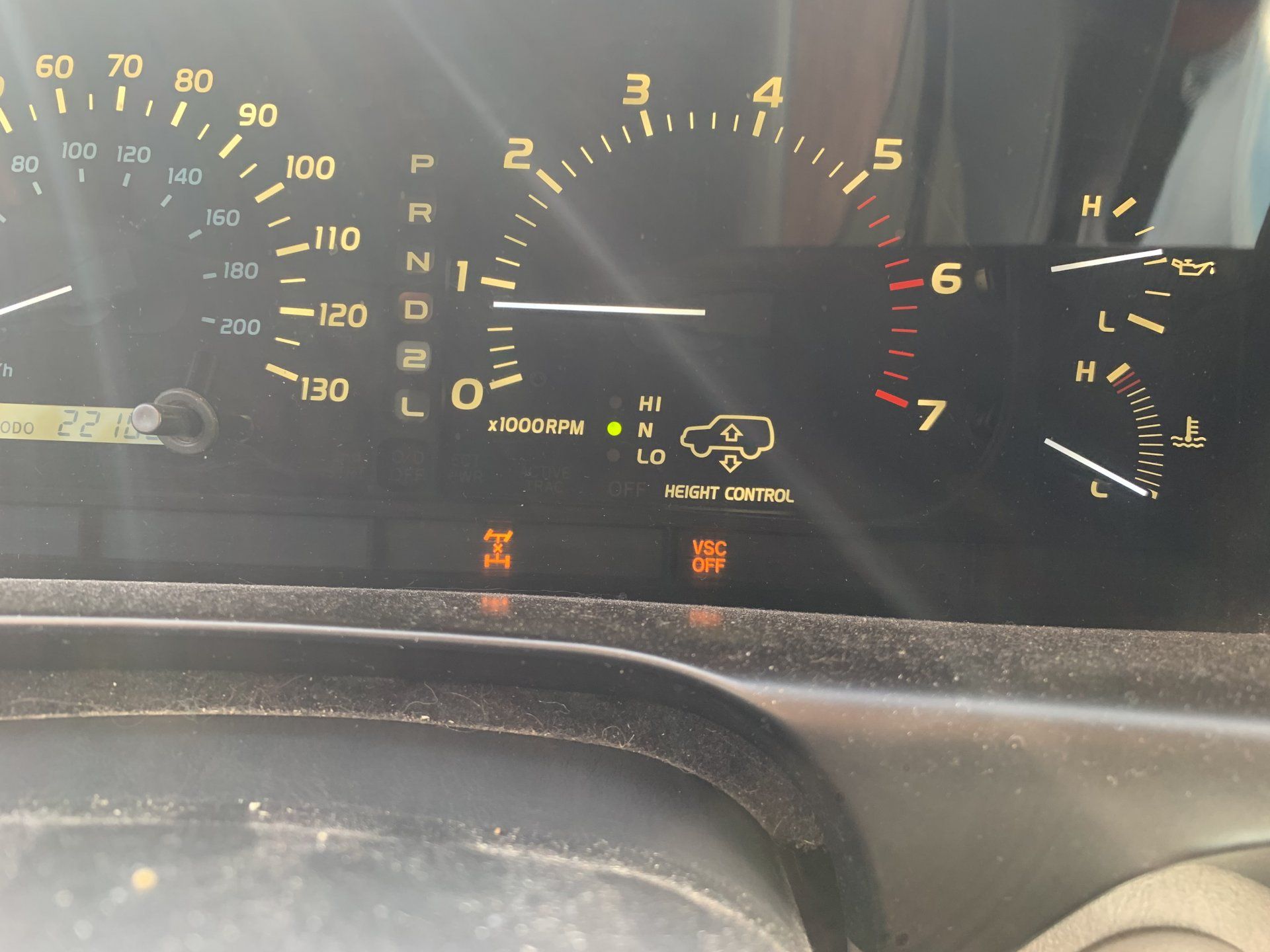

CDL and VSC off does not come on at start-up
When the CDL button is engaged, CDL comes on but VSC does not
I tried debugging using techstream but do not get any errors for VSC
Keen to hear what others think

CDL dash light is not supposed to come on at startup. It comes on only when the CDL is physically locked by the mechanism, so yours is working well.
I’m not sure when the VSC OFF light should illuminate (my ‘98 doesn’t have VSC), but if it’s never coming on I’d check the bulb.

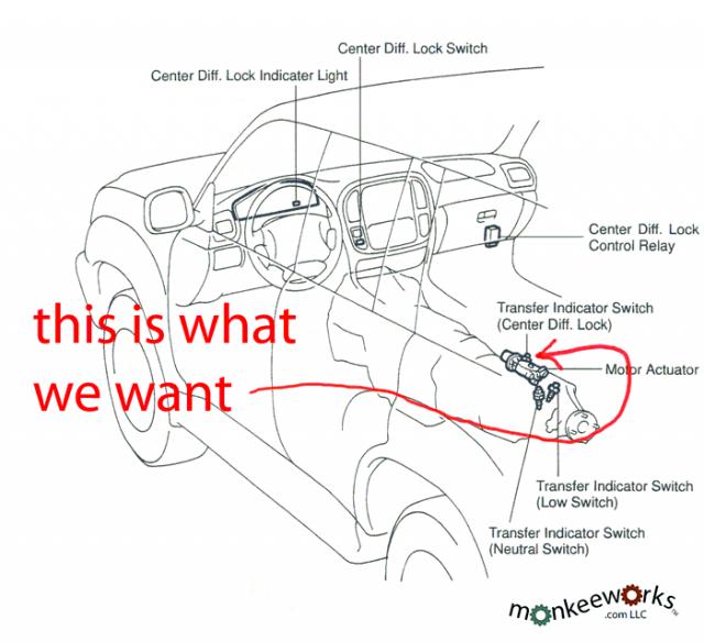

This illustration just helped me a ton. I also had no lights on dash when depressing CDL button. I replaced what I thought was the CDL switch. I mistakenly replaced the "low switch." No change, I was bummed. CDL and low switches must be the same. I just removed the actual CDL switch and replaced with the original low switch. Problem solved! CDL and VSC lights come on.
