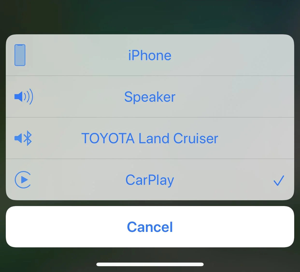

On my phone, I can select either CarPlay or Toyota Land Cruiser for bluetooth and can change back and forth. I don't know.
In order to play something like Pandora on CarPlay, your audio input needs to be set to "Aux". So, selecting "Toyota Land Cruiser" should give you no audio. This has been my experience. . .is it the same for you?
Yes. I can actually switch phone calls between the two. Sometimes when I tell it to play something music wise, it will change to the car bluetooth. I am still playing with it all. You certainly know more about it than me, having installed it yourself. I am just happy to have it!

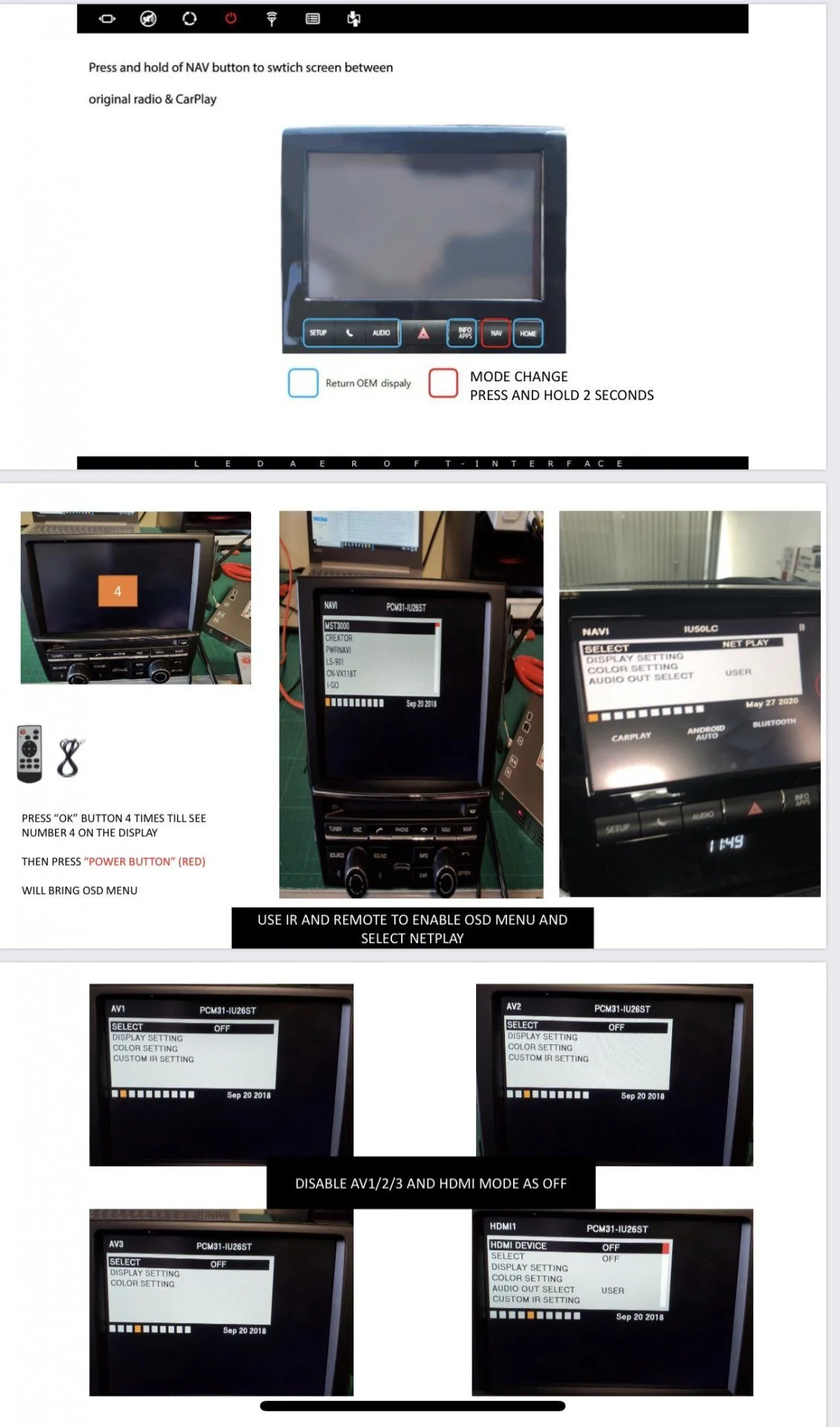

My steering wheel controls don’t work (skip function), of course volume does. I plan to make a review soon to explain all the quirks, but haven’t yet. The cameras work the same as OE with CarPlay running, even in 4LO/crawl.
Eric, my steering wheel controls (other than volume) do not work either. I don't believe you used the USB connection provided by NaviPlus, but it does not charge my phone (iPhone 11 Pro Max). It seems to be strictly a control connection for CarPlay.
Eric, my SWCs weren’t working either. I chatted with NaviPlus yesterday and they advised you need to initialize them via the procedure below. This is the “mystery” purpose of the IR receiver and remote. I followed these instructions and they now work as intended.

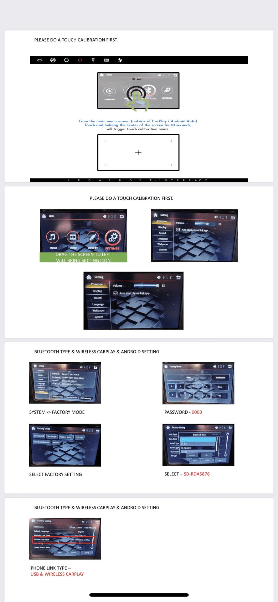

This document shows how to calibrate the touch screen, and some other settings to verify.
