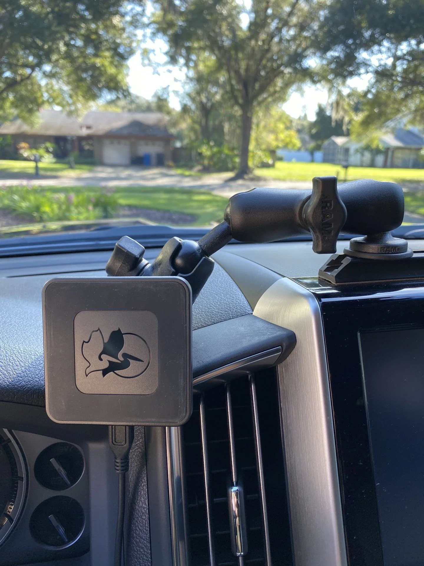

I wonder if you could use a Qi charger for power and a cable for the audio. Not sure if that’s possible or if Qi shuts down in the presence of the cable. I use this Pelican case/mount: Pelican iPhone 11 Pro Max Case, Protector Series – Military Grade Drop Tested, TPU, Polycarbonate Protective Case for Apple iPhone 11 Pro Max - with EMS Wireless Charging Vent Mount (Black) Amazon product ASIN B07X5Y7FGX
Do you have a link for the mounting track, which is sticking on top of the dash? It looks like a perfect solution to mount all my gear.
Here’s the link: Shop RAM® Tough-Track™ End Loading Composite | RAM® Mounts
They offer several different materials/profiles: RAM® Tough-Track™ Mounts | RAM® Mounts
I initially tried the top mount composite, but the end mount was a better choice. I used 3M VHB tape to adhere the track to the top of the nav stack.

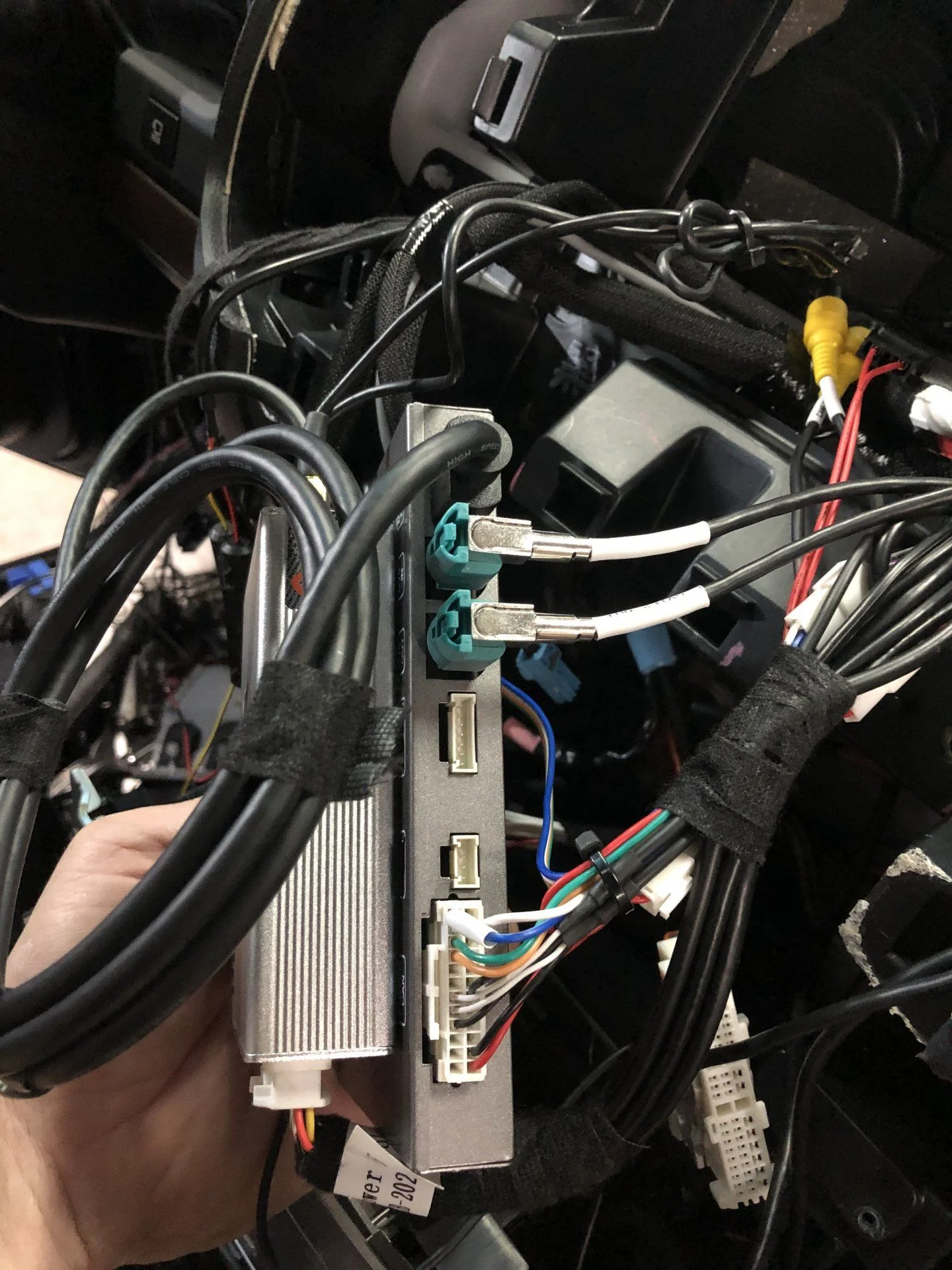

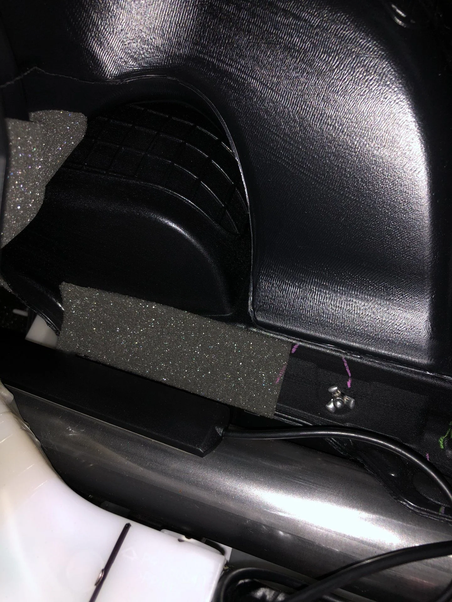

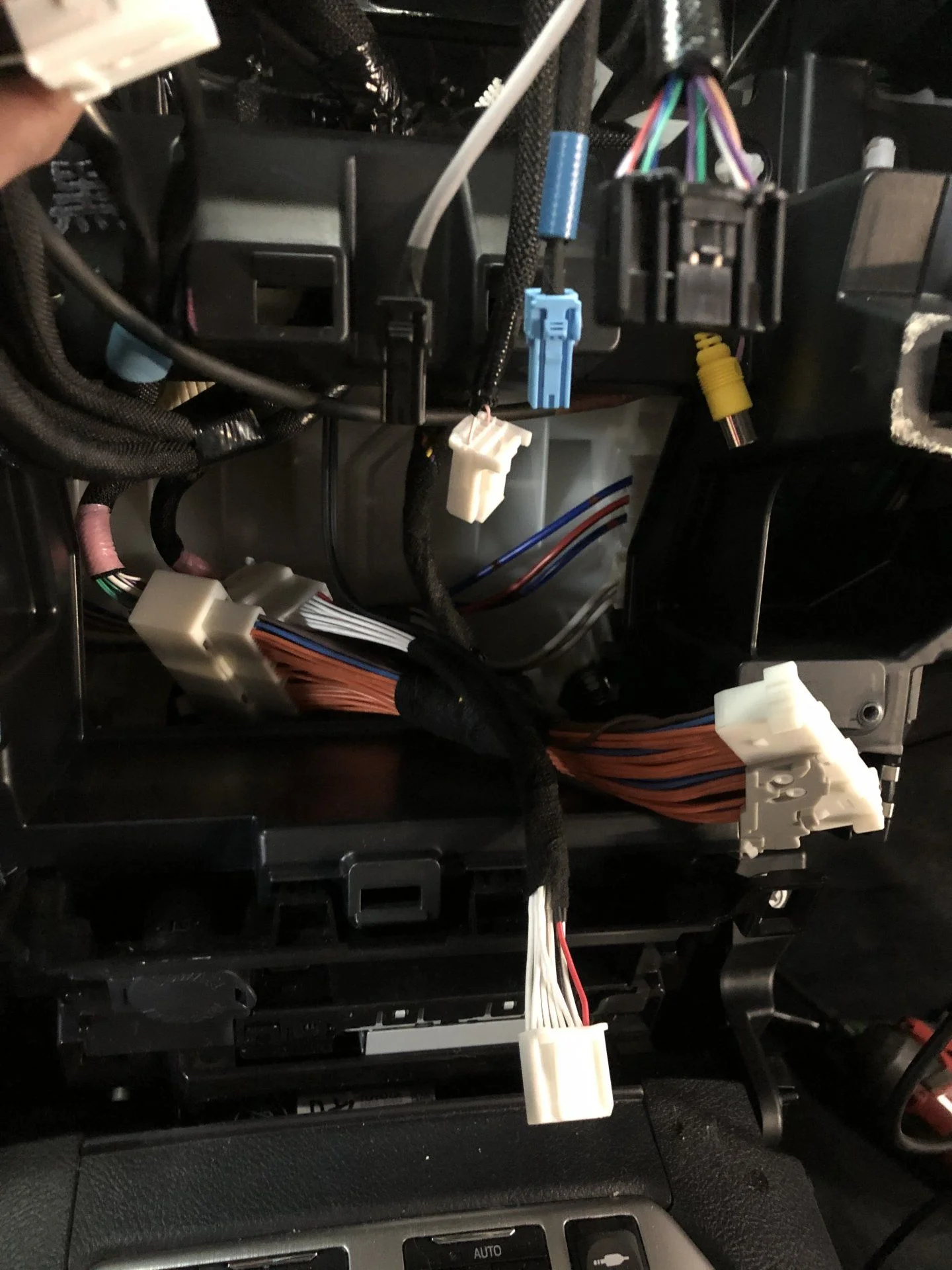

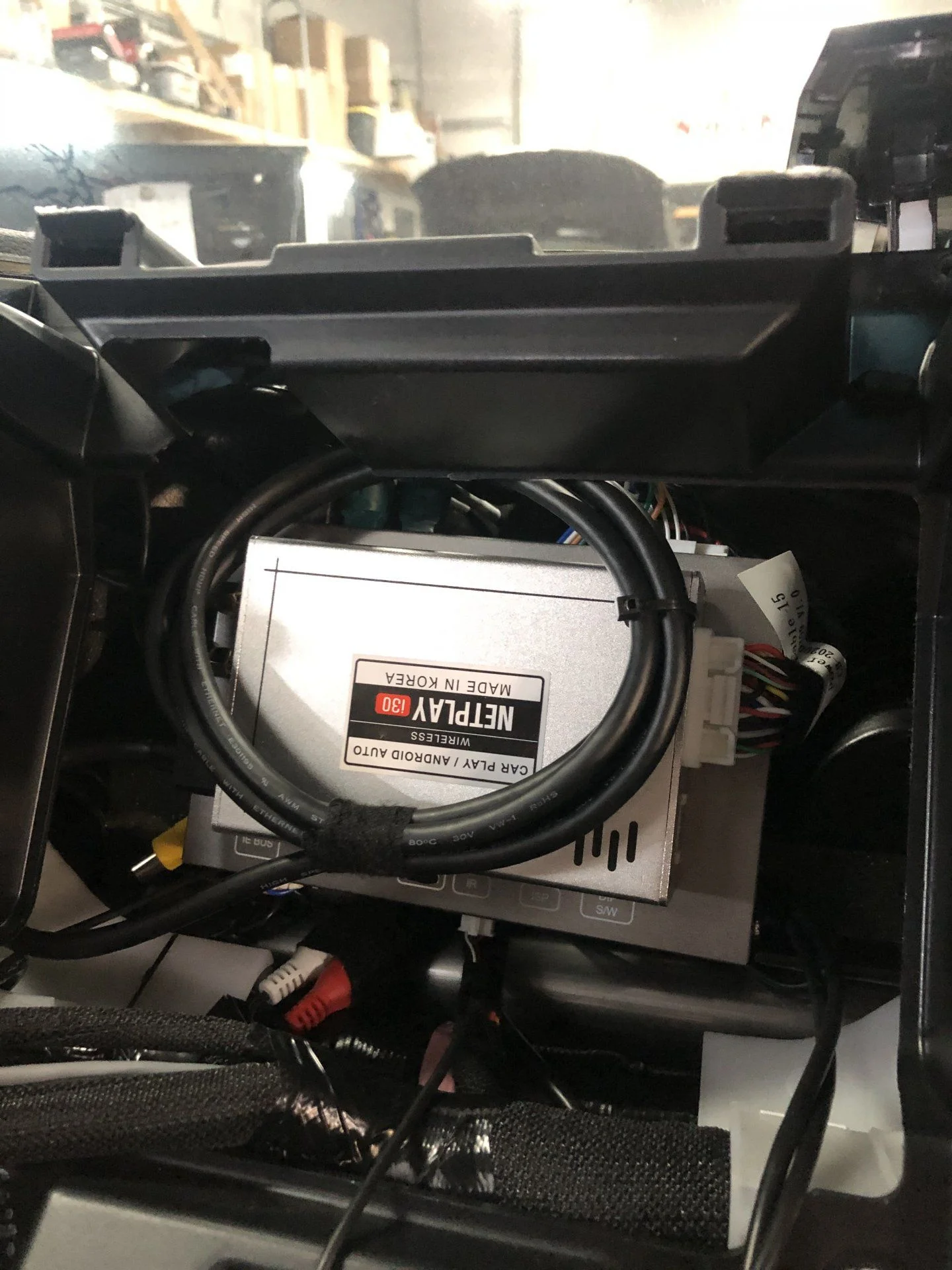

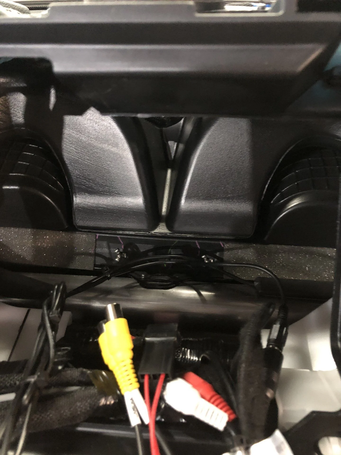

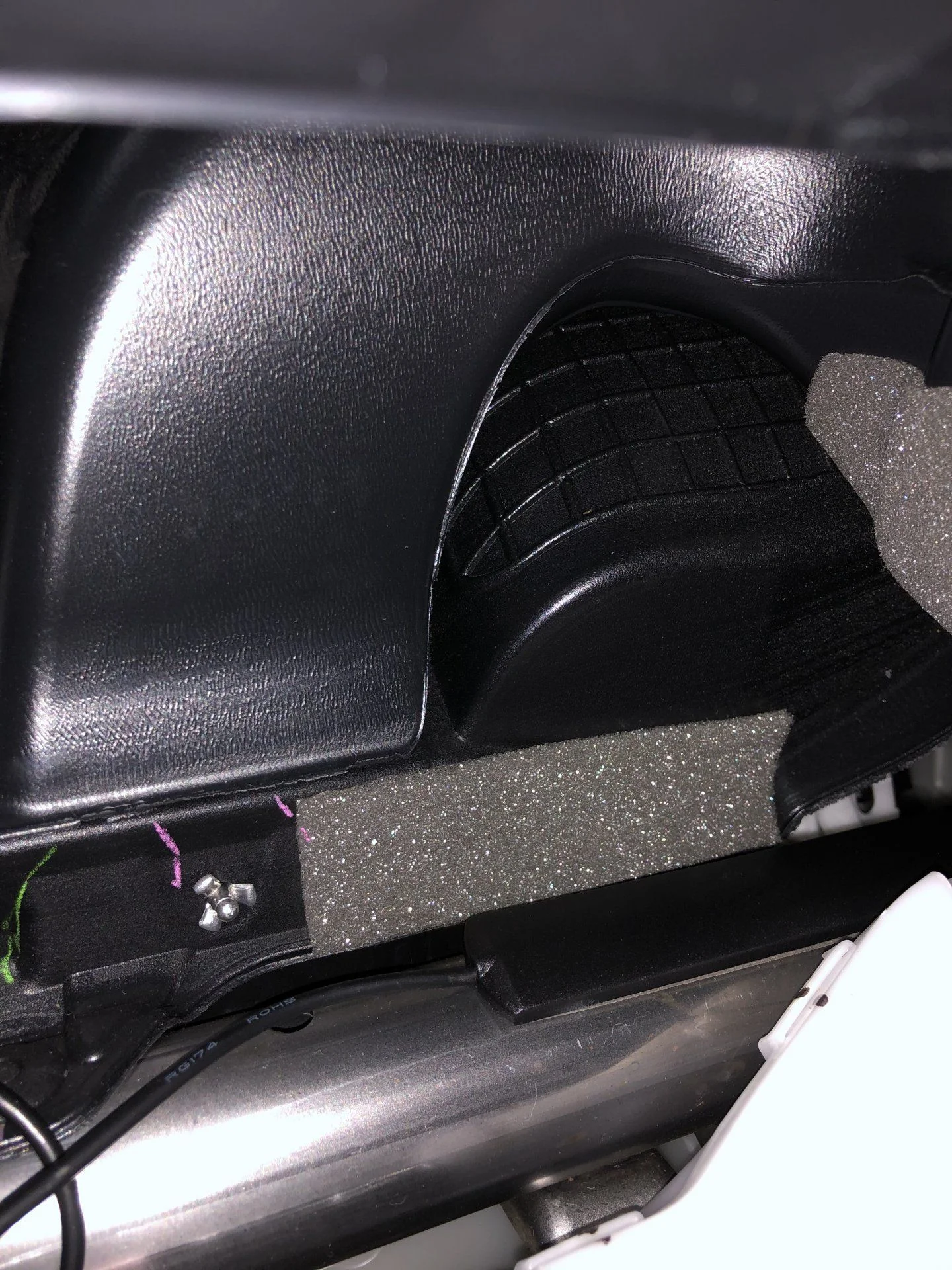

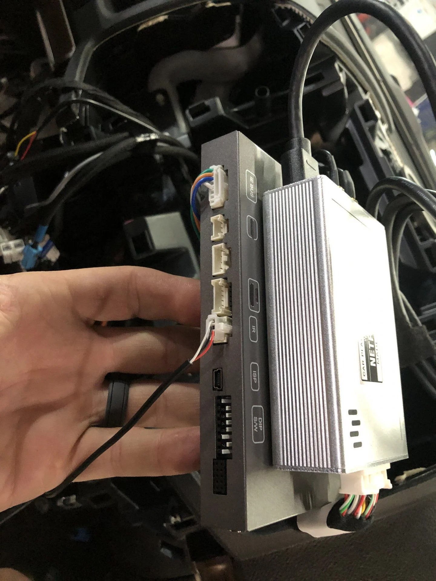

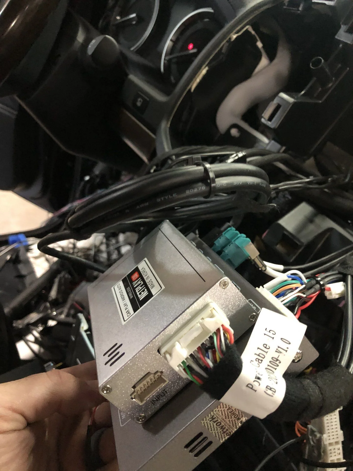

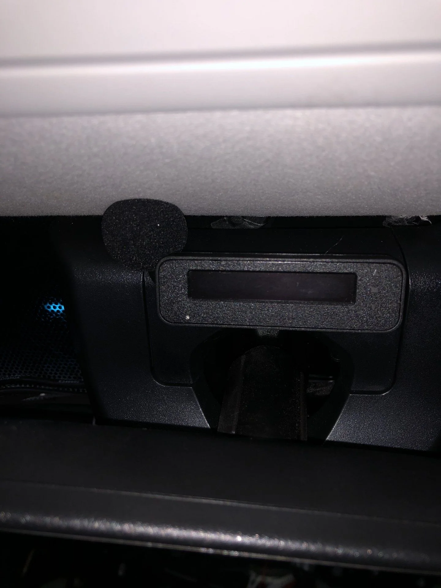

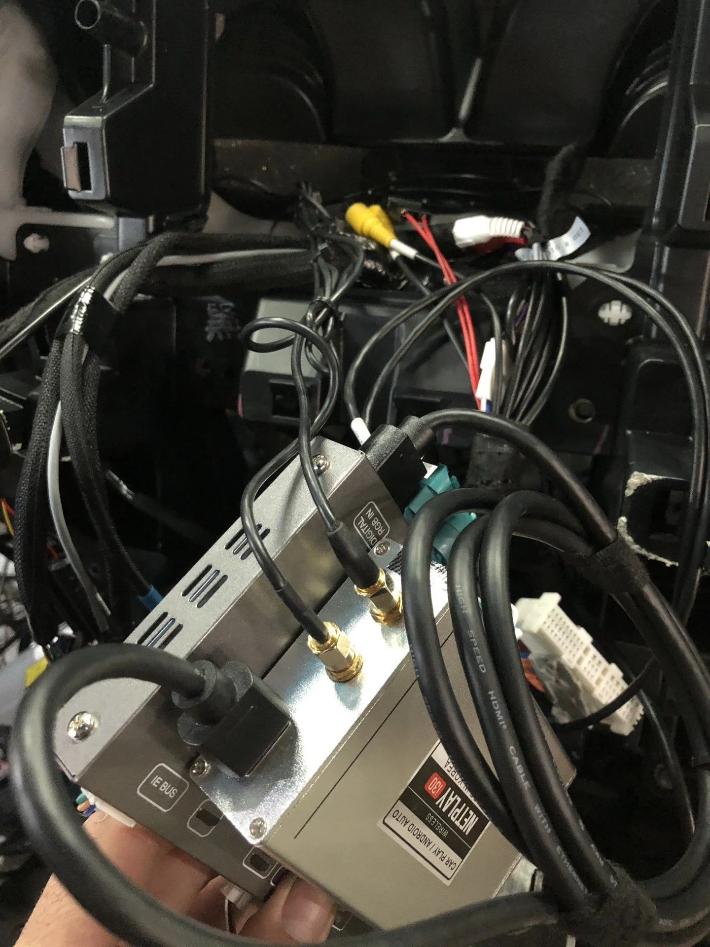

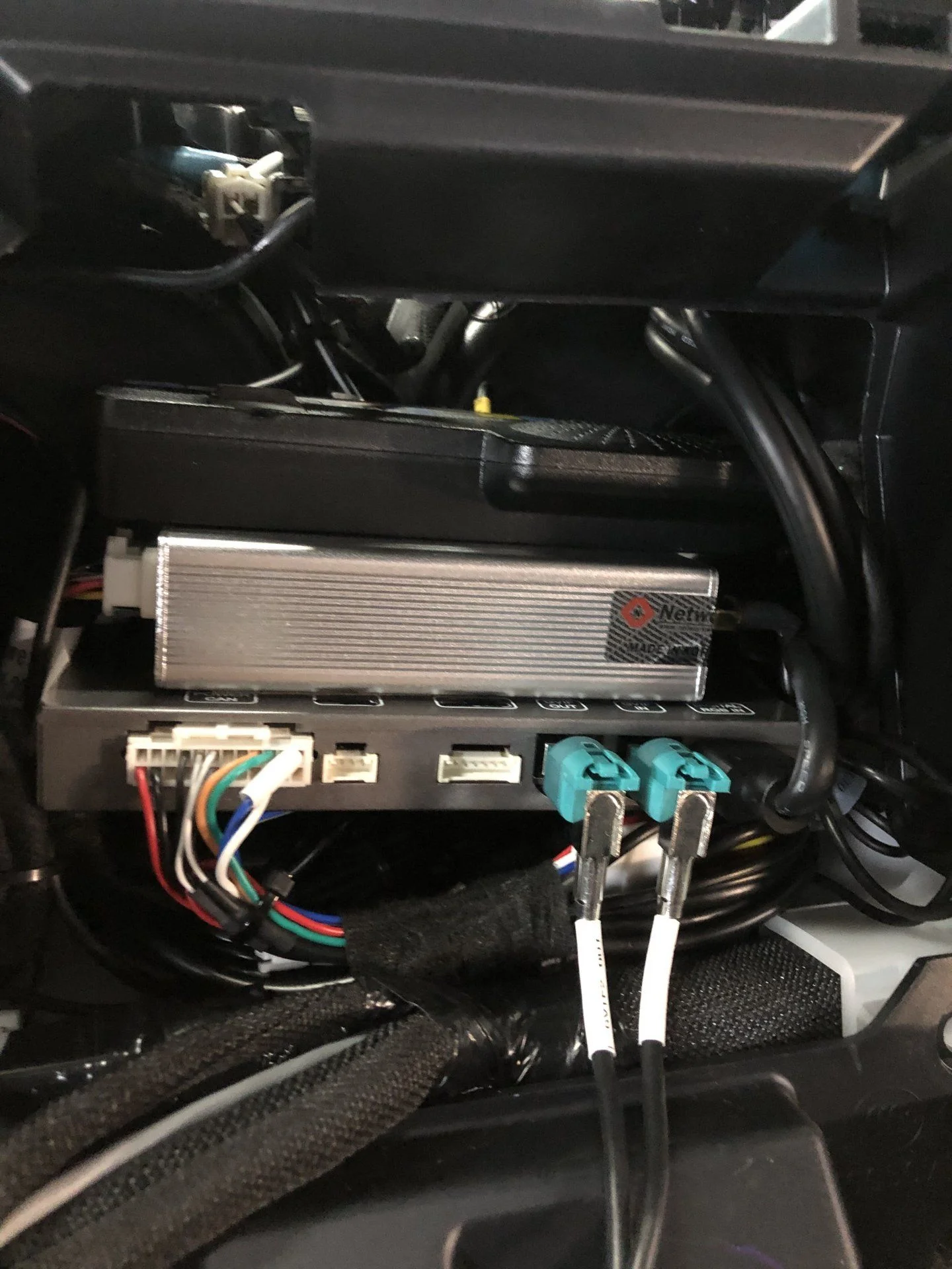

Install pics
#2nd one in and works great. This one in my personal 200. Can’t wait to try Gaia on CarPlay next week in Ft. Collins
