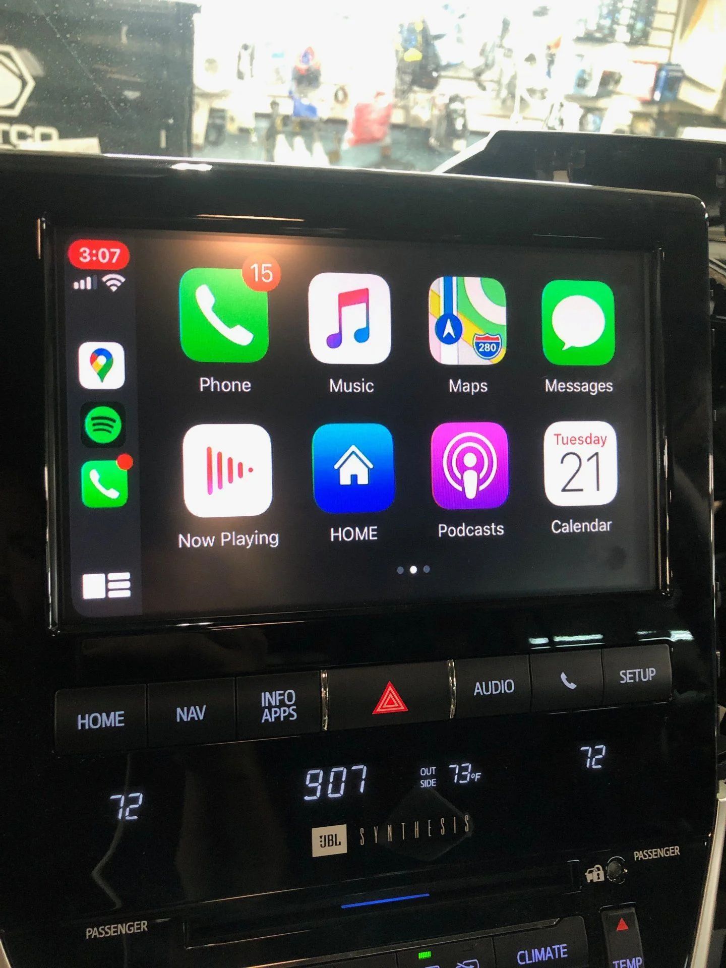

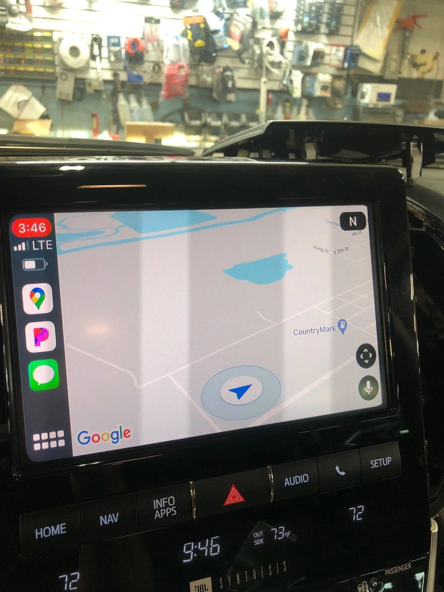

CarPlay works in a 2020 Land Cruiser
No GPS issues so far. I'll be testing it next week with Google Maps/Waze + GAIA On my way to Colorado. Look at pic #3 for mic placement (rear view mirror). I used the factory USB port by the 1/8" headphone jack/shifter.

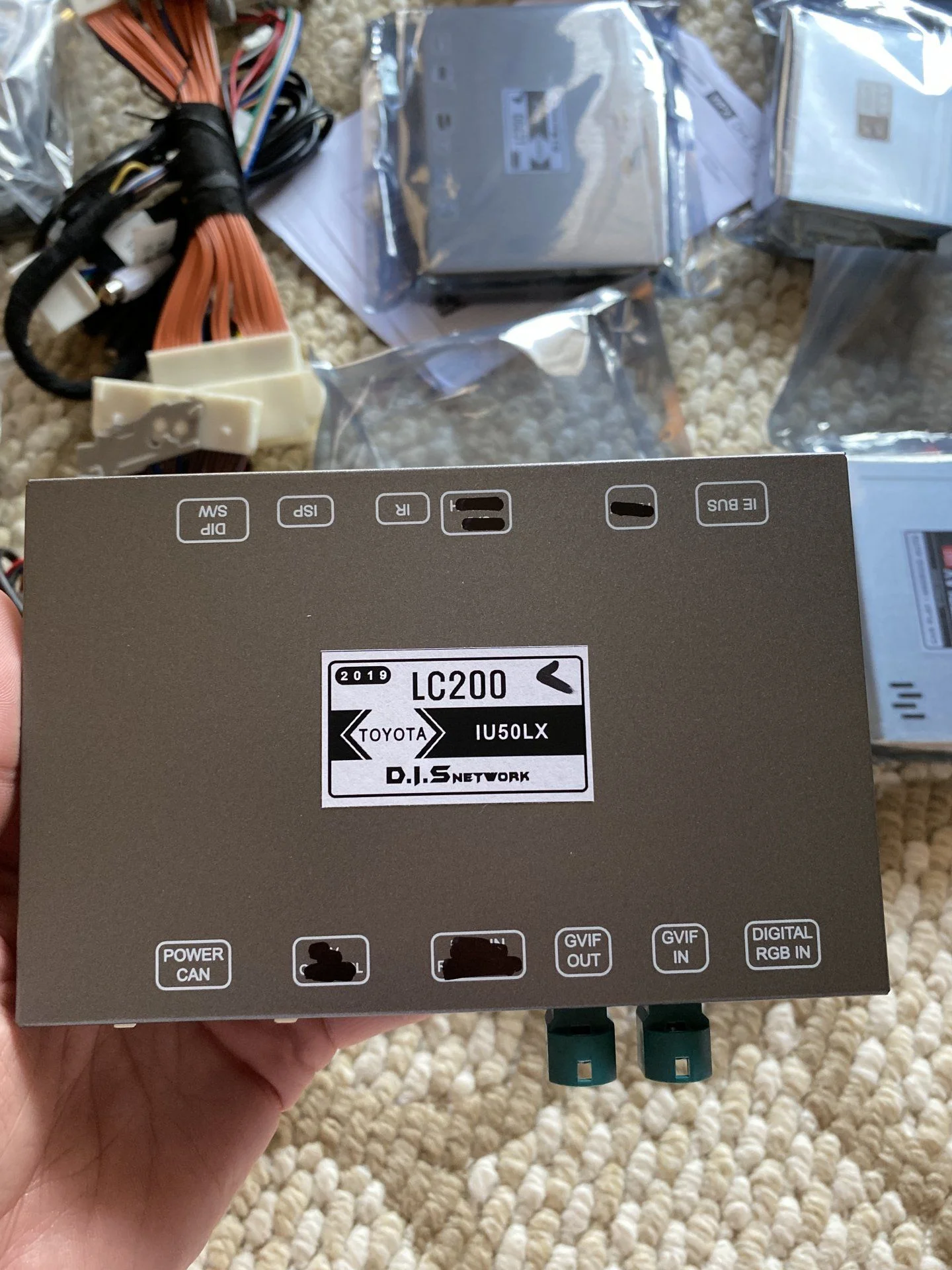

Hi .. could you please tell me where did you put the actual unit? (the silver box).
I got one of these the other week, but I'm still messing with the install. The directions are not so great, or I'm having an issue figuring them out.
Have it sort of working with google maps, but have not been able to install my actual phone apps on it yet.
There are 4 USB outlets, plus the aux GPS, plus the big silver box. Where did you put the outlets and the silver box?
Did you install the aux GPS on the dash?

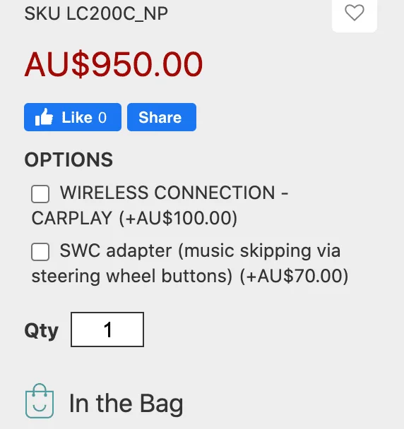

I have been eyeing this unit for a while but at $AU 1,000 ($700) I dont think it’s worth it. I have been using an ipad pro magnetically mounted ofver the display and it does what carplay can and can’t

There are some pictures in this thread that may help: Builds - Heritage Blogmobile Build Thread
Thanks !
I see they Velcro-ed the unit behind the screen. The unit also has it's own GPS antenna which is not mentioned. Instruction could use some improvement.
Our units didn't come with any instructions. I'll get pics on the next install for the thread.
Thanks !
Why would the Naviplus unit need it's own GPS antenna? The GPS in the connected iPhone or Android device will be used for CarPlay and Android Auto apps. This is also the first I've heard of multiple USB ports. Are you sure you're talking about the same device (keep in mind this thread is discussing the version for 2020 LC's, which may be very different from the version for 2016 LC's)?

Confirming wireless Apple CarPlay works on 2020 Land Cruiser.

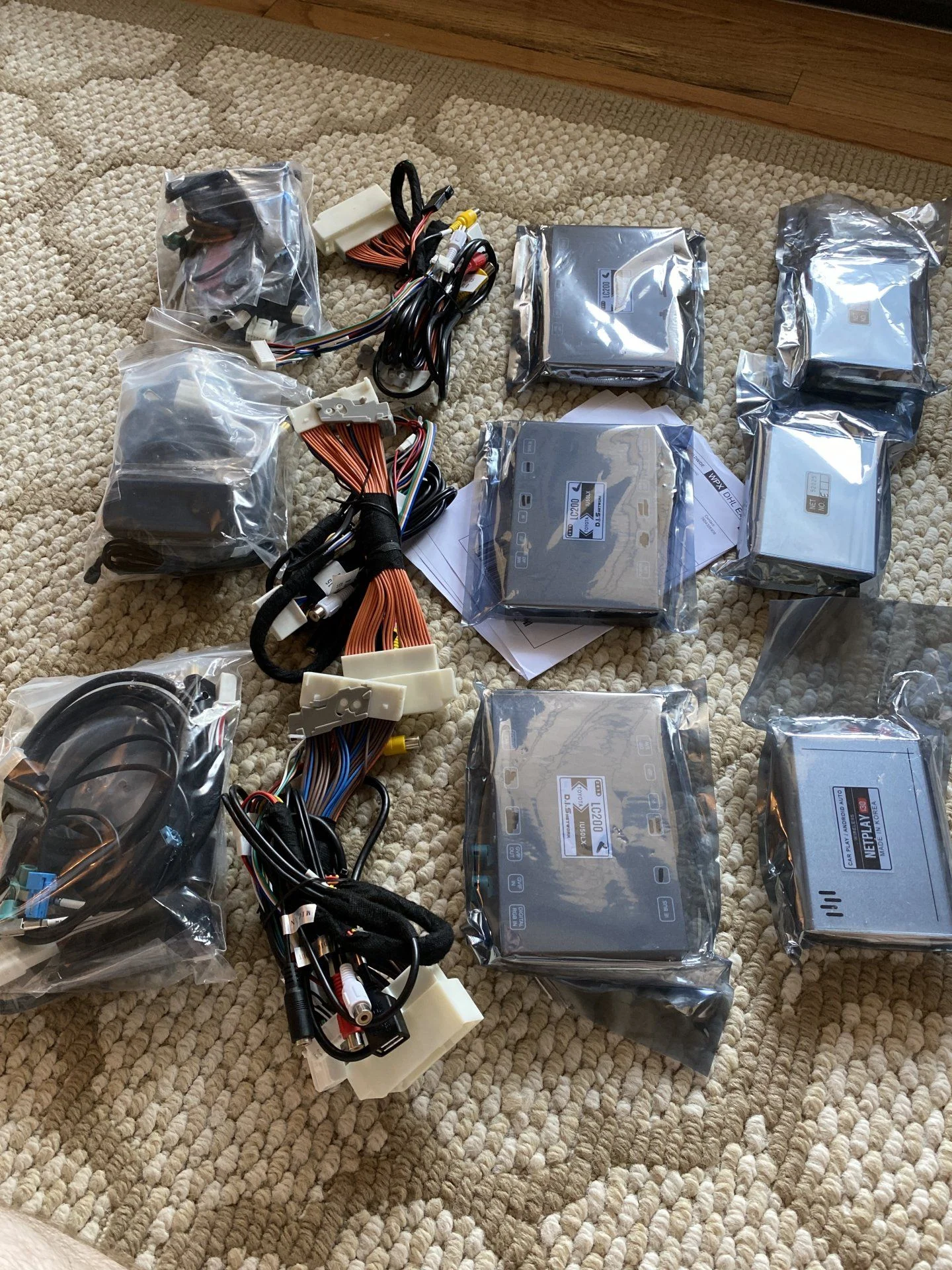

NaviPlus also have unit to support early LC200 too. LC200 owner prior to 2016 don't feel left out.
I was trying to find the tech spec of NaviPlus unit. Not sure what hardware they are running. CPU/RAM info would be nice.

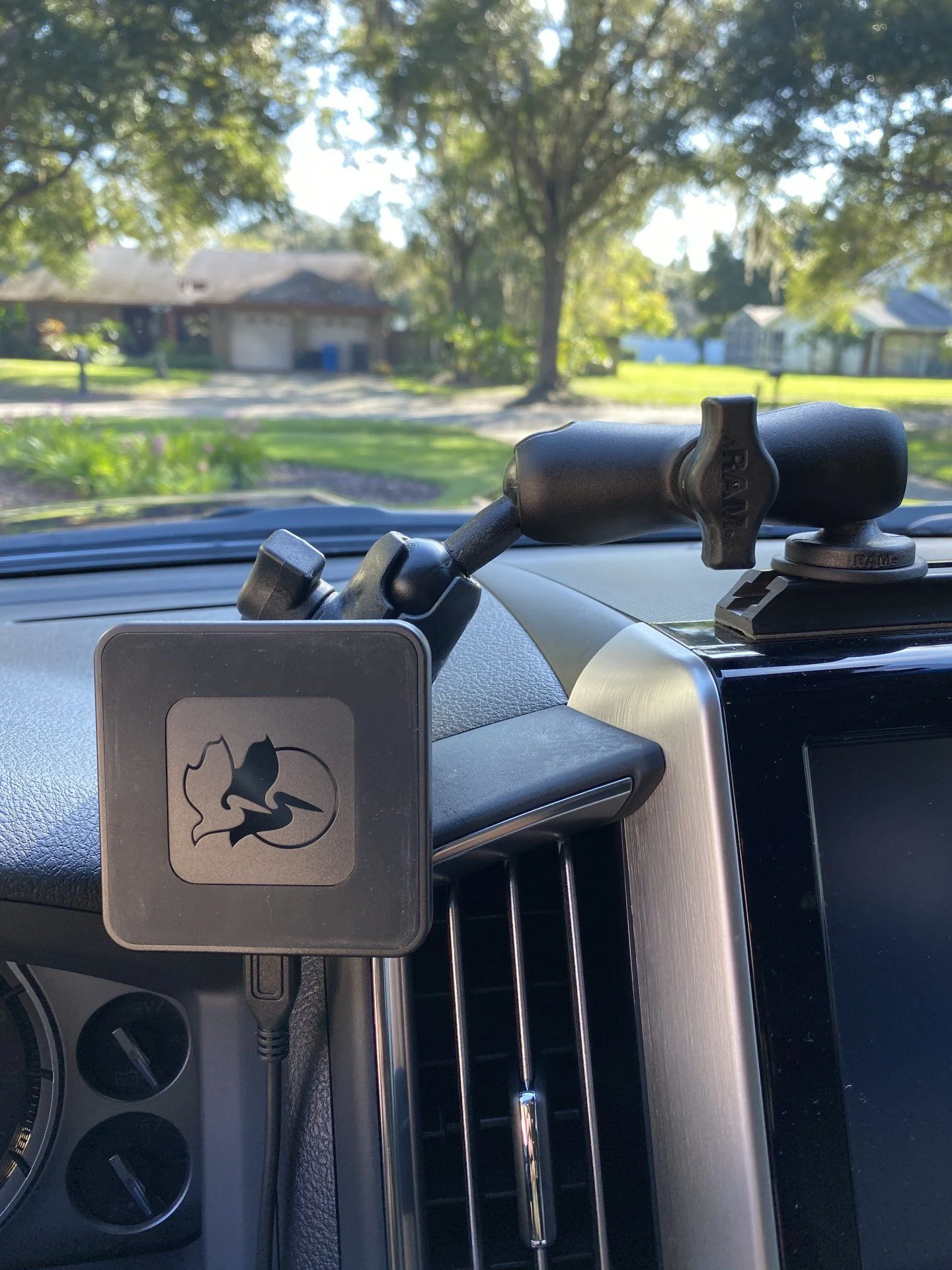

Would you be able to post a pic of this setup?
Here are some pictures of my current setup
ok here is my first setup with a mini, picture it with a 10.5” Pro...
here it is with the iPad Pro
- Smart Cover easily attaches to dash speaker cover via built in magnets
- power adapted with magnetic quick connect and clip on dash to allow easy flip up of iPad to view reverse camera and access to OEM unit
- I use wifi calling on other device to enable native calling from the iPad cellular plan
- split screen music with maps
- slide over for iMessage and other apps
iPad Pro on dash
Why would the Naviplus unit need it's own GPS antenna? The GPS in the connected iPhone or Android device will be used for CarPlay and Android Auto apps. This is also the first I've heard of multiple USB ports. Are you sure you're talking about the same device?
The short answer is you can download your apps to the Naviplus, and they can run on the NaviPlus independent of the phone.
The above version is different.
I have this one here
