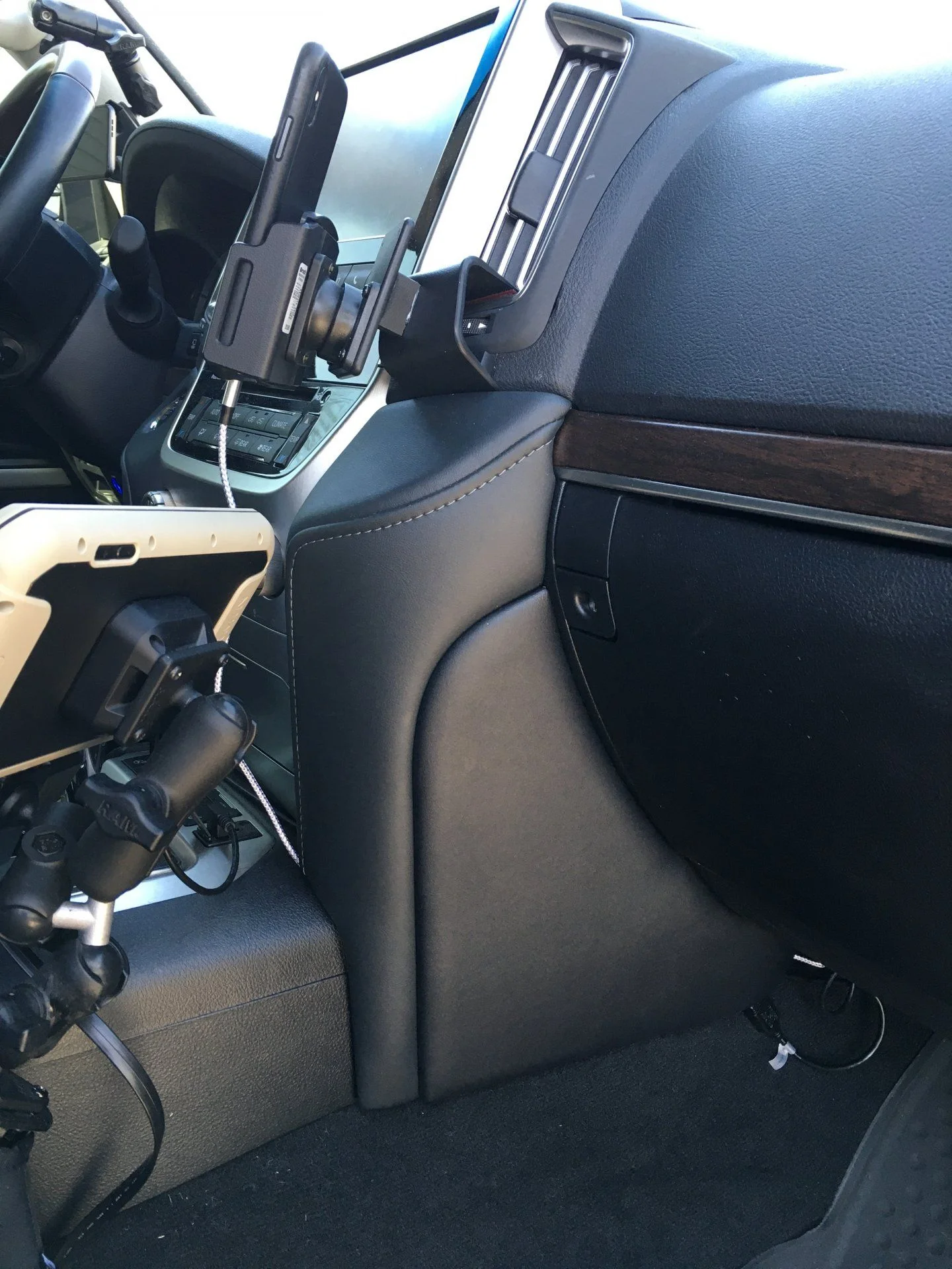

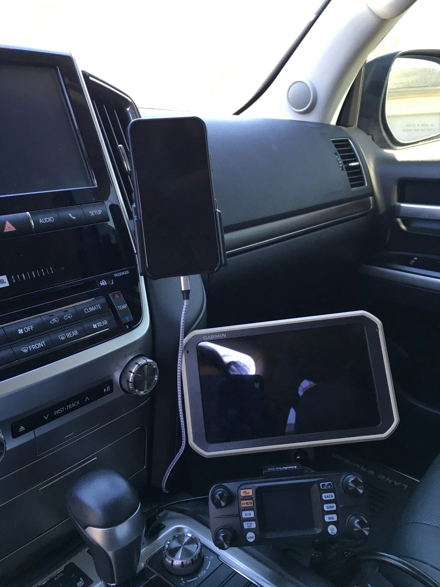

How are you charging the Garmin? Do you find those arms to be intrusive for a passenger?
You can see the angled usb in the factory port. That is going to the Garmin. The only time they are intrusive is when the wife get in with her purse (which is way to big, but that is another conversation) in her left hand and hits the Garmin and Ham head unit. Once she is in and has put her purse on the floor they are not in the way.

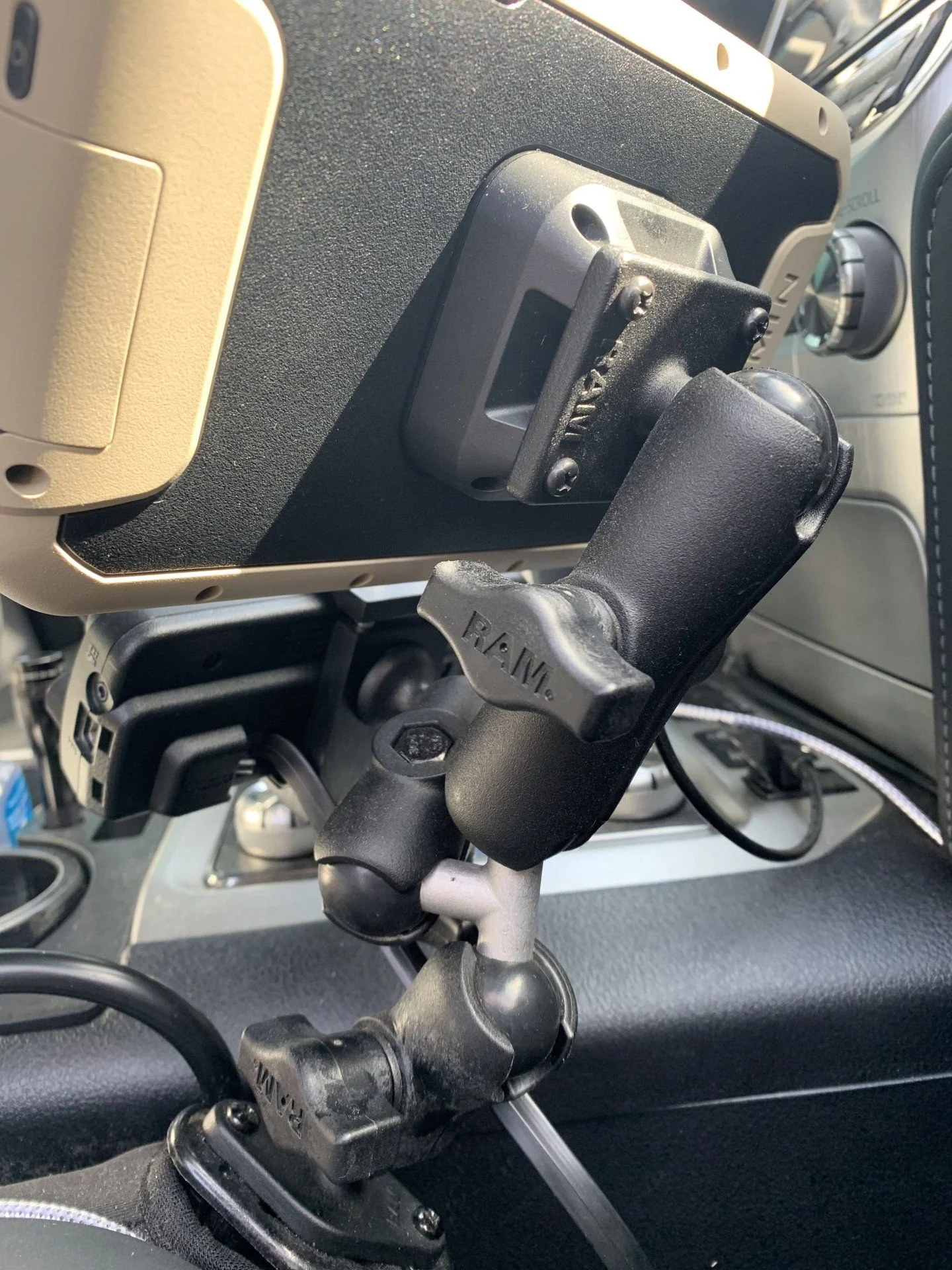

@Fisher23 , here is a shot from the back. You can see the different ball adapters and such that I used.
In all my years using RAM Mounts, I have never seen that T with 3 balls you're using there. What model is that? I must have it!!
