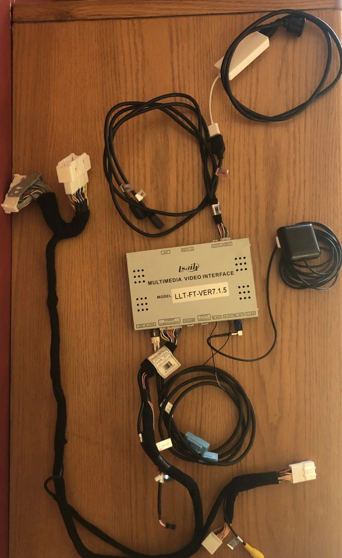

Not sure if this will help or not. Here is what mine looked like. This is for a MY19.

I purchased the SWC "module" and it wasn't very clear what hardware, if any, enables that function. I had two boxes, one small Netplay unit and a larger unit with lots of connection ports. I'm thinking it's either firmware or something in the cabling.

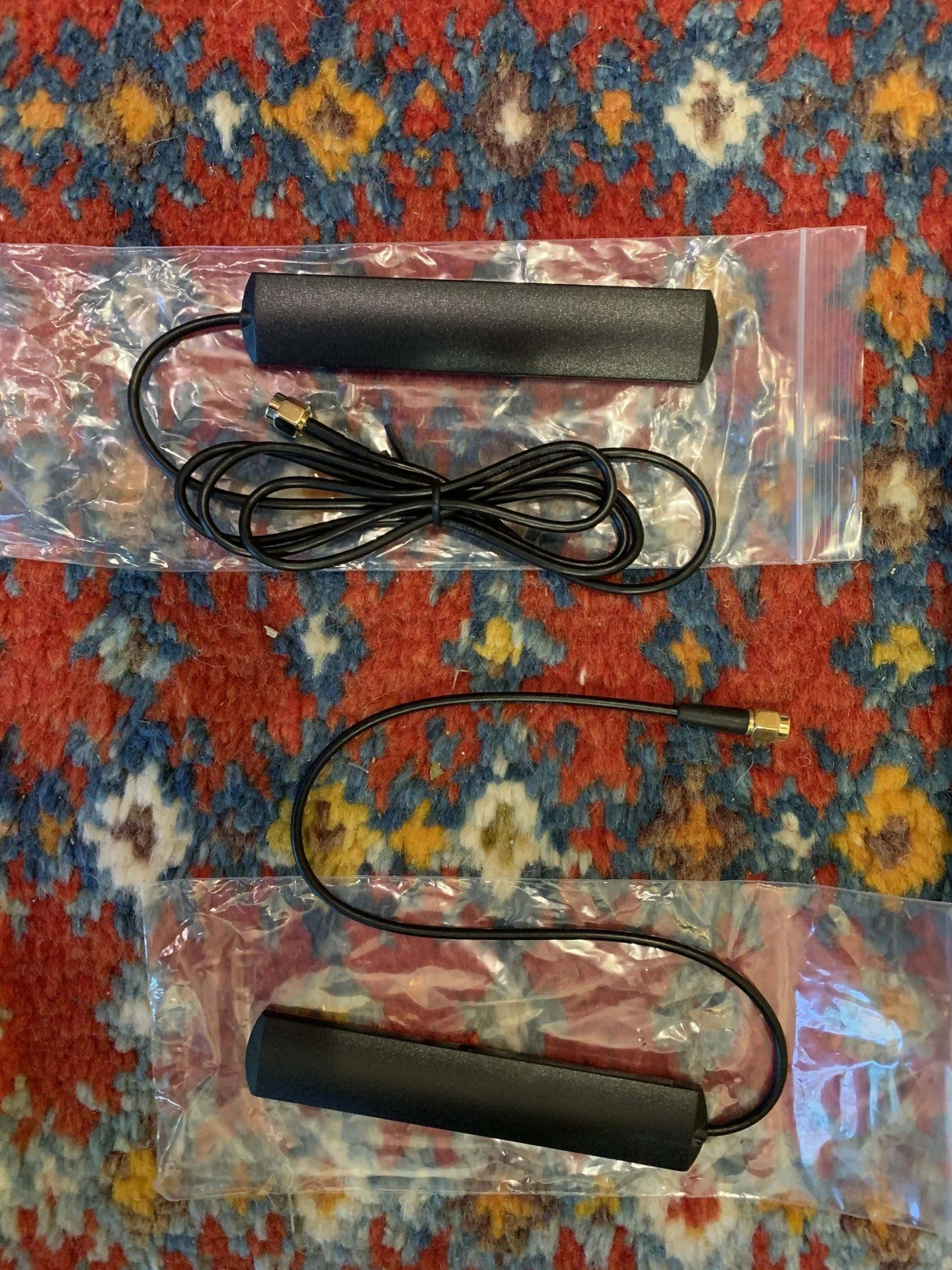

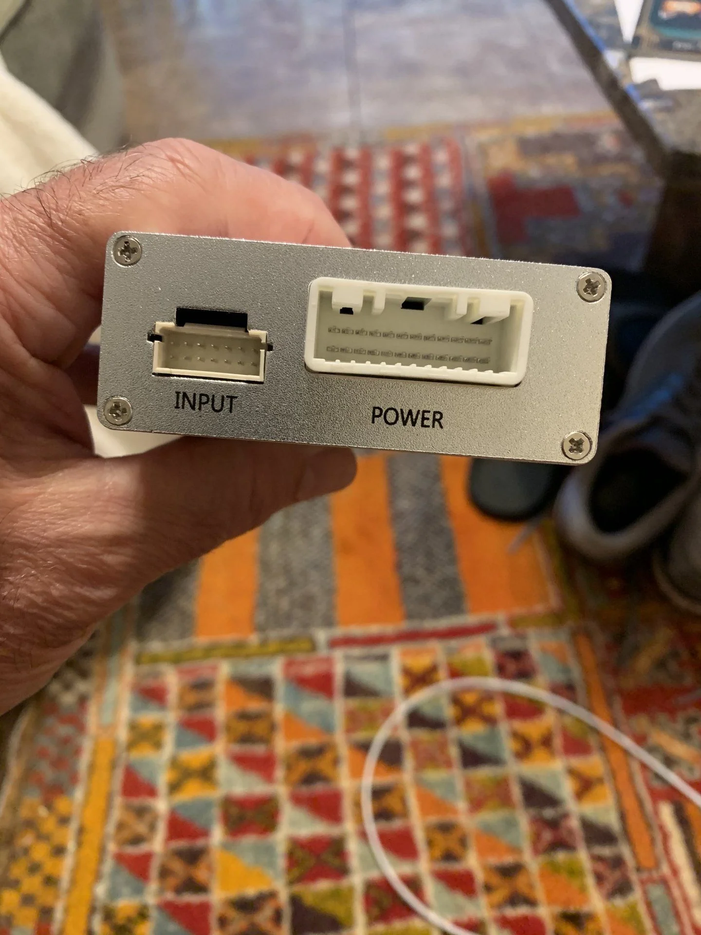

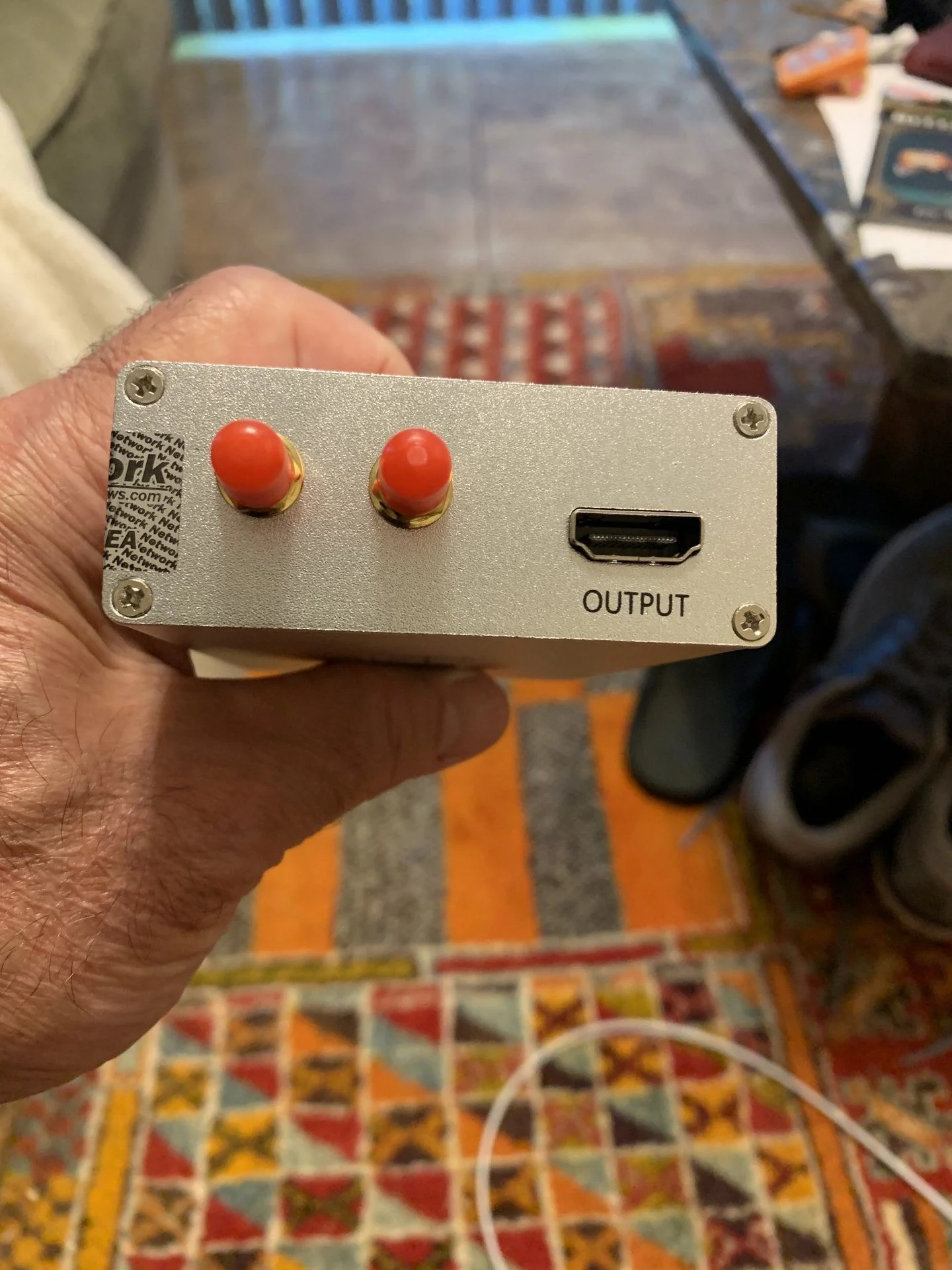

Sorry there was also another small box. Seems I only have picture of the sides of it.

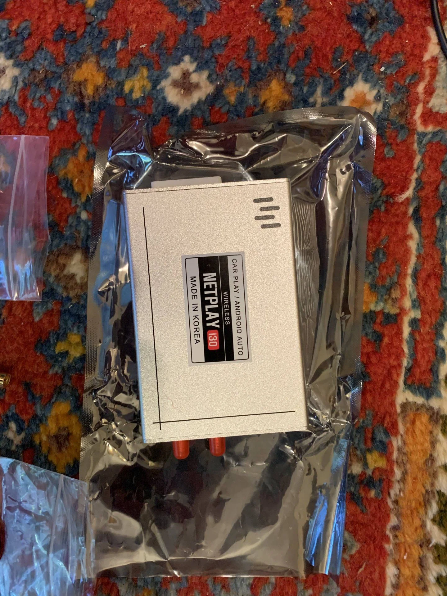

@CharlieS I found a picture of the smaller box. This should answer the question. It has wireless CarPlay on it.

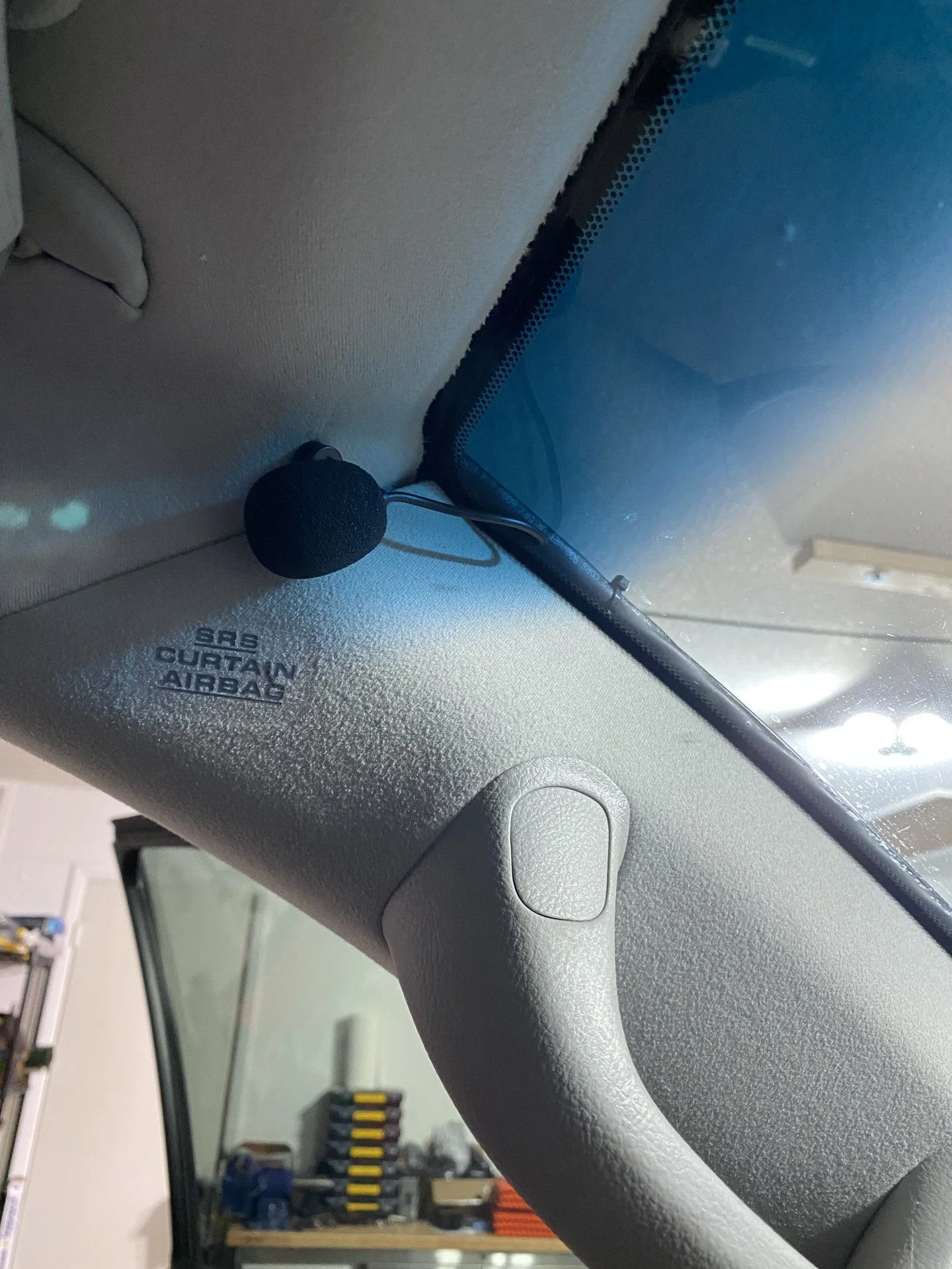

I just pinged Naviplus Sales with the following questions. The first is because I thought I understand that someone was using the unit without the provided microphone (which I understand is a PITA to install and not that great quality). The second question is based on what I saw in @herosfc's post. I like the idea of the USB port using one of my blank switch panel slots.
1) Do I need to use/install your microphone or can I order a kit for my model LC that does not require me to install a microphone? Yes, you do as it's for a voice command in CarPlay mode but you can still use the original Microphone for a normal call
2) The USB port for wired connection (I hope to use wireless but just in case). Some who have purchased from you say that you provided a switch panel "blank" that fits great and allows them to use one of the spare switch panel spots on the LC. This would work great for me! How can I be sure that would be included?
Yes, we provide it as a kit now!

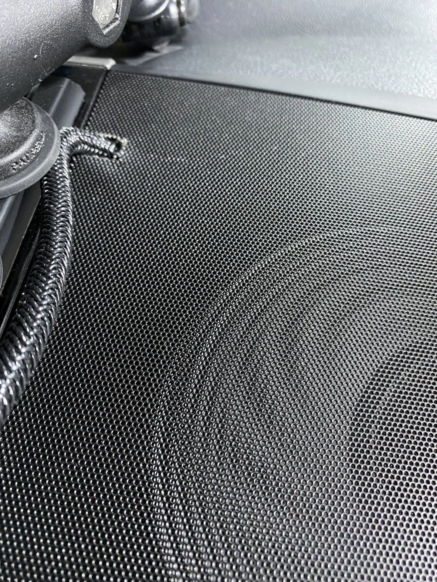

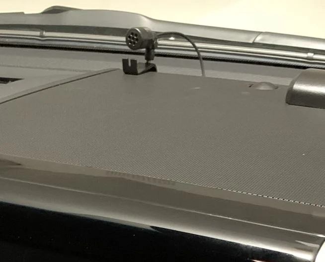

There may be easier ways to install the microphone that don't involve running it up to the headliner. I'm not using Naviplus, but newer version of the EC Offroad module has a microphone that comes with 2 different mounting clips. One of the clips can be attached to the center speaker cover, the only downside being that it causes the cover to not fully sit flush at the front (where it faces the windshield). Here are a couple of photos showing what it looks like:
