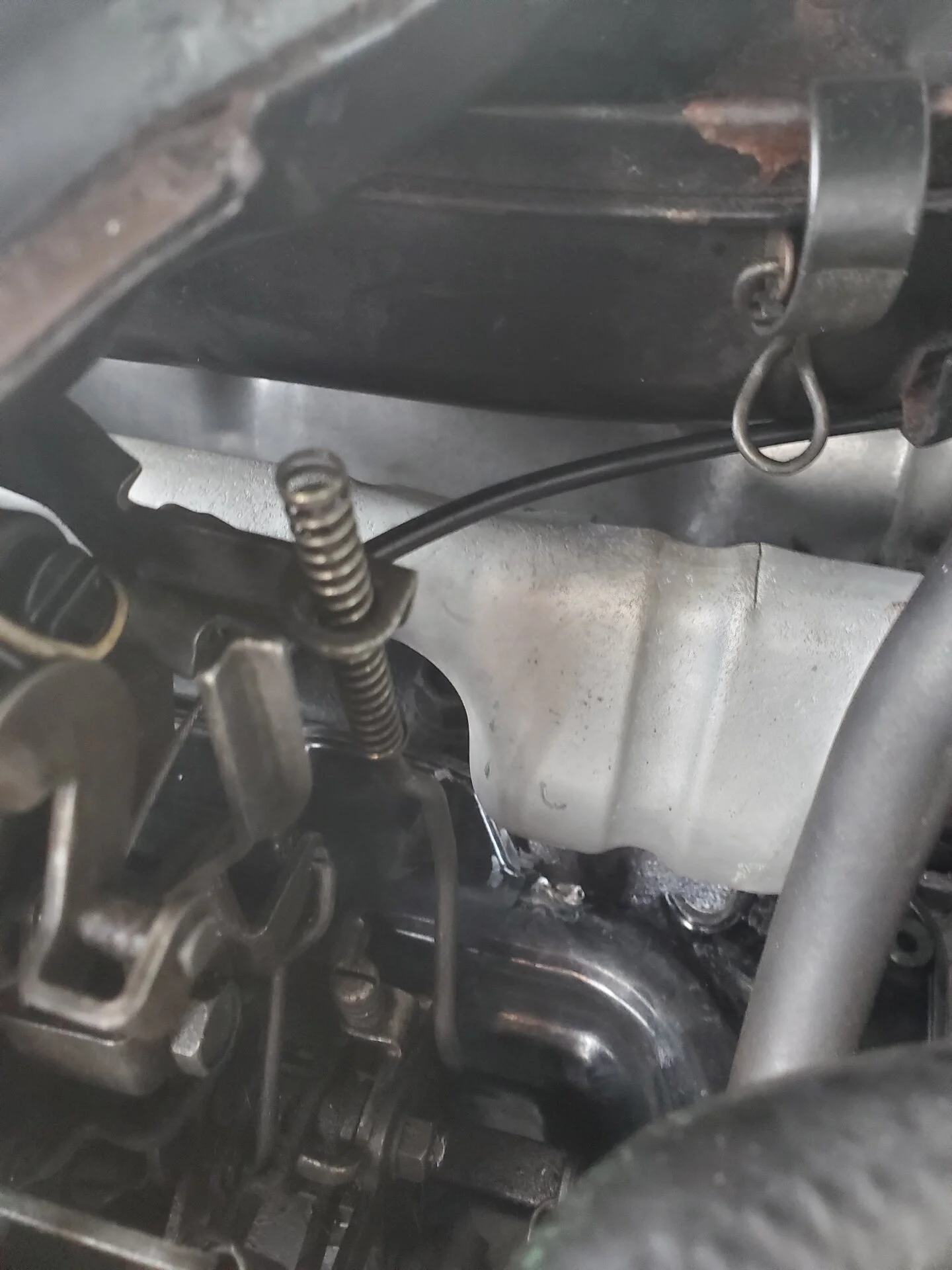

In need of carb for my 85 fj60. Either comple or spring and clip for idle up. I pulled the choke cable and it felt like it got jammed on something and noticed it would idle funny and once I looked closely, the pin was gone and only thing there was the rod out of place and spring.
I would like a rebuildable core but a parts carb is okay also.
Your accelerator pump spring looks to still be there,,
Your missing the plastic bushing,, metal washer and the split pin,,
You should be able to mend that with a trip to your local hardware store,,

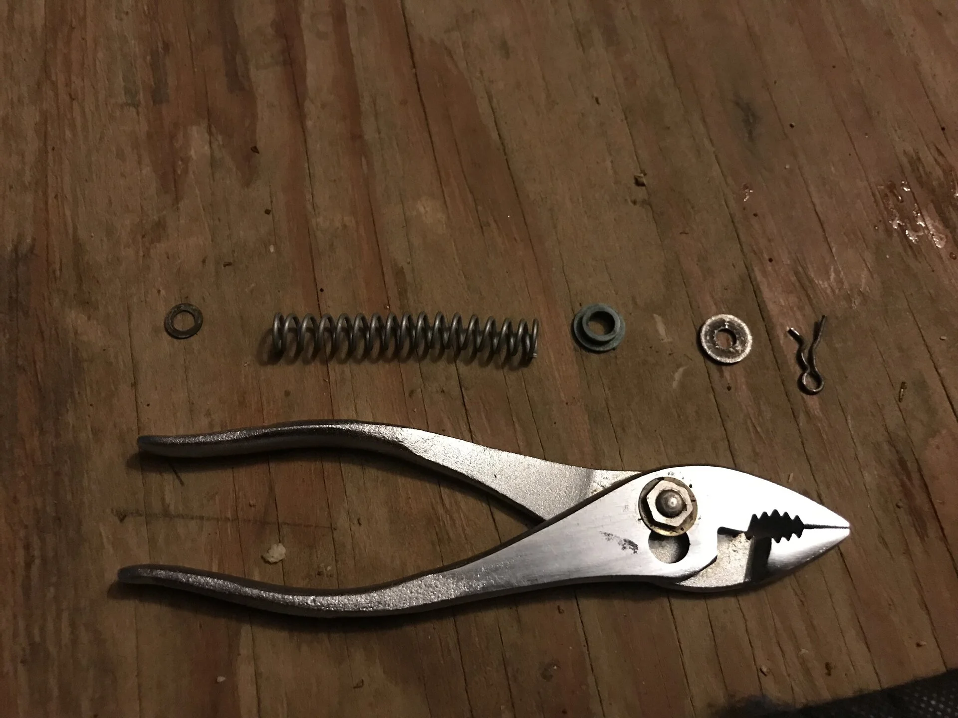

Agreed. In fact, I found the plastic bushings were/are available from McMaster Carr. A fair number of carbs that come in for rebuilding are missing that bushing, so it was worth it for me to buy a bag.
