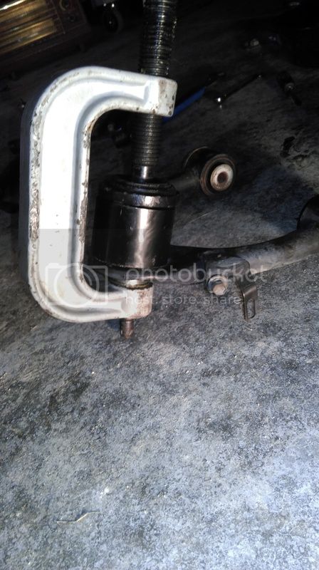

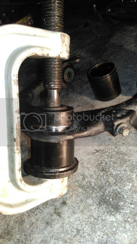

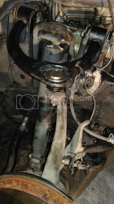

The uppper ball joints are kind of a pain to press in and out, but the job is possible with a little heat, a harbor freight press and a hammer. Replaced mine with the 555.
Removal
Install
Done
