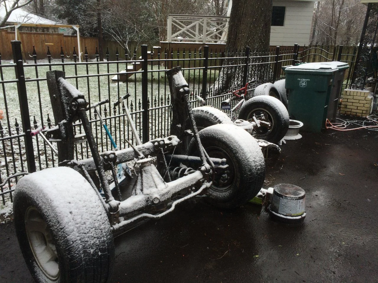

Dusting of snow on the boneyard...
Was wondering how you faired over that way. That death and destruction hit Nashville square between the eyes about 6:30 this morning and hasn't showed any signs of letting up. Its been snowing out our way for about 3 hours now. Got about an inch and a half on the ground here and they are saying 6"+ wouldn't be out of the question for the metro area. Stay toasty.
