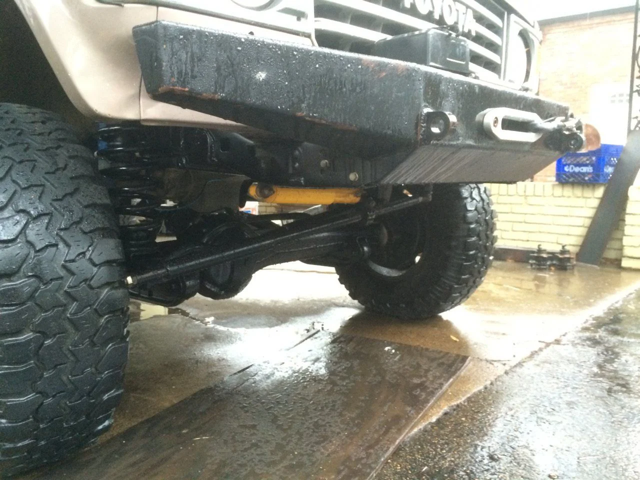

...she's turned around in the carport, ready for her buttock enhancement surgery :bounce::bounce2:
She's not quite a driver yet. I'm waiting on a few replacement steering components and I still need to put the new spindle on.
But, just pulling out of the driveway to turn it around, I could tell how much smoother the front is. No harsh bounce hitting the hard edge where driveway meets the street, just a soft squish.
Steering effort is zero. Between the GM pump, 80 box, better wheel tracking, and lack of caster, it is a one finger deal. I haven't even bled the PS system.
This weekend is looking good to get started on the back :steer:

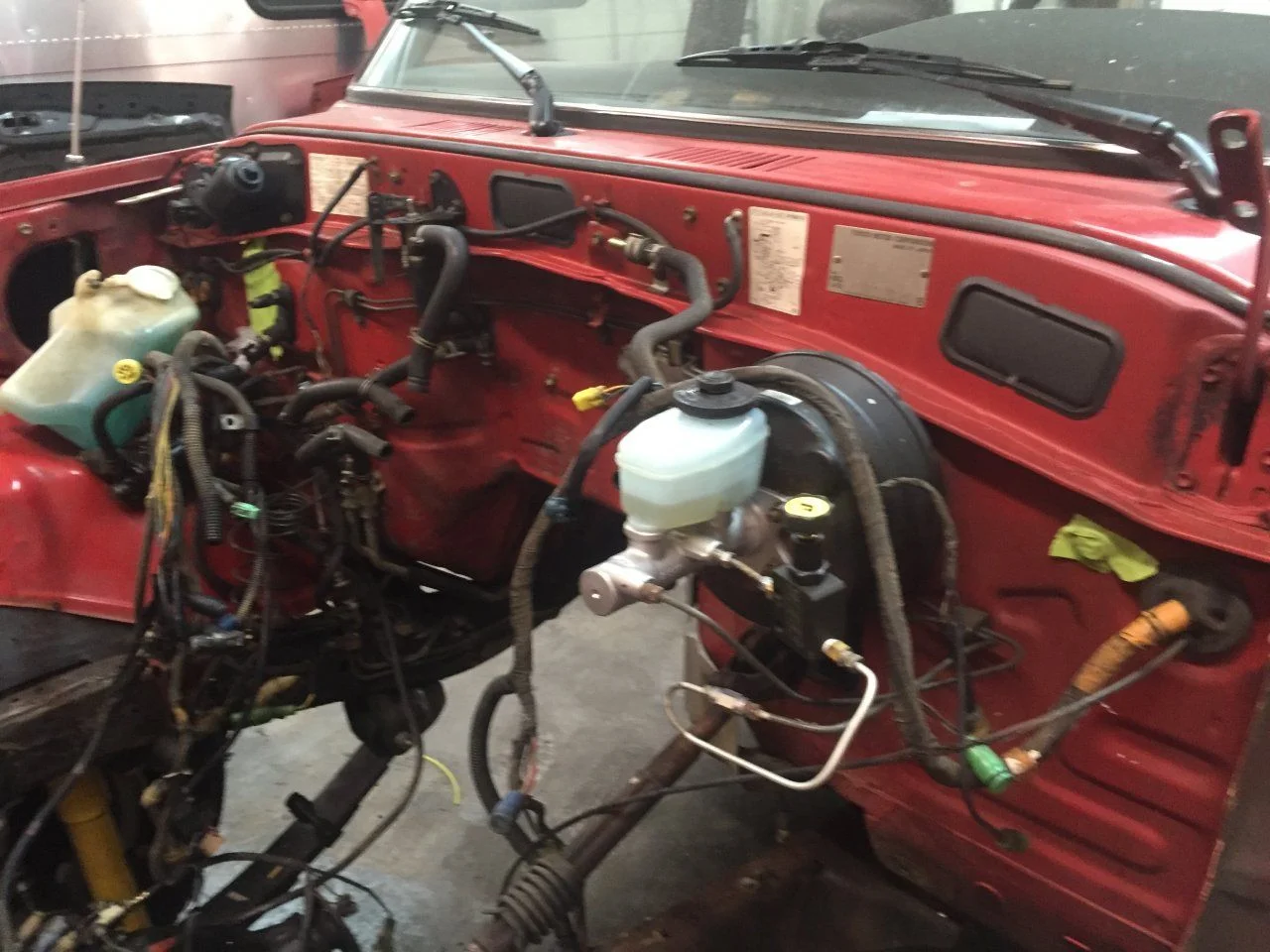

Brake question for the 80 guru's...
I noticed that the 60 has (what I guess) is a proportioning valve separate from the MC, all bolted to the booster.
We grabbed the 80 booster/MC as a single unit and there is no such proportioning valve on there. Is there a separate proportioning valve or is it built into the MC?
This is a '93, so there is no ABS, but I do have the larger brakes up front.

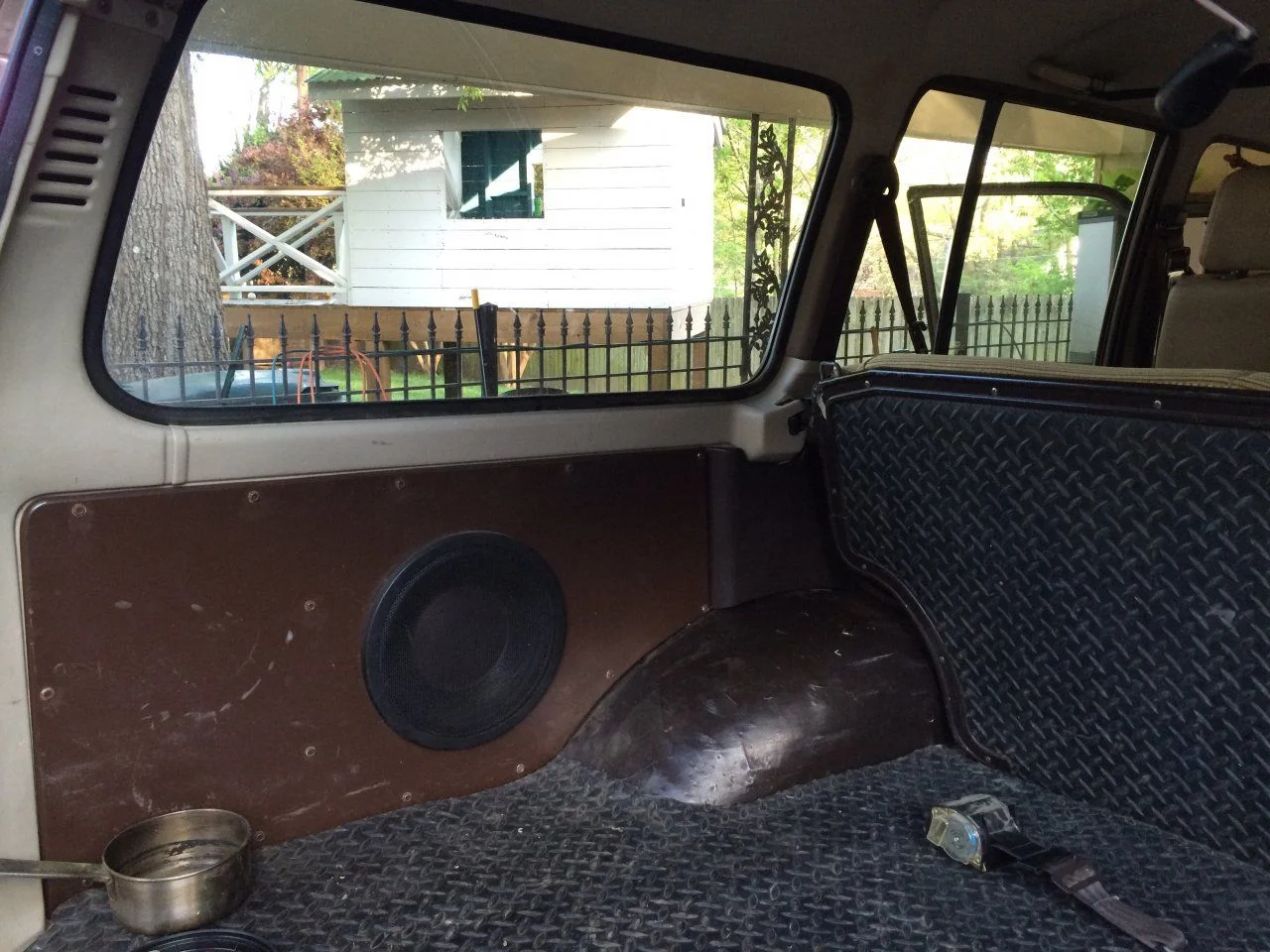

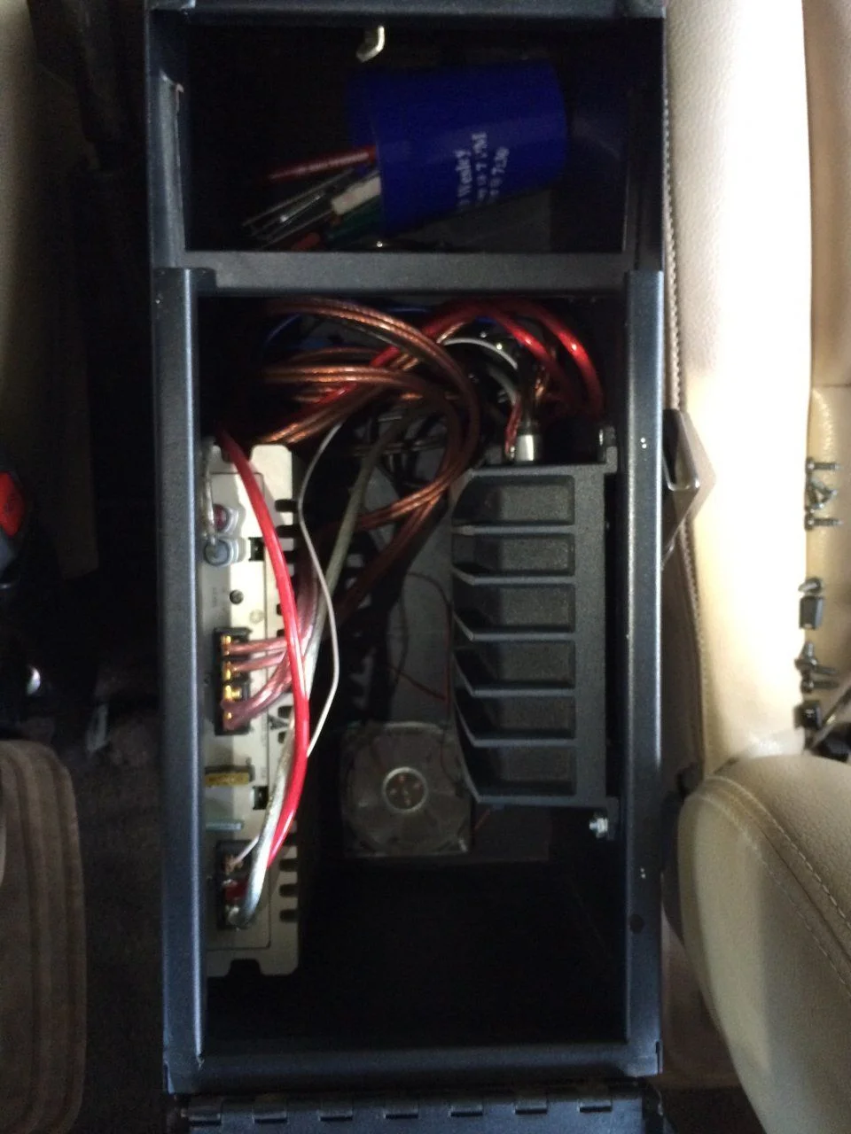

A Honda/Yamaha 2000w generator and a big boom box and you'll vibe your work away in no time. Then be well positioned to provide the NorCal crew with espressos and cappas via your Export. That's what I would do. :D
Andy's gonna love this:grinpimp:
Already got the bump in my trunk:grinpimp:
image-jpg.1060329
image-jpg.1060353
(check out the dope clubhouse in the background. Another Three-6 Hybrids build)
Cool. A friend is doing the 80 FF/tundra disc up front combo that is popular right now. That's what he did...
The 80 has a proportioning valve at the rear for load/brake adjustment. What specifically are you looking for?
I'm not using the LSPV that you are talking about. If there is one, it would be up front somewhere near the MC. It sounds like there isn't one with the 4 wheel disc set up.
