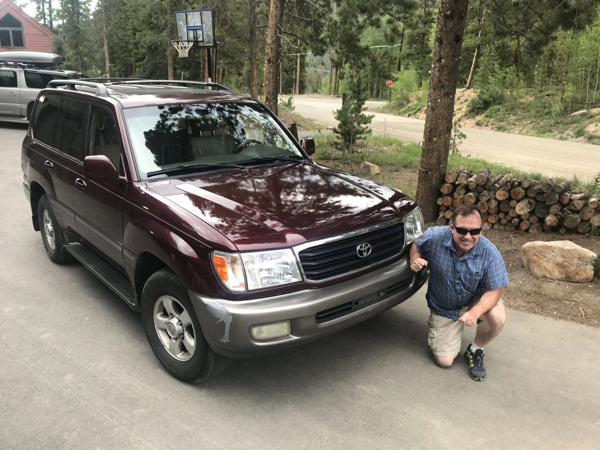

Hi - Newbie here - I've just bought a 2000 LC 100, 180k miles. Its totally standard, been well looked after and does not drop a spot of fluid on the driveway. Main reason for purchase was to be able to access rougher campsites with our pop-up camper - currently using a Yukon XL (which is good for towing but limited ground clearance). The mods I have identified that need done immediately before camping can commence are as follows:
1/ 7 pin electric tow socket (have a kit coming from etrailer) - includes an electronic brake controller
2/ Rear air bags (inside coil) to assist with camper tongue weight
3/ Remove running boards
4/ Replacing heater tees
5/ AT tires - 285/75/16
(Timing belt + water pump were done at 150k so should be good)
I'd like to put in the ubiquitous OME lift but probably down the road when I am feeling more flush....
I'm definitely not building an overland vehicle - the vehicle is a means to an end.... Now you have the background I'd very much appreciate your input re. relevant experience / suggestions. eg Is it necessary to remove the running boards? - much thx
Welcome. I'd browse through the FAQ and spend some time in the pic thread and what have you done this week thread. Those are great places for ideas on maintenance and what others have done with their rigs. As for the running boards, not "necessary" to remove them, most do as an appearance/clearance thing. Drive it as is and see if you need to.

I would leave running boards on for following reasons:
A) act as an early warning system that your rocker panels are in danger. So what if u bang/bend 'em. Bending, unless extreme, won't hurt rps.
B) the step function is much appreciated.
C) RB armor , which u will probably get (especially when u lift...see b above), is heavy. Invest weight in area that will leave u stranded, skid plate/tranny plate, etc.
D!) RB are expensive...see c above.
I see u live in mountaineers area of col, its not if, but when u secum to the "just a little bit more" temptation of more challenge w/r to off-roading (vs over landing).

Not at all. If you have kids or a short wife, keep them on.
Your plan sounds good. Get the 7-pin and airbags setup, throw on some decent tires, and run it. Using it is the best way to find out what “mods” you truly do or do not need.
PS - That’s a great color!
I got the same color! Mahagony Pearl.
A lift is certainly not ‘ubiquitous’, I’d say most folks run stock suspension and have plenty of capability with the larger 33” tires (285/75R16) and dialing in the front torsion bars.
And between my kids and <5’ wife my running boards are still on.
BTW, my wife says “he looks really happy” in your pic.

Looks like a nice setup!
If you're towing a trailer, thats the limitation as it stands. The cruiser will go just about anywhere out here stock that you need it to with some decent ATs.
There's a number of local land cruiser folks in breck with 100s that would also be thrilled to let you walk around their setups for ideas.
Keep up on fluids, maybe consider spraying a rust inhibitor underneath now that cdot is spraying mag chloride with how much traffic we have these days.
It will run for a long time, congrats on the purchase!
If you don't plan to do some serious off-roading no need to remove the running boards. You are already gaining about 3" ground clearance moving up from the Yukon XL to the Land Cruiser with 33" tires, if you notice that you are starting to run trails where they are becoming a nuisance that's your sign to consider removing them and where that lift you are considering would be a nice upgrade as well.
Thx for all the suggestions - sincerely appreciated. Yes I am v happy with the cruiser (unmolested). The - 'do the minimum philosophy and then use it' is definitely a good way to go. That’s good news about leaving the running boards - I like 'em and they will protect the bodywork. The tires will give me a wee lift - hadn't thought about that. Fluid change of the gbox/diffs is a good idea for sure.
