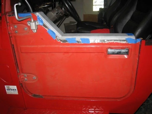

camcruisers half door writeup
a few more

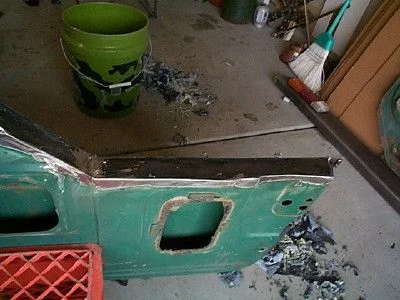

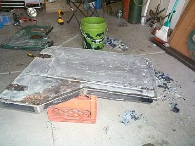

you can see im in the process of stripping the doors, preping for the paint and hurculiner
im thinking of welding an oh**** bar on the passenger side for the wifey, she gets nervous easy
is there anyone out there that could bend me one????

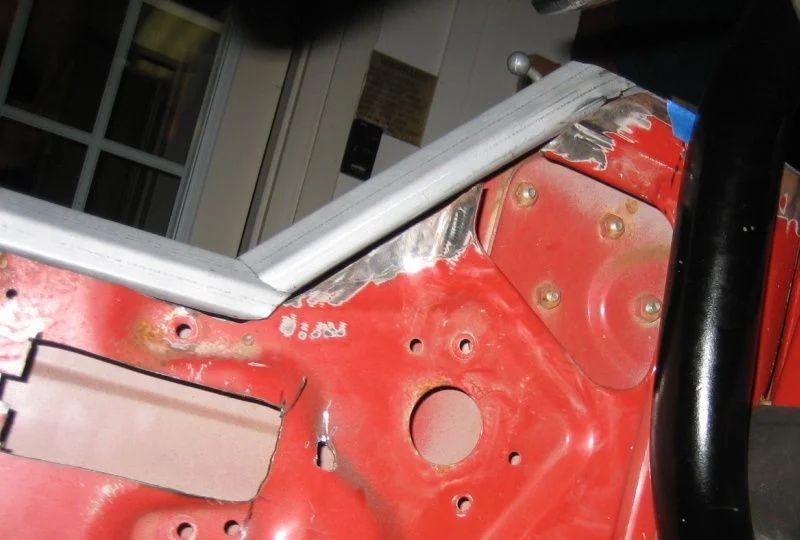

I followed my old kayline soft door profile. As for the back-side edge, I just concentrated the heat on the overlap while welding and the excess cut itself off.

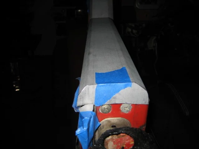

I've got a thread going on for late model doors, but the sheet metal shop took forever (2.5 mths) to get the bent 16 gauge back to me...but hey they only charged me 10 bucks for 3 8ft sections :D
So thought I post a few pics here since its a more active thread.
Here are some pics...just need to get them welded up...
As you can see, I had them bent to fit flush on the outside and left a 1/2" lip on the interior to account for the varied thickness of the panel. This will also allow a door panel to fit nicely. Notice that the radius is different on the IN/EXT...this was to try and mimic the factory lines at the window. Overkill, yeah but what the hell...
PM if you have late model doors and want more info on the profile I used for the bends on the sheet
--todd

Here's a thought that I might try when I get around to it...
Why not use the top of the door itself? When you cut it off, how about using the top piece-with a small insert where the window used to go through-to weld back to the top?
i wish i had late model doors but these are starting to look nice

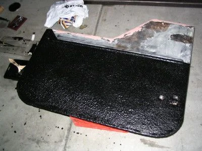

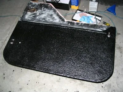

here they are hurculined last night, killed a few brain cells out in the garage, will be preppin for paint this weekend.
