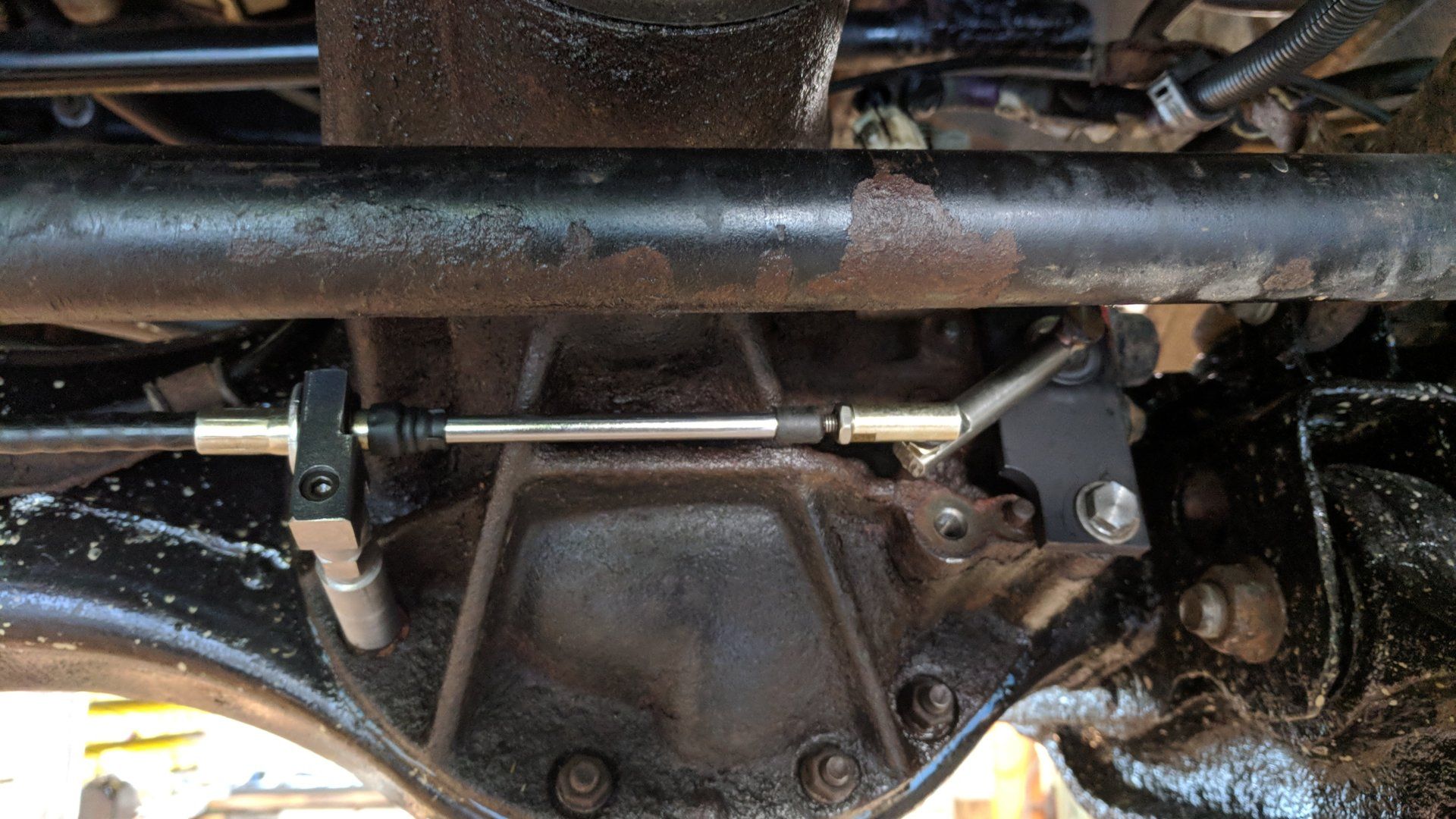

The front locker assembly looks like this at the differential............Please excuse my crusty, greasy test bed of an fj. Its not the cleanest but is my fav:
As you can see, there is a flanged assembly which replaces the factory unit. It allows the installation of the original gear and uses existing mount points. The cable holder is solid bar stock which is threaded and replaces the factory 3rd member nut in that location and acts as a standoff for the cable. The first draft of this had the cable mounting point welded to the end, this didn't work out because it required shimming the bottom with washers until the end was facing the right way once proper torque was hit...no bueno. The end of the standoff is now threaded and the cable holder can be fitted after the fact in any orientation. (see inset socket bolt)
In this photo you see the unit in the fully LOCKED position. The actuator rod requires exactly 3" of swing to operate and the cable has exactly 3" of travel. This setup doesnt move the internal parts "good enough" into lock and "good enough" out of engagement, it uses ALL of the factory travel for FULL-in and FULL-out. You will also notice that the standoff rod is machined for a 13mm hex to aid in tightening it to the 3rd. It may also be hard to see but the setup is designed to run within 1/8" of the 3rd, it hugs nice and close.

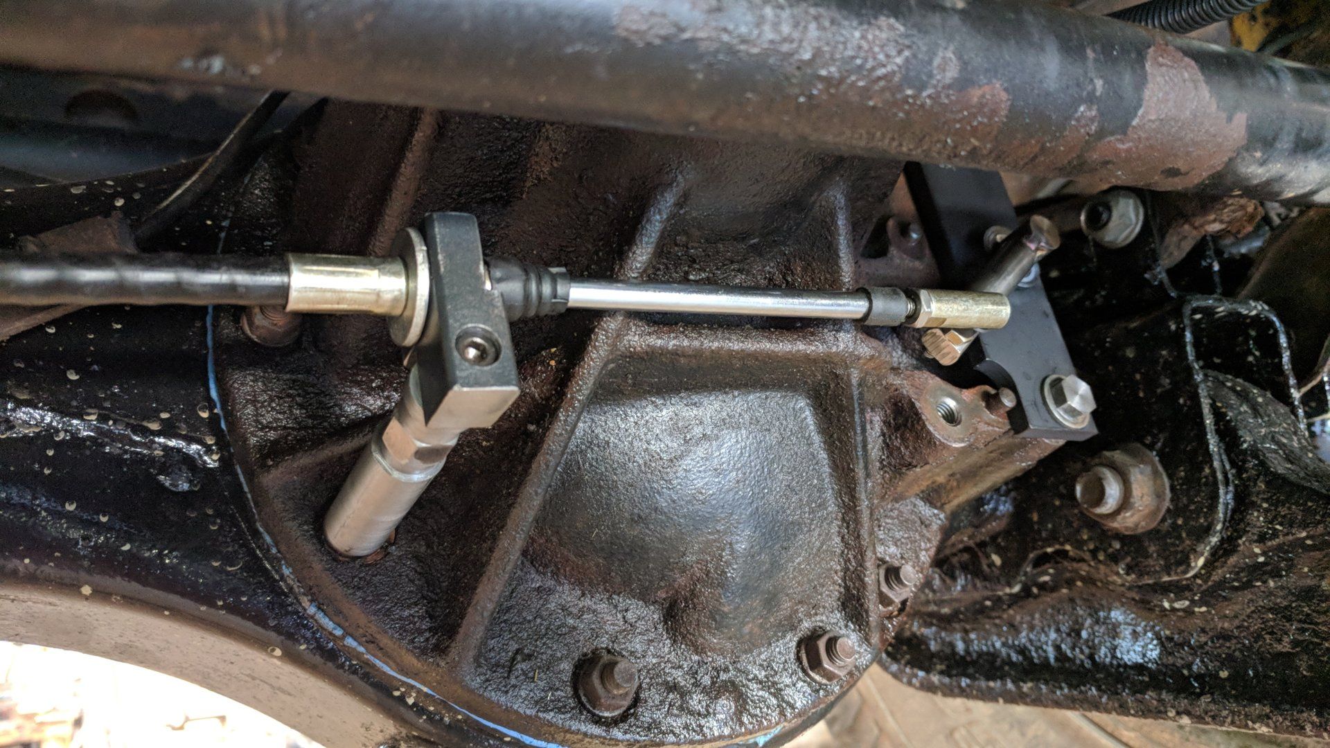

Some may ask why the bottom mount. I chose it because it worked better to be honest. The cable is out of the way and has a much more graceful slack for allowing suspension movement than what i was able to get on the top, and despite first impressions, it is actually pretty well protected by the bottom of the axle and the tie rod. If you are like me and avoid dragging your pinion and tie rod over obstacles, it should be no issue.
Fully unlocked. Not much else to see here. I neglected to take pics of the actuator off the vehicle but I will also add that the unit is o-ring sealed like the factory unit and also features an o-ring seal on the shaft itself for no leakage. I will get pics of the actuator on the bench and also pics of the cable routing.

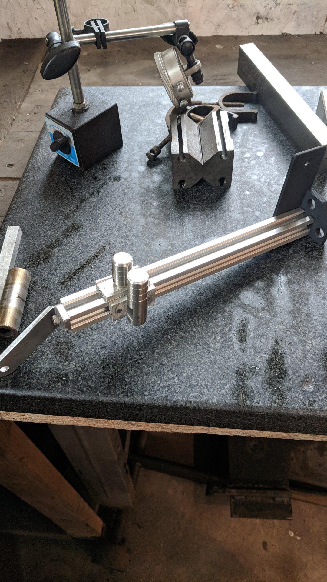

Here is the cabin control assembly:
I forgot to mention - please forgive a few things that may stand out, this is purely a working prototype and finish units will be a tad better and different, however all these parts pictured will be staying on my truck ;)
So I decided to go with an extruded aluminum rail with sliding levers. Not only is it easier than my other plan but it allows for 3 sliders to operate 3 cables all in one compact linear arrangement. Shown pictured is with just 2, and either cable can be run to either hole depending on which locker you prefer in which position. I also have made the sliders adjustable for wear but well see if that particular feature gets done for produced units. Also this assembly as well as the actuator contain a lot of stainless parts (because i have it laying around) these will probably be mostly replaced with aluminum.

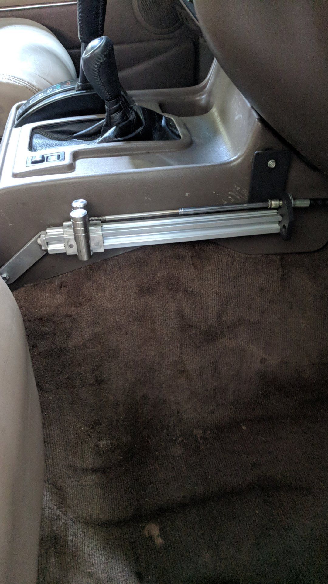

Here it is in the truck:
If you can pry your eyes from the filthy floor you can see that it not only mounts to factory points for the console it also does not interfere with any other controls and also is well away from the legs of any passengers ( tested true ). Quite a few things need minor refinement but as I said this is still a working prototype. At this point all of the major development has been sorted. I know where things need to go and what dimensions it all needs to be.

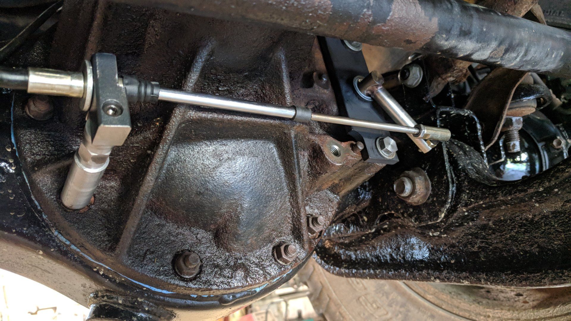

I also had time to move back up front today. Discovered to my amazement that it almost required nothing to make top mount fitment possible with existing parts. The only thing required was this difference in cable mount adapter shown below. Small adapter for bottom, slightly longer adapter for top mount. I will be making another small adjustment in the morning to perfect the angle of the dangle.
Here it is both engaged and disengaged.
