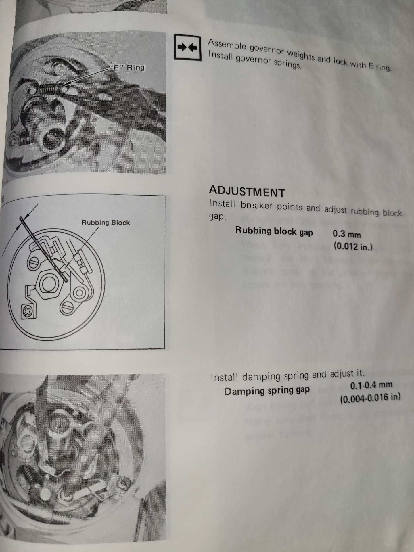

With a points system , The first thing I check when it starts misbehaving is the points, especially if the points have been there for some time. Over time the gap gets smaller and eventually closes completely, and the engine runs erratically or not at all. It takes 5 mins to check the gap. Apologies if you already checked the points. I hate points personally.

I’d start by replacing the points and condenser. They can be set with feeler a gauge or Dwell meter.
