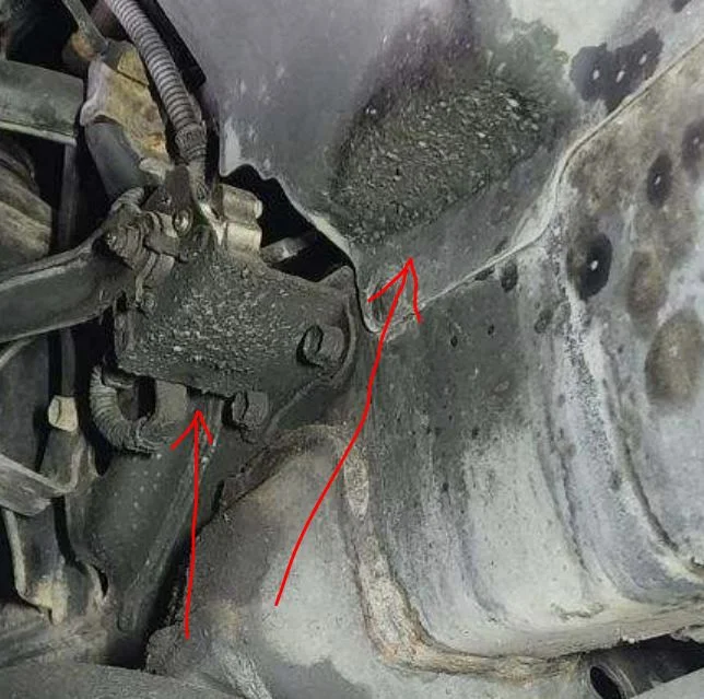

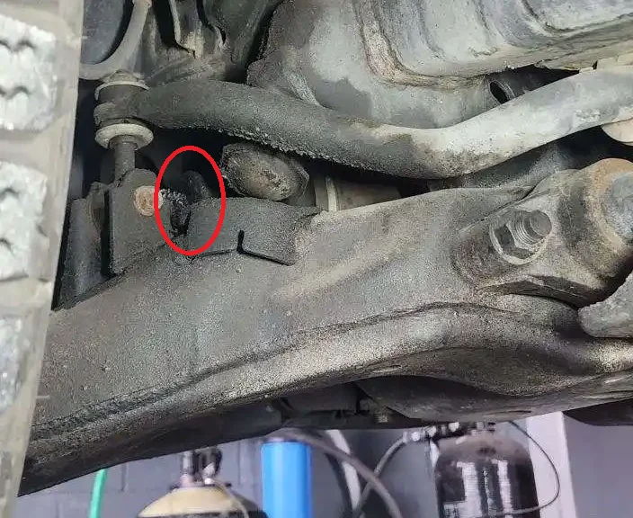

Hi all, I am looking to get back an LC100, and have found one to buy that interests me. The issue I see, is on one of the photos of the underbody the suspension arm has what looks like oil leaking.
Any thoughts what could be the cause of this?
- Brake fluid leaking?
- Front seal cover need replacing?
- CV boot punctured and leaking stuff out?
- power steering fluid leaking?
Thanks
Looks like old grease from a leaking CV axle. Can’t tell from the pic if the axle is leaking now or not.
I would guess CV boot as well. I think you can even see the boot with some greenish speckles of grease. Check both the inboard and outboard boot on the CVs for rips/tears/holes.

My guess as well. needs to come from the bottom to reach the area pointed to in red. If it's broke I think it's a $600-700 OEM part or if not broke it needs a reboot.
I checked the VIN on Toyota for service history and 80K miles ago, the Toyota service techs told the prior owner that they needed to replace the CV axles as the boots were leaking. But it looks like the owner did not replace it as there were two service reports at different mileage dates with the same warning, so I think you guys are onto something.

I took it to a mechanic who knew the LCs and they analyzed it and the picture above was indeed a leaking CV boot, the mechanic suggested I just buy a new CV axle instead of repairing just the boots as the thing is over 160k, he mention the diff seals should be fine. He also mention the Wheel Bearings were aging and should be replaced for a smoother ride, and also get a fresh set of Shocks on front and rear while at it repairing the CVs, as they are starting to age at 160k.

Don't use that mechanic:
  1. FDS (AKA CV) boots, likely just needs re-clamp, unless boot torn. Which by amount of grease I see, is just a weep from lose clamp. If replacing FDS, replace the side diff seals, is best practice. Replace with only OEM FDS.
  2. This is a AHC system, based on AHC front height sensor in pictures. So is a 06-07 LC. So these are not shocks. They're hydraulic rams (AKA shocks), only need replacing if leaking to point of dripping on ground.
  3. To say wheel bearings worn-out need replaced and will give smoother. Can't be determined without removing bearings and inspecting them. They also have little to do with smoother ride feel. To state loose wheel bearings and need repacking, can be inspected for, with wheels on.
