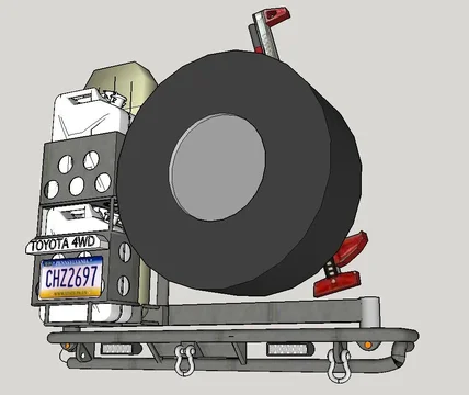

Rear bumper design....
How bad would it be to block the rear passenger side door upper glass? I don't mind driving the 100 series with all our gear in the back and not being able to see anything. But how about on a RHD vehicle? Checking that blind spot a bit more important?
Here's my preliminary design for the PS swing out. Holds 2 jerry cans, plus my TRED traction devices. Trying to make it look good when just one jerry can which would be 90% of the time.
Thoughts and advice appreciated! Witty banter accepted as well :)

Gentlemen,
As Jason and I are finishing up the design for the rear bumper, a have a few more dimensional requests if anyone could oblige me:
Also, any comments or criticisms on the design would be welcome. The top jerry can holder is modular, bolts into place when needed. Most travel will be with just a single can, but for long trips will have 2 cars (one water, one diesel), and the TRED mats. Main concern now is fitting everything and making sure the door handle is accessible!
Thanks!
Measurements approximate.

The DS spare tire arm will be on a standard arm with locking mechanism. The PS jerry can holder will be tied into the rear door. Here is what it will look like in standard "normal" driving:
We'll have to see how much of the taillights are blocked by the swing arm and hi lift jack. You can see the little TS indicators just below the swing arm. Might need to make those more substantial like your Kaymar.
My drawing isn't to exact scale. The spare is a 33". The jerry can is properly sized. And the black rear doors are based off of @cruiserdan super helpful measurements provided earlier today.
Is all of the extra weight supported by the door itself or the new bumper?
