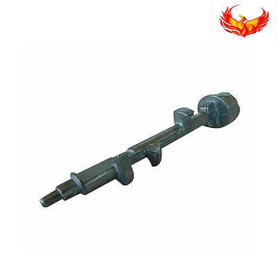

@fussychicken Thank you for the effort here! I'd also really like to know the decoder because parts take a long time to arrive and I want to order a backup for my 2003 LX470 but don't know which rod to order.
What I can contribute is that this eBay seller (see link below and image pasted here) claims the difference between rod number 7853A and 7850B is that 7853A is for power adjust steering wheels and 7850B is for manual adjust steering wheels. I messaged the seller a while ago to see if they knew exact rod for my truck and they didn't, they suggested taking it apart to see what's stamped on it. But maybe A is for power adjust steering wheels and B for manual adjust steering wheels.
Fits 98-02 LX 470 /Land Cruiser A/Tilt Ignition Lock Cylinder Barrel Rod #7853A | eBay - https://www.ebay.com/itm/363292362697?mkcid=16&mkevt=1&mkrid=711-127632-2357-0&ssspo=-v9vlrzdS-O&sssrc=2047675&ssuid=&widget_ver=artemis&media=COPY

Another eBay listing here for a "B" part saying it's only suitable for vehicles with "manually adjustable steering" so another hint that "A" may be for automatic adjustable steering wheels, "B" for manual.
