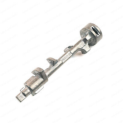

Did you ever find our which one you needed? I have the exact same problem, and 7853B on the broken shaft.
if anyone can let me know where i can buy 7853a....other than rip off lexus dealer.....will be appreciated. attached pic for broken rod.

It appears the replacement rods are beefier in the key locations. Is there a model year that the better rods were installed from the factory or is this a weak spot in all from 98 to 07?
