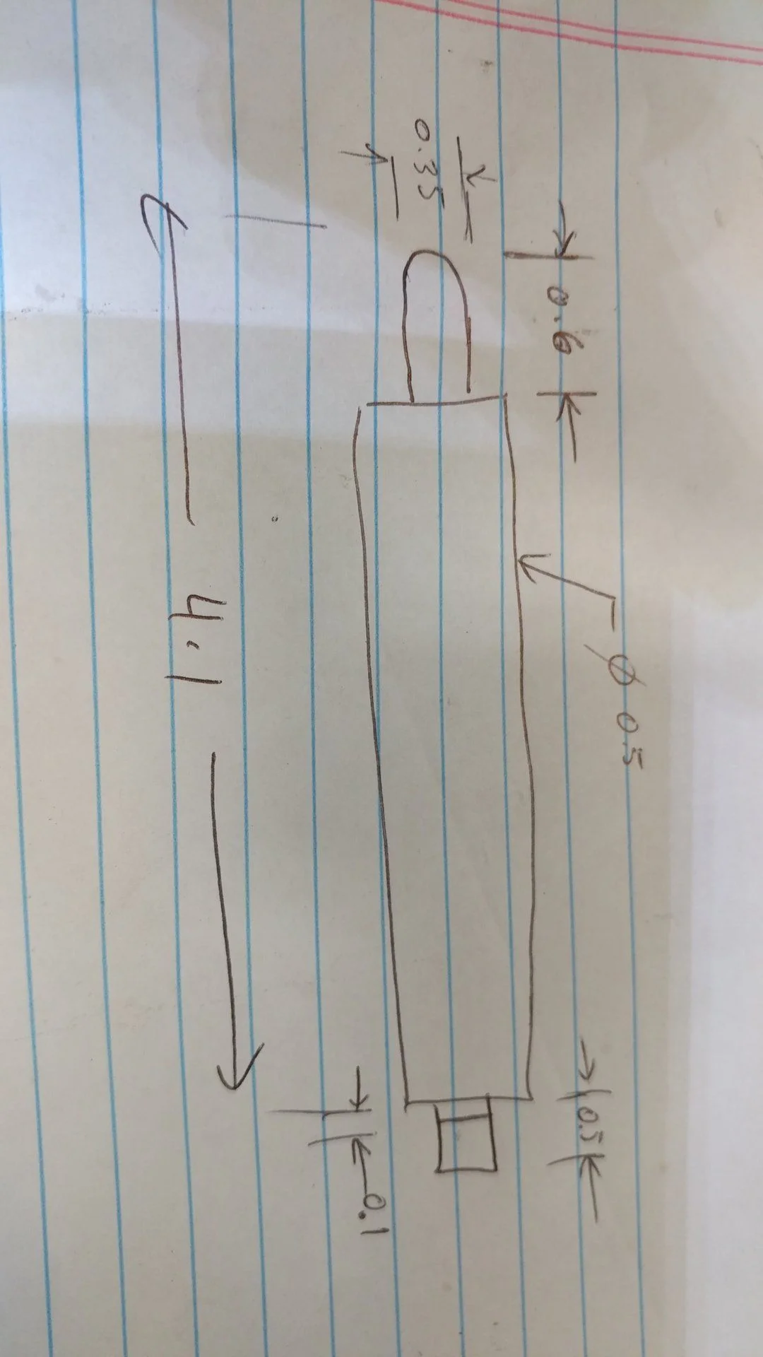

Rough drawing, very rough, and the ends have to be 90° from each other. 4.1" from the wide tab end to the bearing surface at the bottom end, 4.6" overall length. And what is that white connector?? Decided it was not used.
