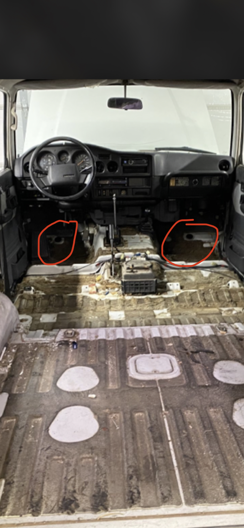

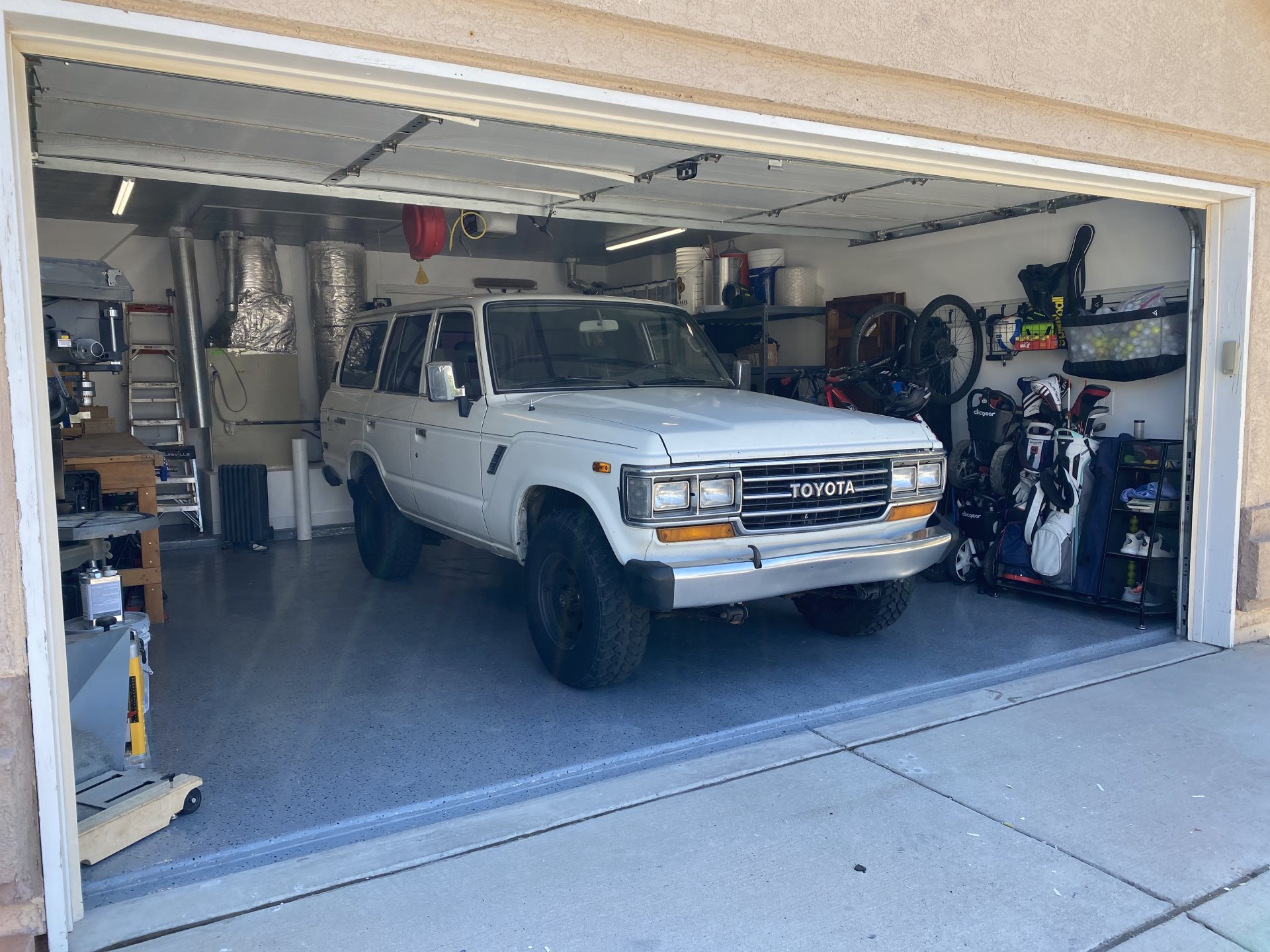

Big day for me personally, a project truck and a organized garage to put it in has been on my list for better part of 15 years.
Let’s start the tear down next

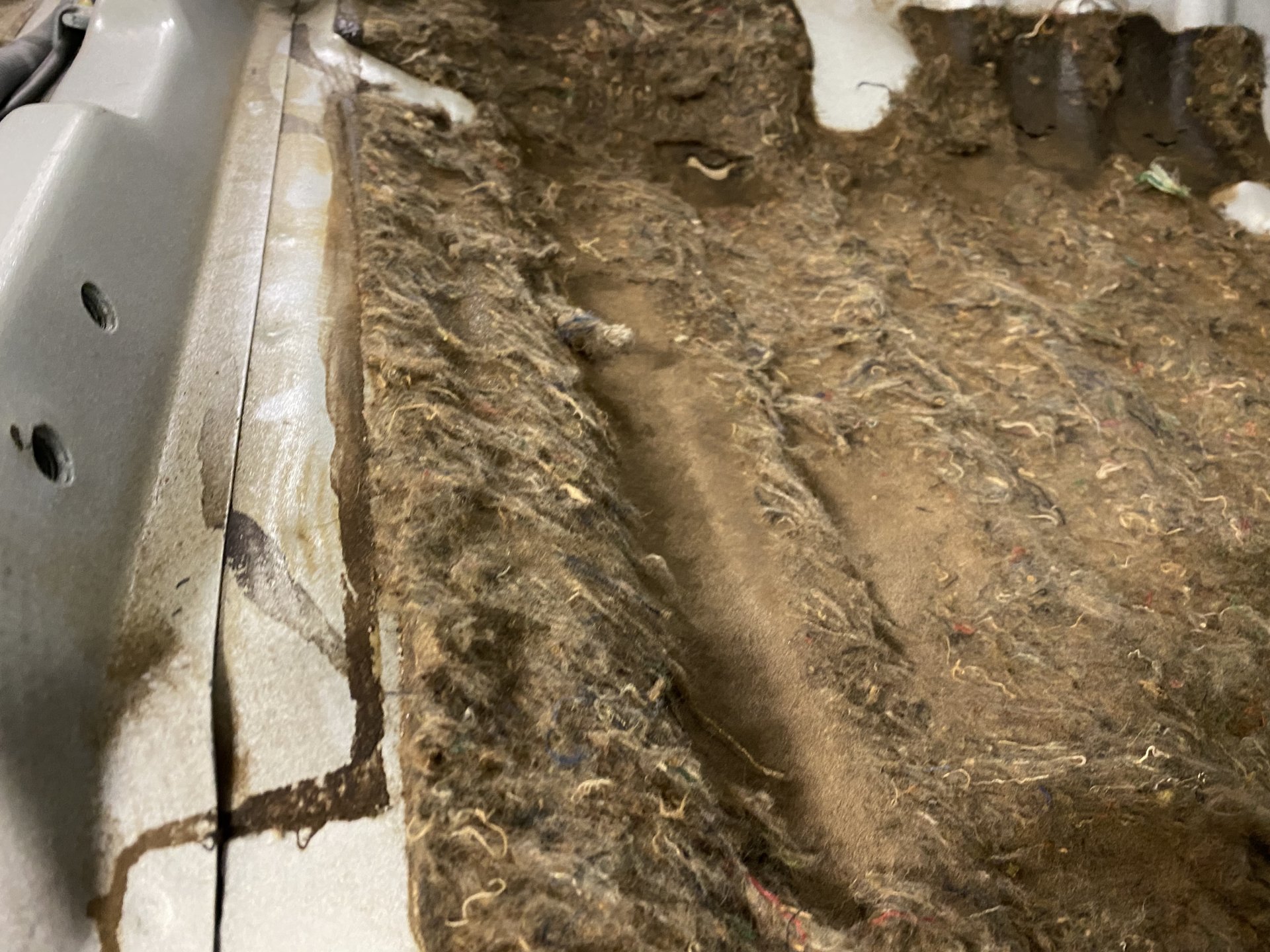

Congrats on the start of your build! Something to be aware of, the body will rust underneath that stuff and form bubbles in the underlayment. If you see any of that you may just want to remove it all, treat the rust then apply your sound deadener of choice.
This was my approach just to be sure of what was underneath. Dry ice. Dry ice. Dry ice.
I used about 50 or 60 pounds to do the entire truck
Same here, just under 50 lbs for the whole truck. Make sure to get dry ice pellets too. A local welding supply had it for $1.25/lb. The pellets are cheaper and easier to work with. I scooped a couple of lbs into a garbage bag so it’s easy to move around and lasts longer. Also helps to have a shop vac to get all the little pieces of material that chip off and fly everywhere. Once the material gets cold enough you’ll hear it popping then it chips off pretty easy. Just do it in little sections starting in the cargo area and vacuum as you go. Really it’s not too bad just time consuming.
You can also buy freeze spray, which is pricier but reusable over multiple times. I used the freeze spray method, and worked great.

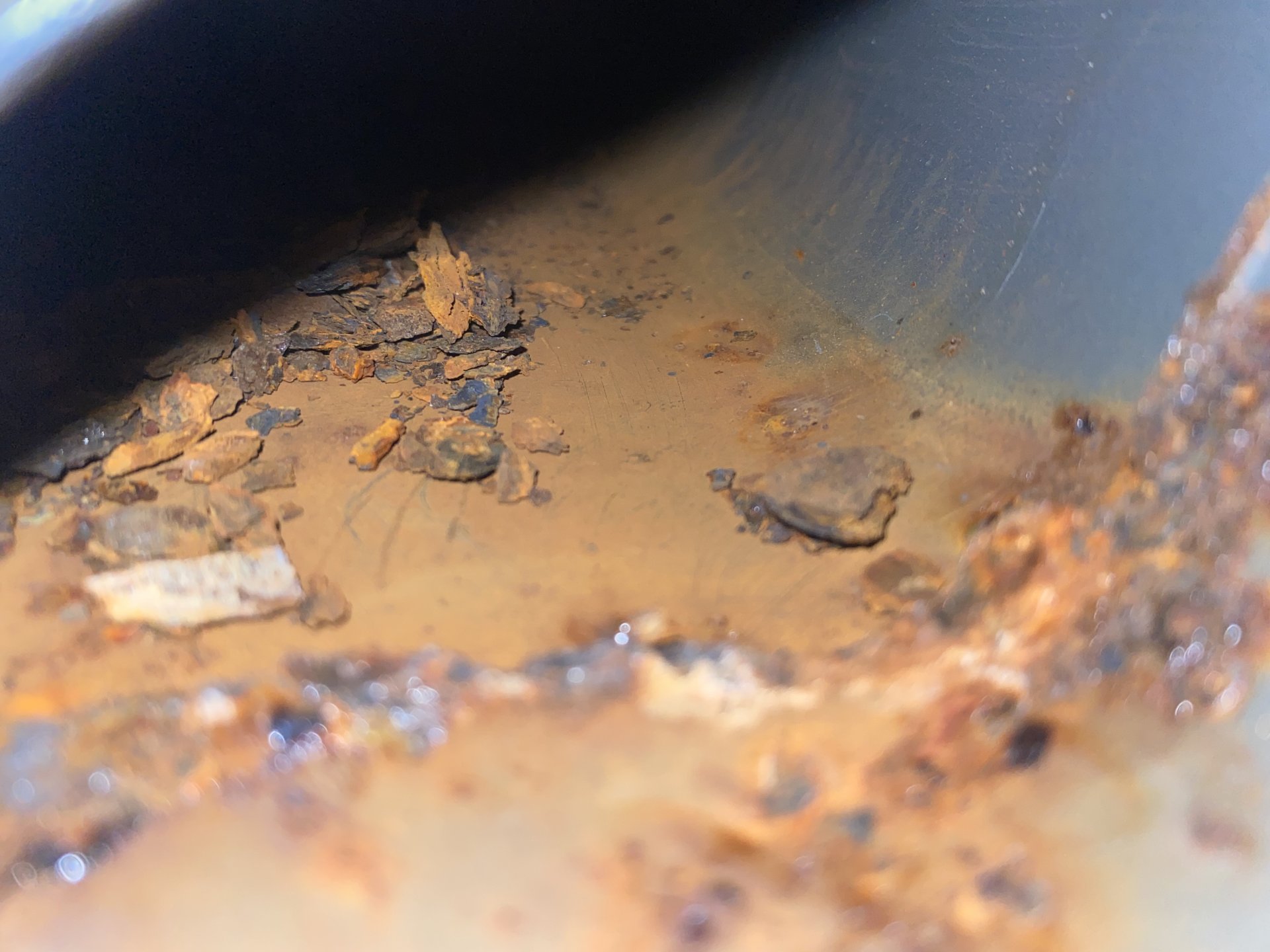

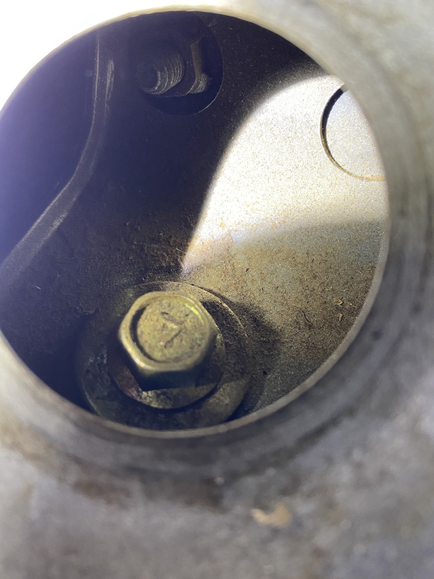

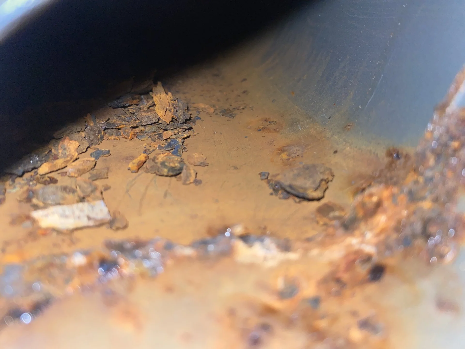

Also check for rust behind these covers. There’s a body mount in there that can rust out if you’re not careful. I found some flaky rust on my otherwise rust free CA/AZ 60 hiding in there.
Great point. I found similar rust on mine under these caps, mostly pass. side. I had wet carpet there intermittently and finally noticed the rust stain draining from this cap. It's a very hidden rust area on these trucks. Any idea from where and how it collects water??
Need to scrape it out vacuum it out and fill it full of CorrosionX or something similar.
