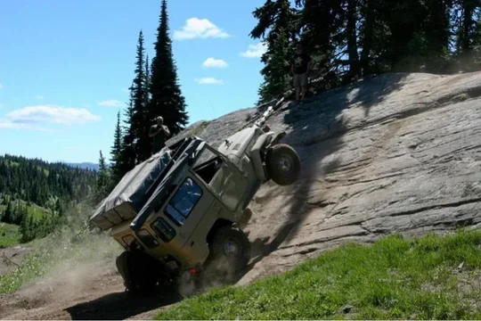

Here is one from the Whipsaw trail. I didn't have enough rpm and stalled it. I did the bypass after the wheelie. I'm pretty sure I could have made it up with a little more RPM but I didn't want to stall higher up and come back down at speed. Ratpuke (in blue standing in the background) got a good picture from the other side.

Great poster shot! Just a little more weight in that roof rack and ... :hhmm::D

Nice Kevin! Time for a 13bt, eh? Bit more torque :-) did you whack your spare?
Did not bend anything AFAIK
