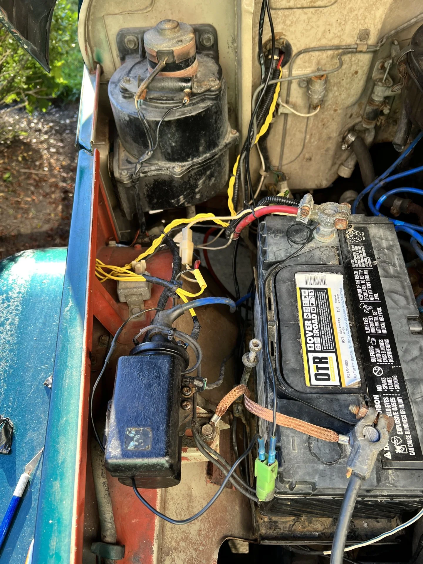

Might try to sort out all these wires this weekend. The yellow ones lead to a switch under the glovebox that from what I can tell does nothing. There is also an aftermarket alarm installed that I think will be going.

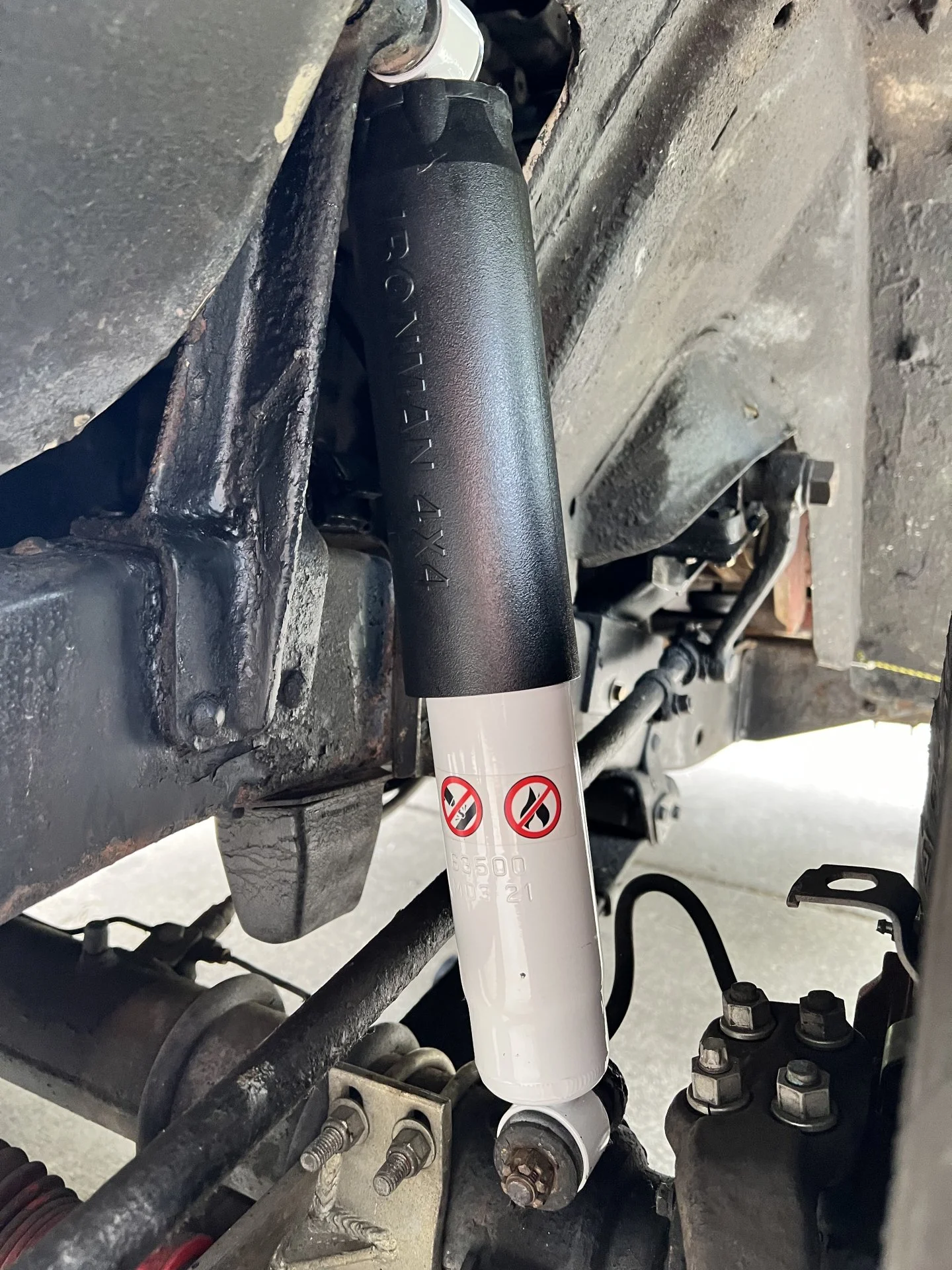

New front shocks today. When I got the old ones off I found they didn’t even expand after being compressed. I knew they were bad but wow. Rear ones will go in tomorrow.

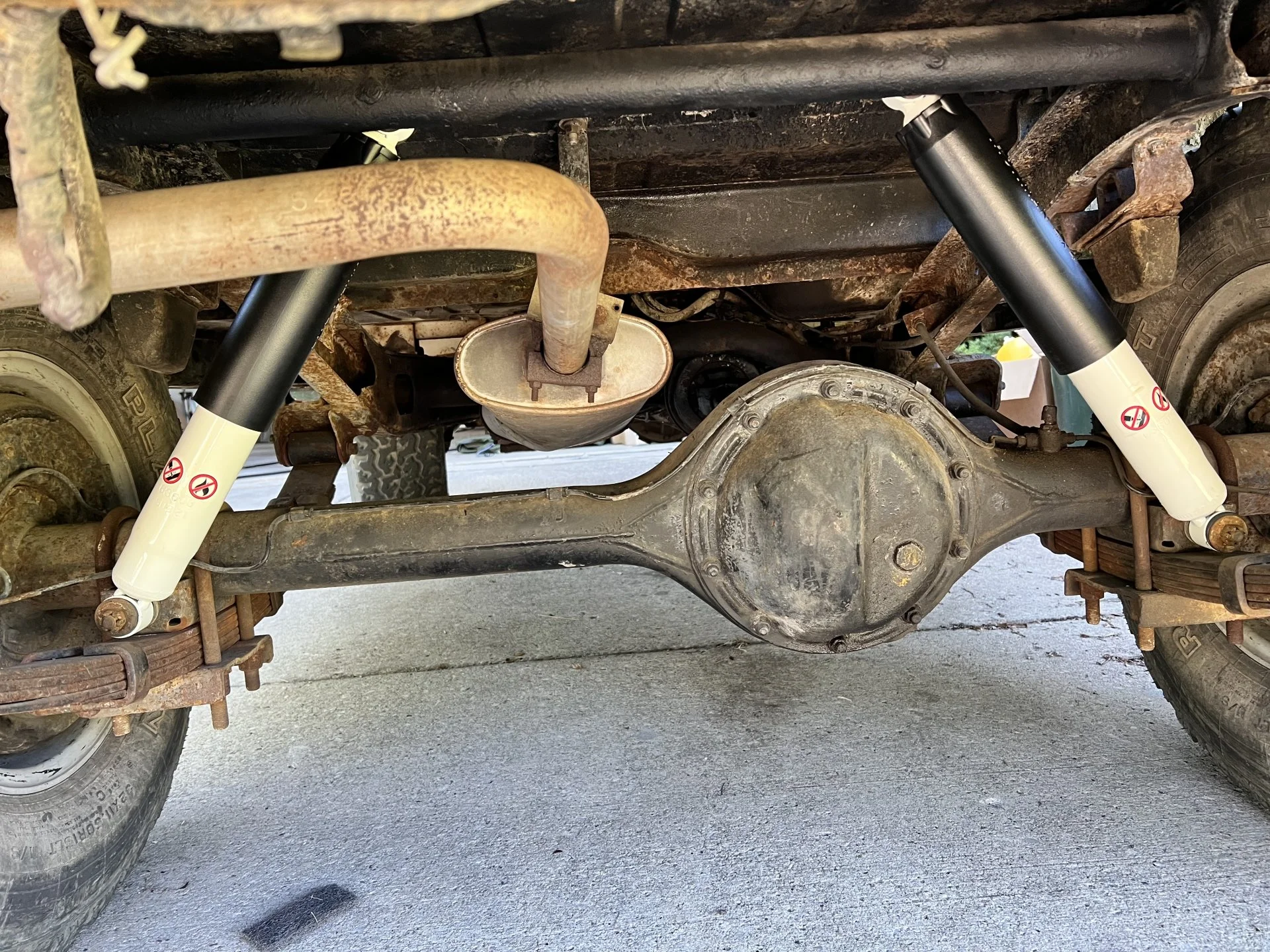

Finished up the rear shocks this morning and the ride is night and day. I knew they needed replacing but didn’t know they were completely shot.

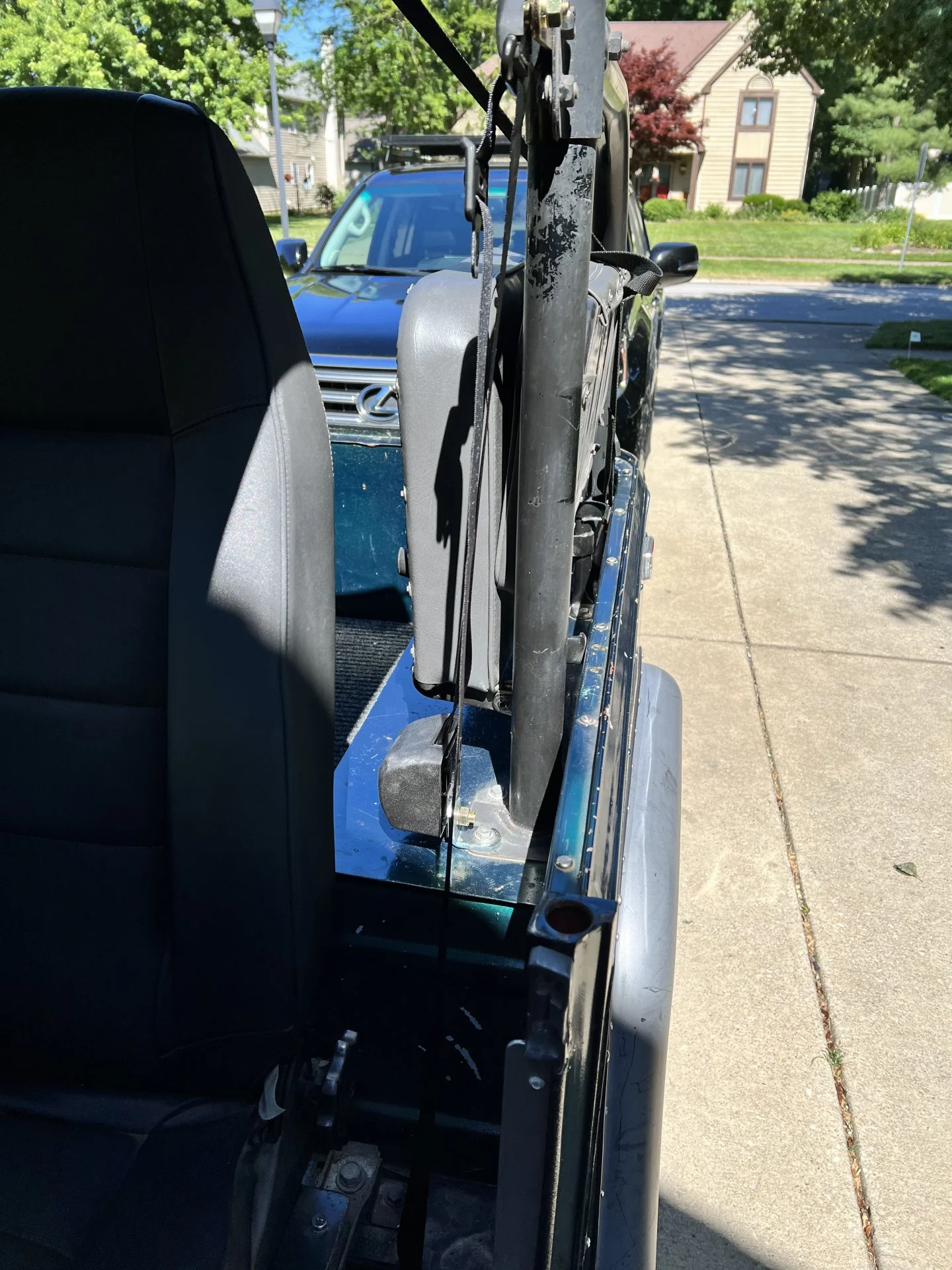

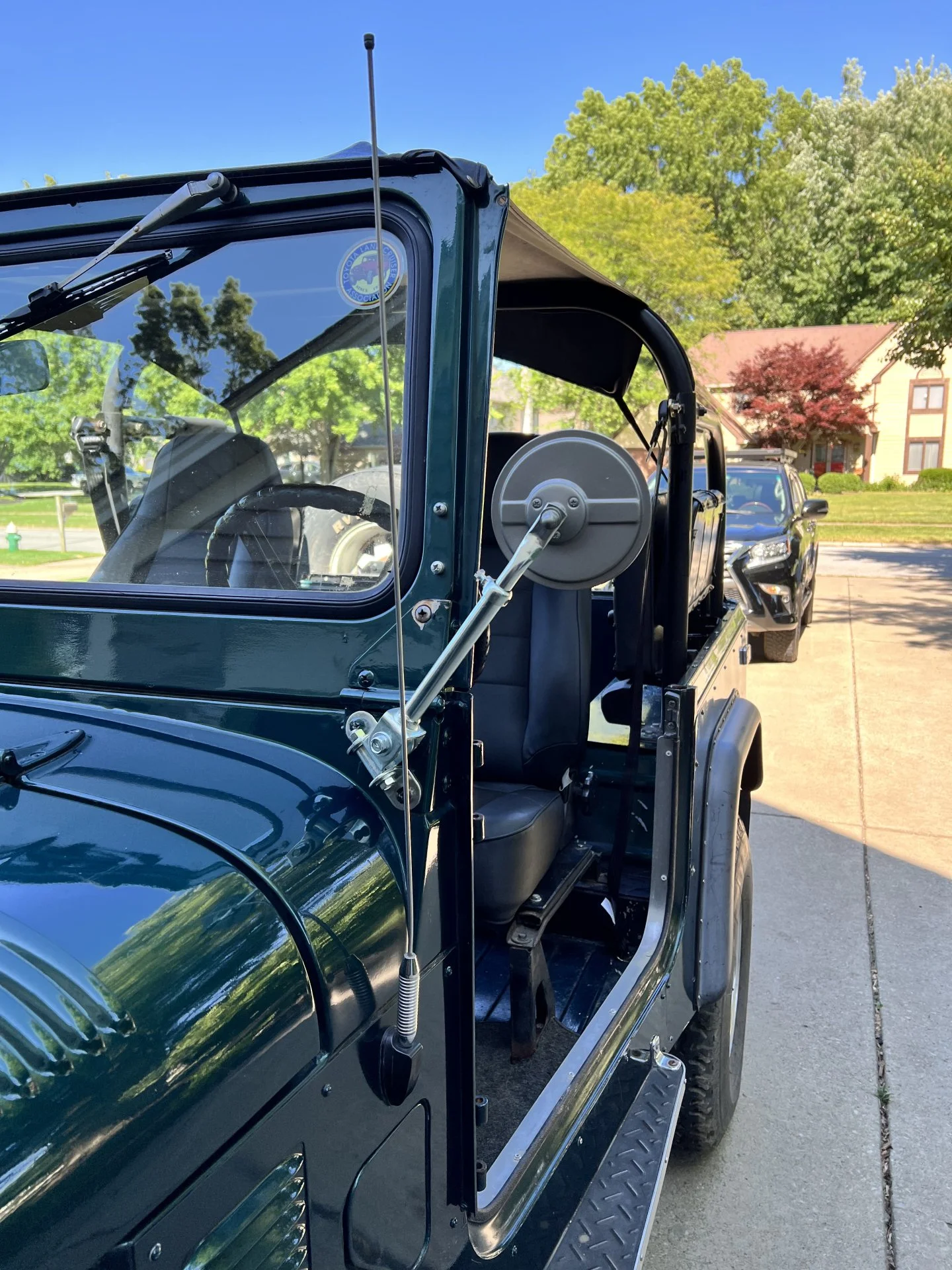

Added some mirrors so I can sort of see what’s going on behind me.
And didn’t snap a photo but removed a lot of useless wiring. There was an old alarm system plus random wiring everywhere

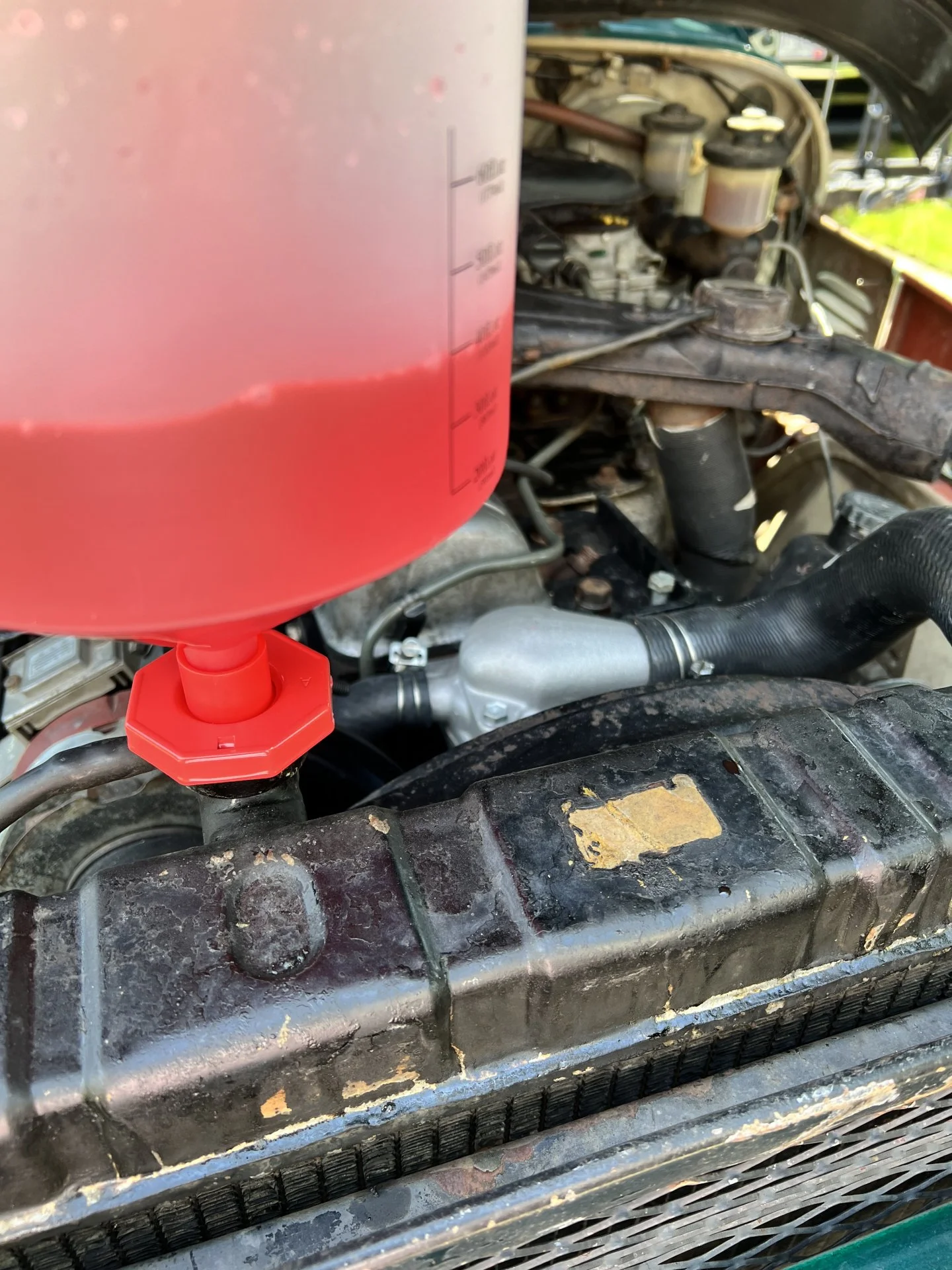

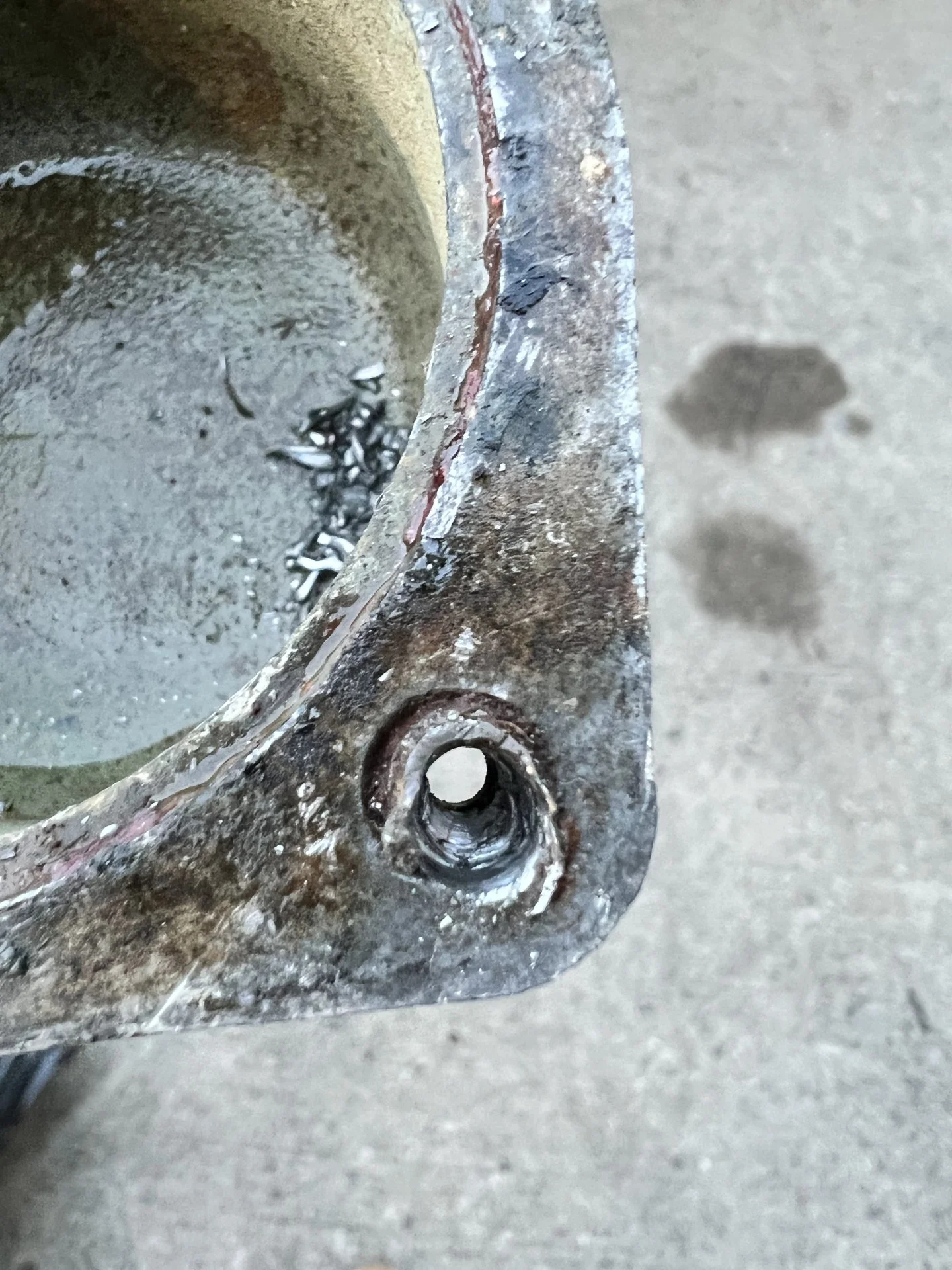

I was attempting to change out the thermostat but one of the bolts seized up. Tried using an extractor but no luck. The upper housing looks fine but for the price I went with the kits from city racer. Added in some new hoses and clamps.
The alignment bindings/clamps on you rear springs look like they are the "pinch bind" style, very poo poo, try to open them up a bit. Pinch binding locks all the leafs together, won't let the leafs slide on each other, so you get a much stiffer ride, less actual spring action.
Or is it time for new ones? I was hoping to wait till next spring since the steering box is leaking onto the front drivers leaf and I wanted to pull it this winter.
If you are still driving the rig, I'd just take a very large screw driver and big hammer and open up the pinch a bit- - -fast easy deal.

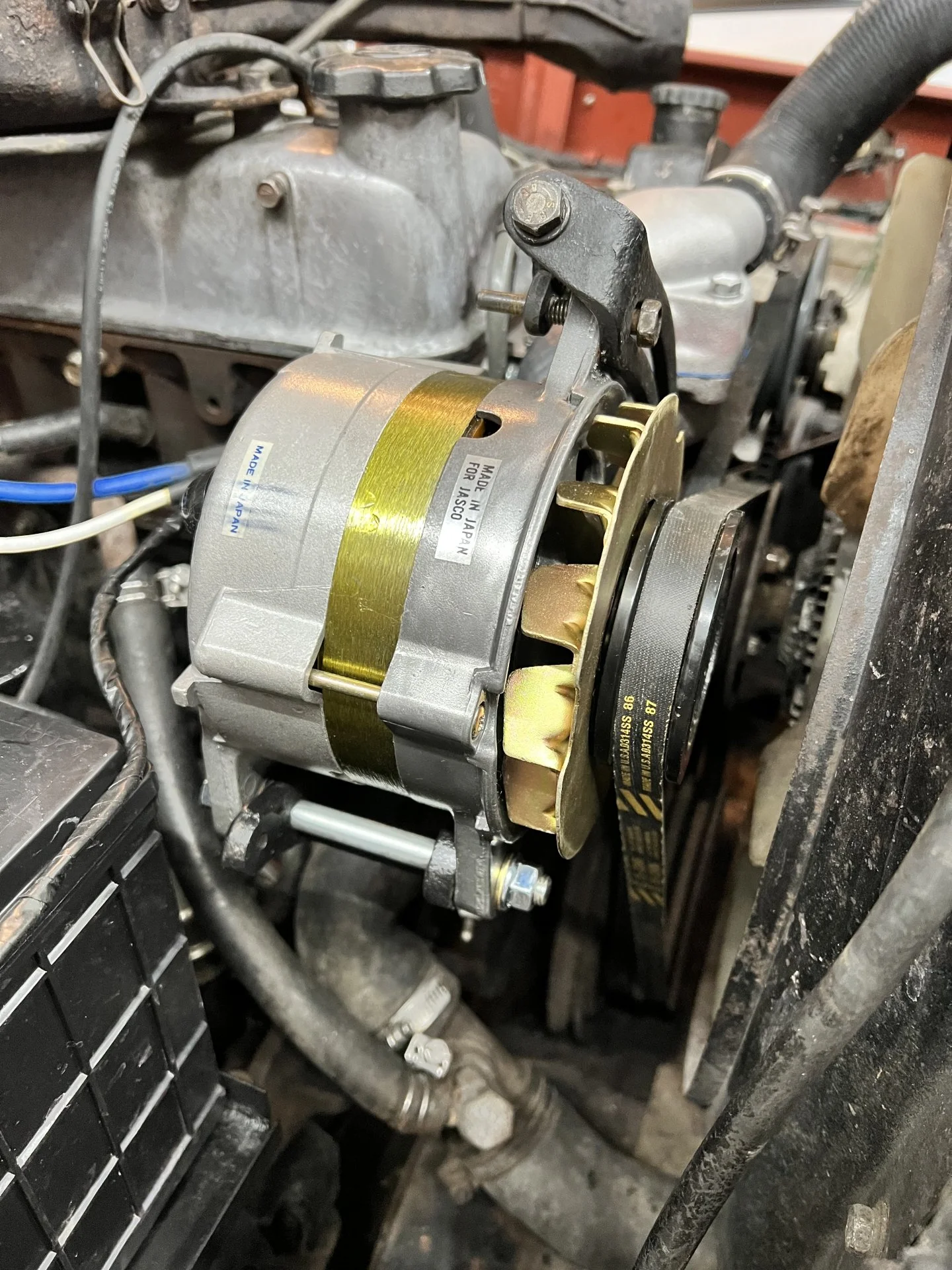

Well what started out as a thermostat swap ended up as replacing some of the hoses, the upper and lower housing units, some new hardware, and refinishing the alternator bracket.
Added in a new temp sending unit but still not working. Pulled the gauge cluster and performed all the checks and it’s good. Thinking I need to try the older style unit in this engine.

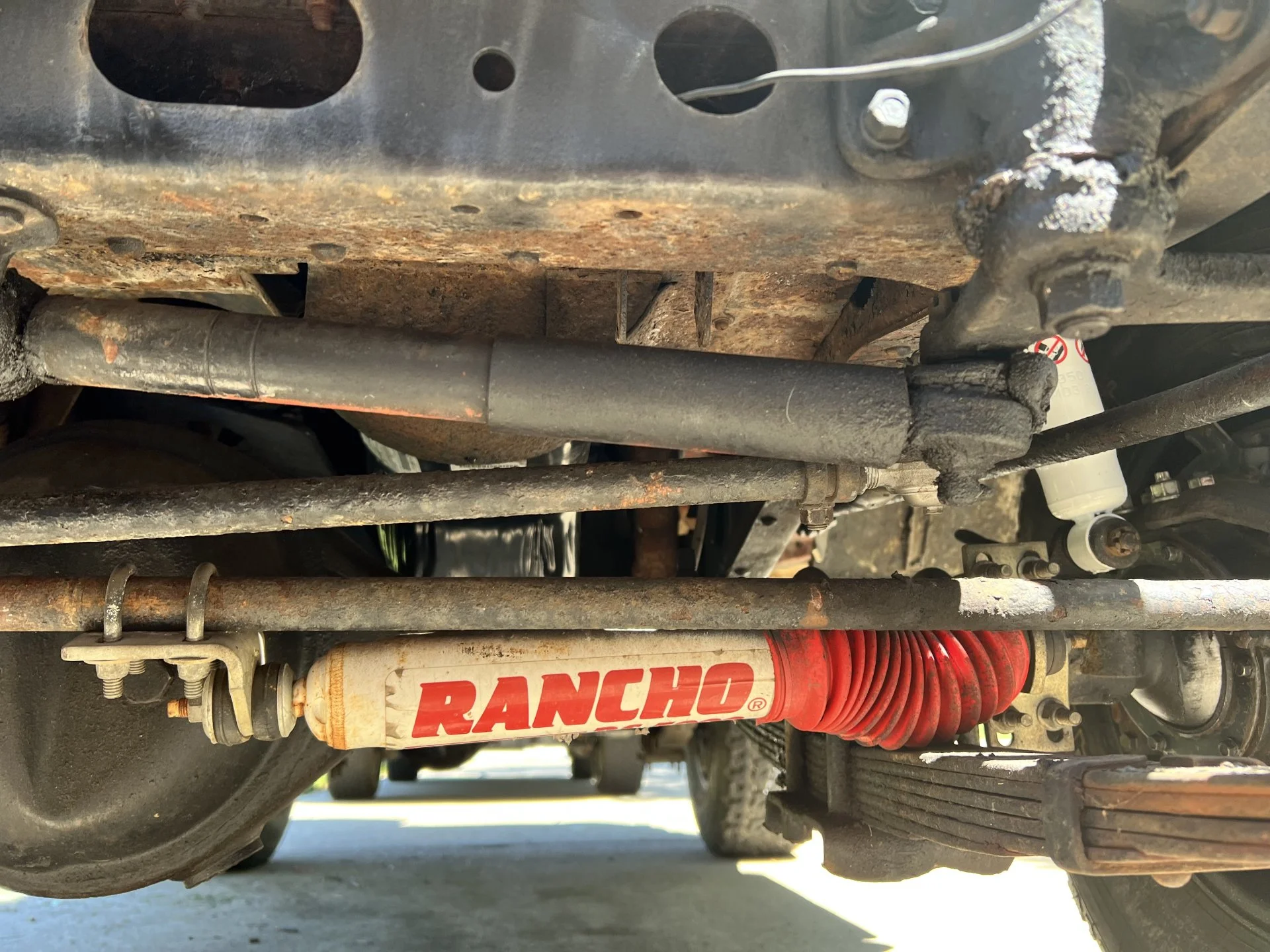

Other than that just removed a ton of grease and the added on steering dampener
I actually prefer the added-on steering damper to the original. Your original is probably not doing anything at this point, and if it works at all, it puts a lot of stress on the center arm. Connecting a fresh damper at the lower position and deleting the original at the upper position is probably the best solution. If you're a purist, replace the original, but check that center arm real close for slop. It's likely that it could use a rebuild.

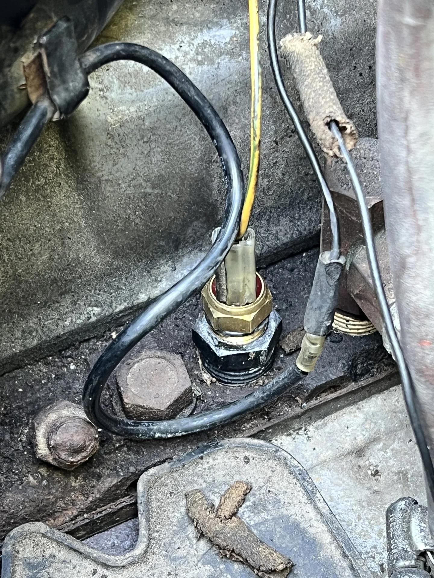

I have been trying to get all the gauges up and running. I think there is a problem with the temperature gauge in the cluster. Everything is hooked up with the correct year sensor but it never moves. I hooked up the oil pressure gauge wire to the temperature sending unit and the oil pressure gauge moves... Now to the oil pressure sending unit. I know it should be on the oil filter union... but its not. So the other positions is by the block drain. Not there either. Now remember my engine is a later model one but here is what I figure.
That wire for the oil pressure just makes it to the block. So I am thinking the original engine had it there. The PO might have pieced together this engine and used a oil filter junction that didn't have it.
Found someone on FB that is selling a bunch of 2F parts so hopefully he has one and I will just replace the junction and run a longer wire.
