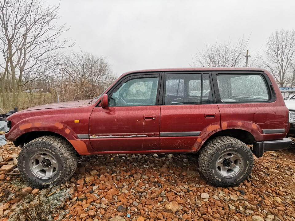

Looks bad.

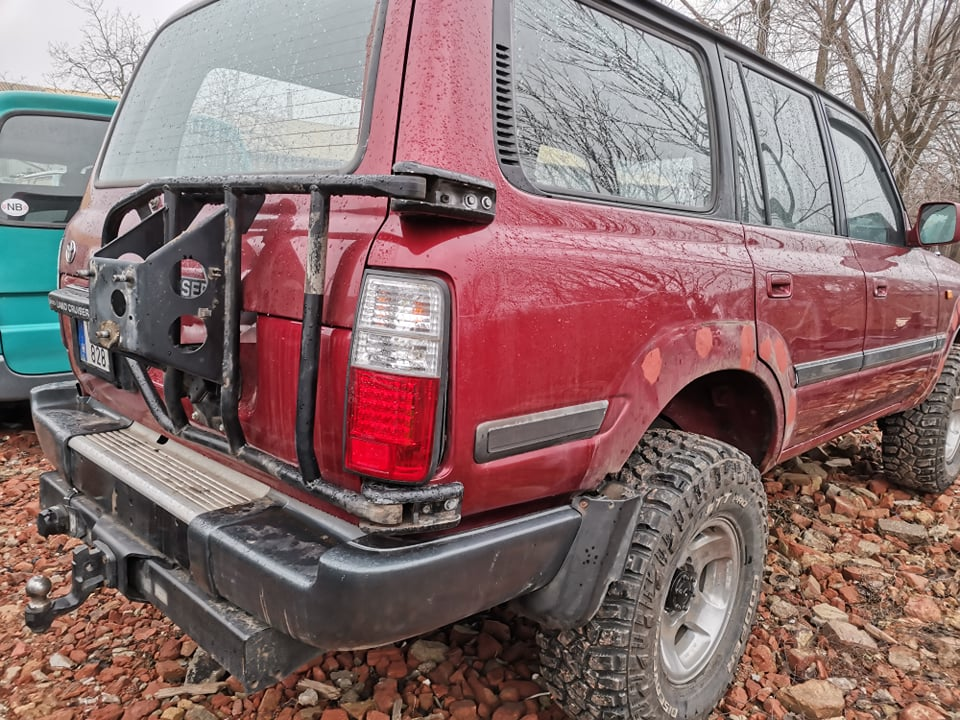

As you can imagine, quite some of the hardware holding the flares is rusted, rothed, belongs to the bin. So it was a quick and easy decision to deflare the car.
I actually prefer the more clean look without flares, also they will fit better the quad headlights:

Flares removed, holes welded up, painting hopefully will be done soon.
On the drivers side the new door is installed, slightly less faded and the front fender rust shown earlier got repaired too.
And finally, the tire carrier is on!
The reinforcements were replicated and now I dont need to worry about the carrier braking the pillar, its solid!
Need to reorder the mudflaps as they were not available at the moment, also the rear wiper needs to sorted out. But slowly its coming together.
