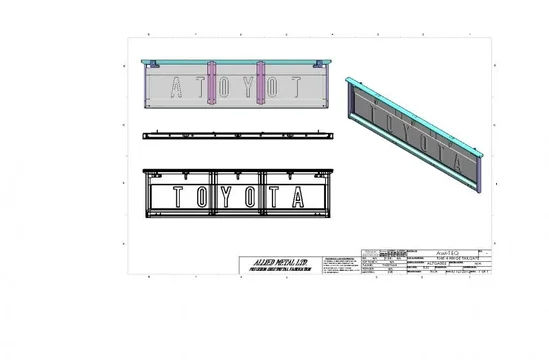

Still more to do but I want to finish off the last few beds I committed to building. Three of those require tailgates so I have been tooling up to make gates. I've made the perimeter frame parts and hooks already and I just finished laying out and programming the dies for the letters. I have to sneak them onto the laser this week and sould be able to proof my technique this weekend.
BUT!.... I have a question.... did the 63 to 67 USA units have the oval on the right side for that chrome 4x4 sticker or was that introduced later????
I think it was always there but before I stamp them all in I thought I should make sure.
Here is a snapshot of my Solidworks model....

Today I finalized the CAD work and the laser NC program needed to cut out the pieces I will use to make a home made set of dies for the letters in the skin. If that makes sense. IOW I am ready to make the tools to stamp the letters in the gate. I have a flat gate skin that I made a couple of years ago. I will experiment with my letter tools on that and update here with the results likely next Monday.
Well My 66 has the raised area for the 4X4..
