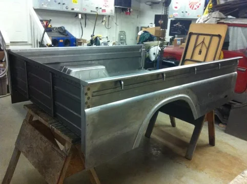

Got a full ten hours in the garage today. Managed to finish the bed I started last Sunday. All together it took two full days to assemble this one. Gonna try and start another one on Sunday.
Started another one on Sunday. Here is a stop-motion film of almost three hours and a little over 700 stills. I'll keep shooting and add to this with the goal of a full construction.

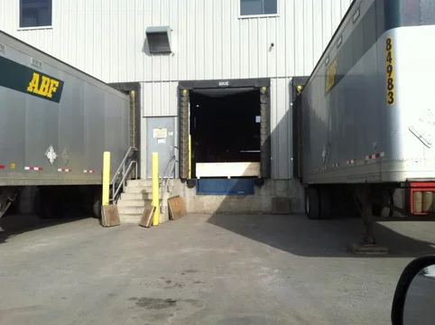

Oh, and I shipped out the crate today :bounce: More room in the garage!!

I'll be adding more and eventually have the whole assembly. If you watch closely you will see that I screwed up my build sequence by forgetting to weld in the two little cross members before adding the wheel humps. With the humps in the way I couldn't clamp them as I would have liked. So I turned one of the saw horses sideways and climbed up on top to use my substantial inertia to get them tight.
Ok, its a little repetitive but here is a video showing the complete assembly shown above. Everything except the finish grinding and sanding is shown.
Had to clean out the garage. First real warm day of the year. The bed in the corner is going to CO and is the one in the video above. The others left already, the crate to Flagstaff and the bed that was in the background went to Vancouver Island.
This one is destined for Tucson. You guys ready??

The one on the horses now is earmarked for you.

Not a biggie. The bed shown above that I said was for a buyer in CO isn't. I somehow got confused and made it a late model when they have a 1965 frame. So..... JIM! Your bed is ready! Sent you an e-mail and I just saw your reply chime in.
Sean, I'm sending you and email next. Got a little issue to discuss.
Ok, Sean is cool. I'm gonna make the one I'm building now, shown above on the jig, for the CO buyer and Sean will get next weeks assembly.
