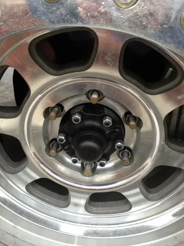

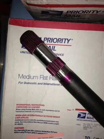

In continuance of the OT, more band aids arrived
And did get the ARP hub and wheel studs in
