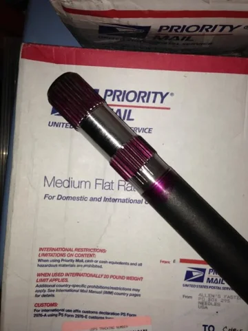

I just finished building my 96 axles. Factory Elocked
Front Nitro 4:88 and Nitro axles, rest is toyota OE fully rebuilt.
Rear Nitro 4:88 and Nitro axles rest is toyota OE
Now i am worried about the axle studs/pins
Does anyone have a link to which studs and pins to get? I would prefer to NOT tap and drill so what are my options? I have a TON of $$$ in this rebuild
Its not a DD and won't see much highway use, i run 35" KM2 and plan to supercharge at some point

Opted from Front Range Off Road's ARP hub and knuckle studs.
Hub studs are sold per axle. Unscrew the OE and these threaded right in.
Edited: Since sarcasm is difficult to relay in text and everyone is so sensitive, I was jokingly lamenting.
You're preaching to the choir when it comes to axle, well build, monies here.
Thanks, just ordered a front and rear stud kit! In stock!
Ahhhh....didn't have a clue studs were an issue! Guess i will take my chances for now with them as its all assembled and done!
Next time im in there i will do the studs.
