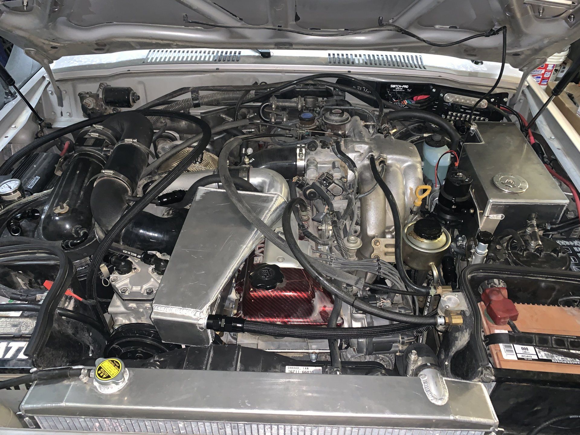

I finished up all the plumbing and electrical for the Intercooler system and the oil cooler, all are controlled by the switchpro, and are programmed to come on when the truck starts.

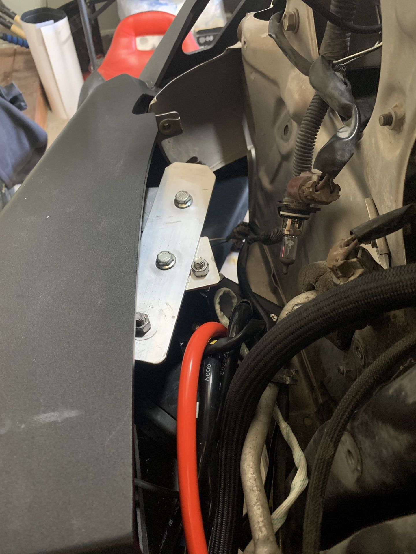

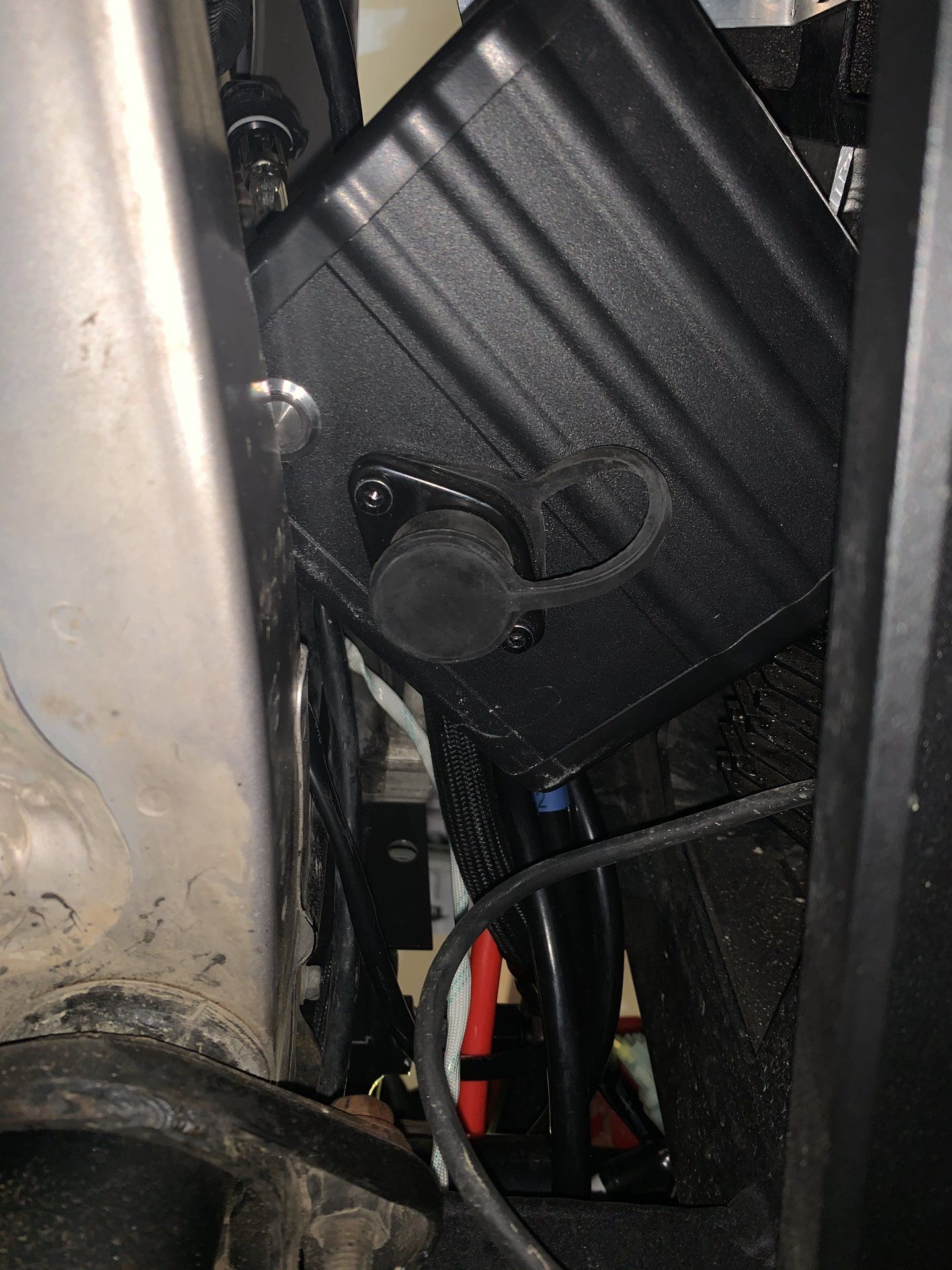

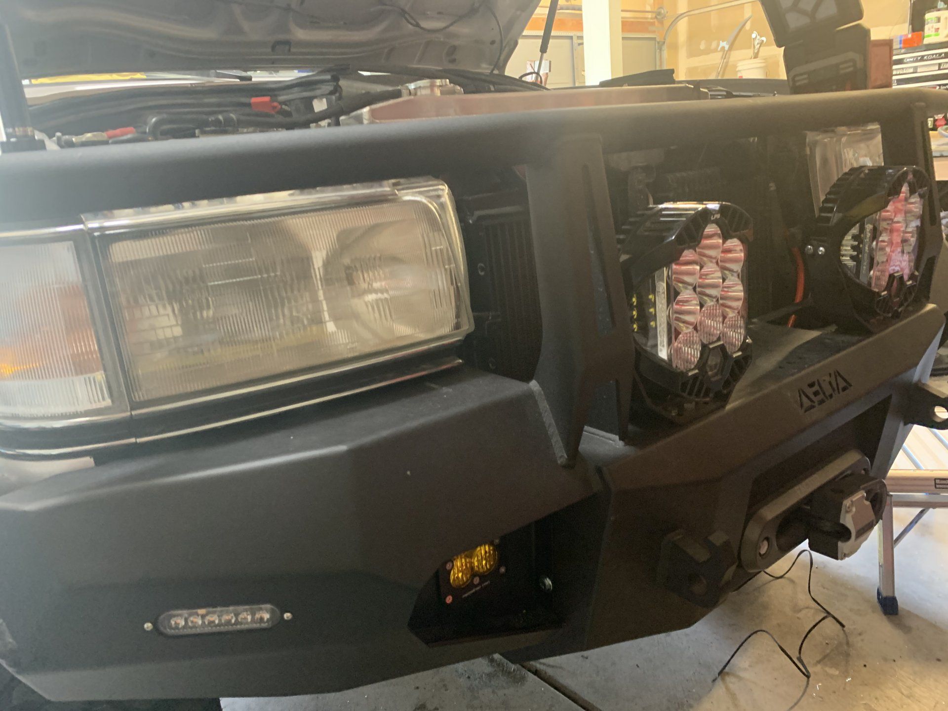

I have a Comeup 12.5RS winch stuffed behind the Delta bumper, but there isn’t room to attach the control box, especially with the IC heat exchanger and PS cooler I have mounted up front. My engine bay is already at maximum capacity, so that’s a non starter.
I ended up pulling the passenger headlight and stuffed the box inside the bumper wing. Knocked up a simple aluminum bracket to bolt the control box in place and upside down. It is positioned so that I can plug in the cable from under the bumper easily.

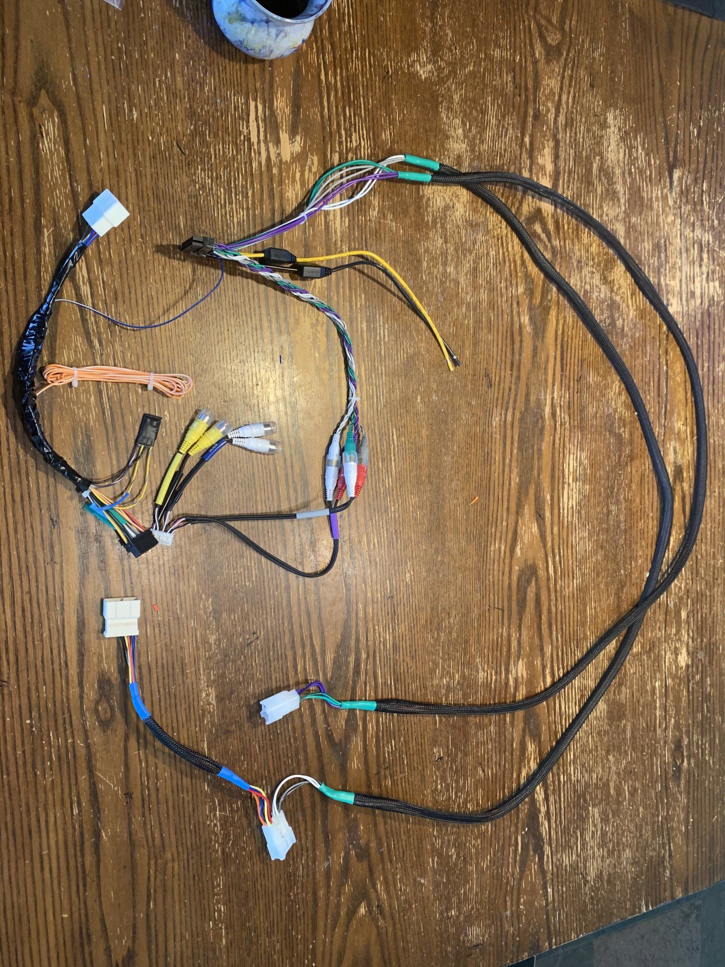

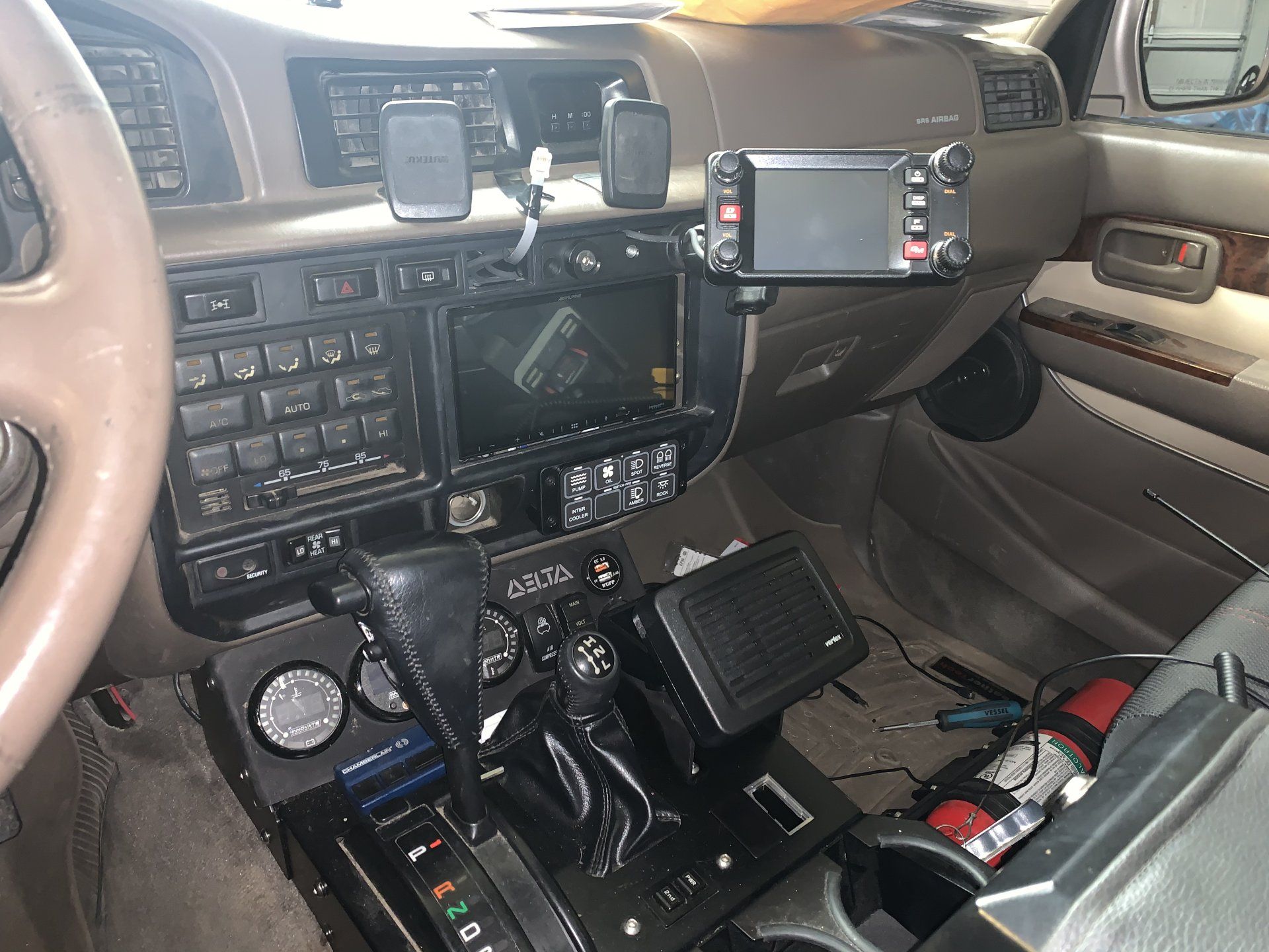

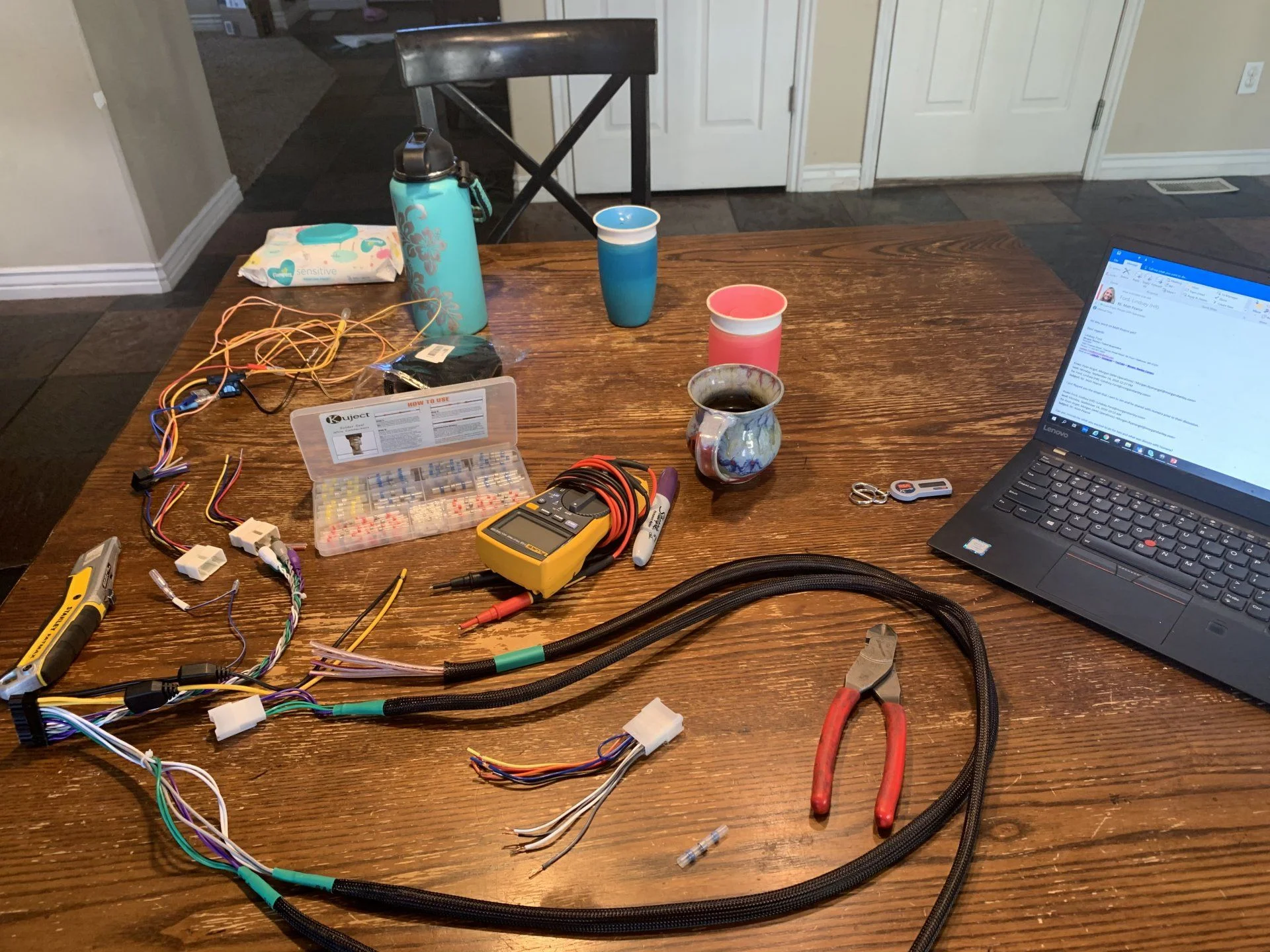

After @Box Rocket offered to lend me some tapes for our upcoming trip I figured I better upgrade the stereo. The LX450 however adds some complexity with the factory amp, CD changer and “sub”...predominantly the amp. With some good old Mudsearch, I found a couple useful threads that detailed how to go about making a plug and play harness that bypasses the factory amp.
A bunch of time at the kitchen table making a mess and I produced this...hoping it works.
While I had the dash apart I figured it would be a good time to also install a new Ham radio, so that added a bit of time. I am pretty happy with how it’s all coming together....and all the wiring worked as planned. Phew!!!

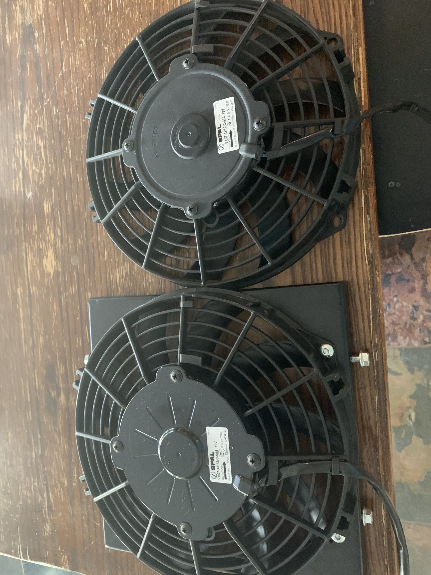

The intercooler heat exchanger I ordered from griffin with a pusher fan, showed up with a puller fan...I didn’t notice until it was all wired up and I turned it on....ugh. Griffin wouldn’t be able to get the right fan from SPAL for about 3 weeks, so I went ahead and found the correct one on amazon and got it delivered today...progressing along.

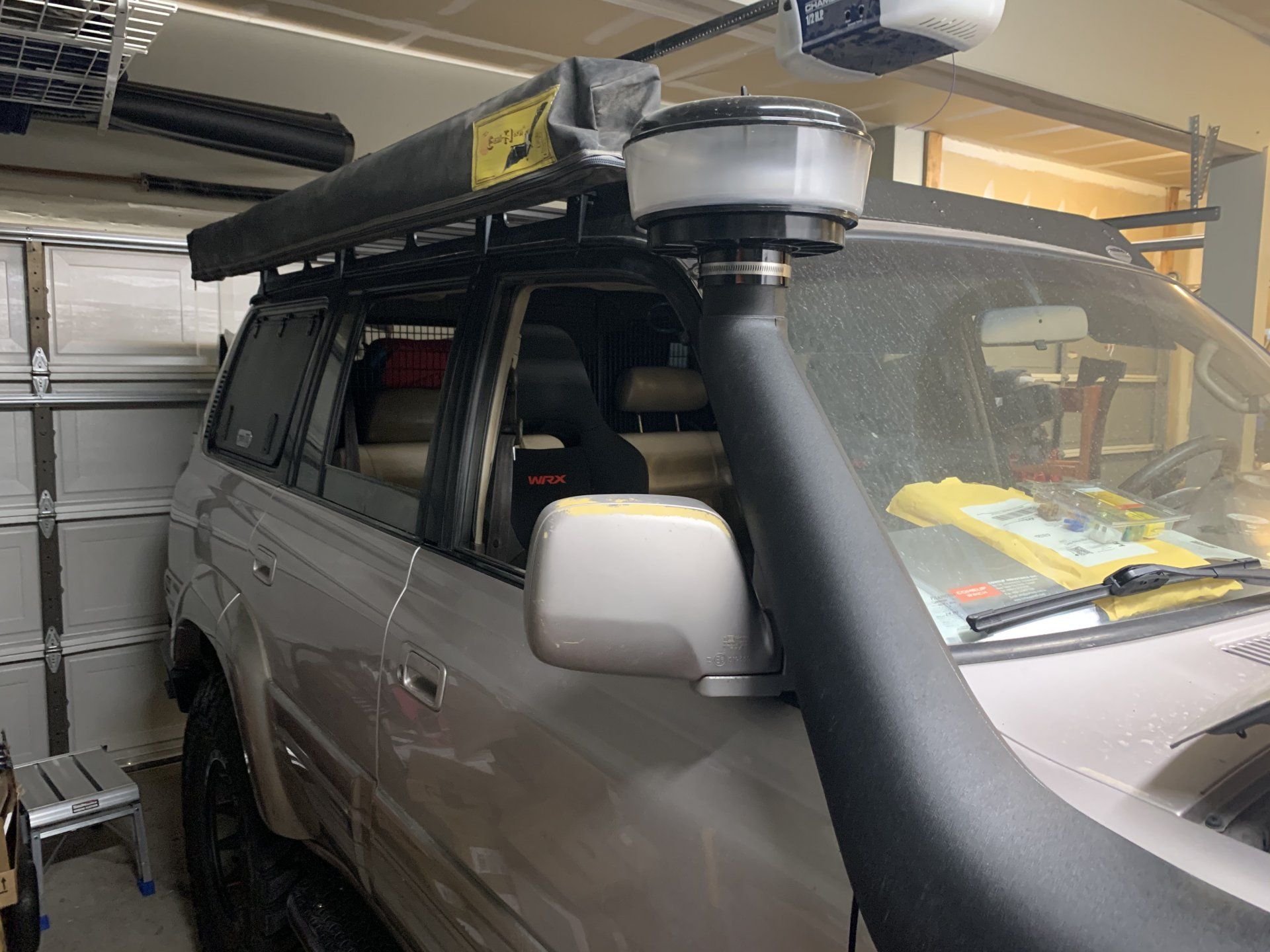

I had a buddy come over this afternoon to help me mount my Eezi-Awn batwing on my Bowfin rack. This used to be on the Cummins 80, but that one will be under the knife for a while so figured it would get more use on the LX. With a full tank of fuel I can get in and out of the garage with 1/2” to spare.

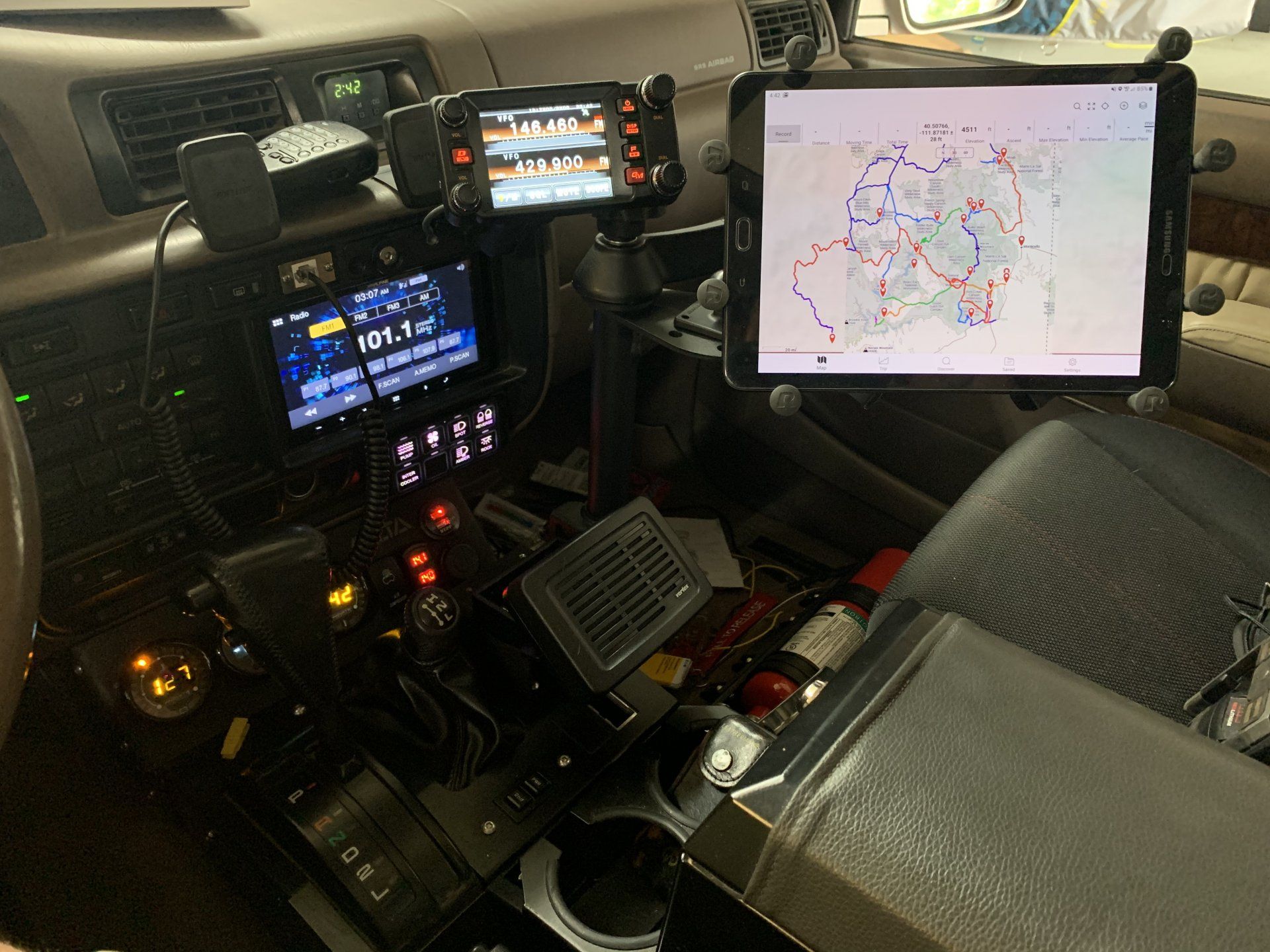

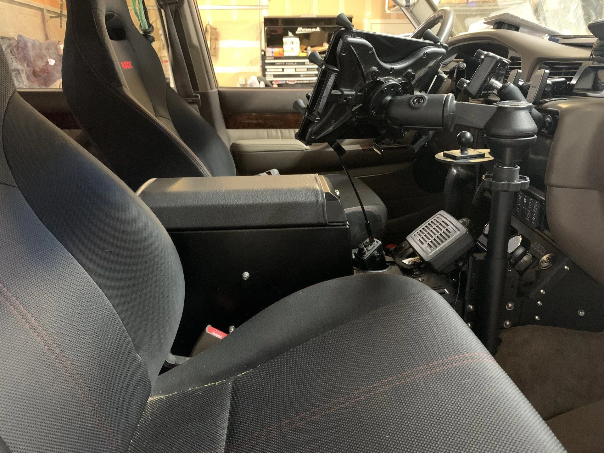

This @Delta VS Shift console has enabled me to make a cockpit. @Outsane made up an R12 jack version of his switch blank data port for me and it works perfectly with Yeasu radios....no more mic cords getting in the way.

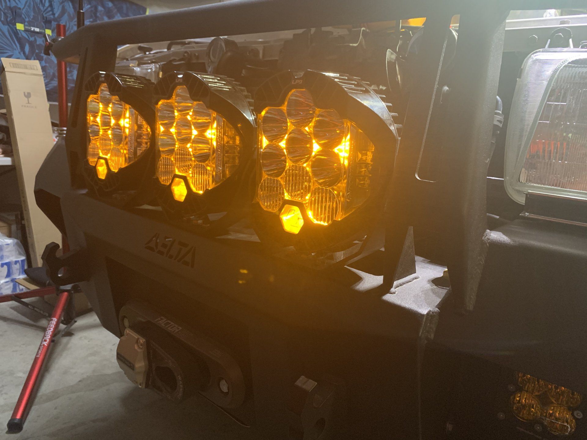

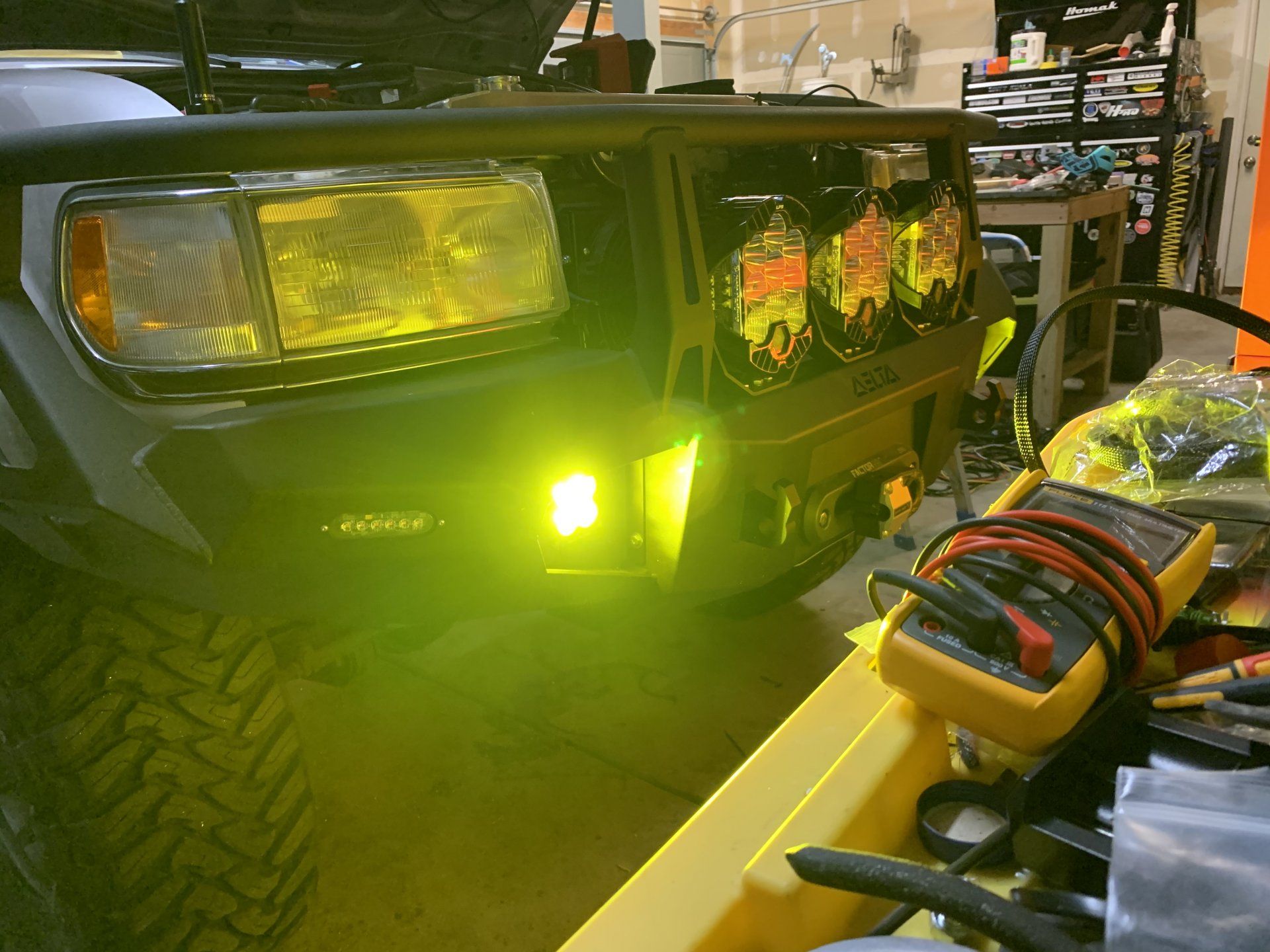

Wired up the 3 LP9 Pro’s. Amber running lights tapped into the parking light circuit. The high circuit is running through the switchpro.
Also wired up the pair of Amber Squadron Pro’s through the switchpro.

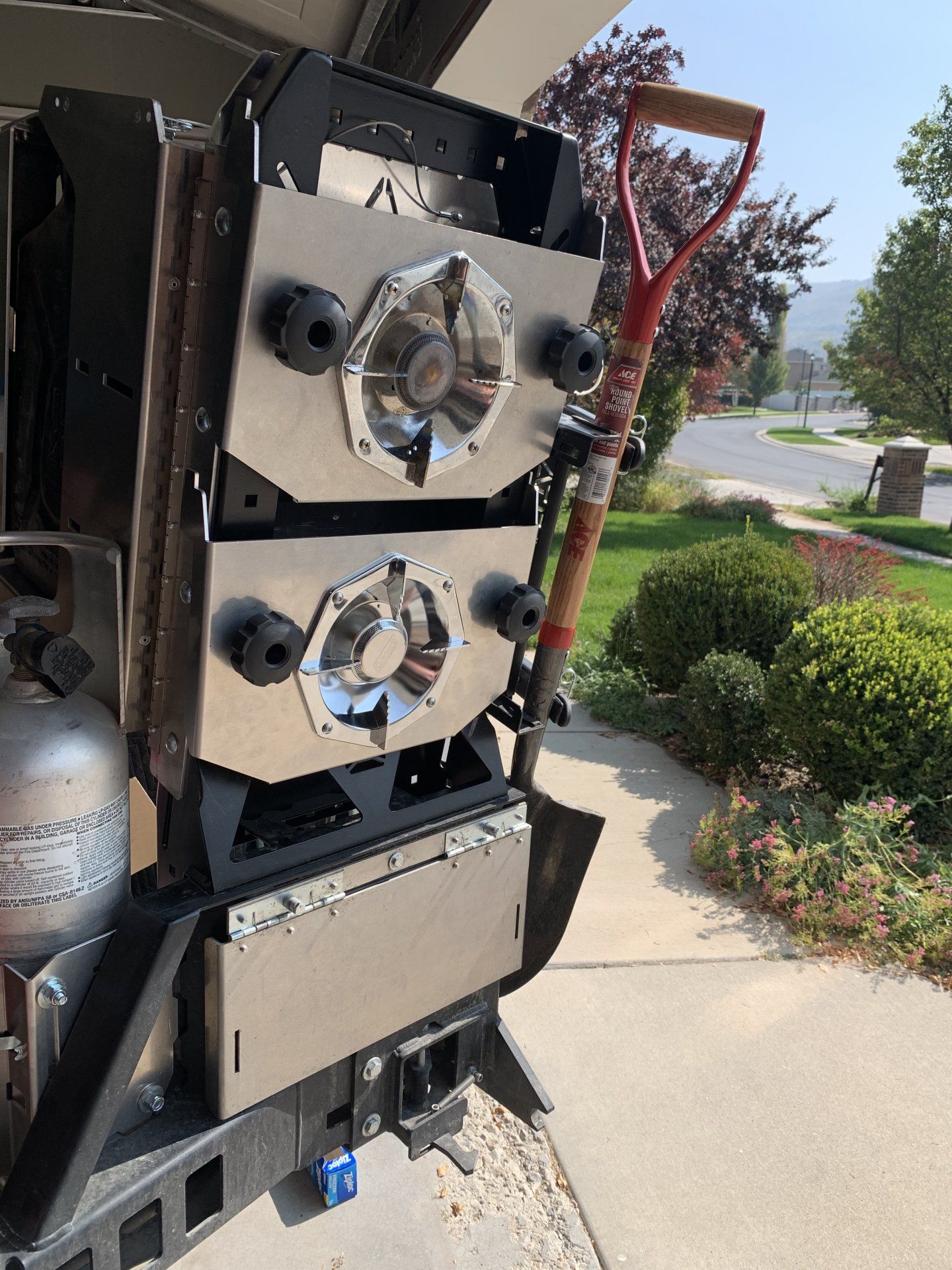

Today I mounted up both of my @Delta VS drop in stoves to the backside of the ladder Swingout. Can’t wait to test out this setup next week. I have plans to plumb propane quick connect fittings to both swingouts, but haven’t finished collecting all the parts for that just yet.

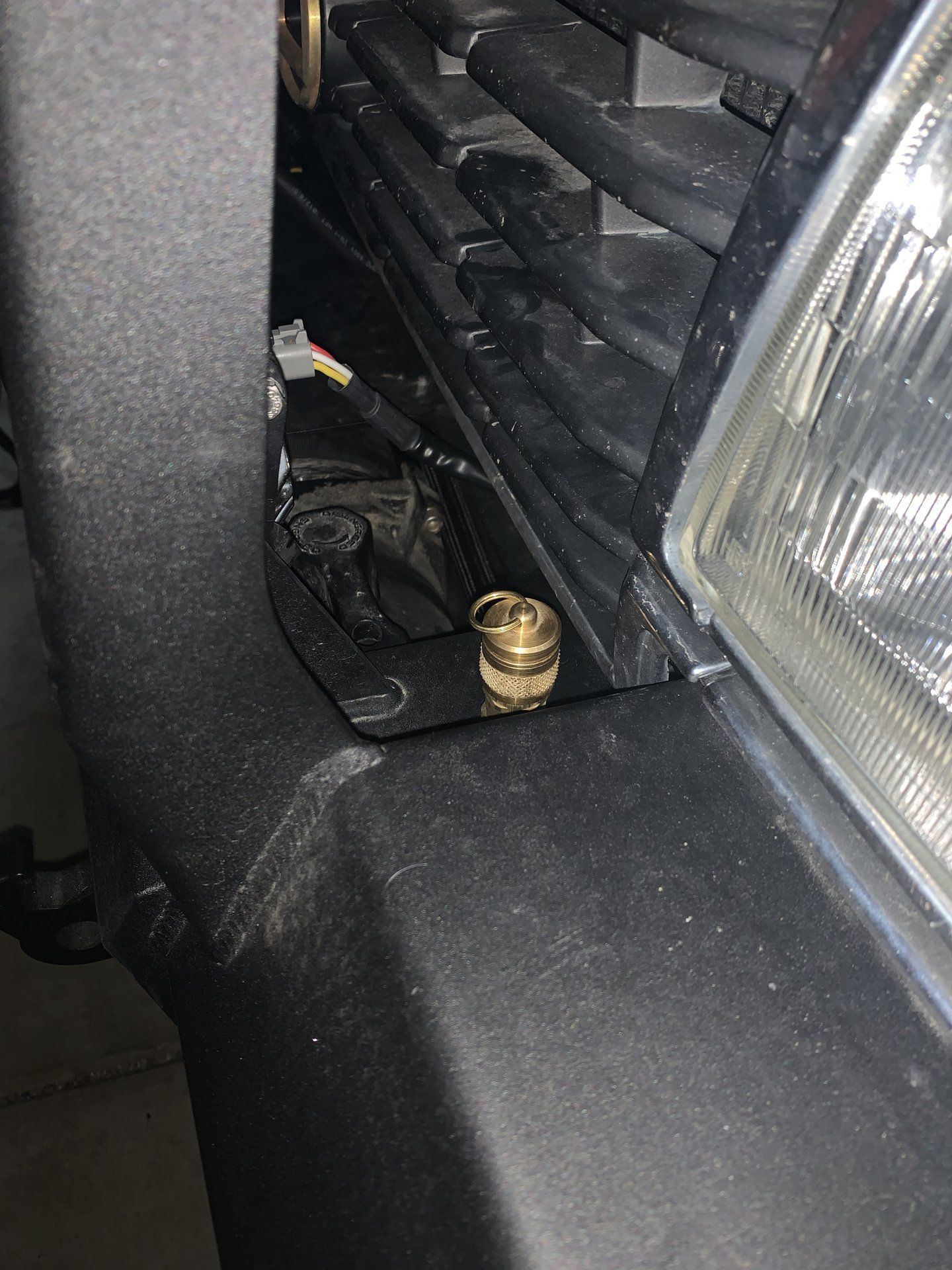

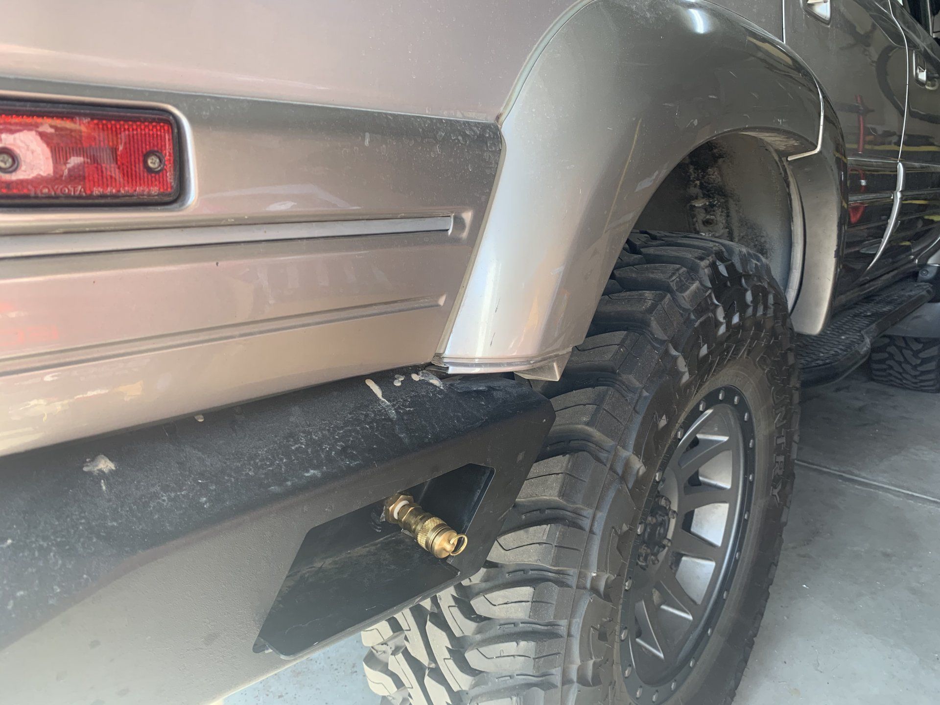

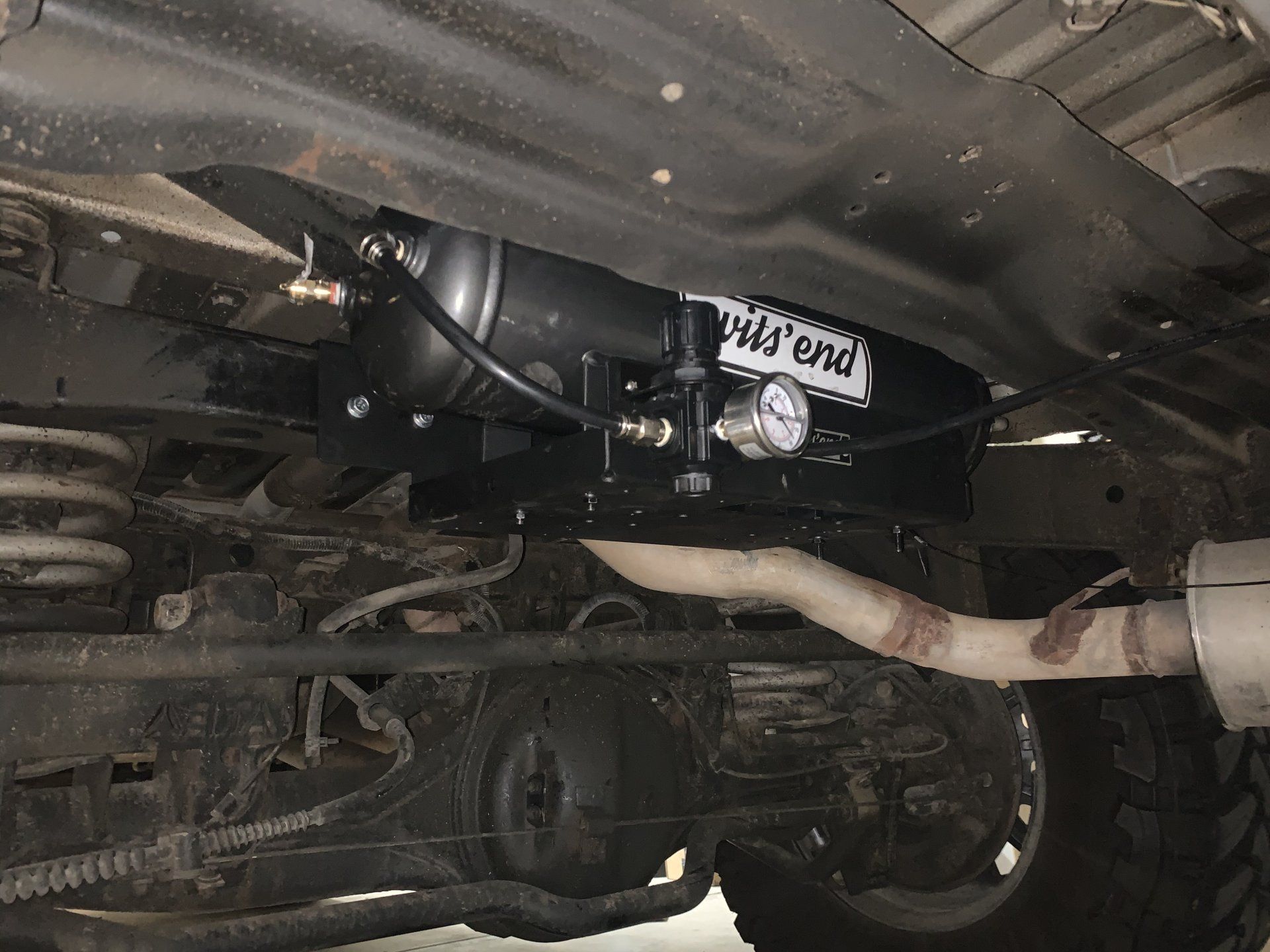

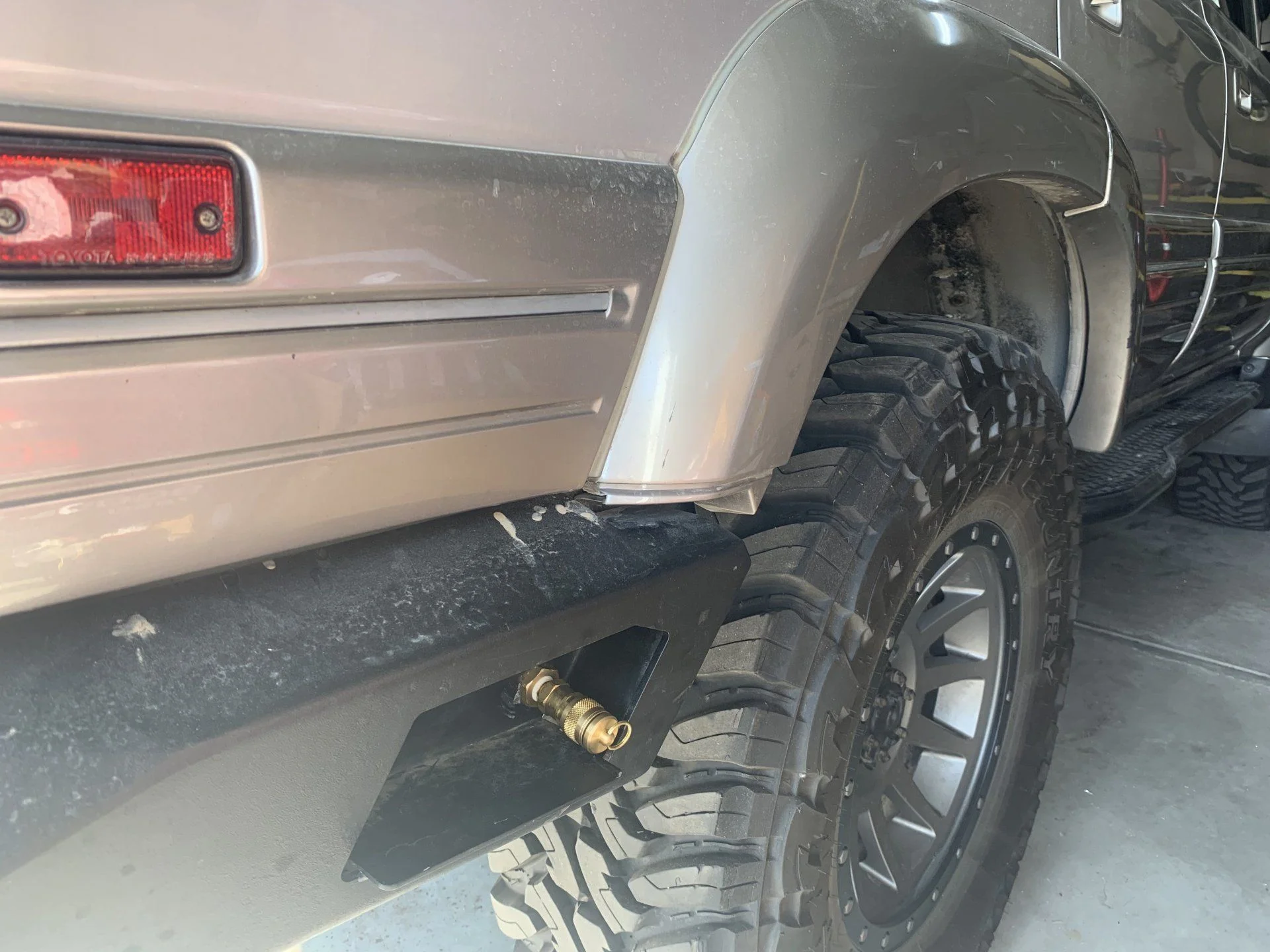

Got the Wits End OBA tank installed that I have had sitting in storage for about 4 years. Also added another air coupler inside the passenger side step of the Delta bumper. The York fills this tank up mighty quick!

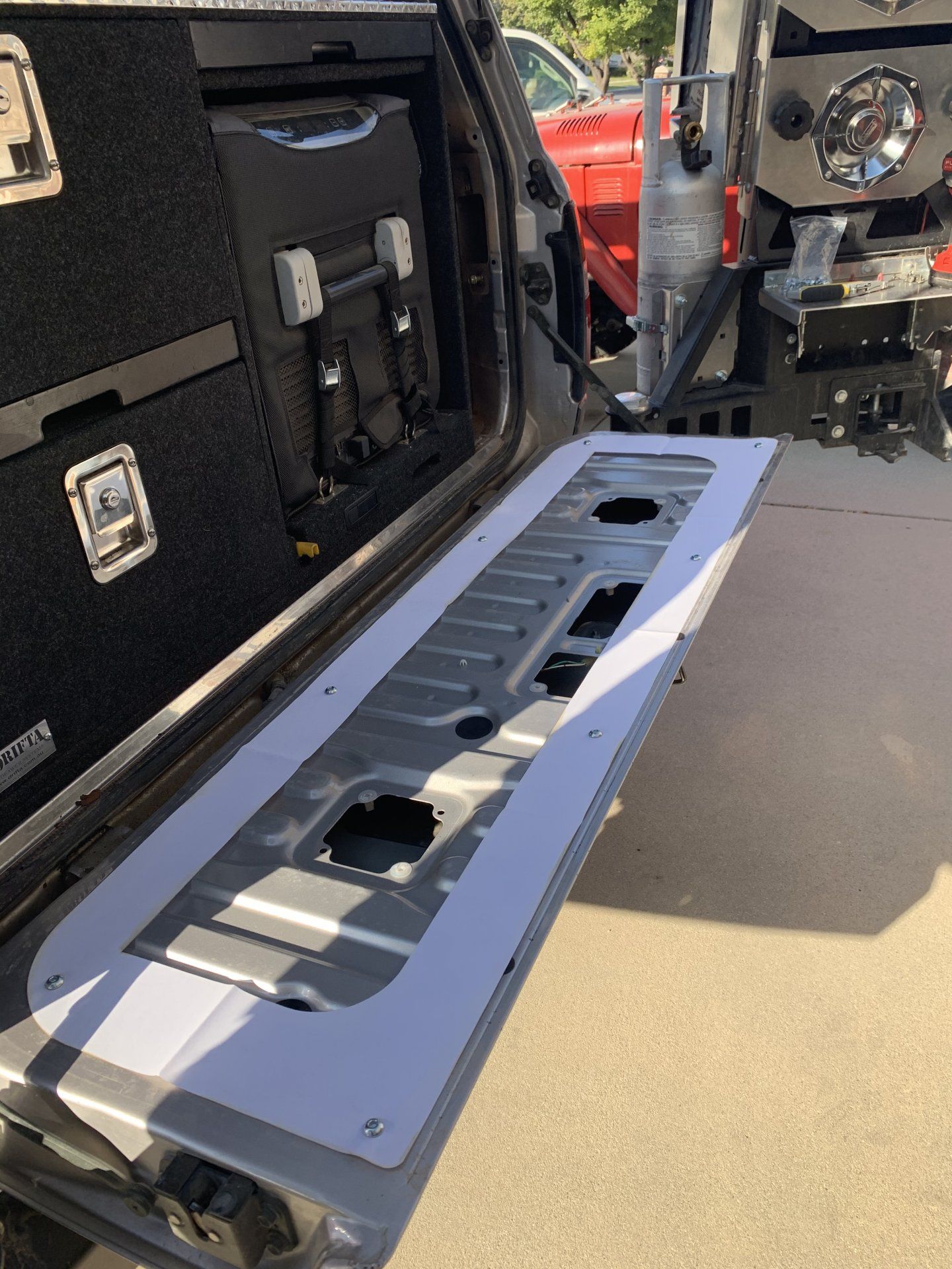

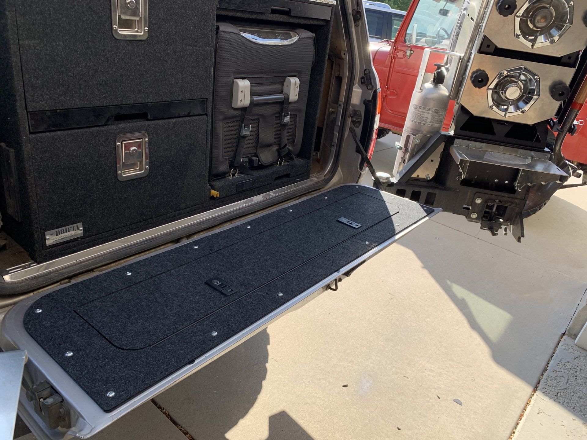

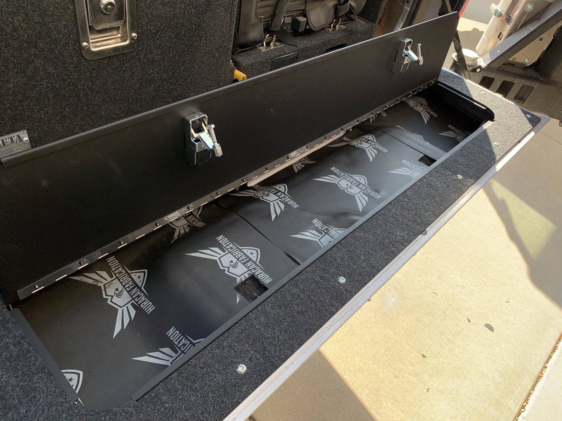

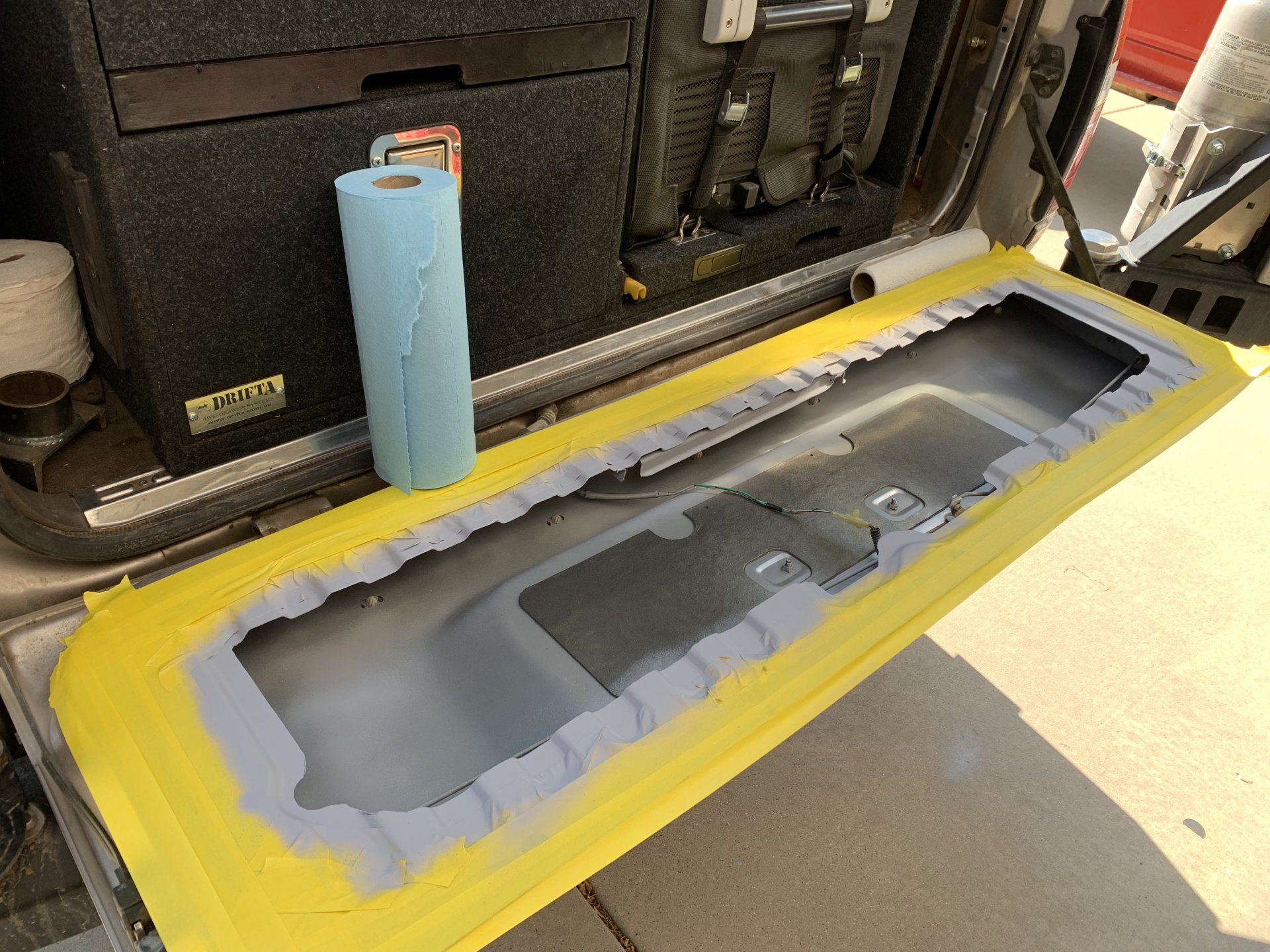

Today’s project in between meetings was tailgate storage. I managed to only cut myself once which I will consider a win.

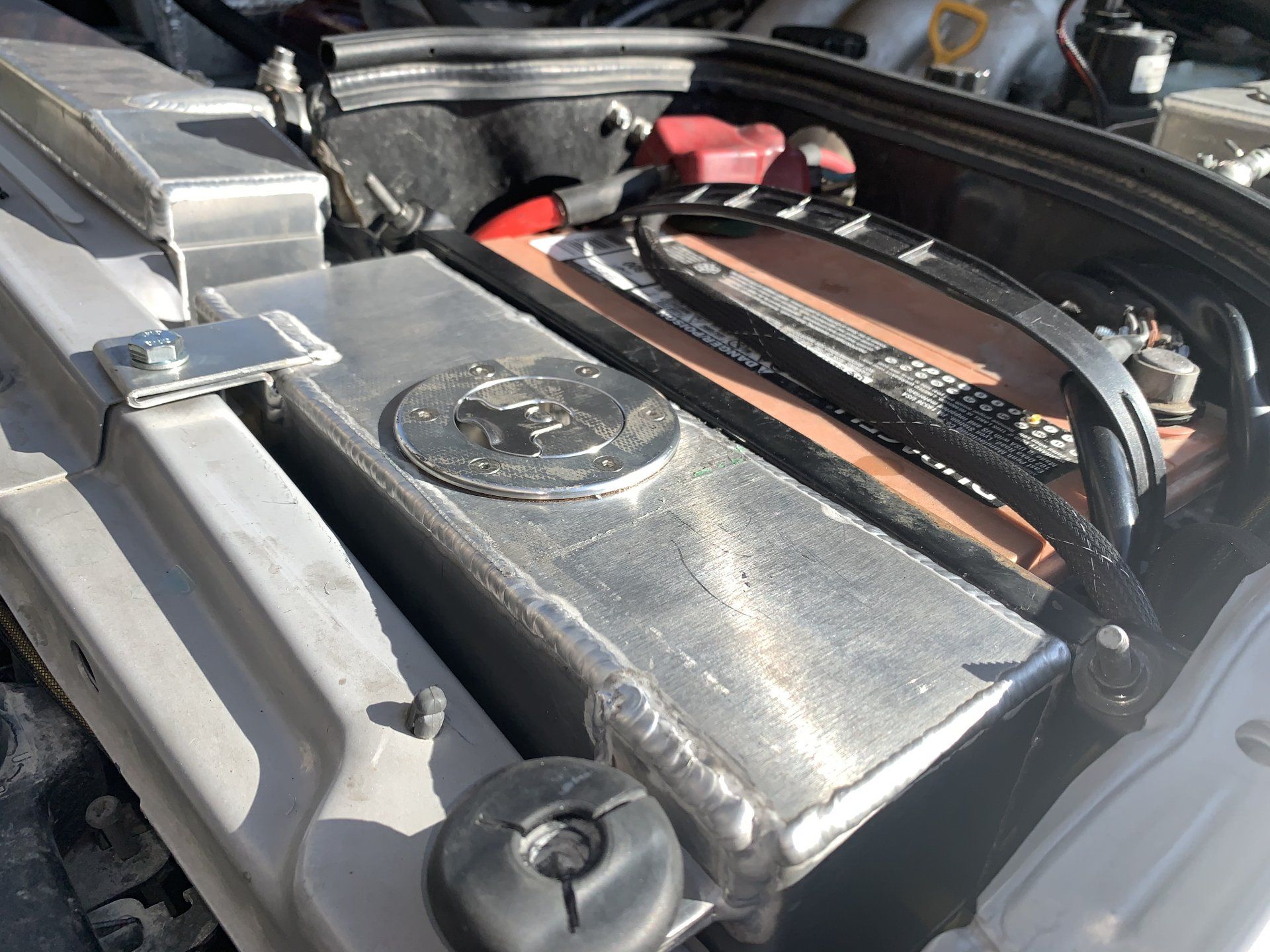

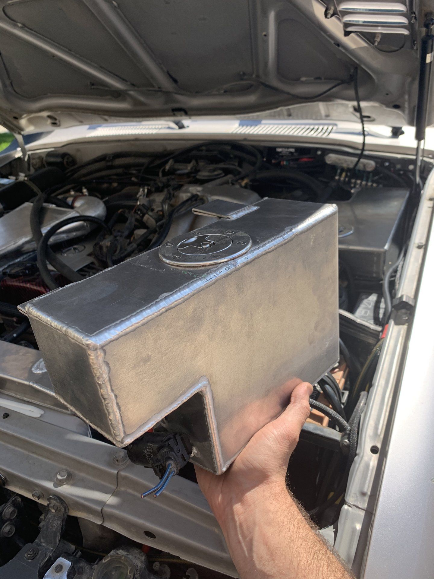

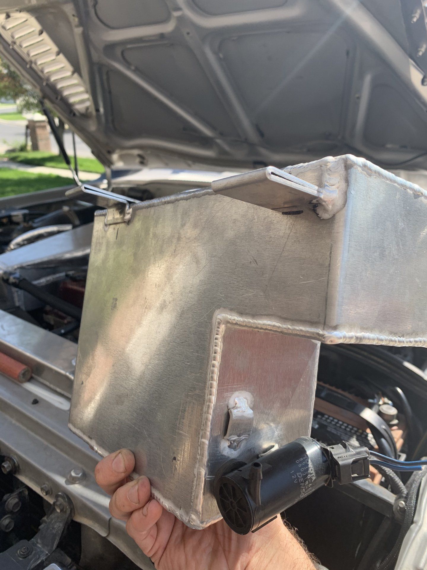

I found a little bit of real estate under the hood that wasn’t being used....fixed that problem. Custom windshield washer tank with a new OEM pump now resides in front of the main battery. The tank holds about 1 Gallon.
View attachment 2459785View attachment 2459786View attachment 2459787View attachment 2459789
I’ve had this tail gate lid for a few months. Its very durable. My only mod to it was running some additional padding on the lip of the where the lid sits when closed to minimize chatter. Other than that its solid and the additional storage is great addition.
