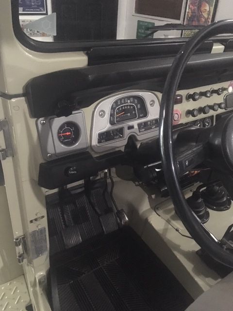

I didn't know that FJs came with factory tach. In the absence of the factory unit this is where I mounted my Auto Meter tach:
It was a challenge installing it as there's a duct in the way behind the dash. I used heat to deform the duct to make room for the tach.

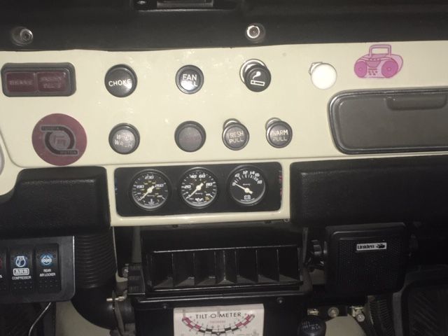

What are you looking for? I bought one from Mop Dog back when he was selling them. I can say that it still works after a few years and makes me smile. I do not like add on gauges unless they are OEM like or installed in a unique way. Check out my other gauges in the radio slot. The color is off on my spedo or tach since both have been repainted the photo makes it look worse. No issues with the light switch being moved down like other market had.
What are these gages? They look like oil temp and battery?
