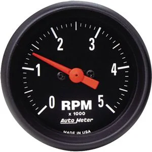

Found an Autometer 5000 rpm tach. Looks as Close to stock without the silver bezel.
Uh, yeah...but where did you find it, that always helps ;)
...Without jumping out of this forum to google something...
