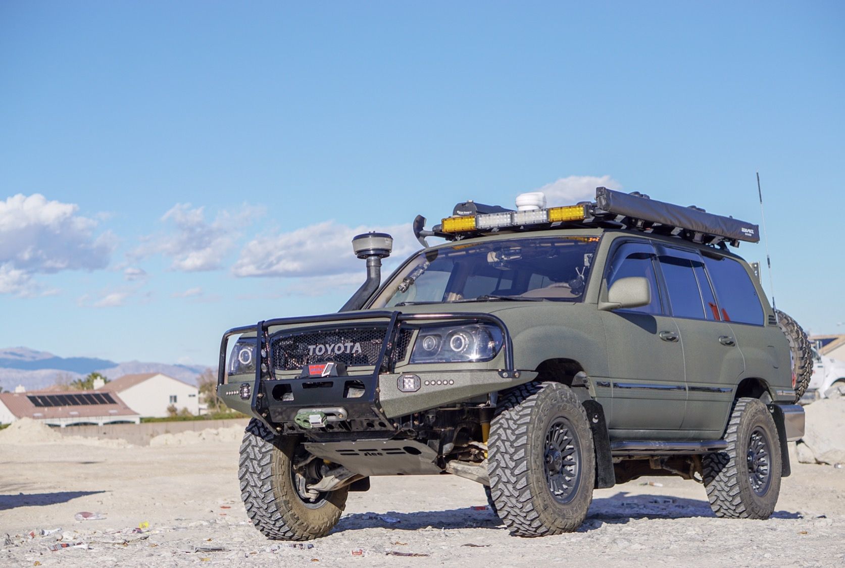

Dissent bumpers are here! Sent most parts off for gloss black powdercoating! The wings I wanted to color match. So the insides were painted gloss black, the outsides were done in Raptor Liner to match the truck.
I also am painting, powdercoating, & installing my new Land Cruiser Grille from @kelly saad. I had a couple of brackets welded onto the back of the grille shell, to install a pair of Whelen yellow flashers behind the grille. People tell me they like the yellow flashers I have installed in the rear when we are going through dusty trails. They say it's easy to see me up ahead. So I'm hoping the guy in front of me might like to be able to see me as well.
Thankfully I had mixed 2 gallons of paint when I painted the truck a year ago. So I had leftover and it was the exact same color. Sometimes custom colors when written down and mixed again can be off.
I had painted the emblems to match the old Hutchinson wheels. So instead of changing the color of the rear emblem I decided to do the TOYOTA letters the same color as that. Plus they will match the projectors in the headlights.
This install also included the new rigid flood lights mounted flush in the bumper, reinstalled the Warn Zeon Platinum 12-S, relocated the winch head back on top of the bumper, & factor 55 1" fairlead. I originally wanted to try and remote mount the head. But there was no room in the engine bay and in case of emergency there really wasn't an easy place to get to to turn the winch on.

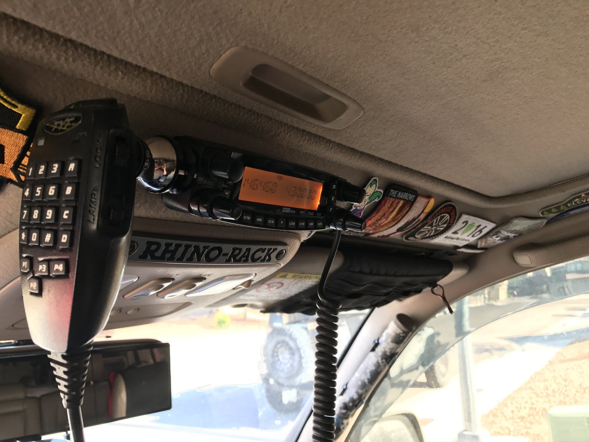

TYT TH-9800 Ham Radio finished up and wired. Mounted the body under the passenger front seat.

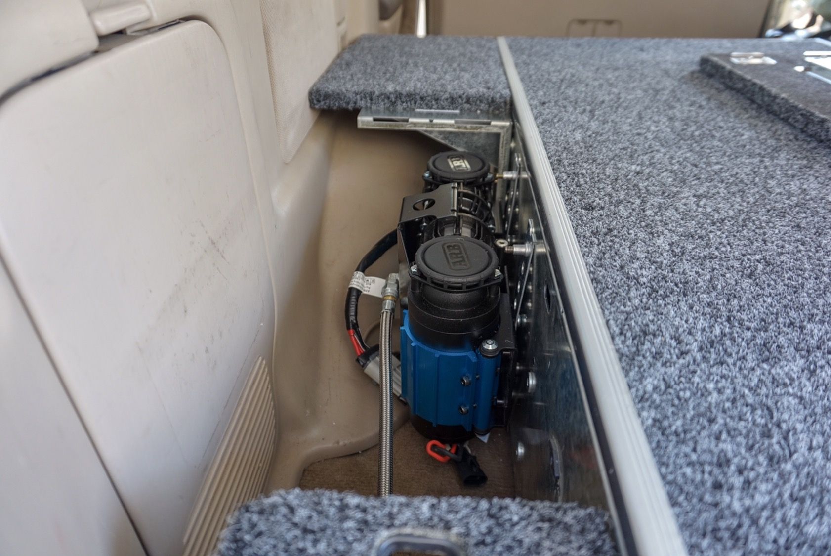

ARB dual compressor mounted to the ARB drawers. No room under the hood to put them and this will keep it clean and out of the dust. Might add a fan to the front section of the drawers to blow into the cubby. Still gotta wire this up.
Very cool compressor setup! That may be the best use I've ever seen for that leftover side space in a drawer system.
