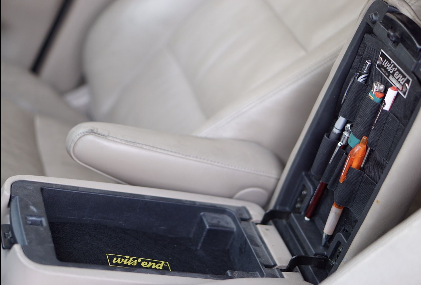

Wits End - console organizers and liner

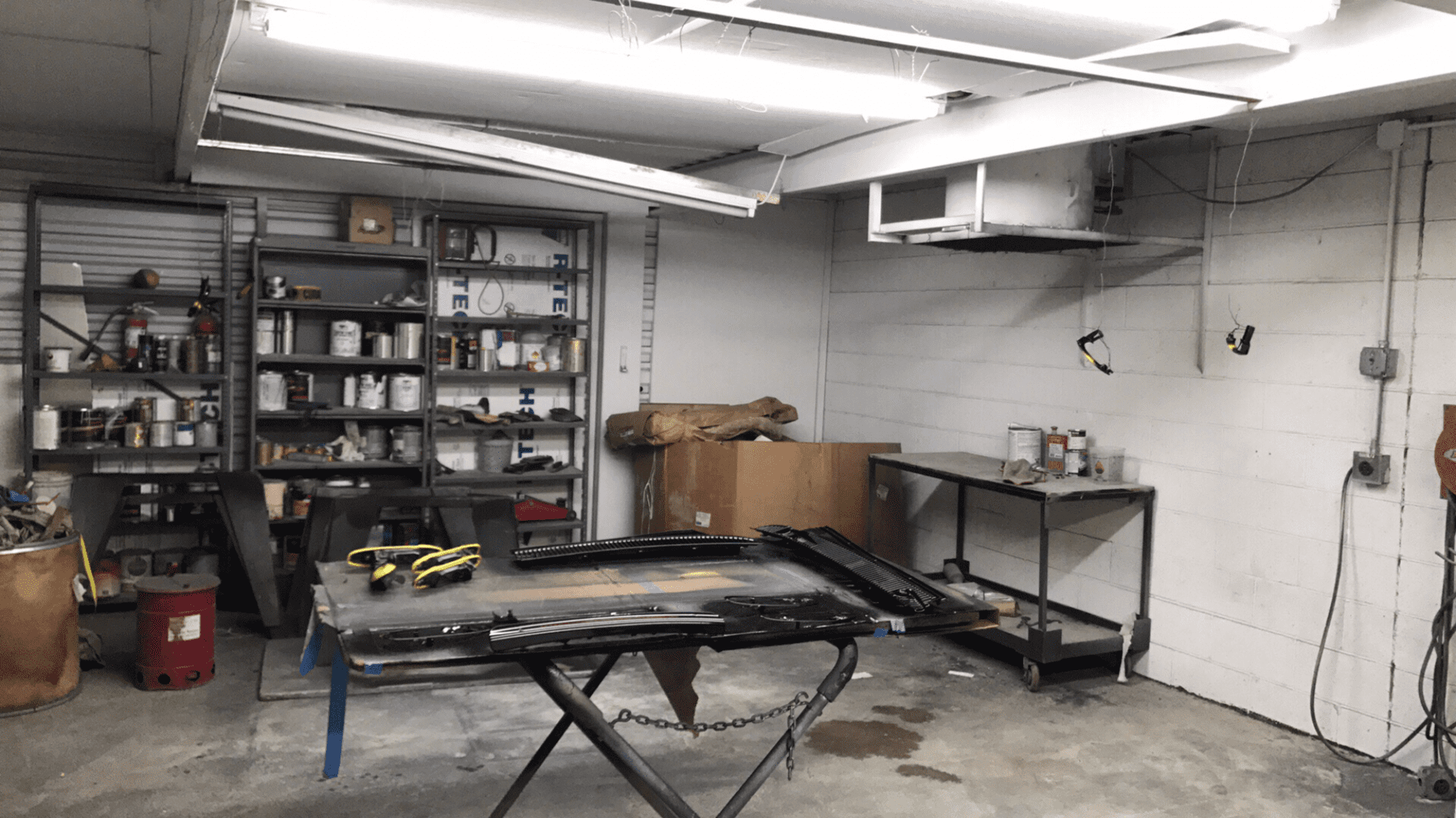

We had been waiting on the raptor Liner to get the rig painted. It had to be painted before we could start installing parts!

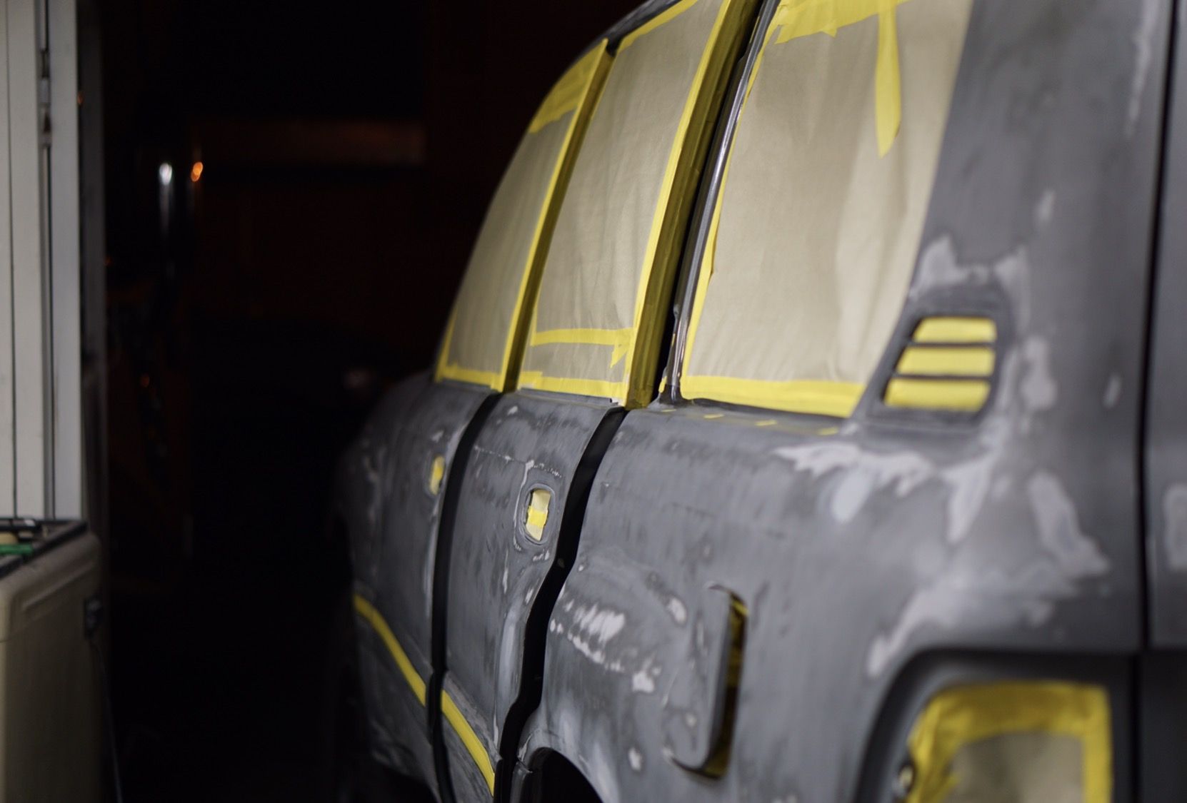

While we were waiting we started painting items gloss black. The grille, taillights, 3rd brake light, trim around the door handles, plastic cowls under the wiper arms, the center stripe on the body mouldings, & the vents on the rear pillars. We also got the body fully sanded, primed and ready! It's time!

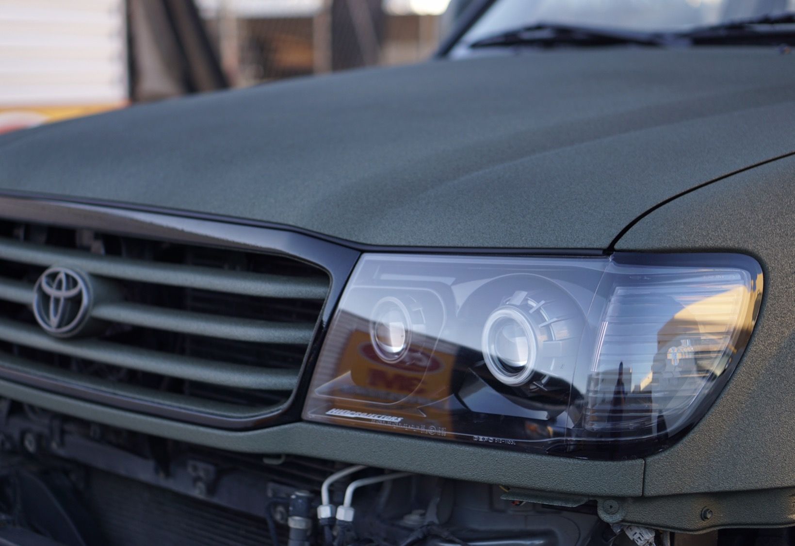

Depo headlights are back from HIDProjectors.com. They did a quad projector retrofit. Painted the housing black, painted the projector housings grey to match the Hutchinson wheels.

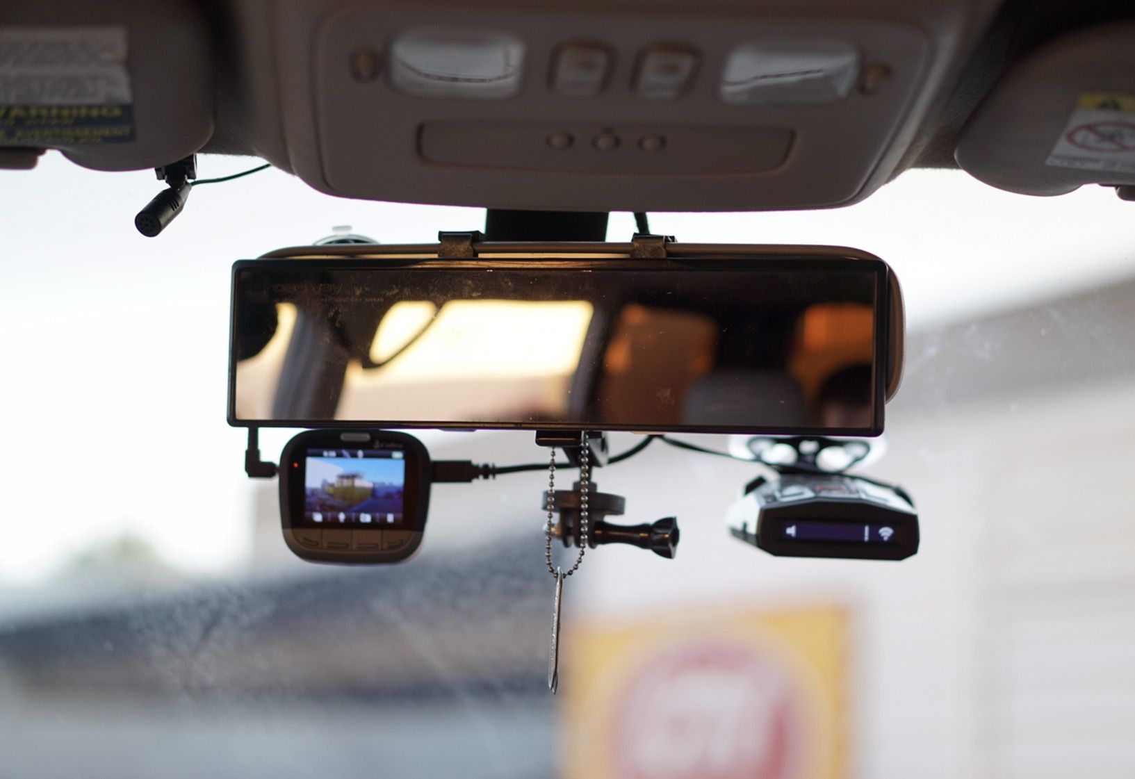

Cobra dashcam and radar detector hard wired into the truck.

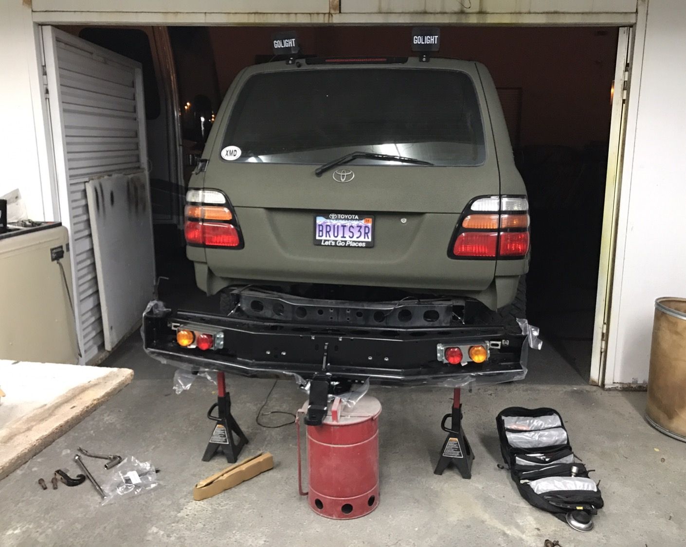

Finally the ARB pallet has arrived! We are 2 weeks away from Sema at this point! It is crunch time! When I ordered the rear bumper, ARB was out of stock of the passenger side filler panel and out of the gas can holder. The only thing they had in stock was the tire carriers. The only option they had was a dual tire carrier… So I had to get ahold of Hutchinson and Falken and get an extra tire and rim shipped out as fast as they could! It's too close to Sema to send out both bumpers to get powdercoated the grey to match the wheels. But the front bumper came in a grey Metallic. Rear bumper came satin black. So I sent the front bumper to the powdercoaters to get done in satin black while I worked on the rear bumper install.
