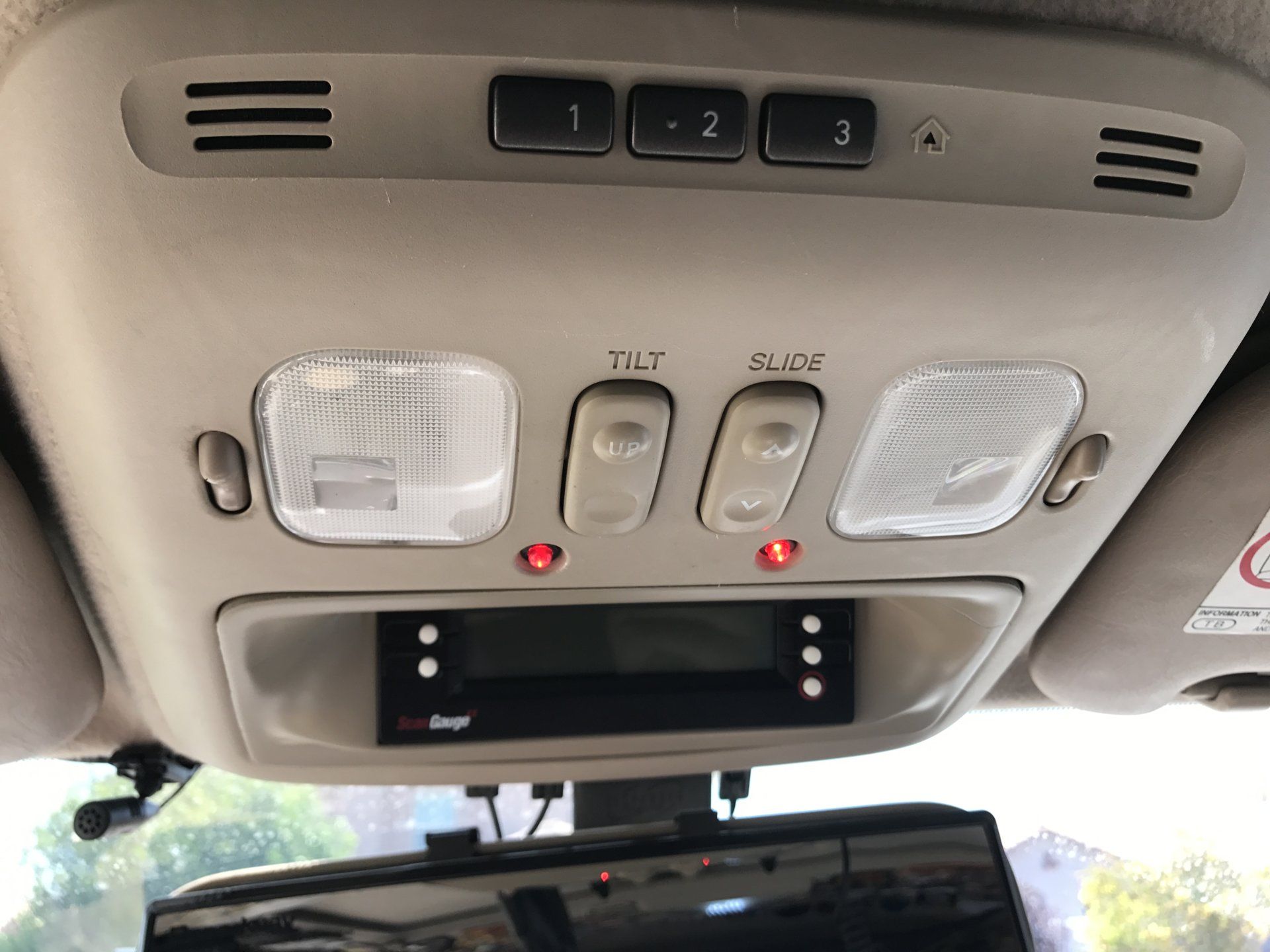

I got tired of waiting around for the ScanGauge II mount to be made. So I Spent the money on making upgrades to a friends 3D printer. He spent the time developing the part!
The black one is the prototype made out of ABS. The white ones are made out of PETG and should hold up better to the temps a car interior endures. This was the first test print with PETG. So we'll have to make some adjustments to get it to stop stringing and make it print smoother. Excited that it's getting close!
Productive day today!
1) Sanded, puttied, & primed the scan gauge mount.

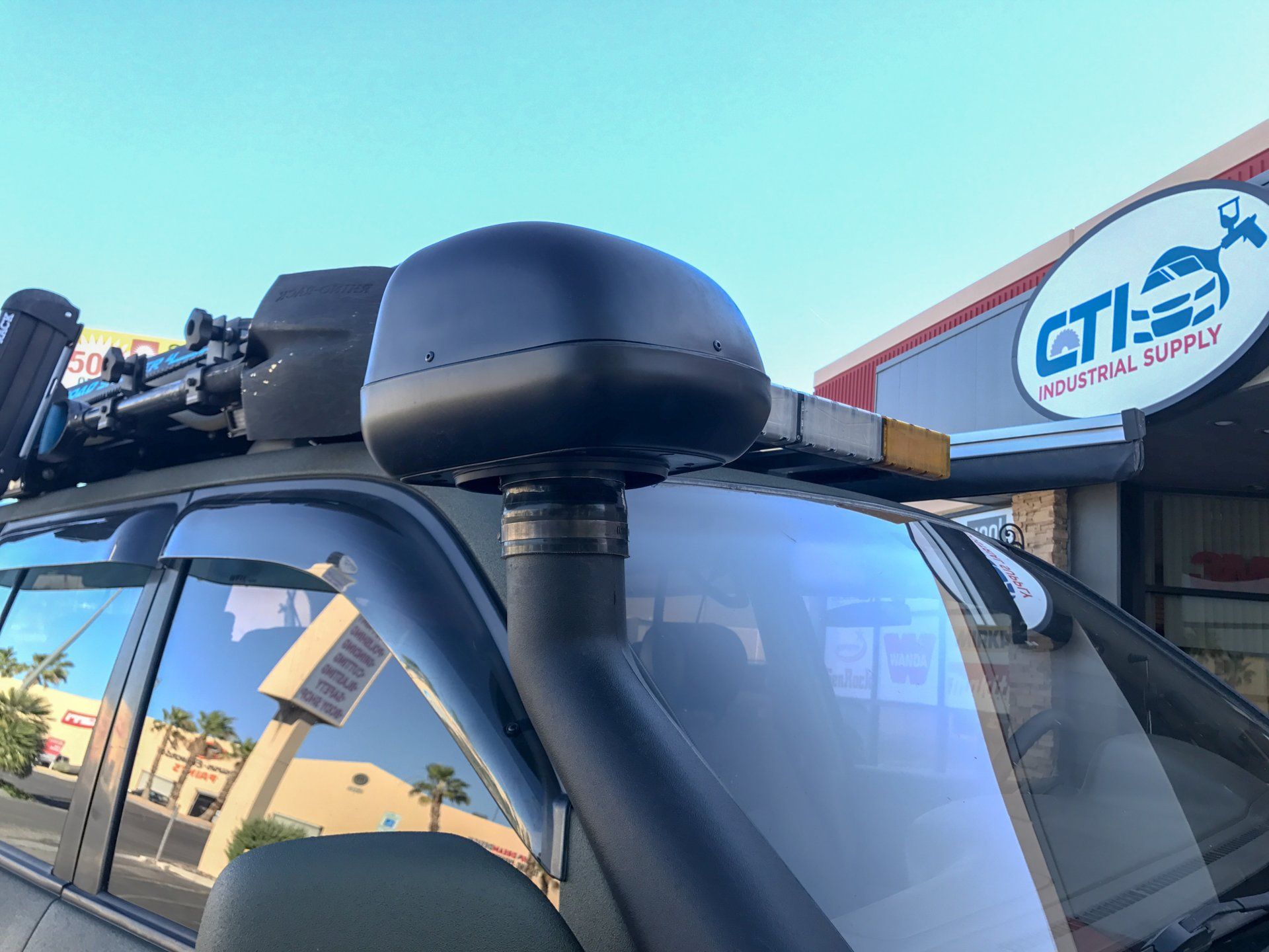

While emptying my Donaldson precleaner over the weekend I noticed it was loose. It has come loose a couple of times. So this time I decided to take it off and look at it. It was starting to crack at the mount. I started looking into precleaners & came across the OEM Birdfeeder style. The mount is a solid piece of plastic. It doesn't have the slits notched in it like the Donaldson does. So that should keep me from overtightening and cracking it. Did a little more research and found one for the 200 series. Part number 17730-51010. With the supercharger my 4.7L is actually close to a 5.7L. So it should be perfect for CFM's. Ordered that and a new coupler Sunday night. Both arrived today!

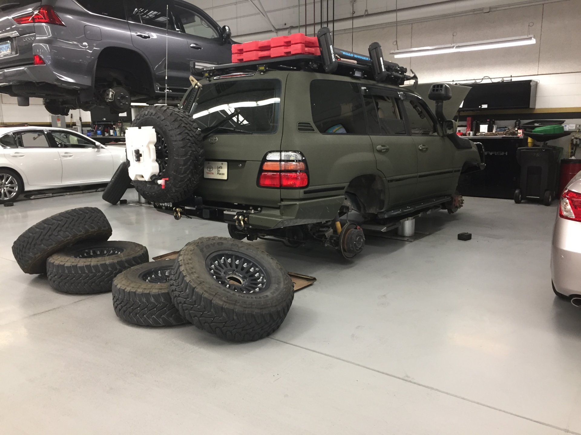

Just got her back from a long list of maintenance and repairs!
•Steering Rack replaced
•Inner tie rods replaced
•Oil dipstick tube replaced
•Header stud replaced (One of them backed out)
•Big hard brake line replaced (previous owner pinched it when installing the old sliders)
•Wheel speed sensor replaced
•Adjust parking brake
•Brake fluid flush
•Changed Transfer case fluid
•Changed front and rear diff fluids
•Transmission fluid was checked (still good)
