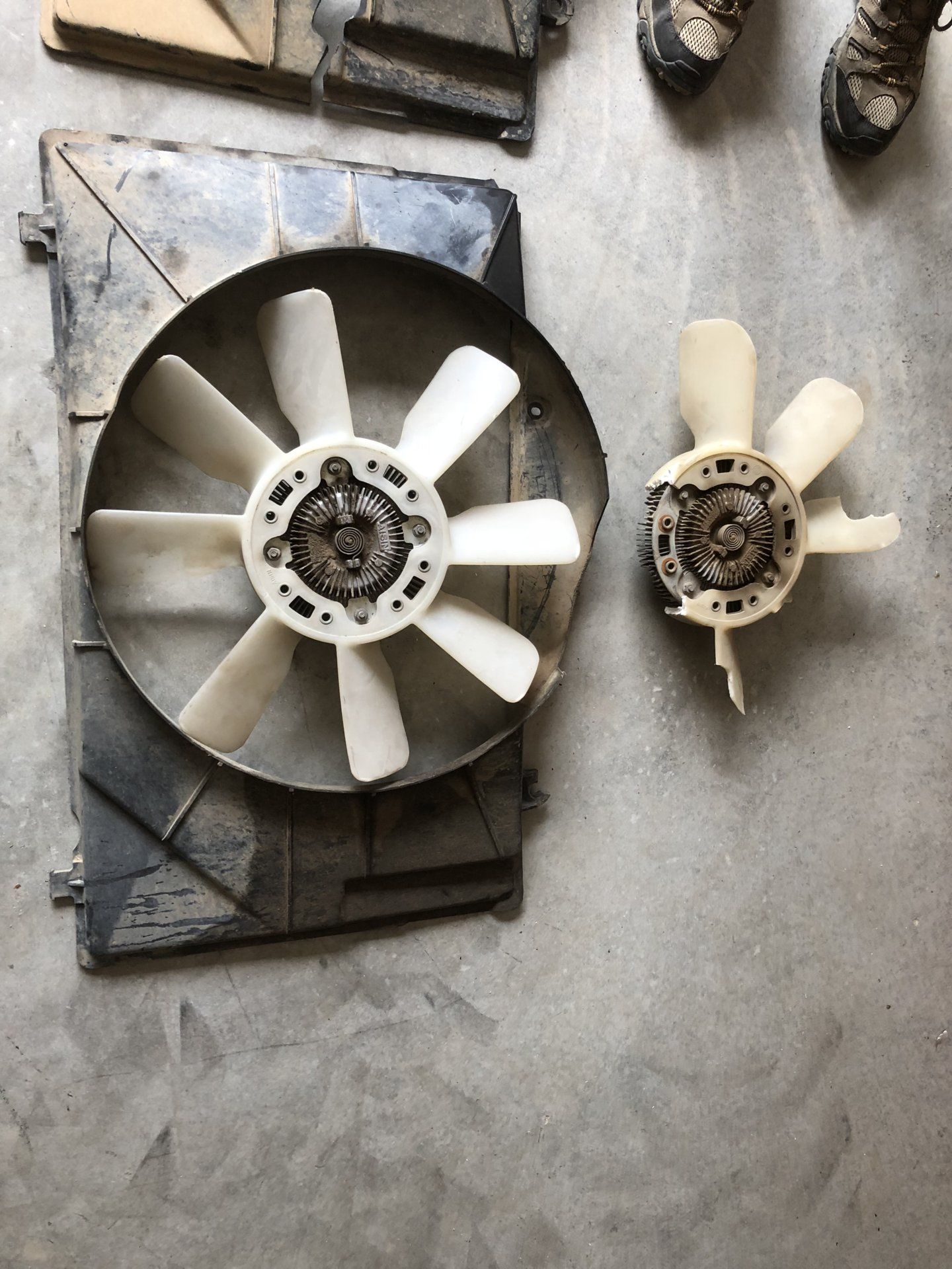

I wonder if your fuel pump or pump relay is starting to die. Bummer about the fan.
Might check your water pump. On some BMWs the bearings on the pump develop play and let the fan move enough to contact things. Also possible the blades were just old and failing. Might be worth looking at just replacing the fan with an electric one at this point but for whatever reason people on this forum don't seem to like doing that. Other car crews that have cars that had clutch fans like to replace theirs with electric fans especially because it takes load off the water pump.

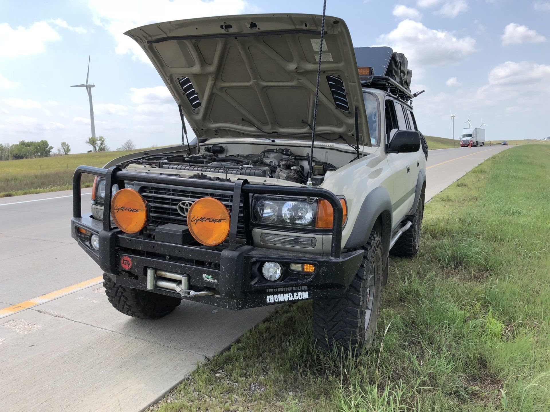

Made it home yesterday evening. This random shut off issue Ihave been having is absolutely frustrating.
To document what has been happening:
CEL light remains on when trying to restart.
Seems to happen at less than ~3000 rpms.
It has happened on both 100% gas and E10 gas.
Outside air temp has been as low as 40s and high as upper 90s from low humidity to extremely high humidity.
It has happened with as much as 3/4s full of gas all the way down to where it has a 1/4 tank or so. It seems to be most prevalent below half a tank.
It has happened while under load or while coasting and even at idle. When it starts to shut down it does it in stages like I am up shifting several gears over 5 to 10 seconds. Flooring the throttle does nothing but ihave found that pumping the throttle pedal rapidly helps delay the shut down but does practically nothing.
Has happened within a 90 mile drive but sometimes it’s fine for a 400 mile drive...more on that later.
At the start of my trip, along with making repairs, I replaced the fuel filter, fuel pump strainer, and charcoal canister. None of these have solved the issue.
Which leads me to several days ago. We left our campsite outside of Crested Butte around 8 am and drove over and down the Paradise Divide and into town. We had breakfast and filled up the cruiser with e10 87 with Lucas fuel injection cleaner. I always add this in with ethanol gas as it seems to help.
We set out for Pearl Pass. We drove for several hours and by maybe 11 we had reached a decently fresh rock slide. I put the cruiser in park to scope out the slide and that’s when it shut down. I popped the gas cap and there was a little bit of pressure. Probably about normal considering the drastic change in elevation.
After letting it vent and cool for 20 or so minutes, we hopped back in and I was able to get it to fire up albeit with rapid pumping of the accelerator pedal. Without pumping rapidly, it would want to just die. Once it seems ok, I’d get the RPMs up to 3000 and hold them there for maybe 10 seconds. Then I would be able to let off the accelerator and it idles smooth and without hint of issue.
We continued on and this issue never presented itself again on Pearl Pass; However, it did show up again later that day. Probably 6 or so hours later, we were descending Independence Pass and it shut off again as I let off the gas pedal for a tight corner.
I pulled into a large pull out and opened the gas cap. We waited for 15 minutes or so and I was able to get it to start up and did the usual rev to 3k and hold for 10 or so seconds and then drop to idle where it seems fine. Within 100 yards of driving, it shut down again. I pulled over again and repeated the wait time and procedure. From there we drove all the way to a friend’s place south of Denver without issue.
Yesterday morning, we left my friend’s place around 6:30 am and the cruiser performed flawlessly for 400 miles.
Somewhere outside of Ellsworth, Kansas, in a one lane construction zone, the cruiser randomly lost power and began to shut down. Luckily I was able to get off the road. I repeated the procedure and it started up only to die maybe a half mile away. Repeated the procedure and once again made it another half mile or so before it shut off. On the third try and after roughly 35 minutes, the cruiser had a hard start where pumping the accelerator didn’t really help. The next turn of the ignition and the cruiser started up like it does normally without even needing the accelerator pressed. We drove 20-30 miles and I filled it with 91 octane 100% gas thinking maybe this thing does have a mind of its own and it will appreciate this gas.
I guess it did because we drove the remaining 270 miles or so without issue. We had stopped for gas several times in that drive and I also bought a spark plug tester in Salina but obviously didn’t get a chance to use it.
