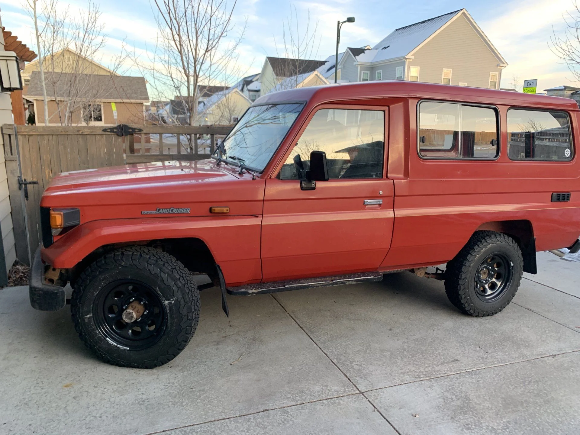

After purchase from Steve in Boulder, I've been messing around a bit to get a feel for the thing. I'm not mechanical, so any mechanic work will be completed by Robbie "powderpig" in Boulder. First thing was transfer case rebuild, tie rods, and water pump. Then replaced all hoses in engine. Oh, and put a oil pan warmer in...greatly helps with cold starts. Then, my batteries died on me, so those were replaced. Due to the split rims and agricultural tires, I bought new rims and tires - made a good difference as the old tires were stiff and provided no shock absorption...or traction on ice.

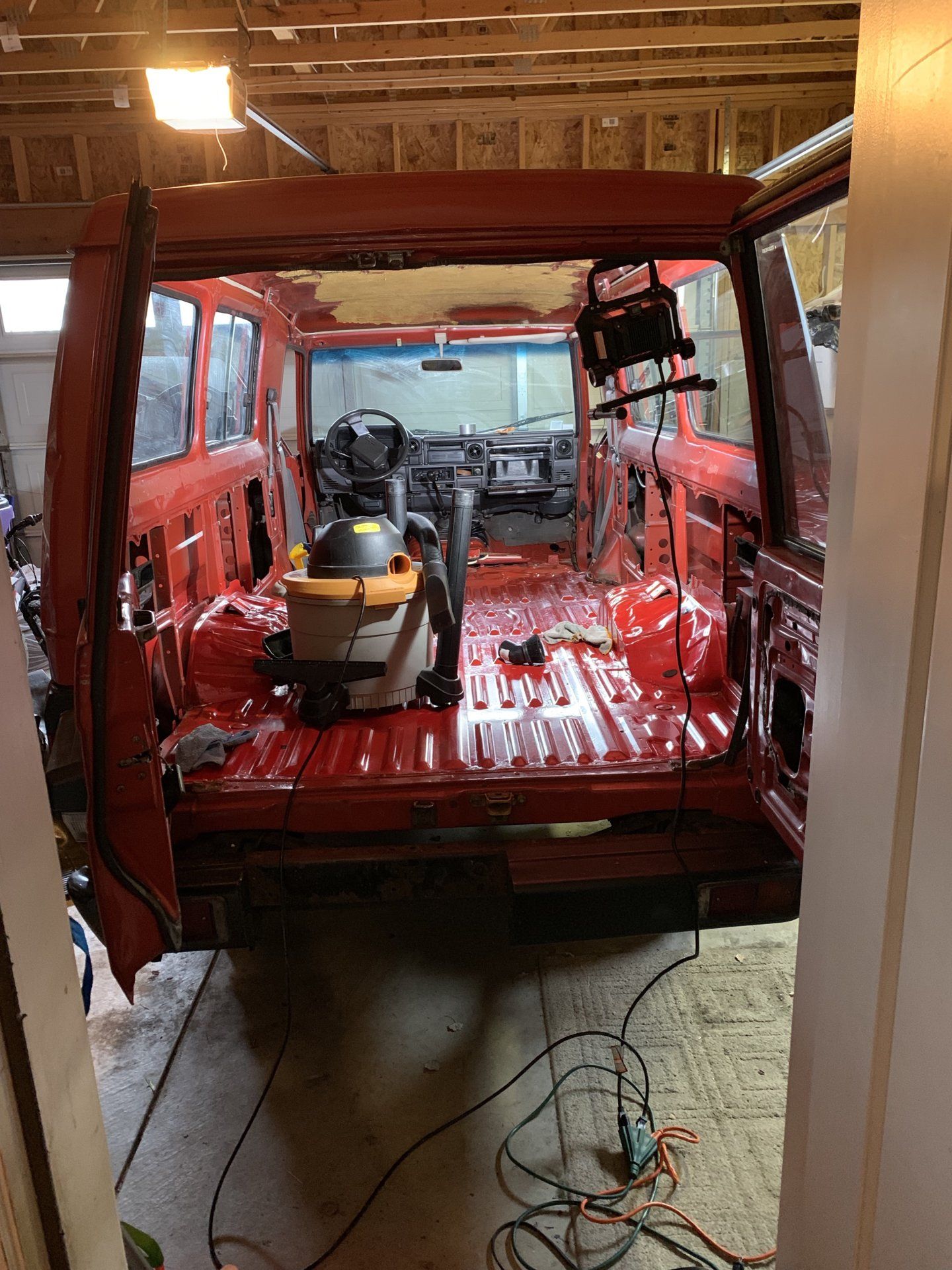

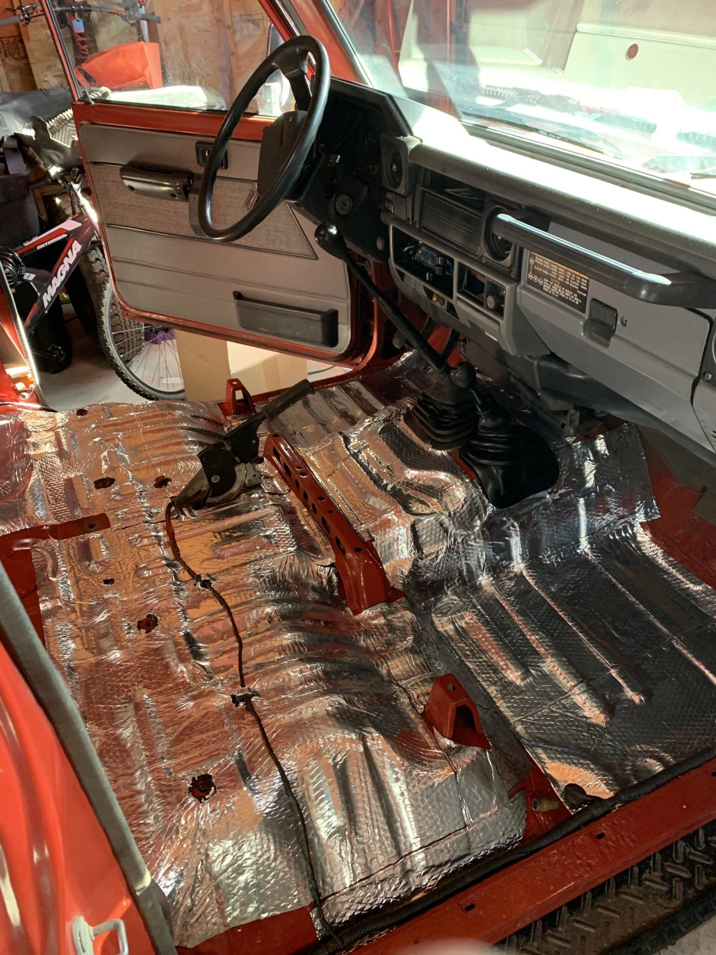

For stuff that I am capable of, here's what's next. I plan to soundproof the inside with NOICO 80 ml and add a homemade headliner. I bought some auto foam-back fabric for that. I purchased an oem bedliner from a mudmember and plan to add a soundproofing layer to this as well.
Future plans include new suspension, bodywork to cut out and replace rusted panels, cut new interior panels, and repaint.

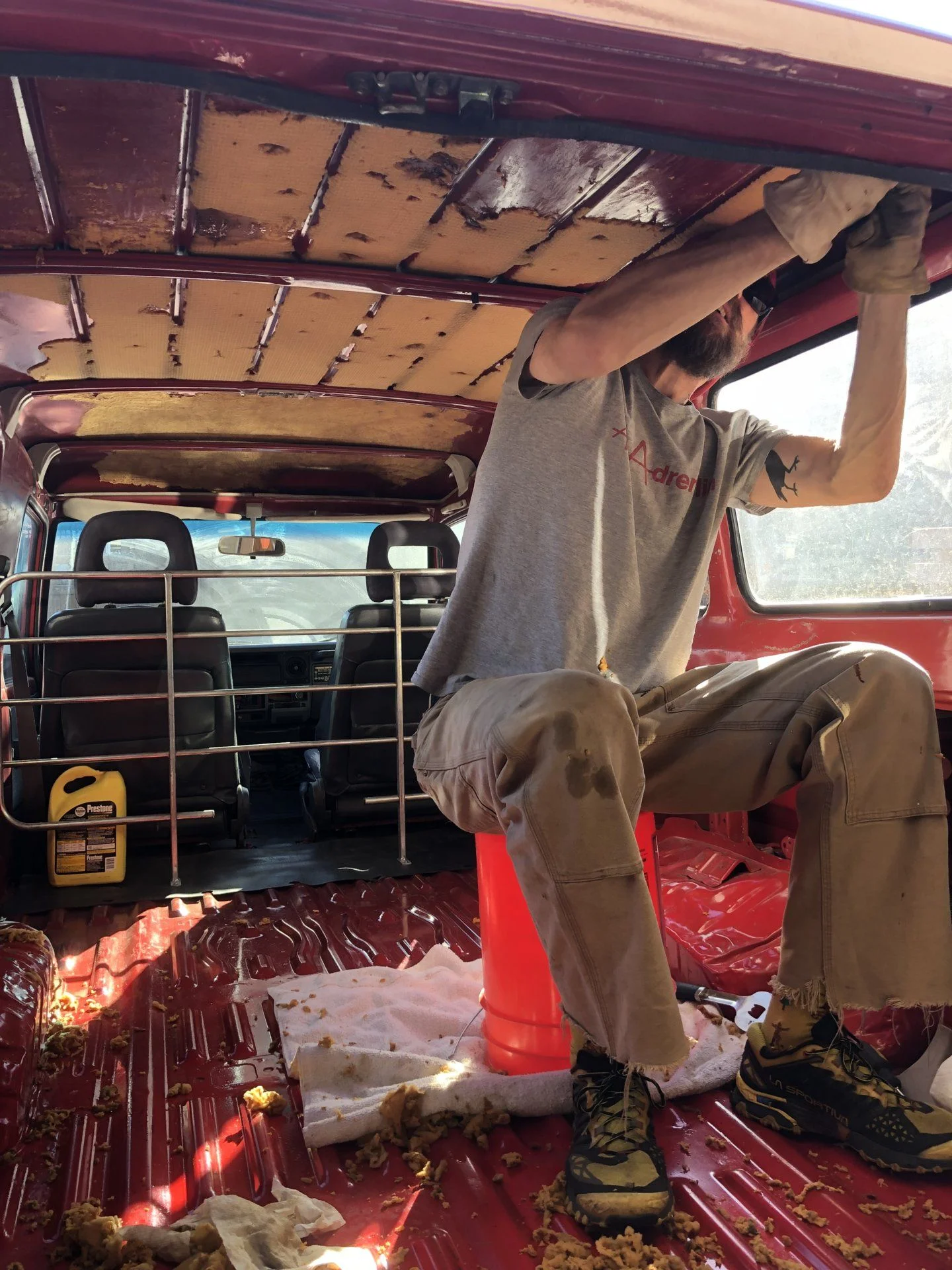

Not so fun trying to get the old foam and adhesive off the roof.

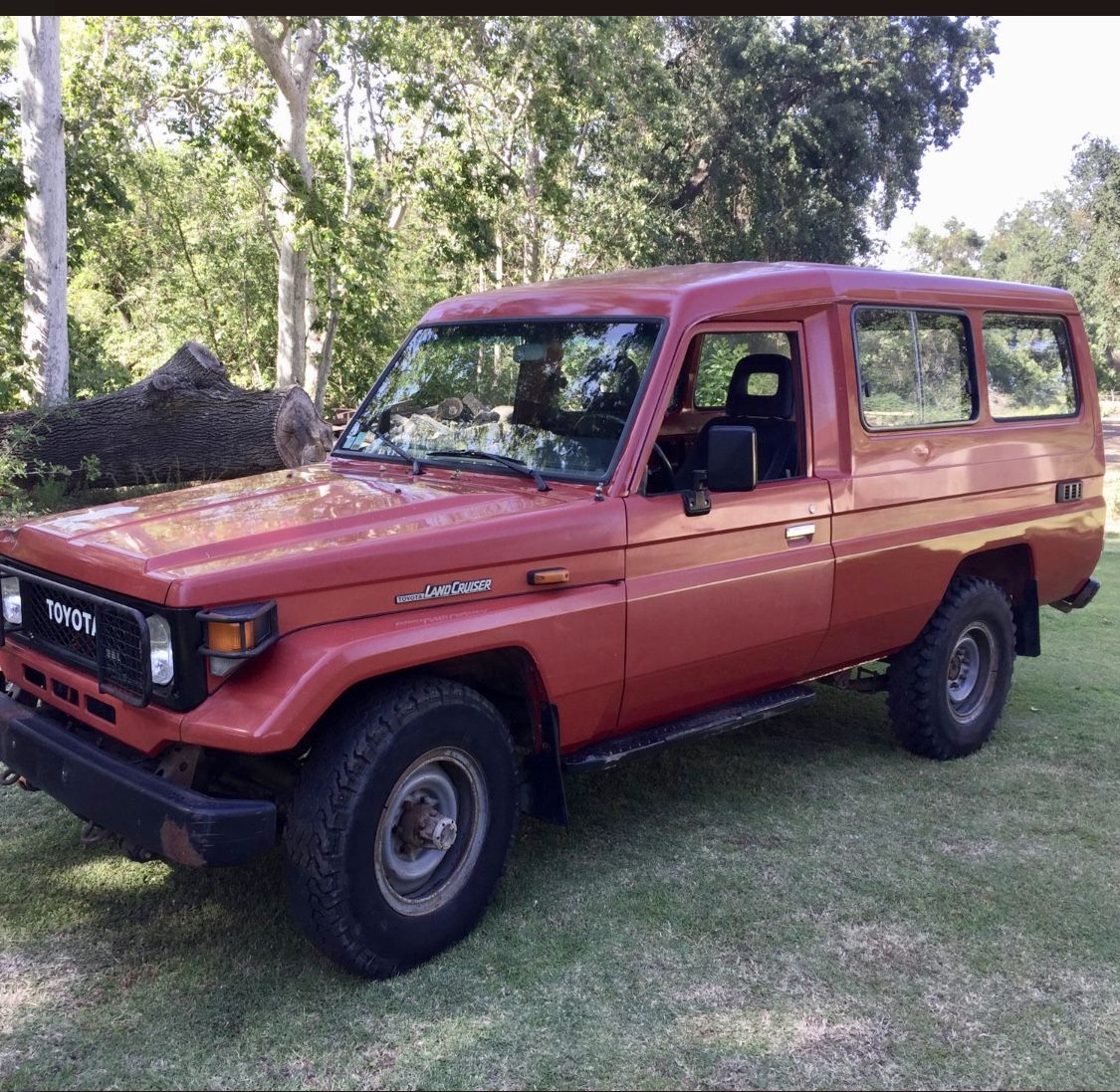

P.S. You don't have any of your own photos, you gotta re-use mine? lol....:p
Lol....It's so good though!
