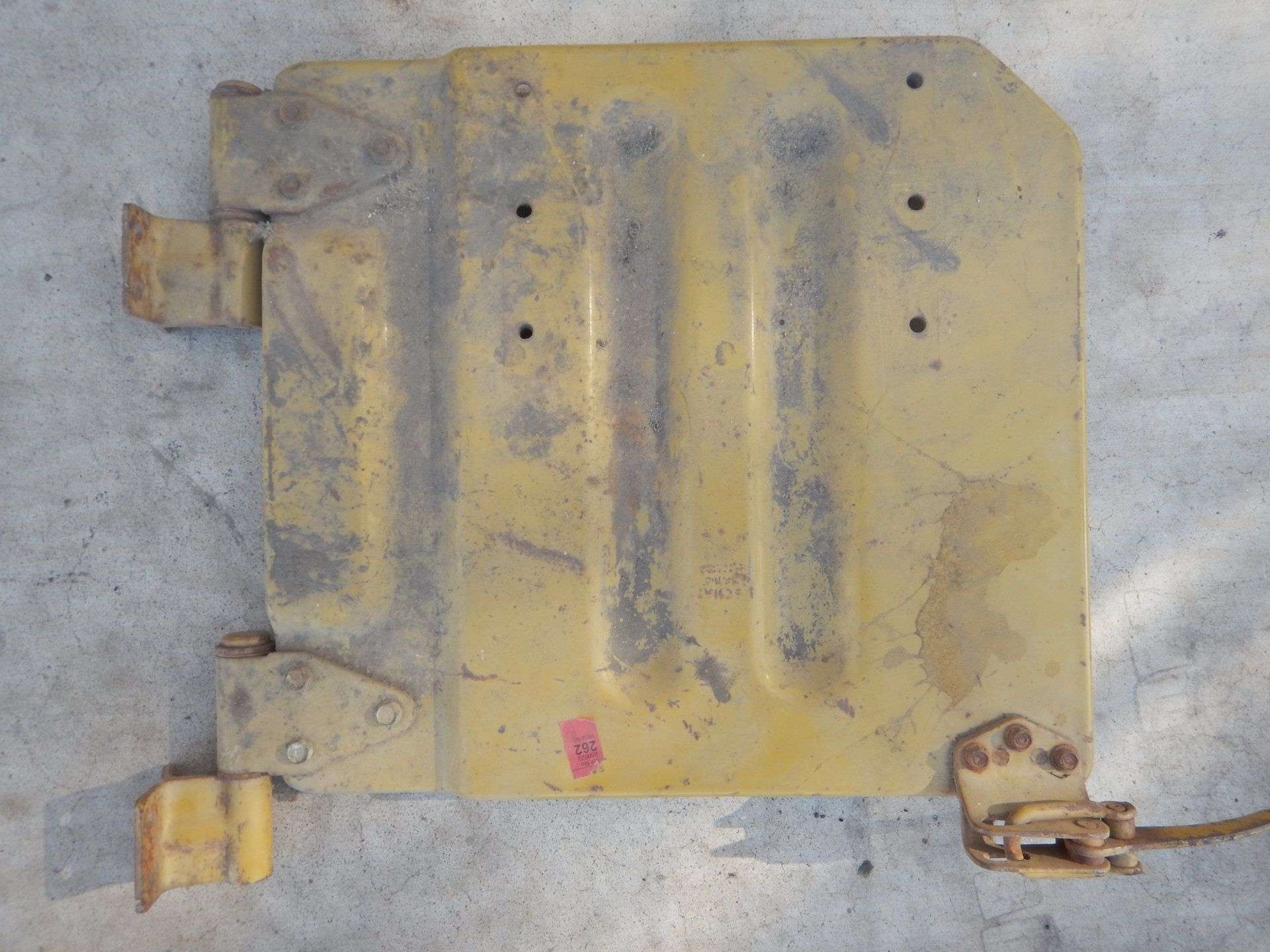

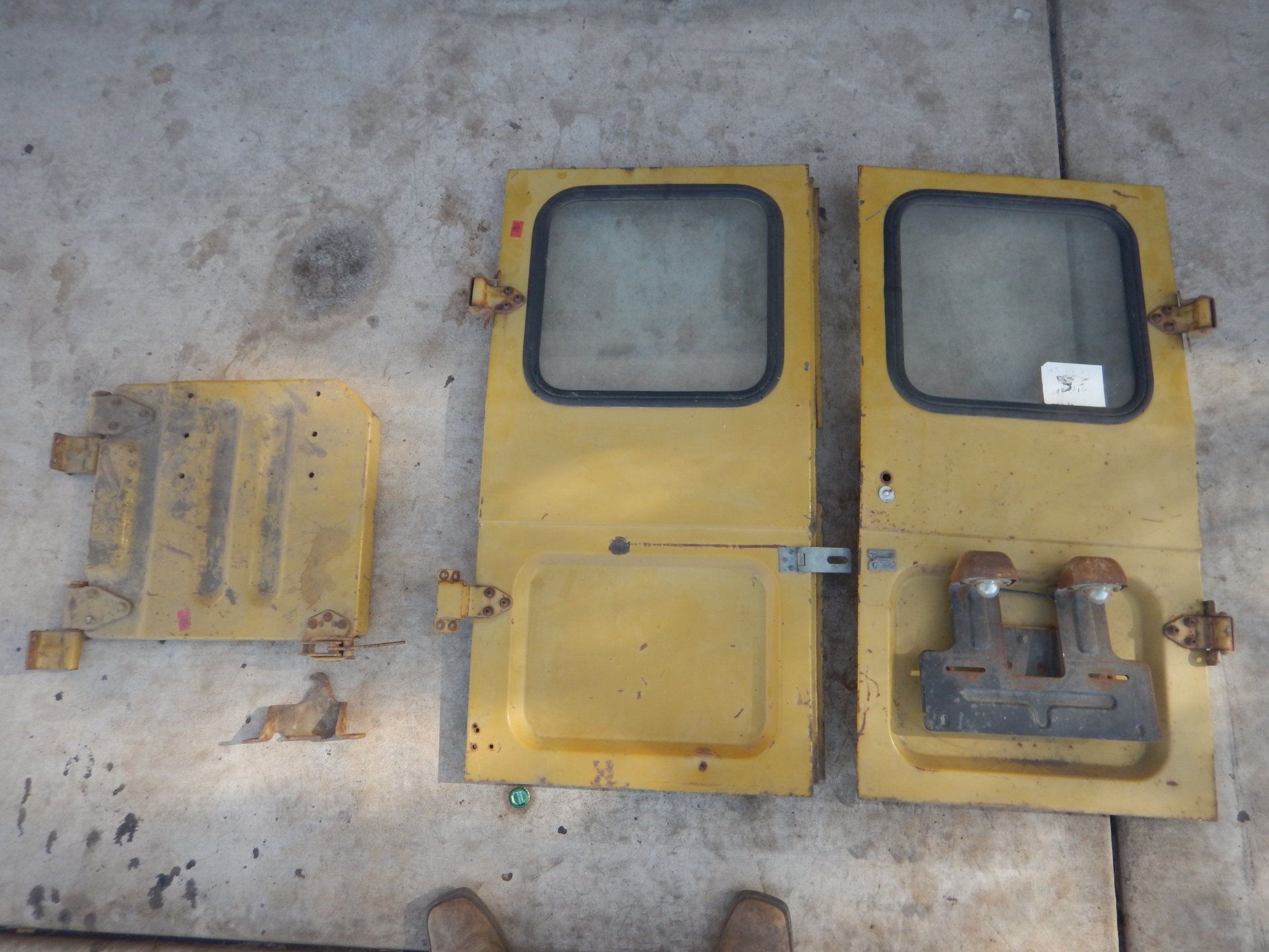

took some pics of my rear ambulance doors and tire carrier. they are nearly complete set, hinges latches glass all the good stuff. will post pics later. i also have the j panels and rear door header its pretty much complete ard top set minus the top, im keeping that. i want to get rid of the T/C, ambi doors, and j-panels in place of correct year panels and doors. gunna take it all down to btb industries here in las vegas see if they will work with me if not gunna post it in the classifieds and on craigslist.
pica i promised

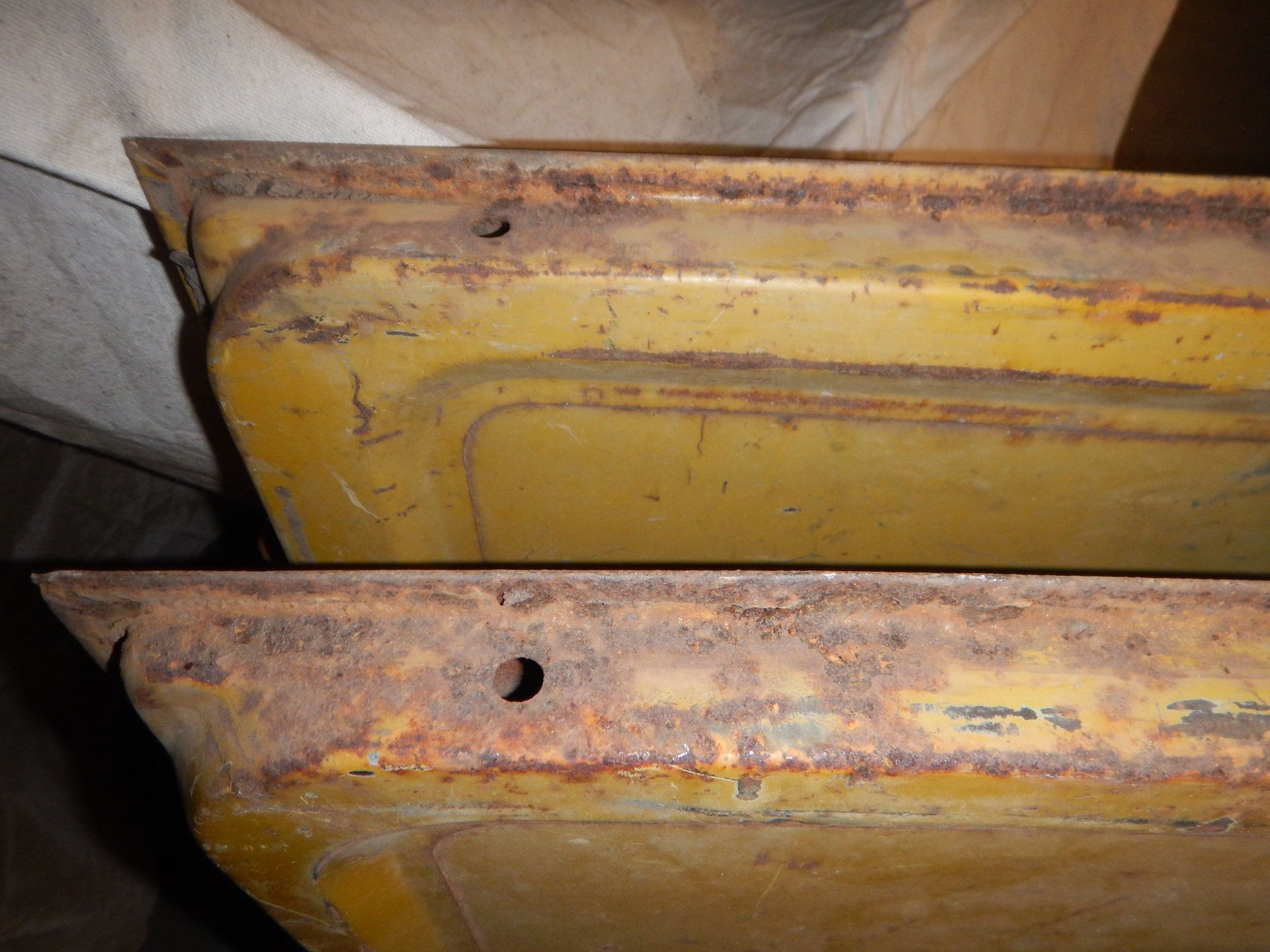

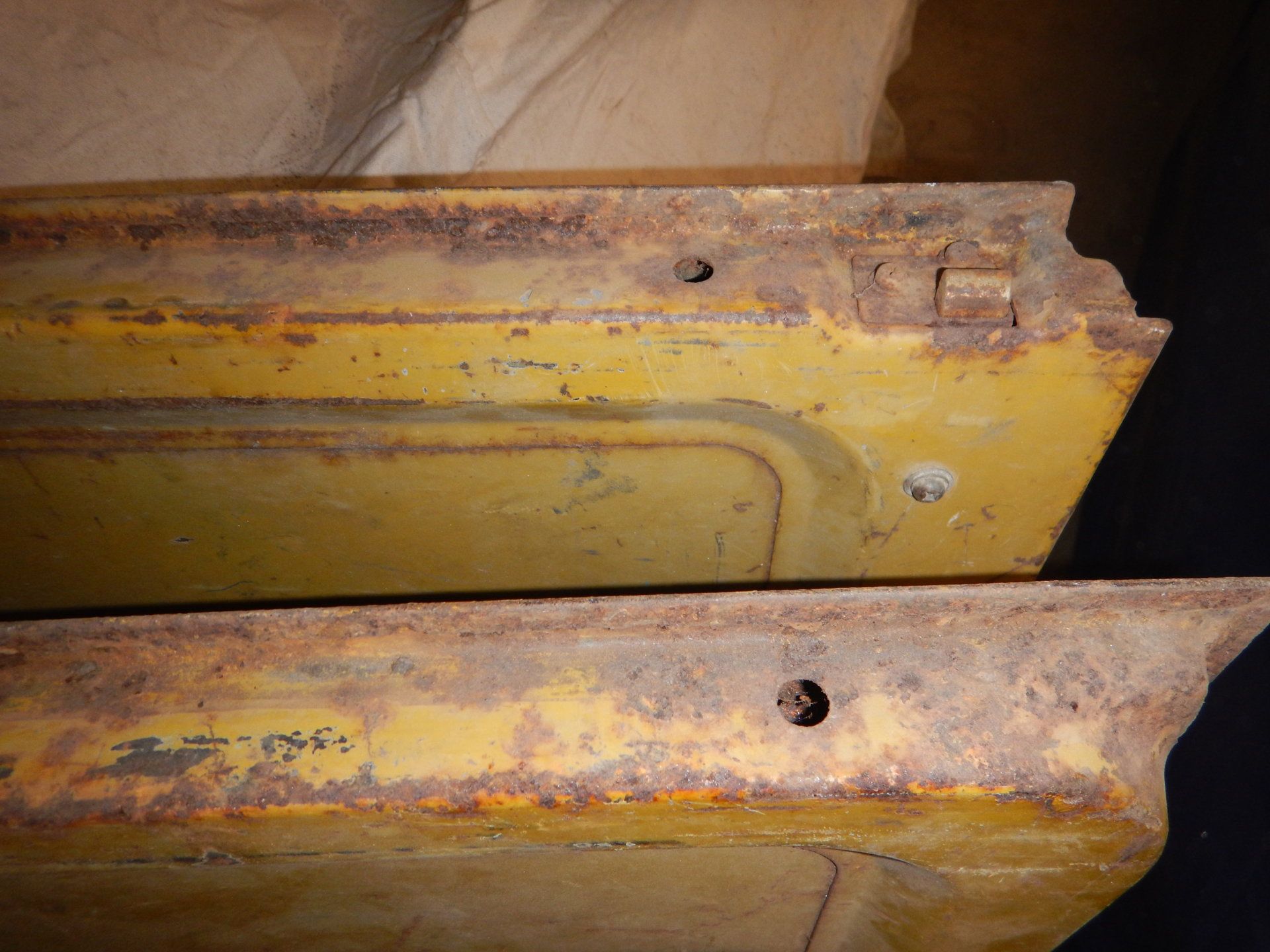

@CoFarmer might be interested in your ambi doors. How do your ambi door bottoms look?
Those Door headers are often rotted on the ends that butt up to the hard sides. Does your header look good? You probably know you’ll need an earlier door header with pockets for the hatch hinges.

they are pretty good ill take a couple pics and post them in a bit. there is a little rust but not very bad at all mite be a bit of pitting but must just surface.
