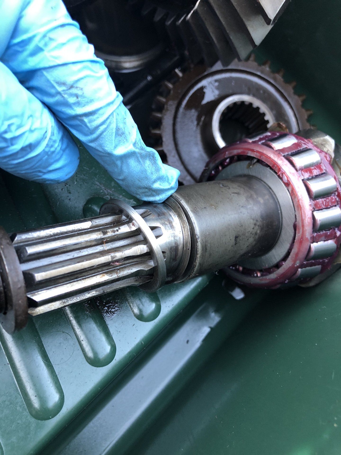

I had to re-do a partially rebuilt differential somebody else started and walked away from. The pinion was binding up/not turning freely by hand as you’re describing. The differential I was dealing with did not use a crush sleeve to set the pre-load for the pinion. The pinion has a washer and shim to set the pre-load and then the depth is adjusted using shims underneath the inner pinion bearing race (see photos). After disassembling the pinion I noticed the original shim behind the new bearing race was a different inner diameter and was rubbing against the bearing pressed on the pinion pictured below. I removed the bearing race, read the thickness markings printed on the shim and double checked it with my calipers. The rebuild kit came with a shim pack having shims with inner diameters matching the bearing race of the rebuild kit. I used the corresponding shims from the rebuild kit and reassembled the pinion resulting in the correct preload/no binding.
If this is what happened to your rebuild, then the shop is basically going to need to redo quite a bit. Once the pinion depth and bearing preload is set; then the carrier needs to be setup to mesh the gears properly (backlash/contact pattern).
