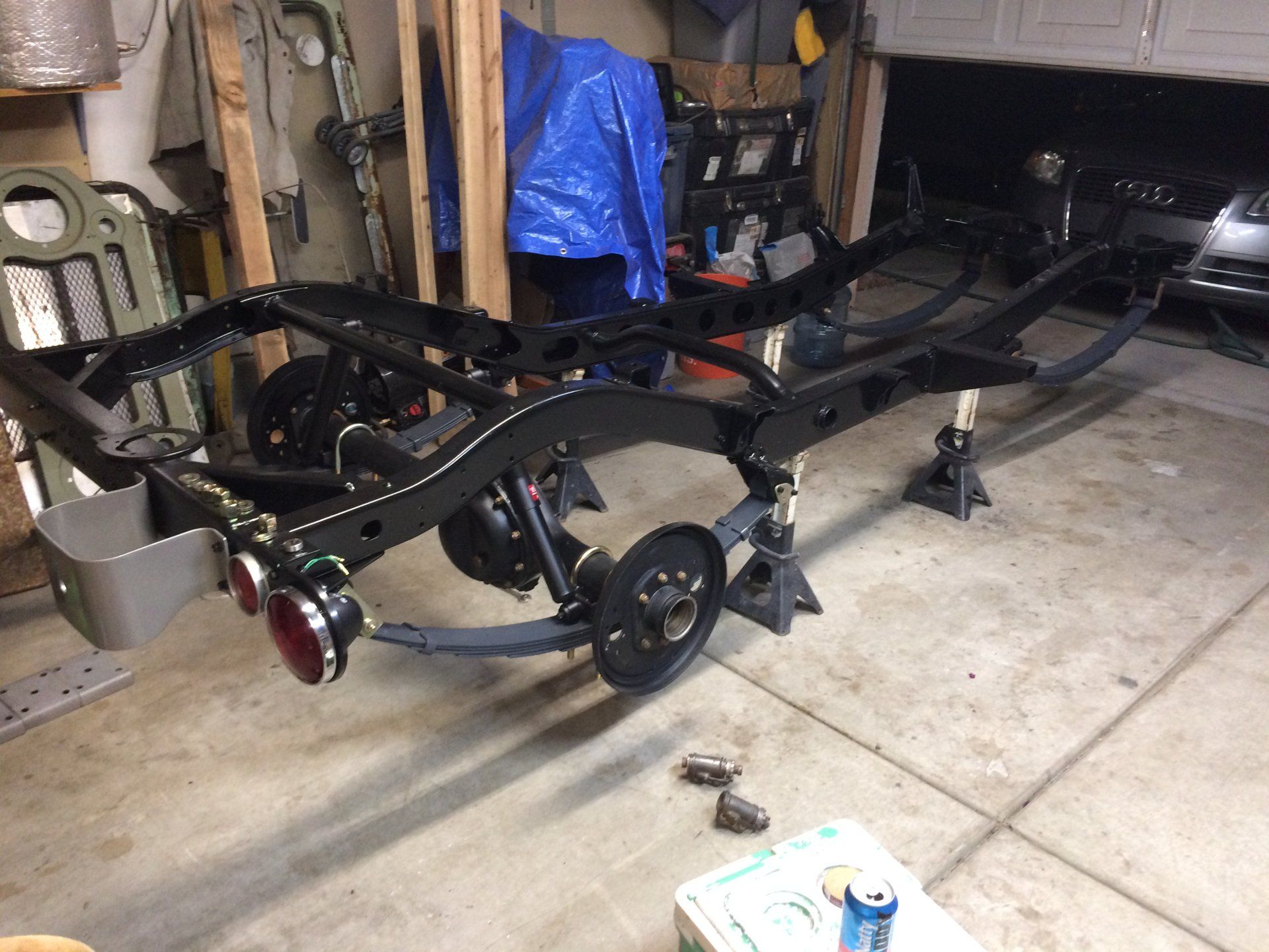

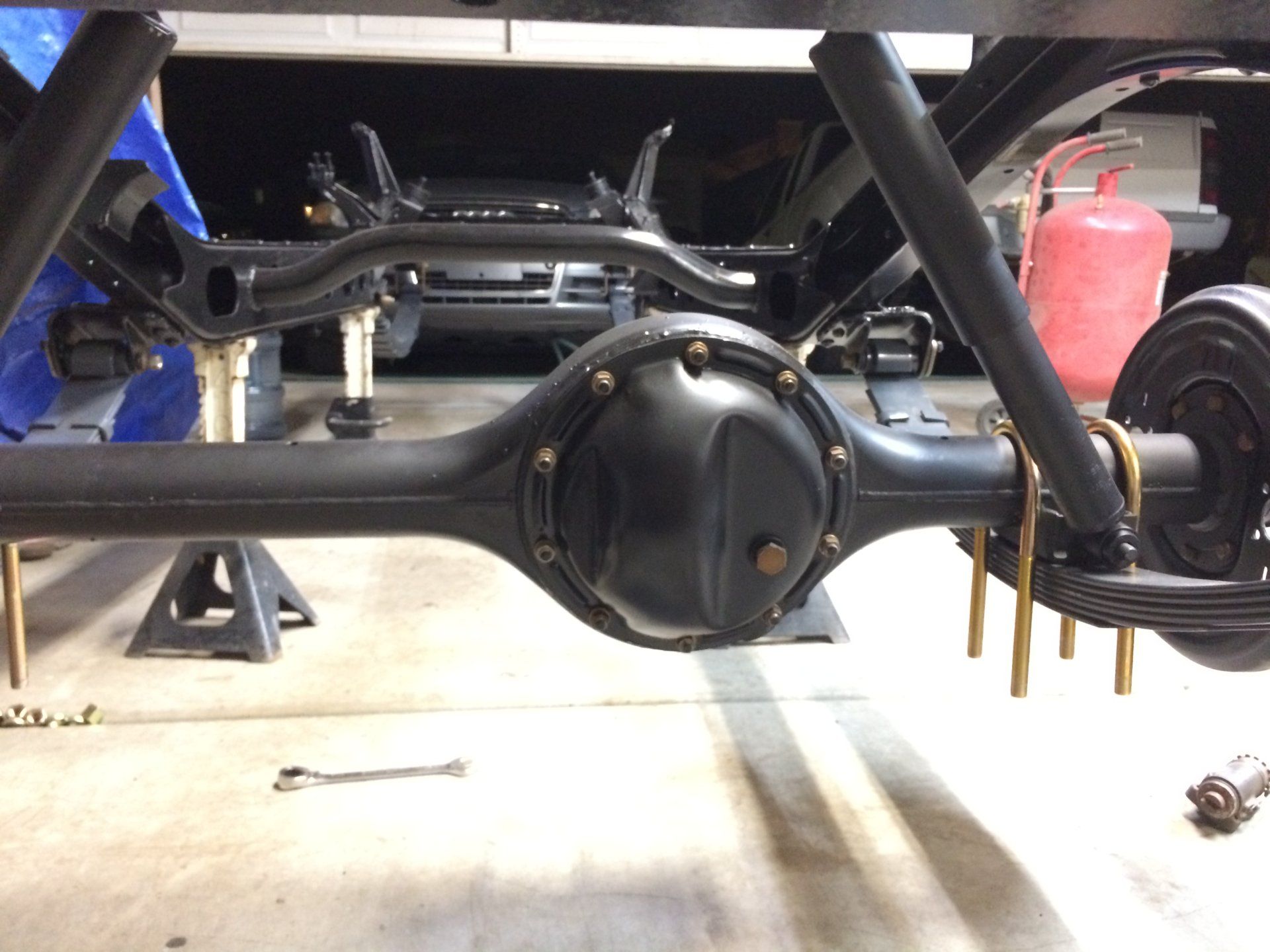

Got a little bit done today, finished zincing and chrimating nuts and washers fit the rear dif, and cleaned the garage. Attached a finished spring to the frame to see how it looks. I like it I think it looks professional lol
Shins for both knuckles were identical for upper and lower
More shots of the finished frame with rear shocks, and housing attached for looks, 1 bumpertte and some lights. Oh the feeling of a job well done can’t be beat. I’m so proud of my creation!

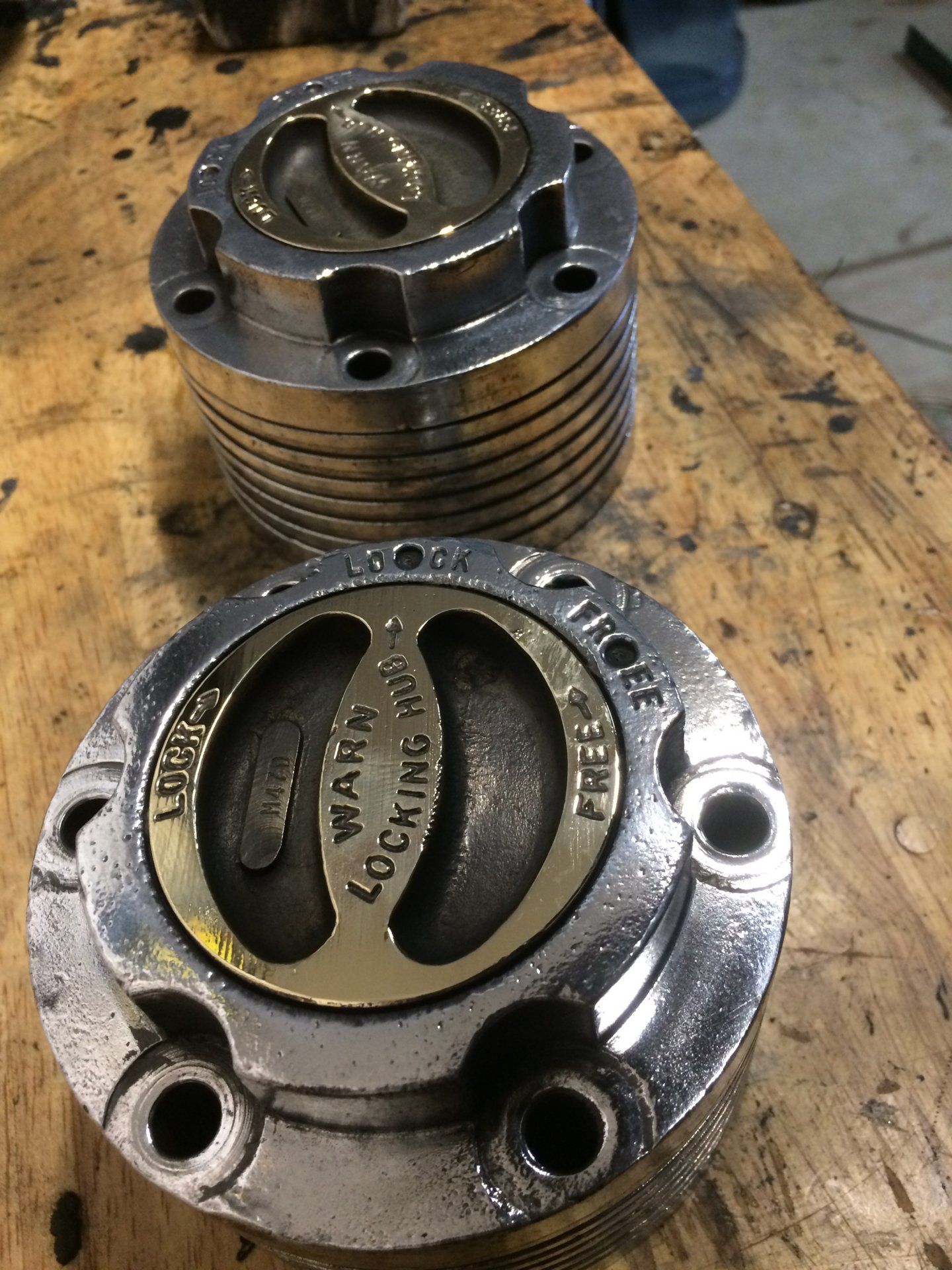

Also got started on the disassembly of the front axle and knuckles, a lot easier then I thought but taking things apart is easy, putting everything back together with out pics priceless!
been grinding hard at work, got a litlle bit done. painted fron axle housing and almost al under carriage components, got all my bearings and seals for axles just looking for the time to put it together.

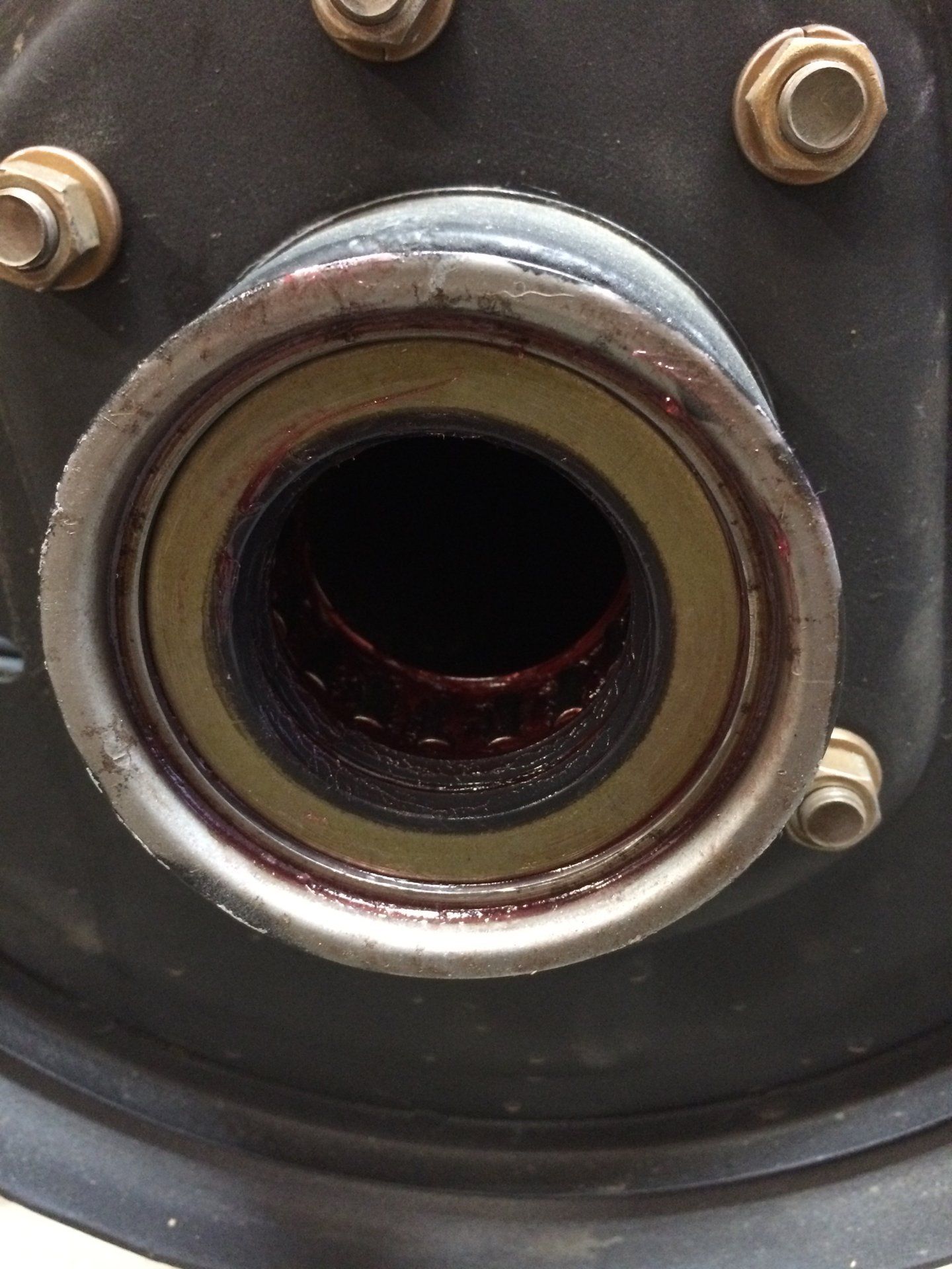

I need a little help with my rear end ha ha Ha. Space erase, no but for real though I really need some help with my rear end so I was putting the axles back in and I try to put the sea clips into the spider gears axle thing and axles don’t penetrate the spider gears enough. I’ll attach some pictures please help my rear end Needs a lot of help!!
Because this is my first time doing a repair like this the only thing I can think of is that the bearings and seals are not in all the way I will attach a picture and maybe somebody can tell me if they’re in all the way.
Please help guys it’s Saturday night you can’t all be drunk already:beer::beer:
