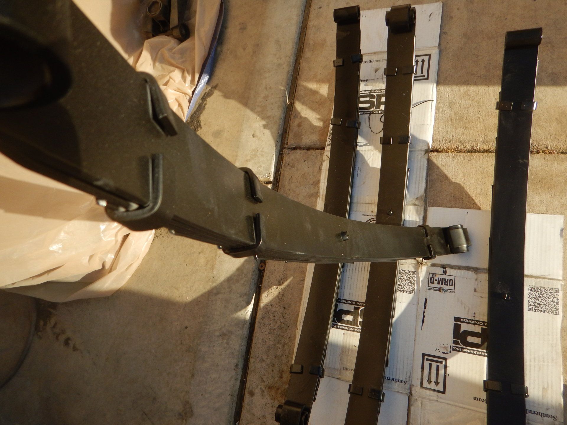

got some painting done over the weekend. shot 3 coats of gray epoxy primer on all the parts then a black sealer coat. i want my undercarriage components to have a satin or dull finish so i was advised by the company to add no more than 50% acetone for the dull look of the sealer coat. some parts came out glossy some dull. i sprayed to heavy and i guess it flattened out the dull. gotta spray it thin i guess. the leaf springs i wanted a darker grey so i mixed some gray and black together and came up with a machinery gray here are some photos of them black and gray. gunna shoot the housing again with another sealer to try and dull the finish again since i kinda know what to expect.

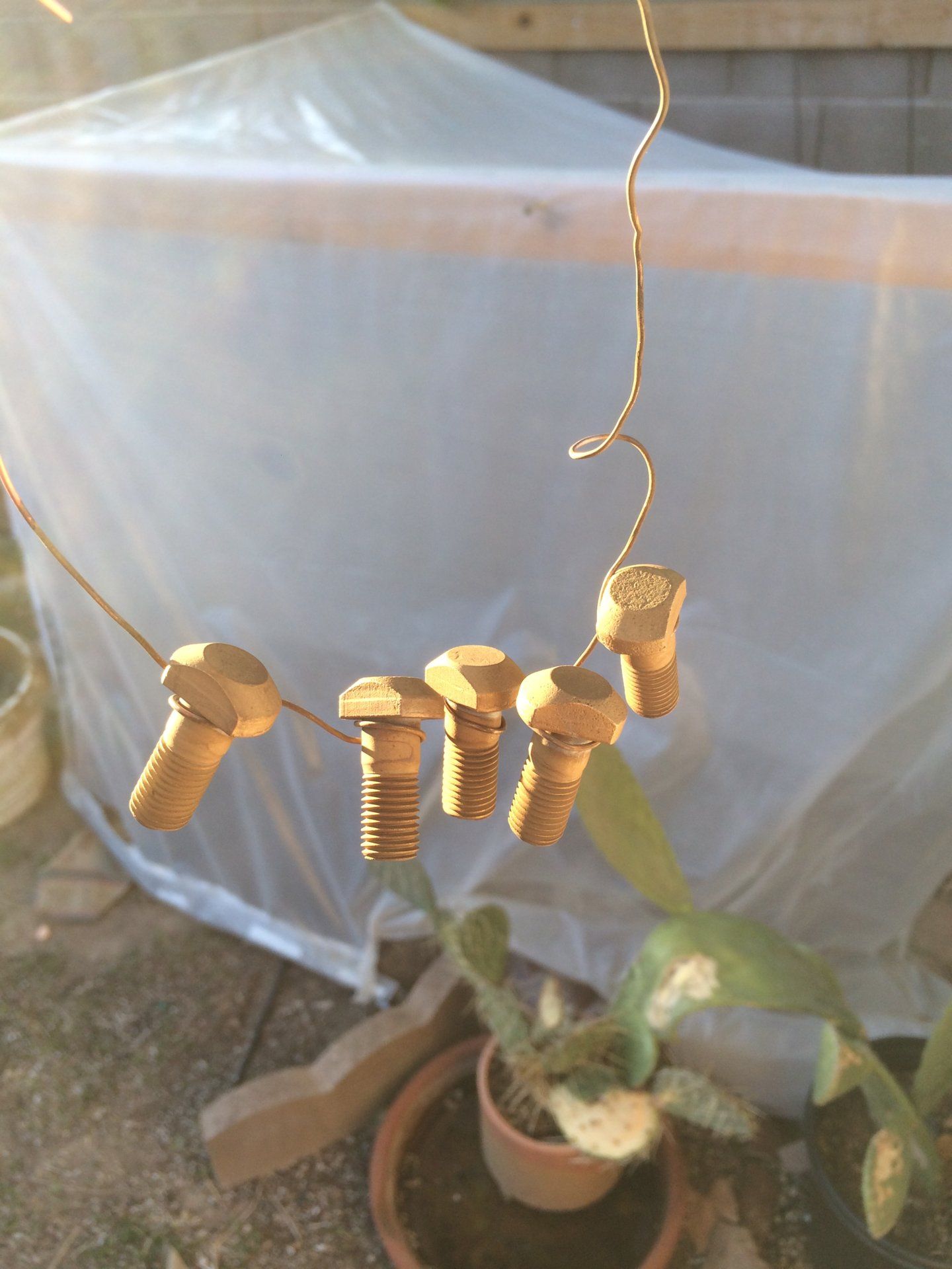

So I was experimenting with chromate colors and came up with a dark flat bronze. I really like it and plan on doing most of my nuts and bolts with this color. The down side is I lost one of bolts pictured.

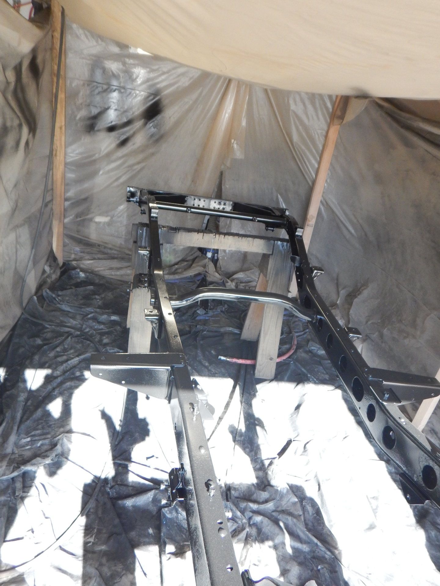

got the frame epoxied 3 coats this weekend and a sealer tomorrow. wow what a mile stone! i feel like a huge weight has been lifted. looks good to.
still got some knuckles to rebuild and a rear end to put together but once that is done ill have my rolling chassis done. a little behind schedule but a huge accomplishment none the less!
