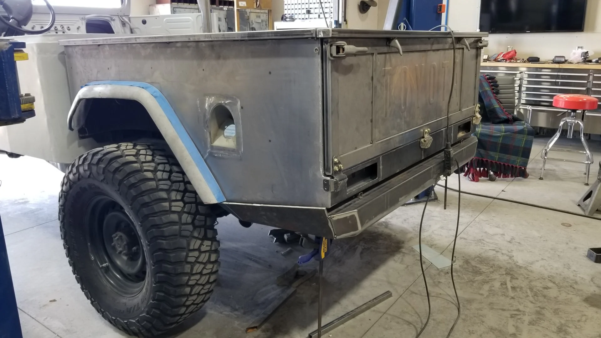

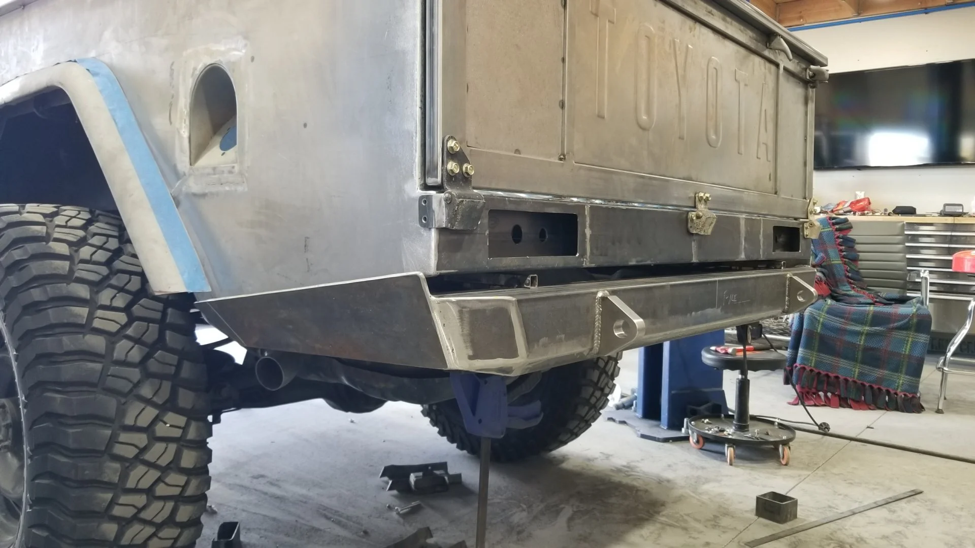

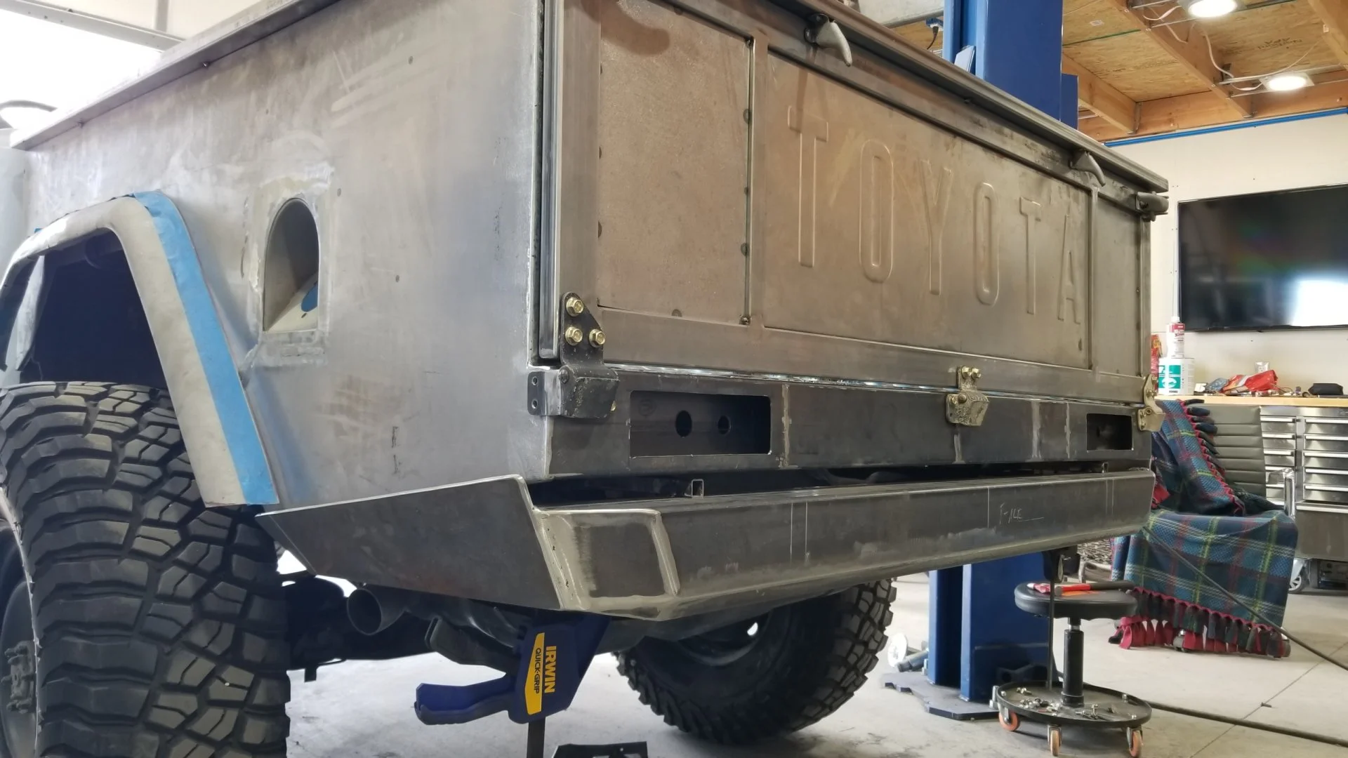

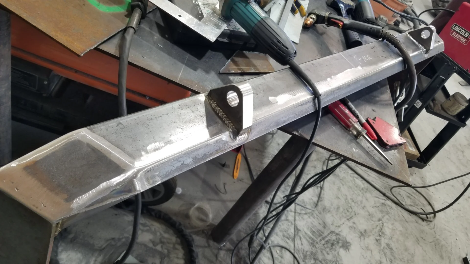

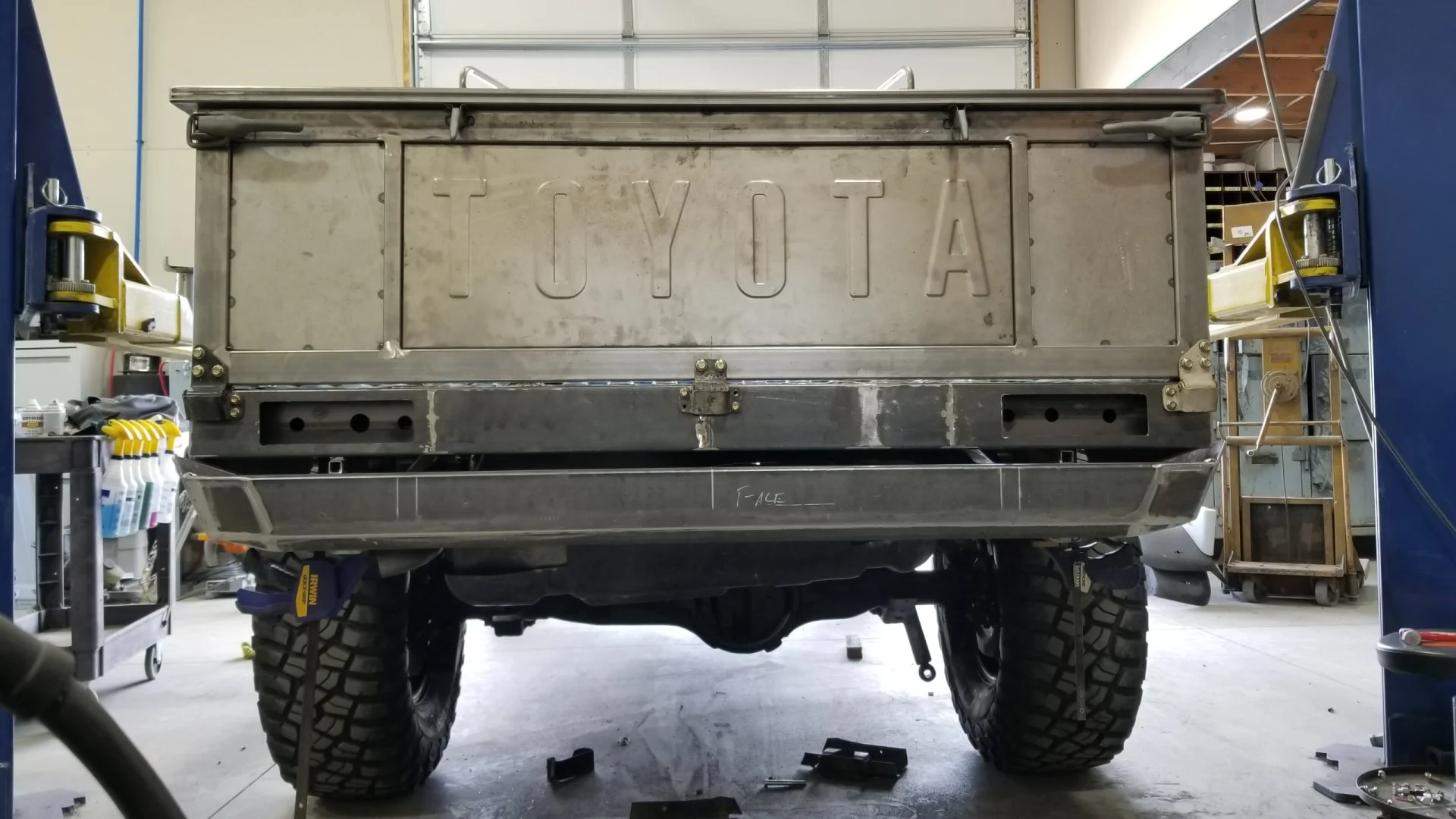

Let's build a rear bumper...

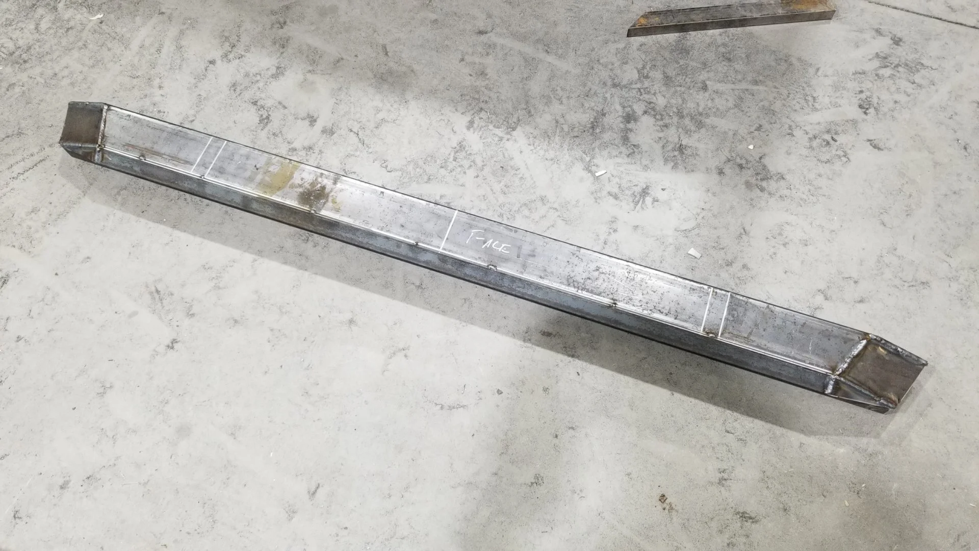

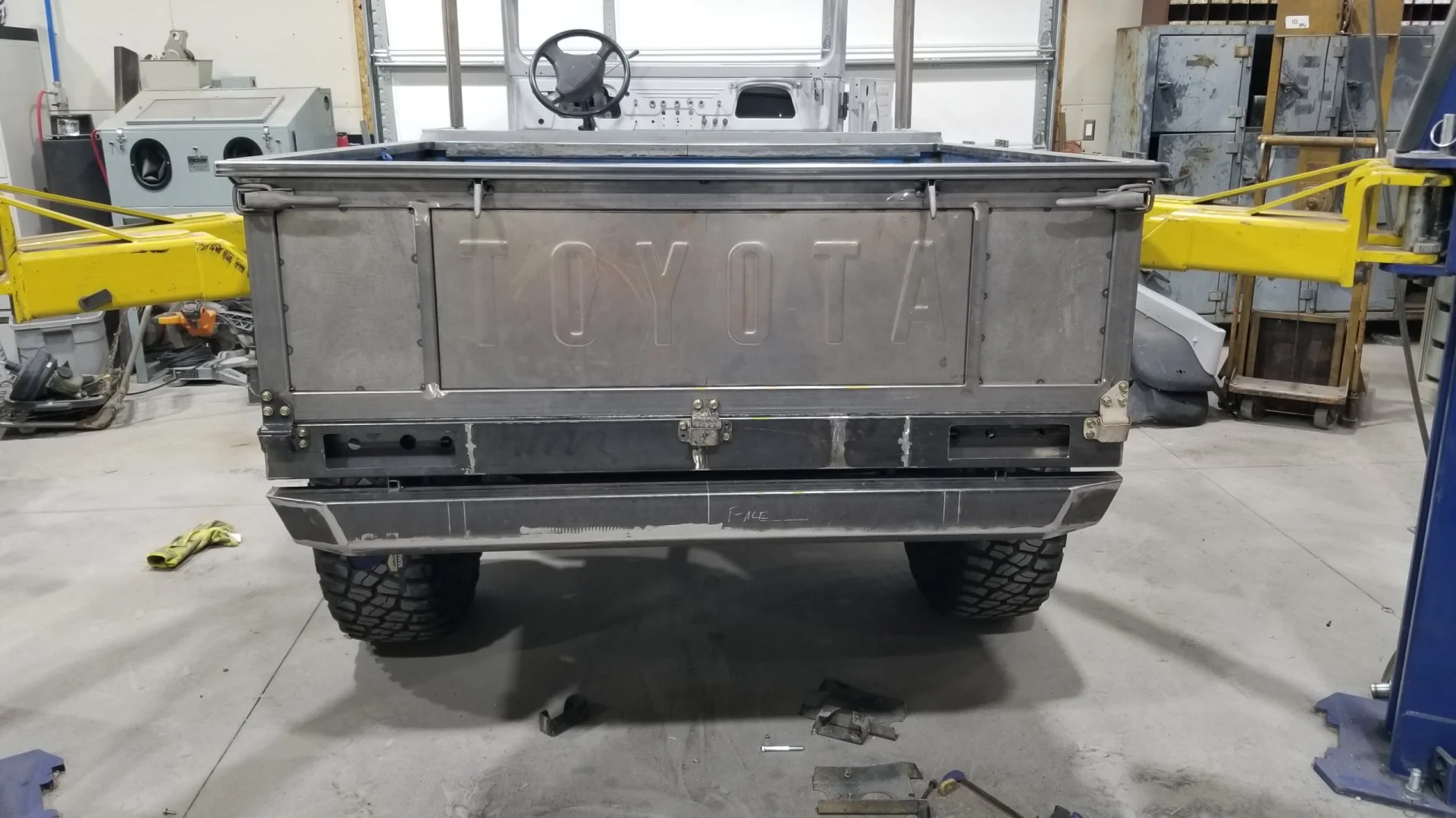

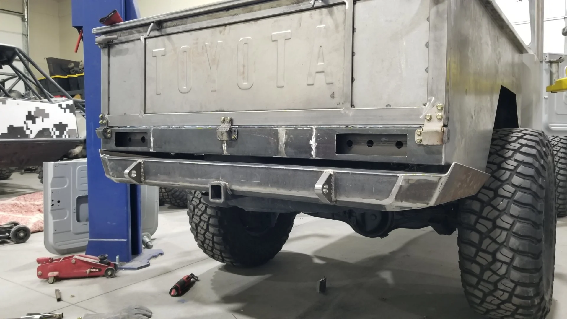

Started out by using 3.5x3.5" 3/16" square tubing and a small strip of angle on the bottom -
Cutting the edges to get the angle I'm wanting to achieve -
Pretty much like playing arts and crafts with 3/16" metal -
All welded up -
And cleaned -
Test fitting -

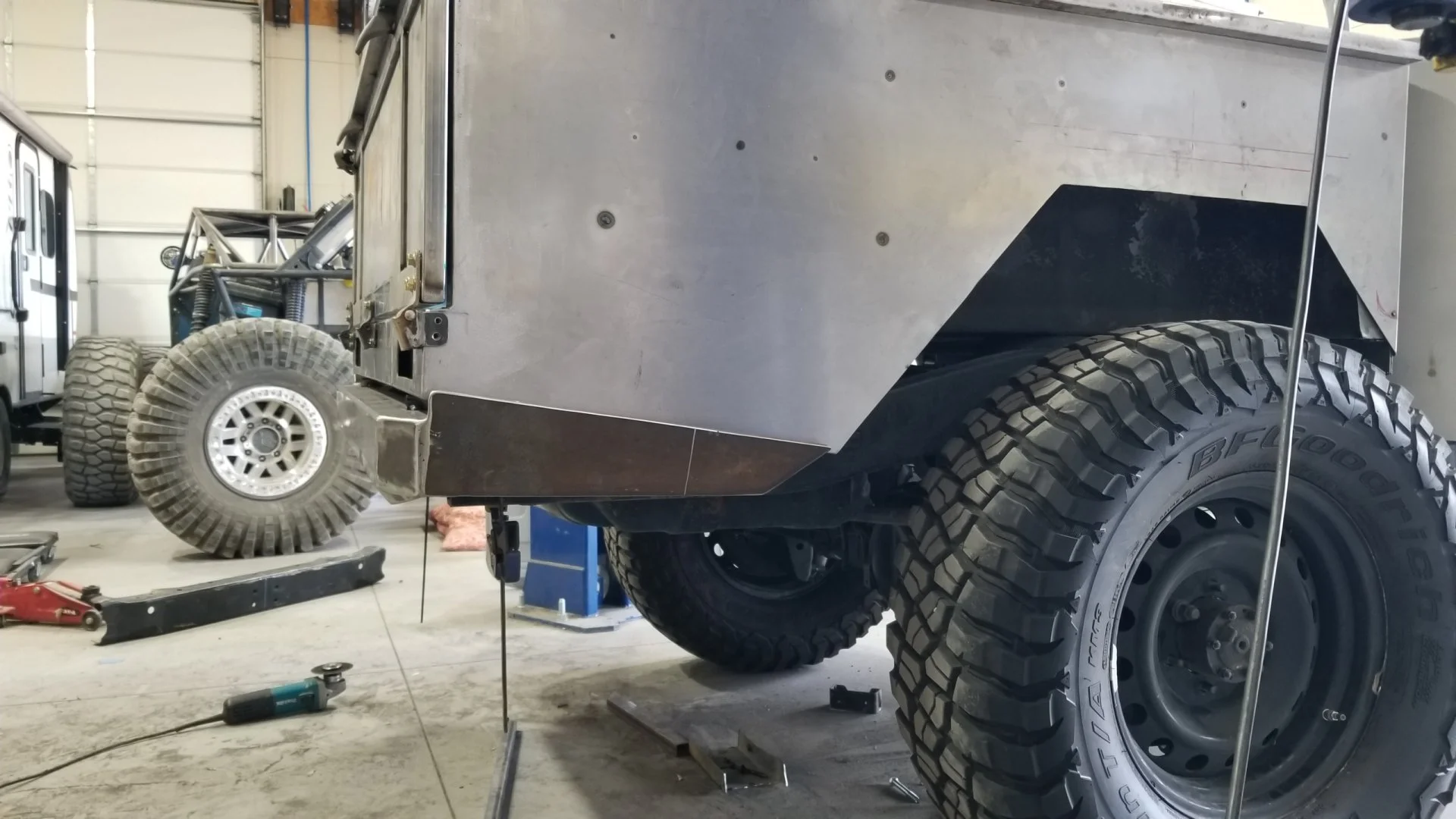

Adding side protection -
Welded in and cleaned up -

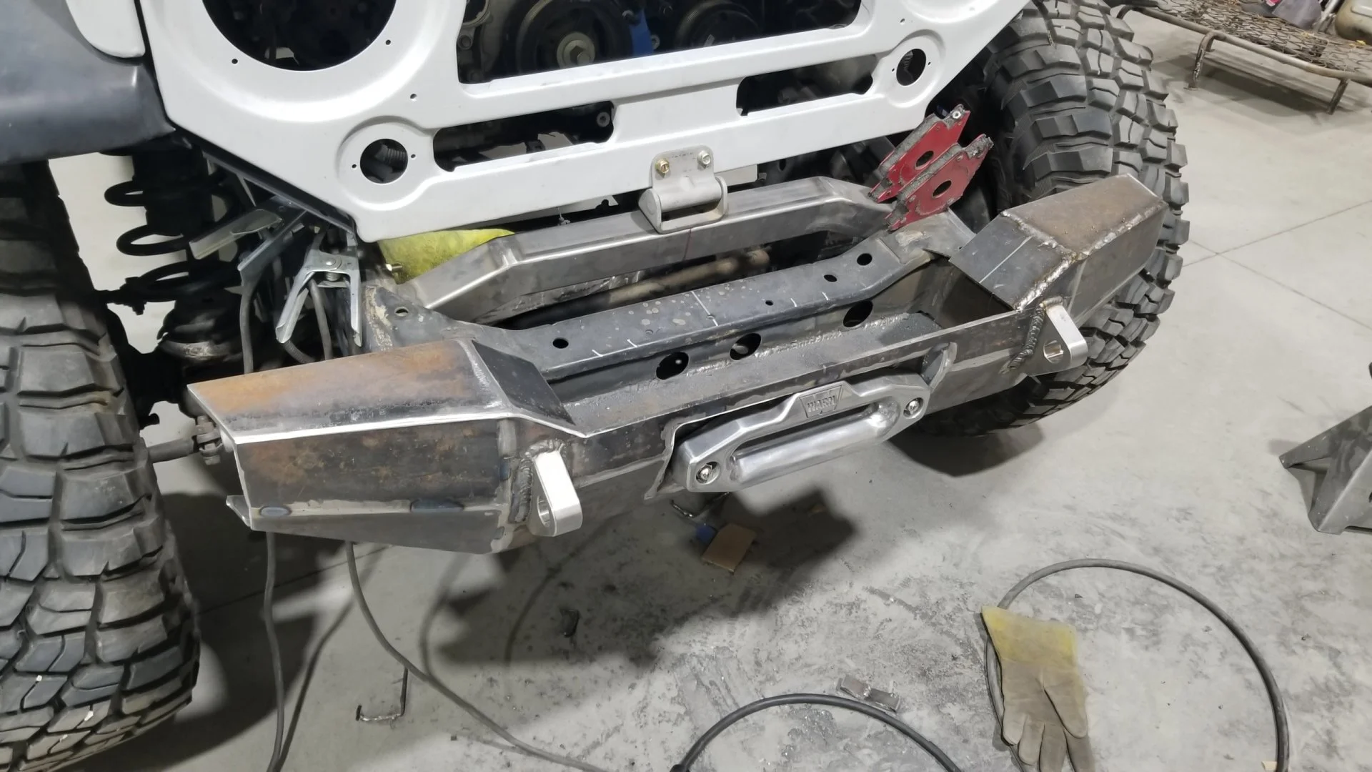

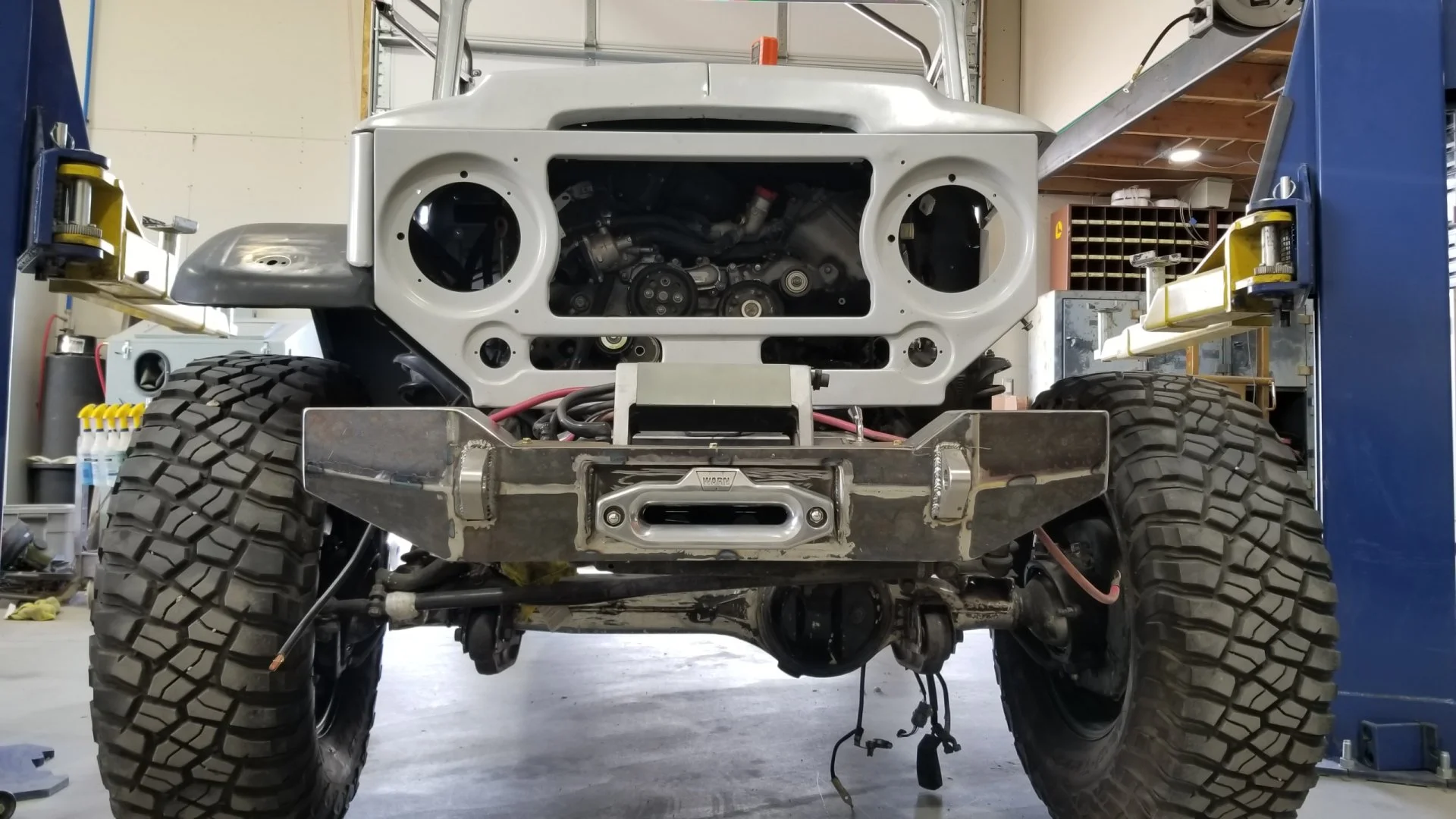

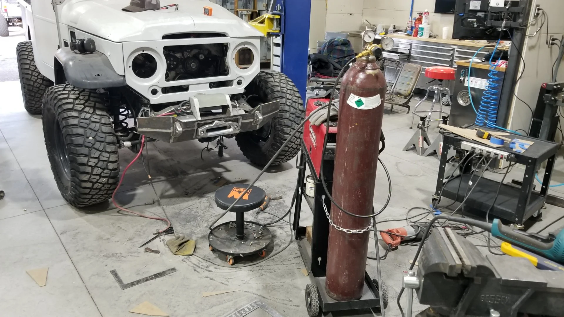

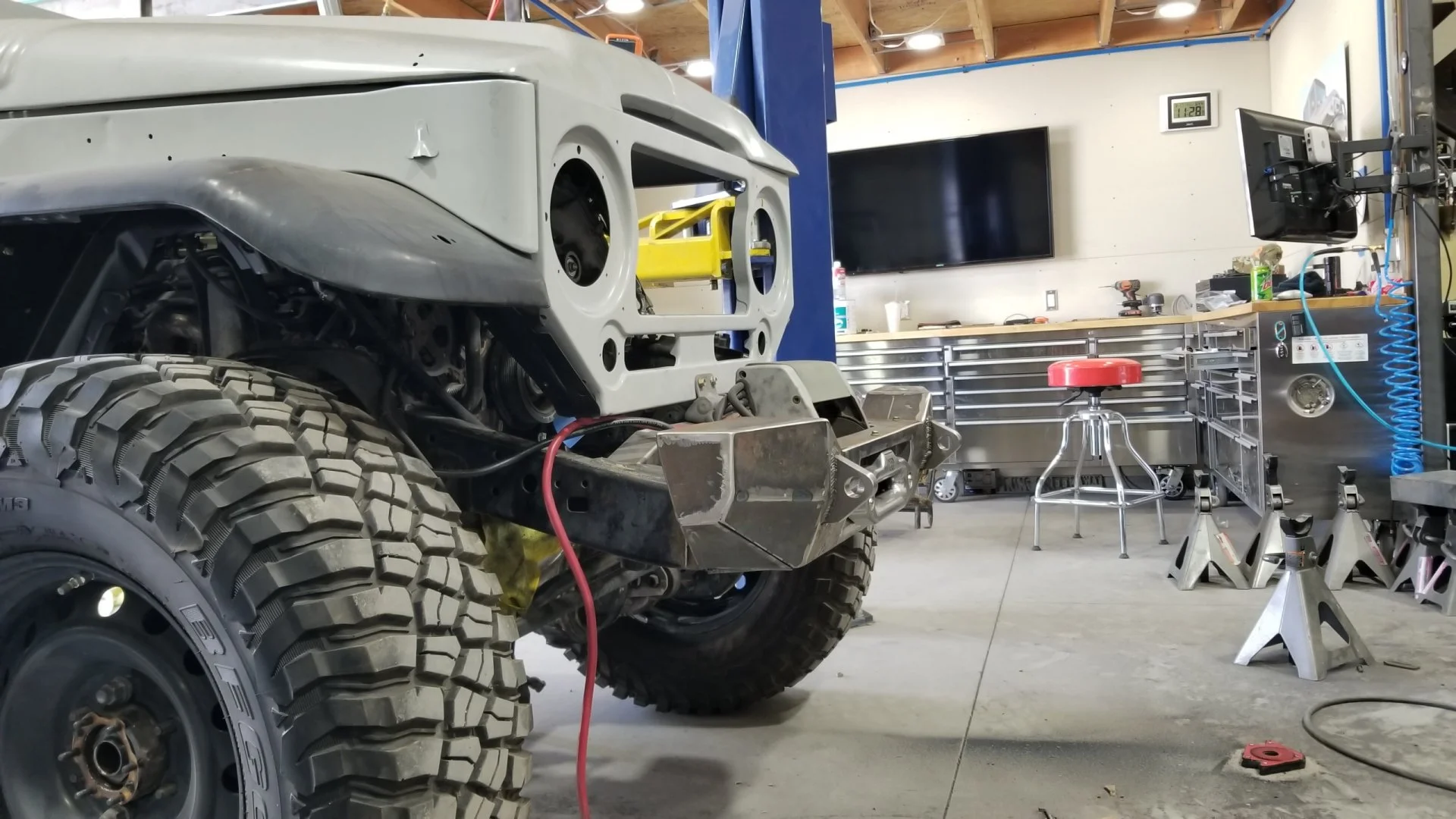

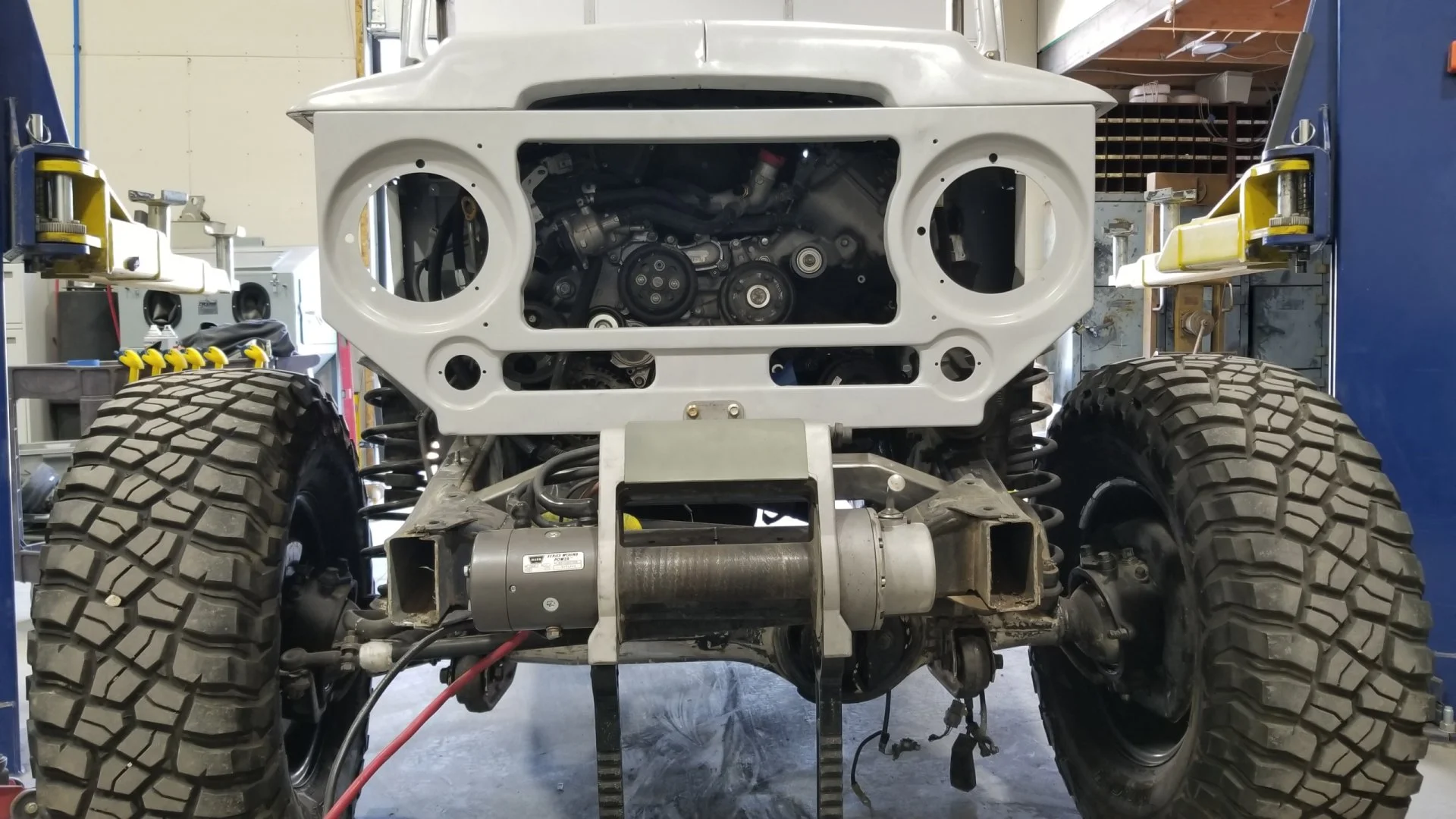

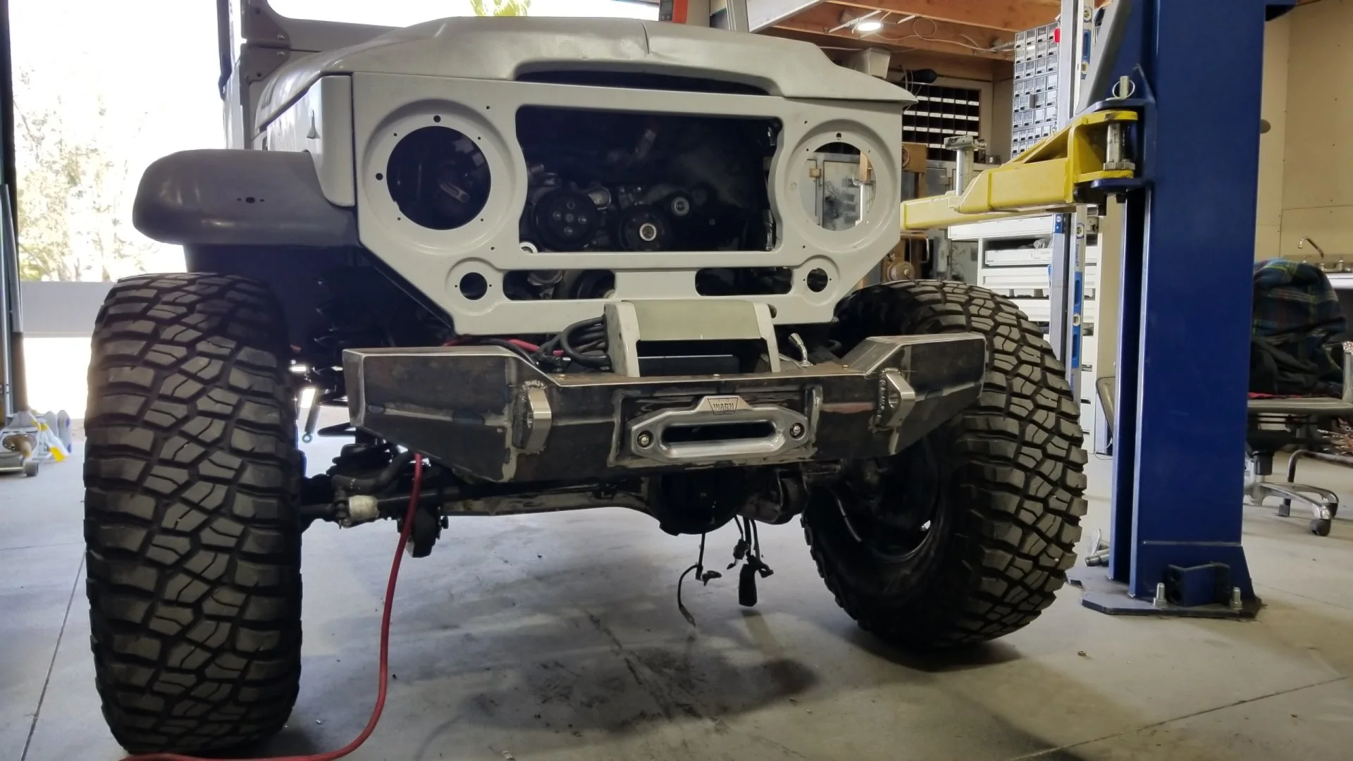

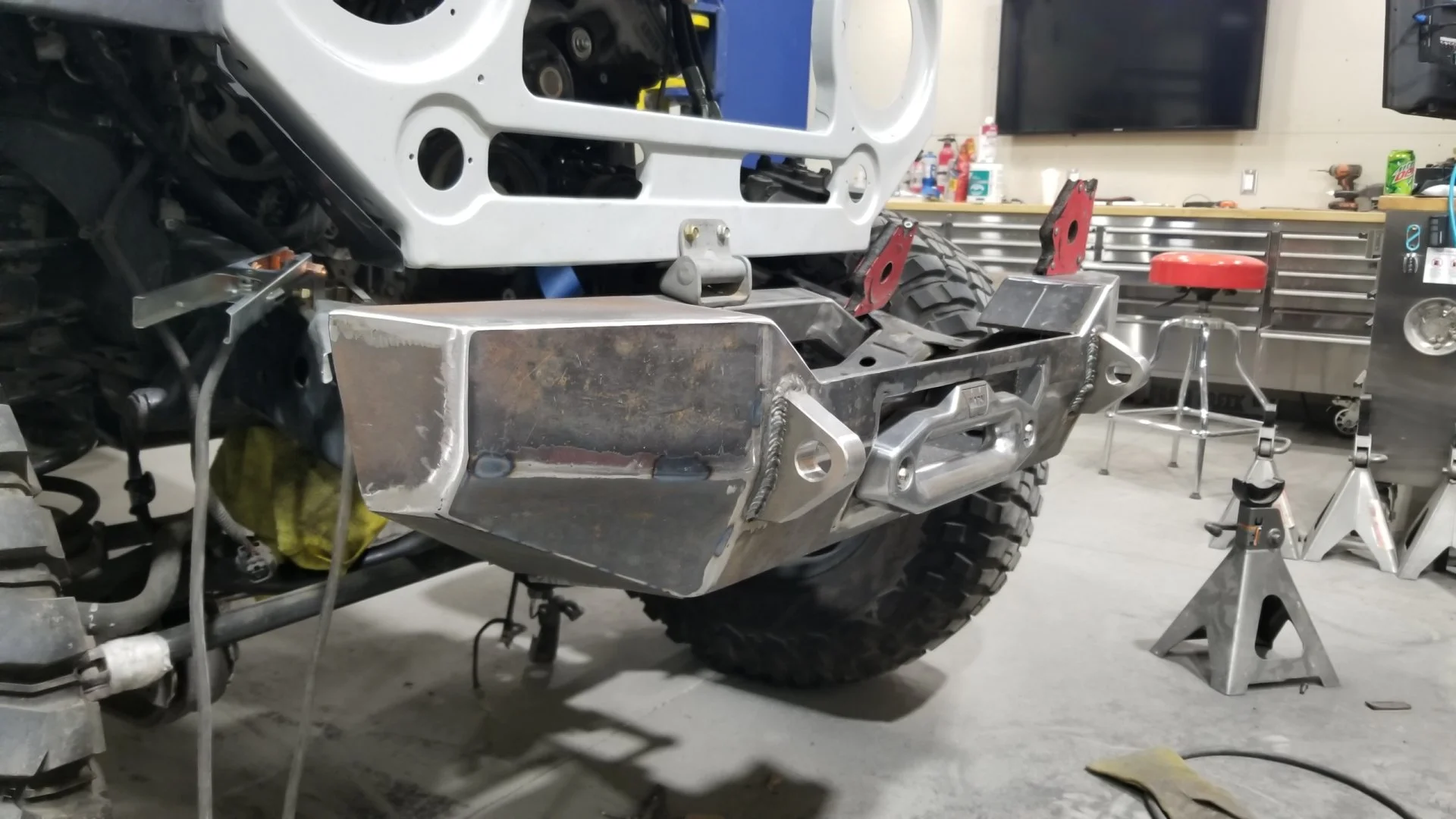

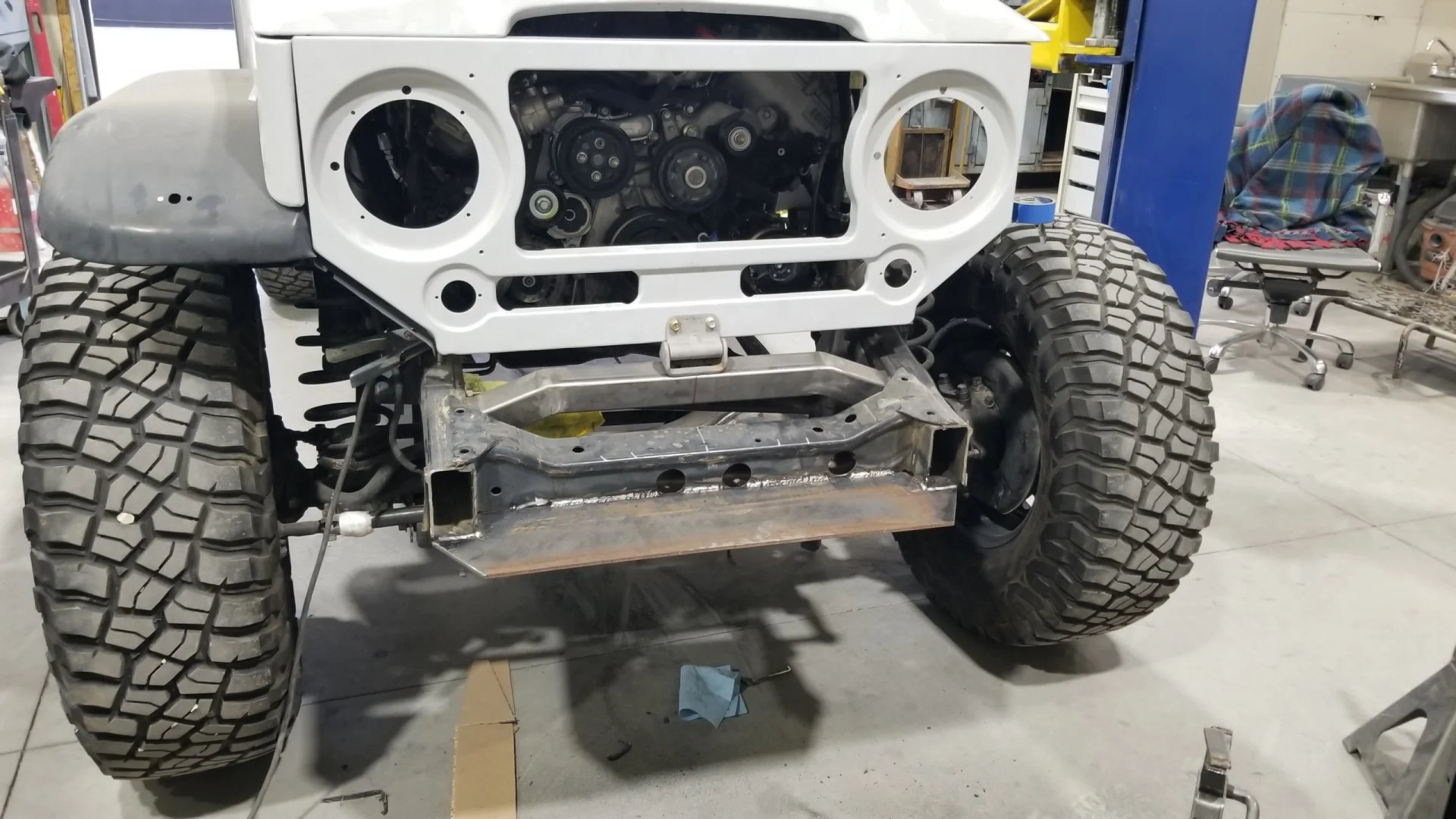

Let's build a front bumper...
Much more difficult due to it being more 3 dimensional and not necessarily following any body lines.
I used some design elements from all of my favorite 40 bumpers. I like the length of the HFS and 4+, but wanted a bit more dimension. I like the ARB, but it's too bulky, and I don't like the bars on the top.

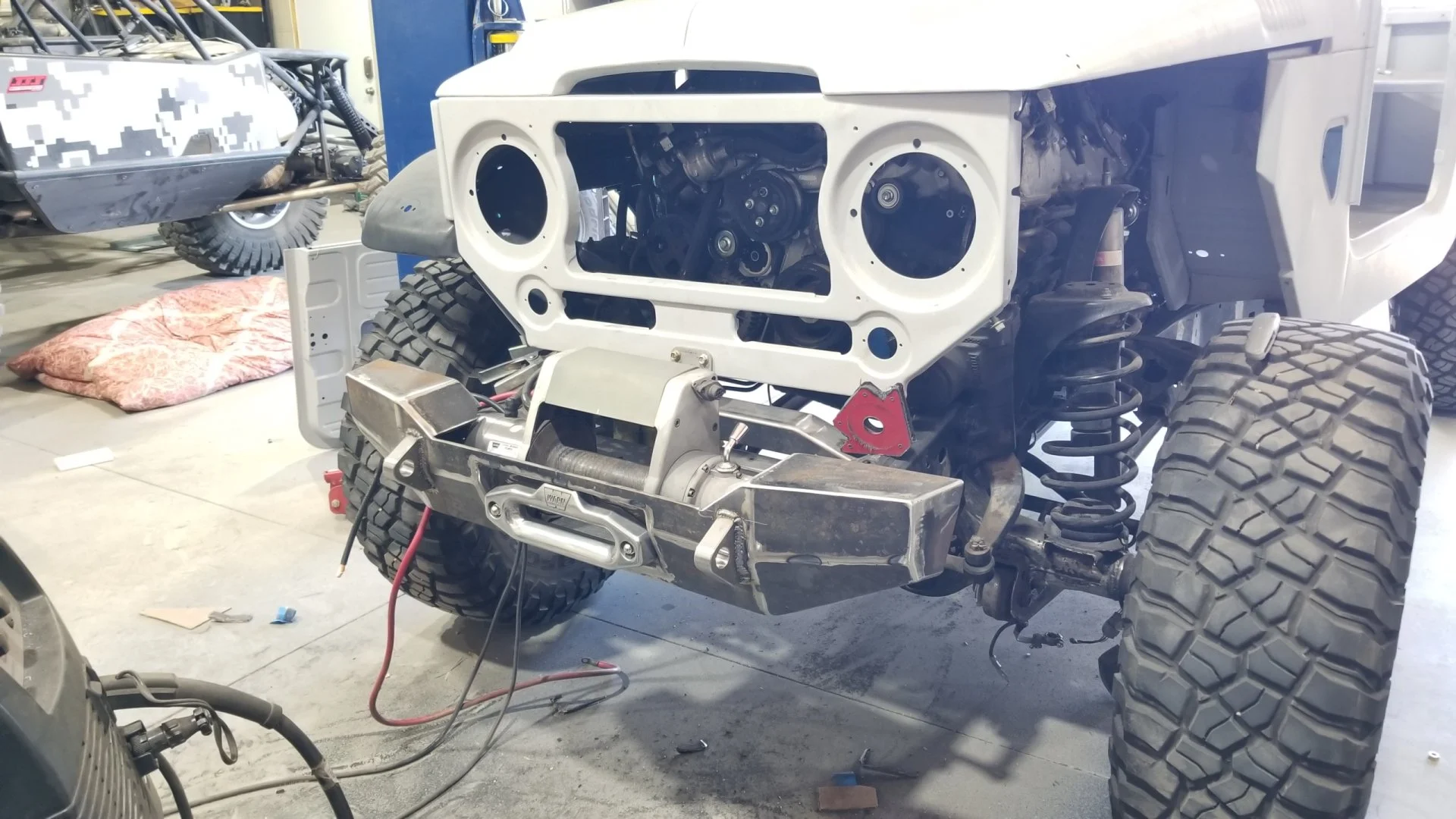

Airflow is also a huge consideration for this bumper and winch combo. I love 8274's, but they are like bricks sitting in front of the radiators. Being that this build has an extra litre and 150hp than the last one, I want as much air flow as possible. I tried to line the solenoid pack on the top of the winch up with a body line in the bib.

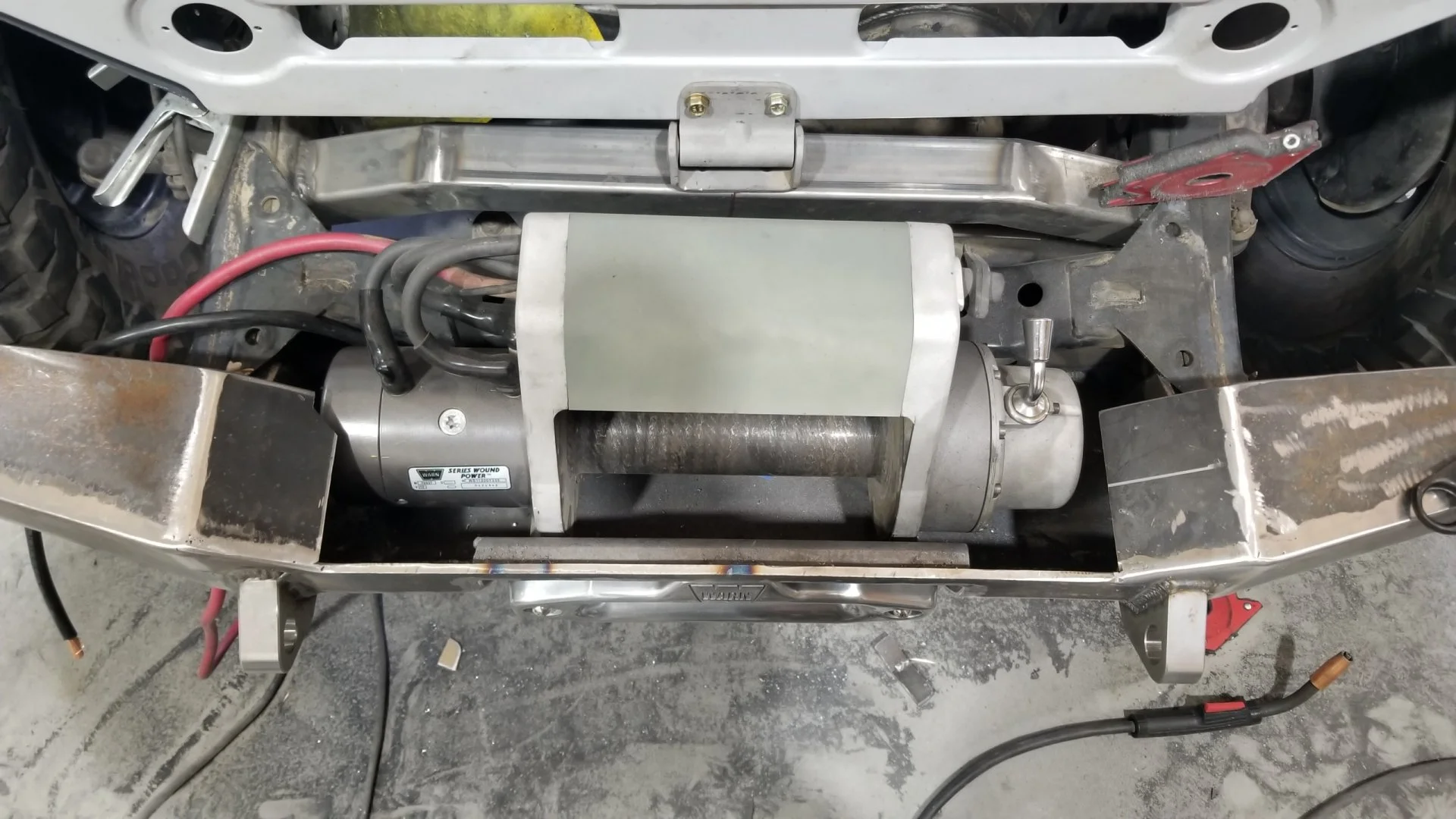

I picked up A Warn XD winch a few weeks ago and rebuilt it, so that's the center of this bumper.

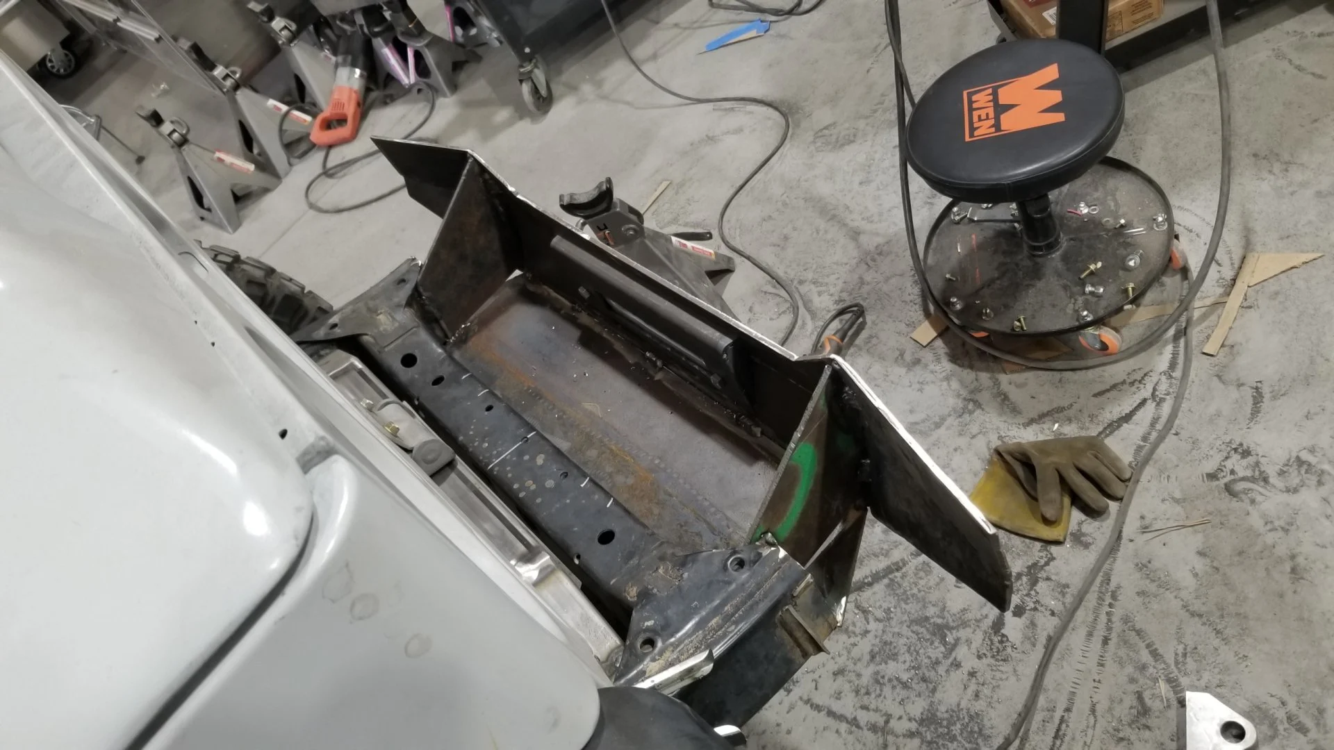

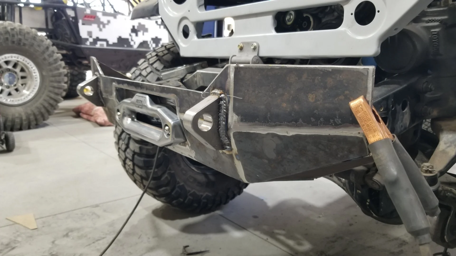

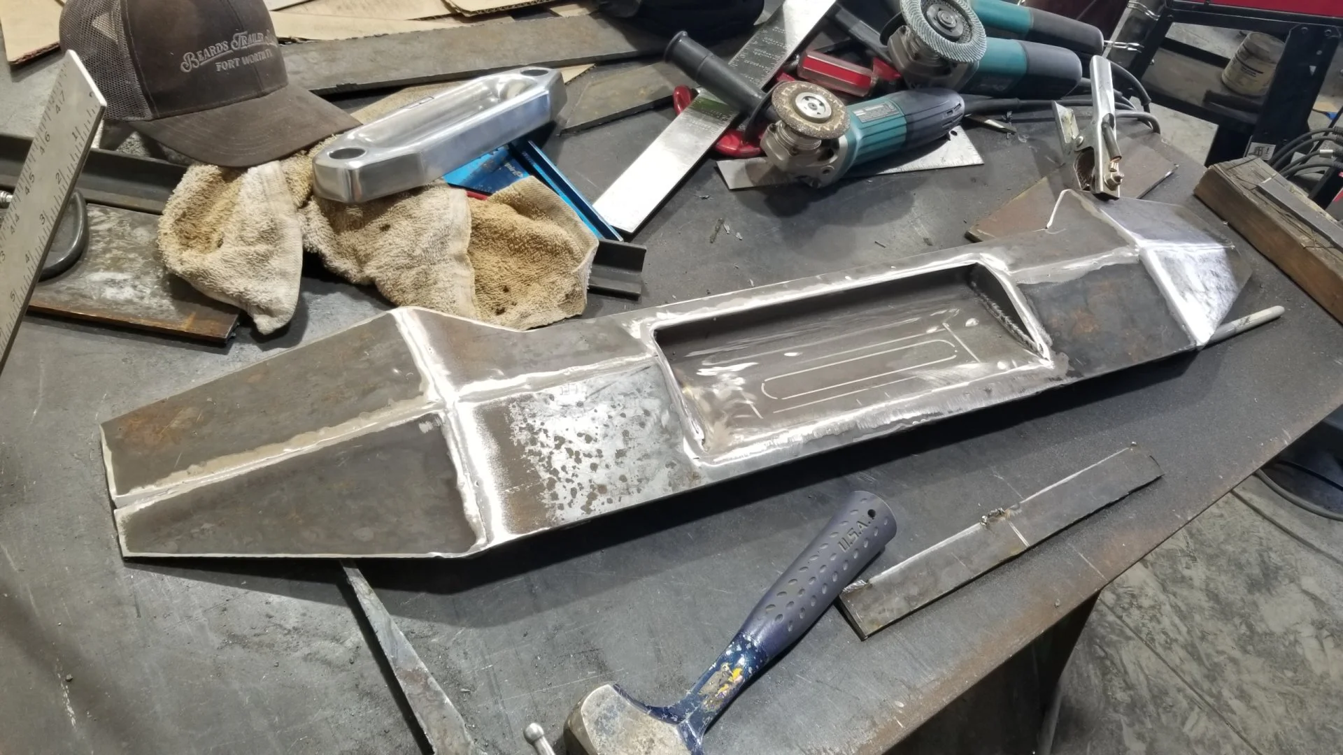

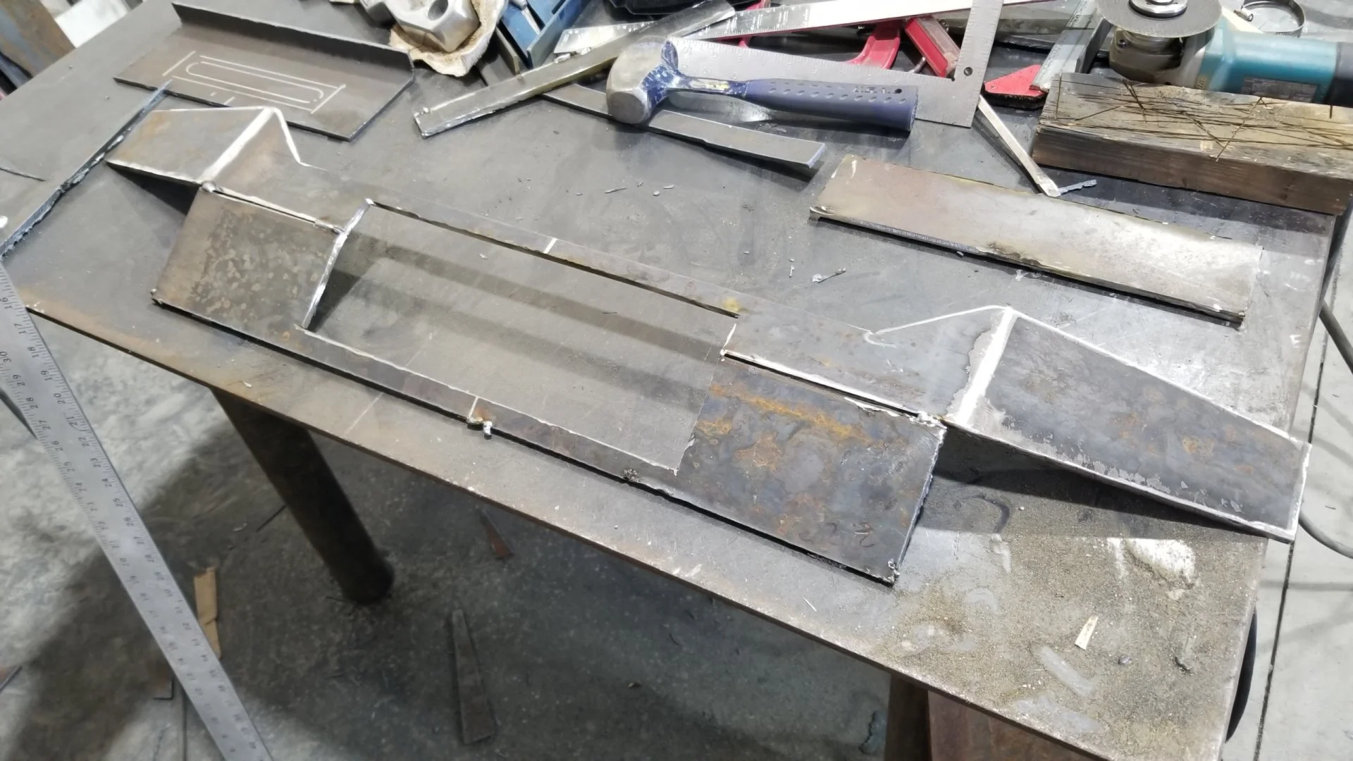

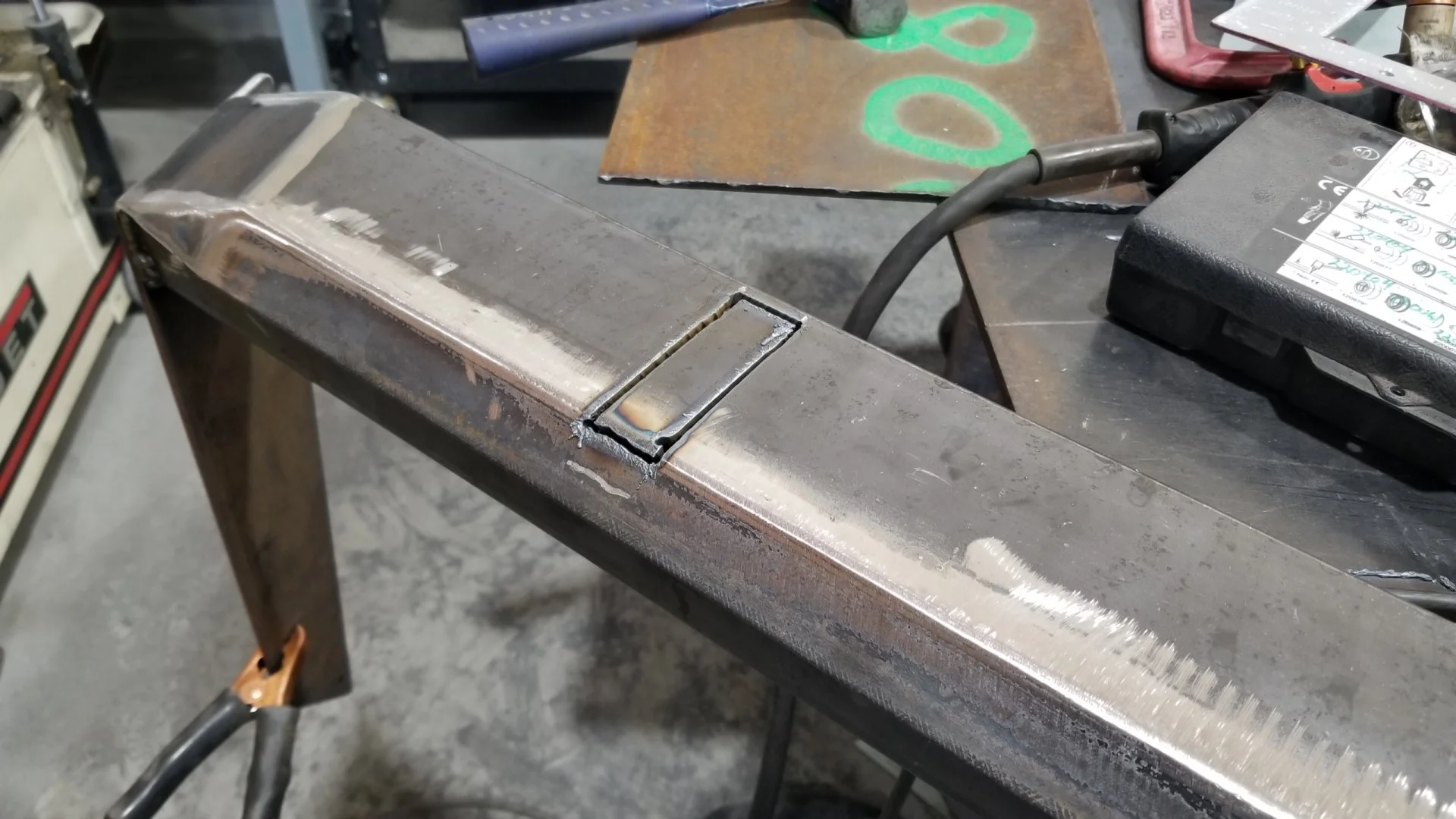

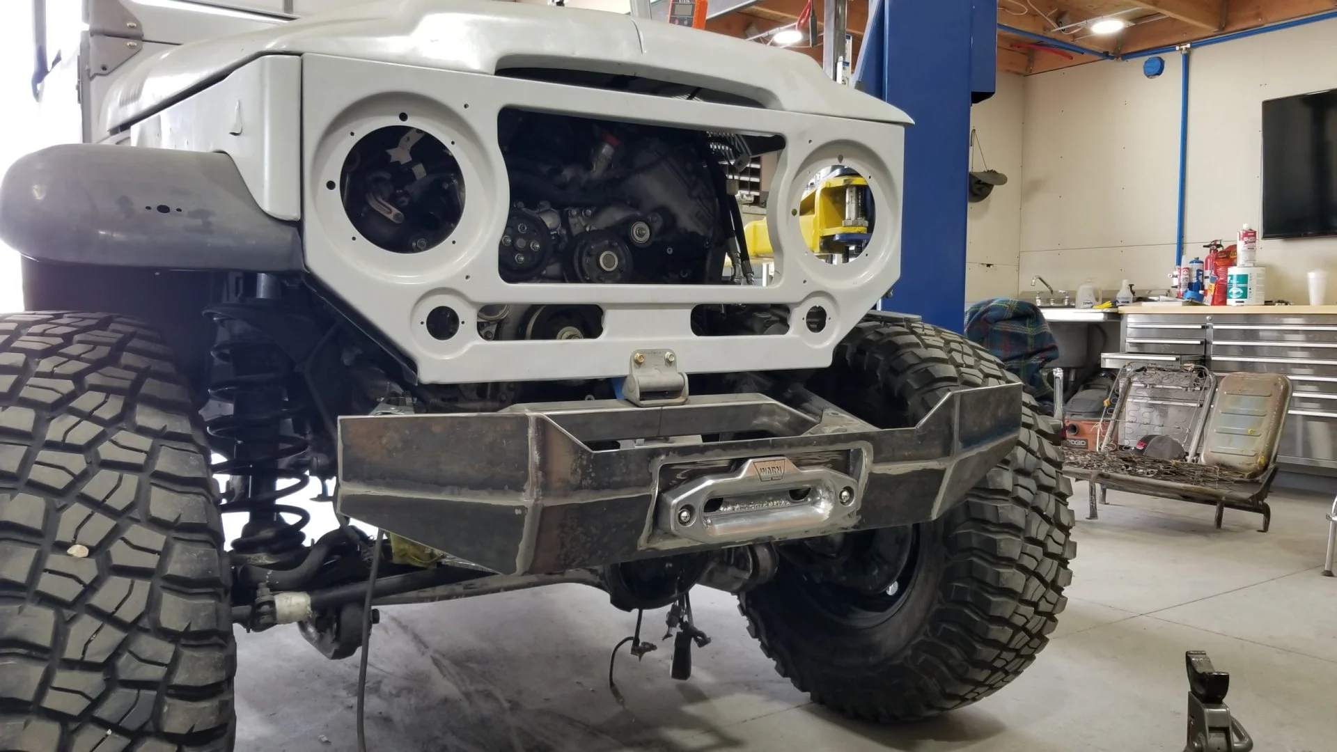

First things first, making a winch plate -
Next, making the front face. This took about 4 hours longer than I thought it would because I decided to recess in the winch fairlead.
Adding some internal bracing -

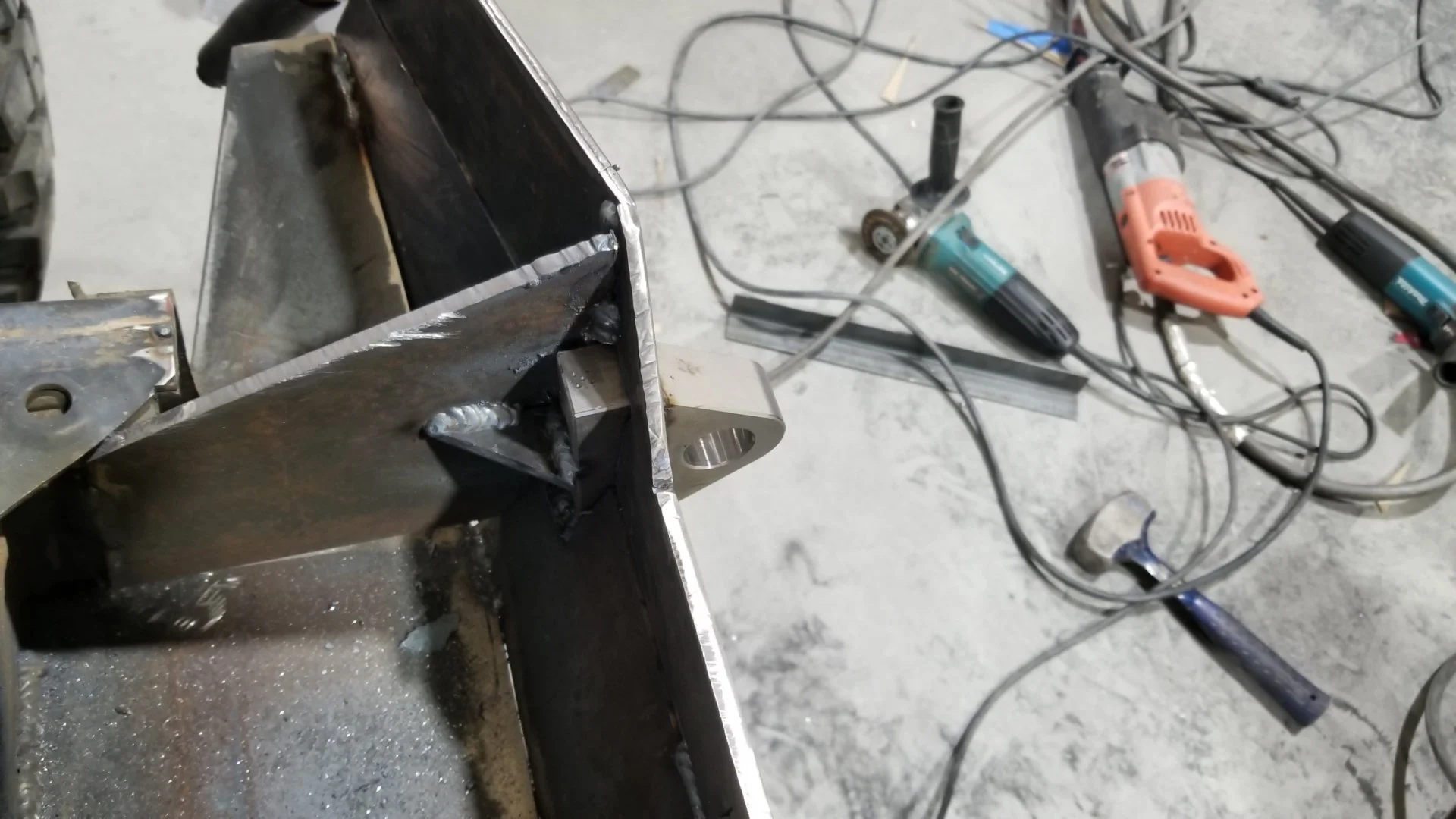

Adding recovery points -
Internal gussets for the points -

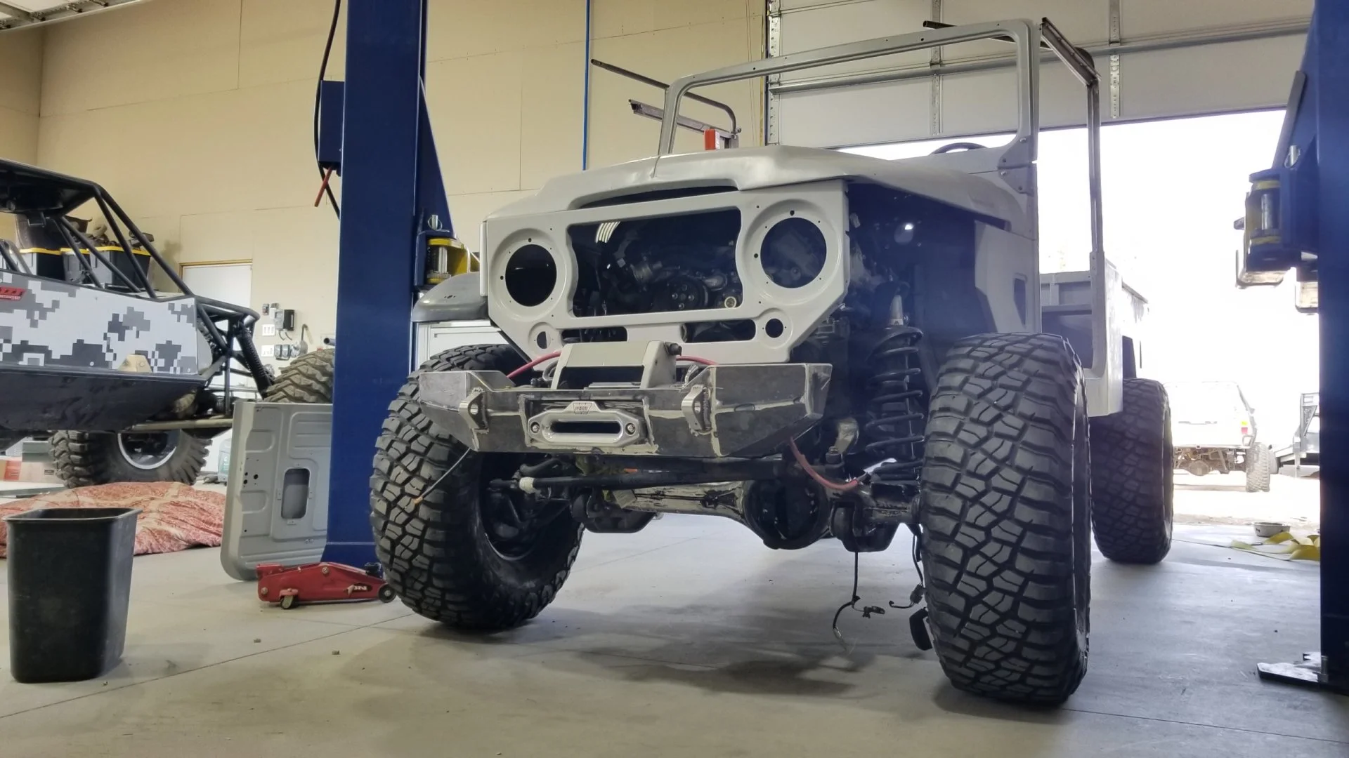

What a mess -
Plating in the top -
End caps -
I wanted to make a filler plate that goes around the winch, but is removable so it's easier to remove the winch -
All done -
Knocked it out of the park again !!

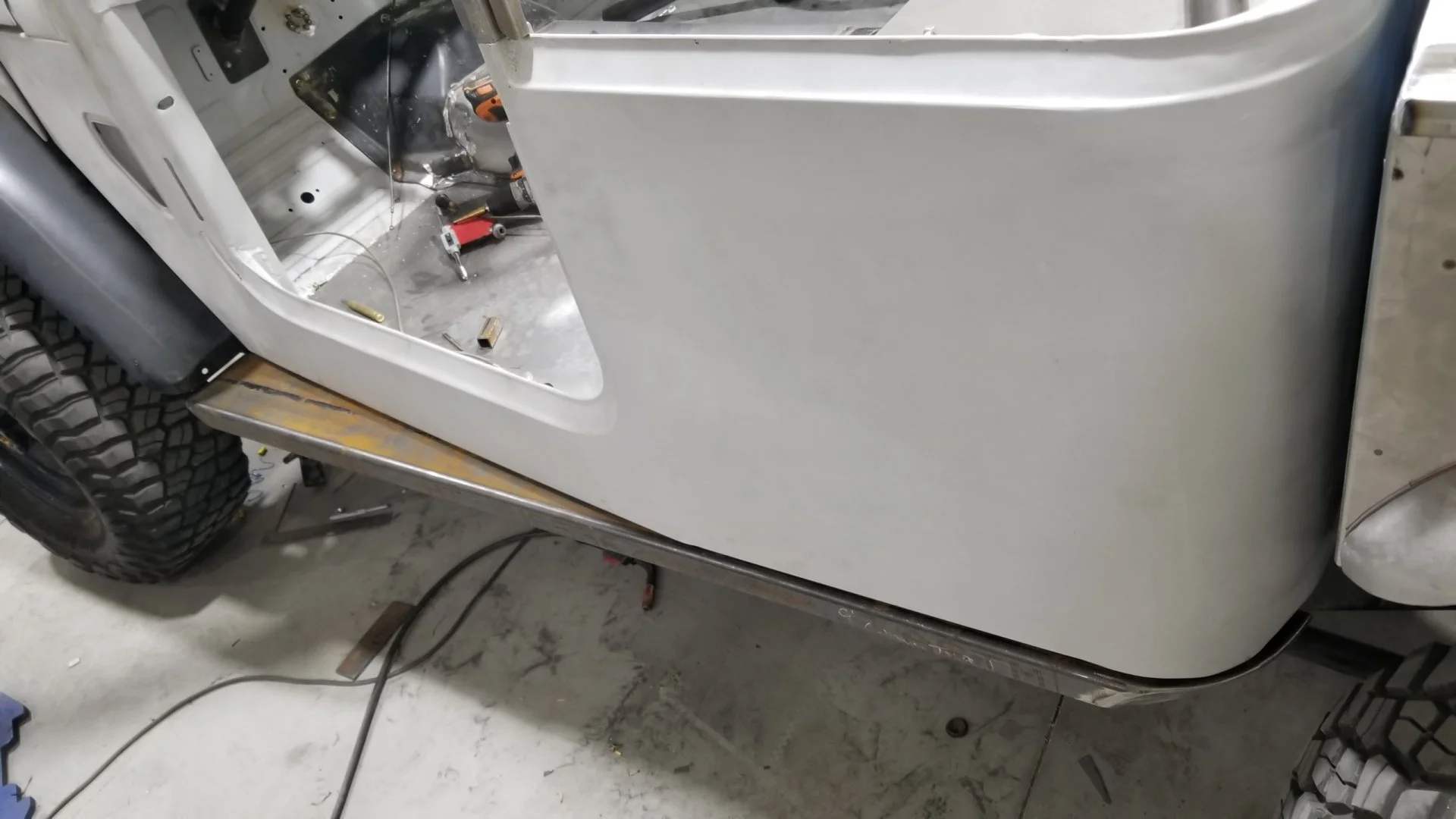

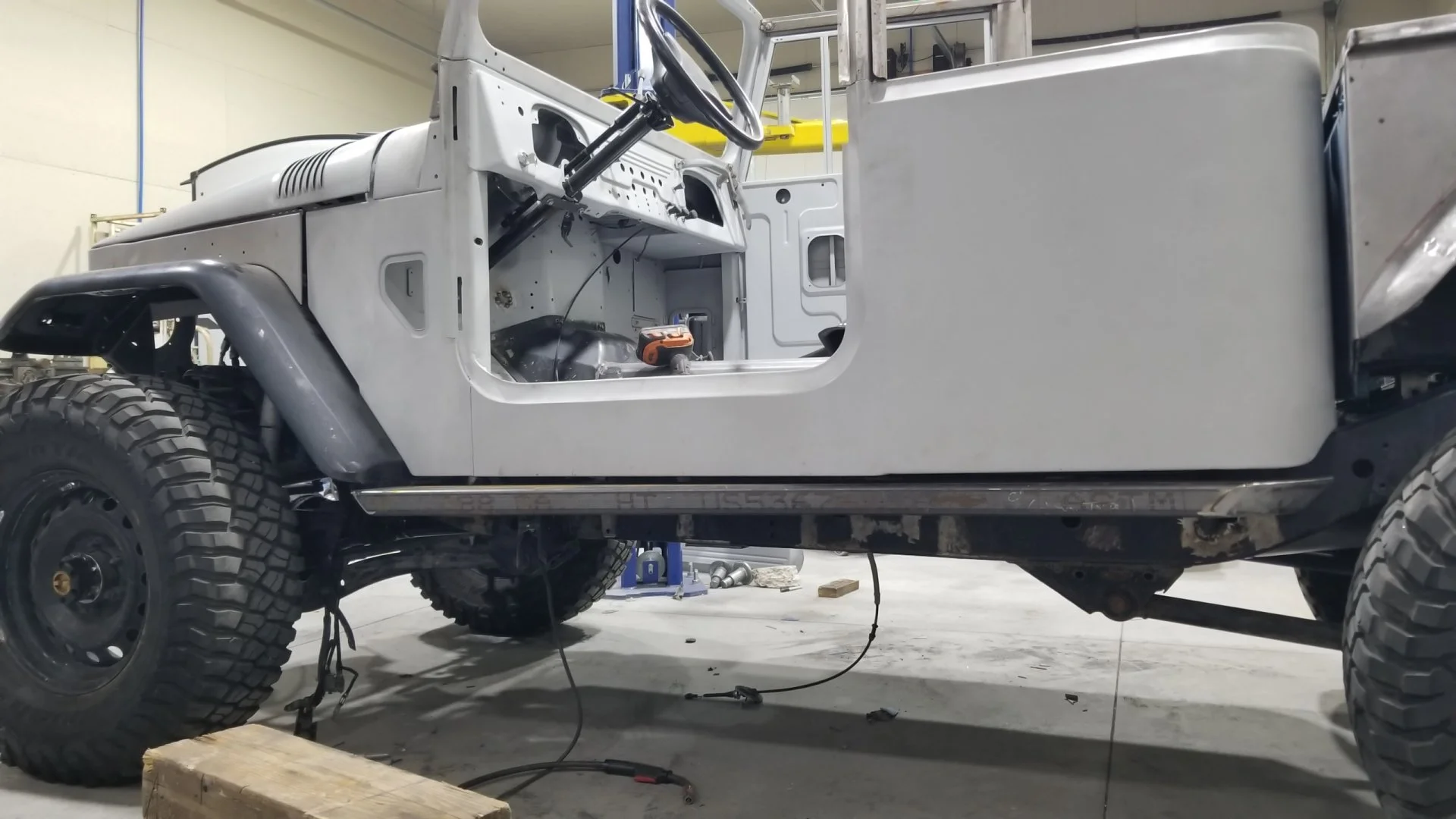

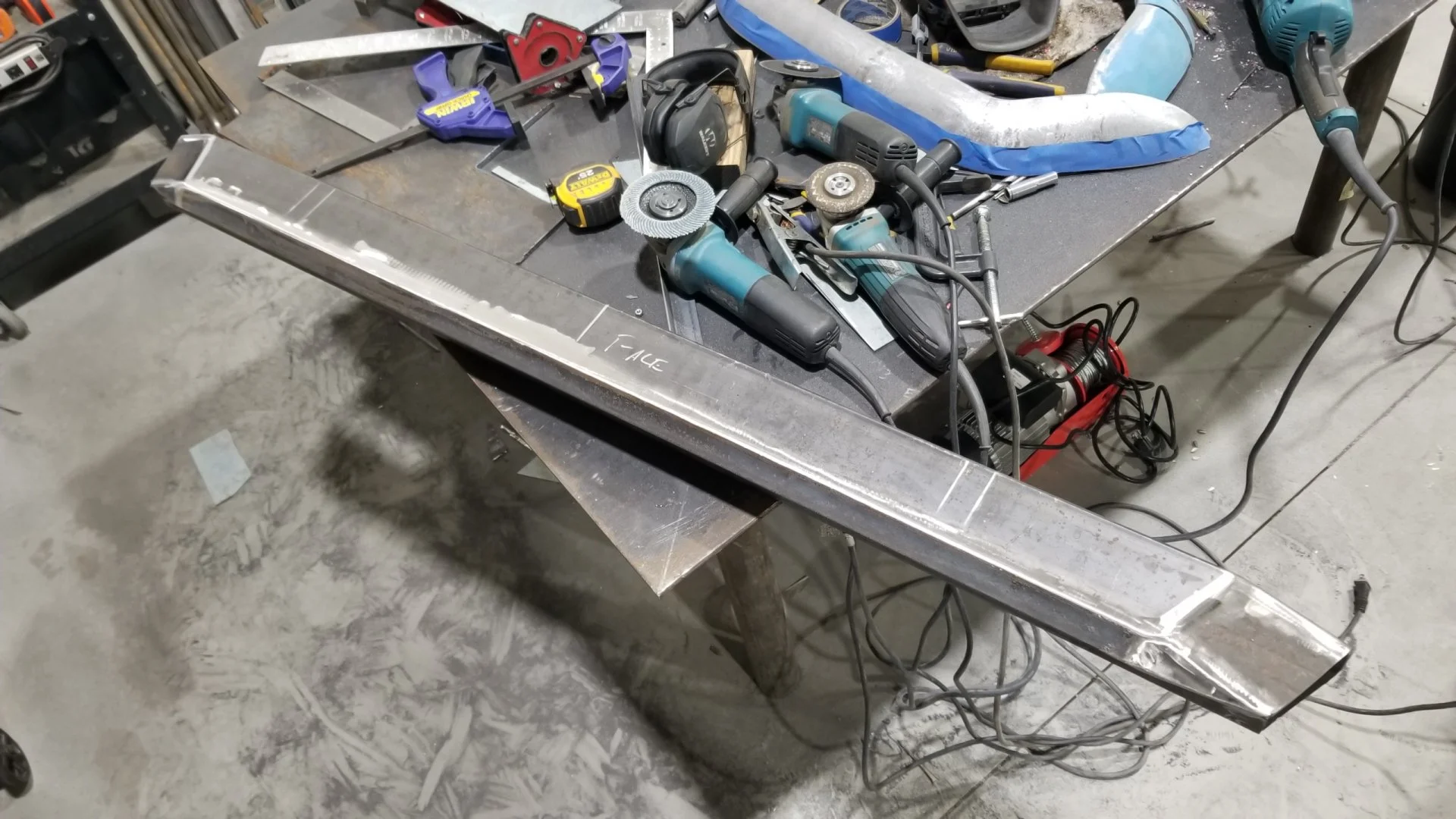

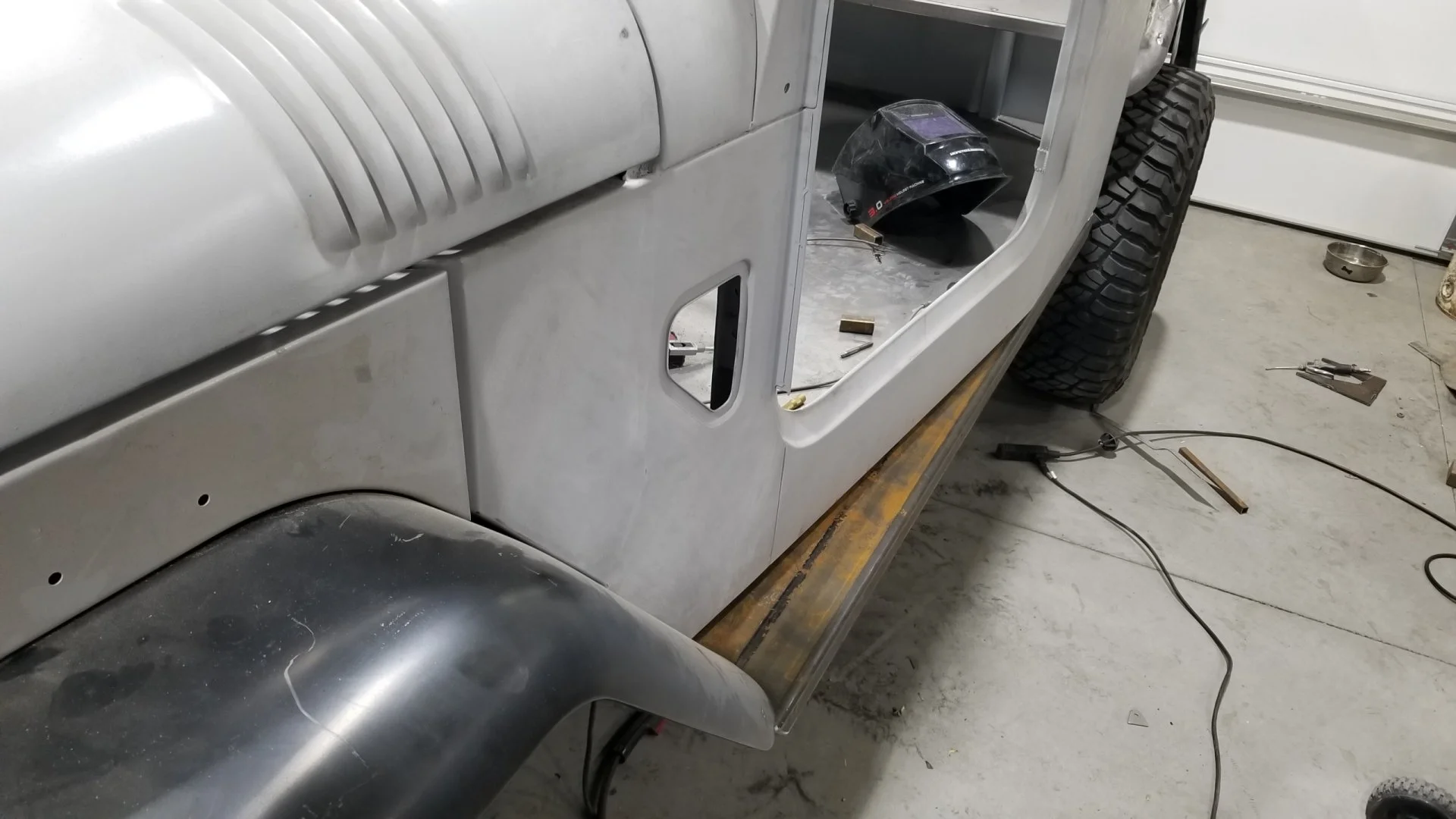

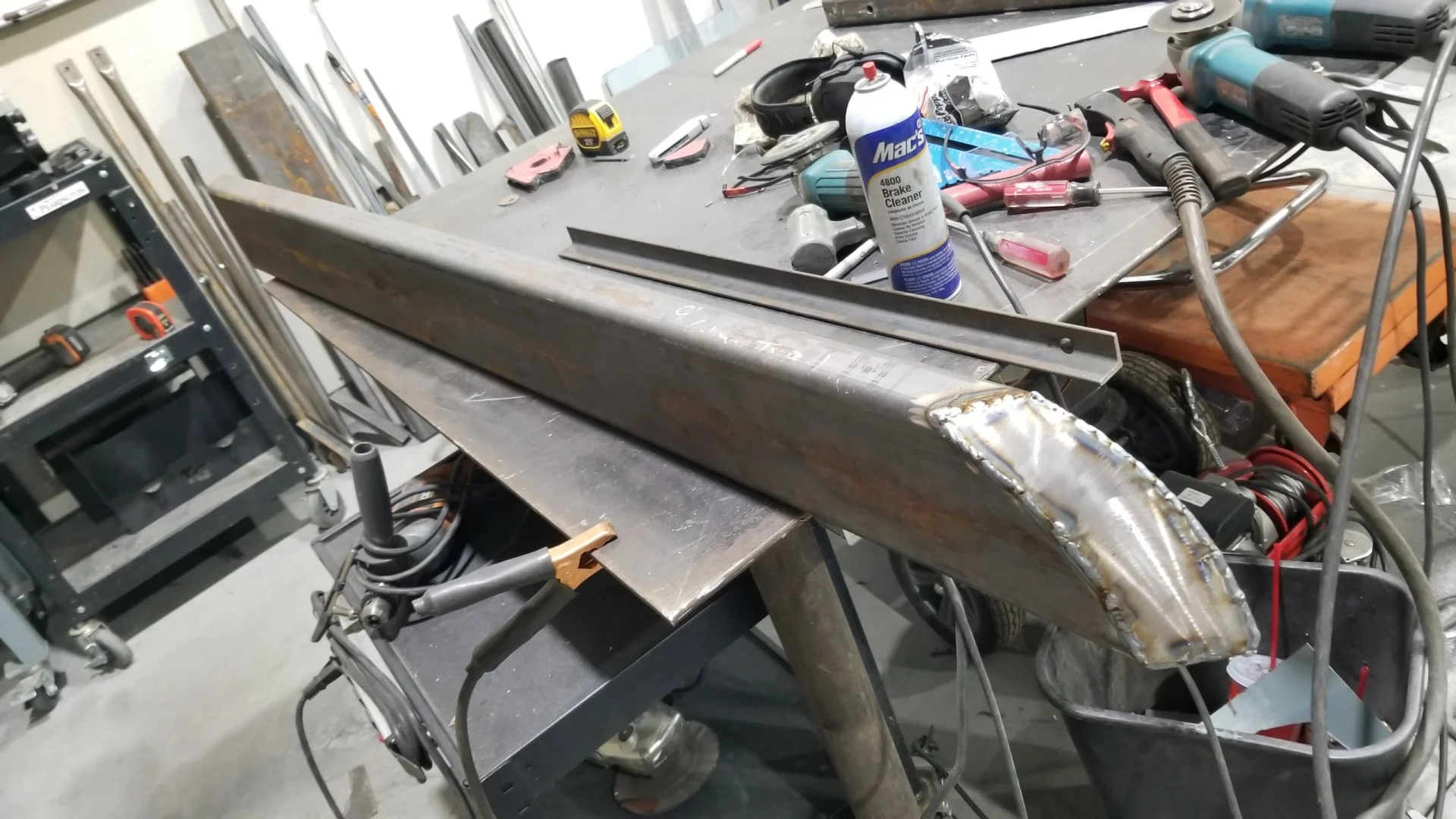

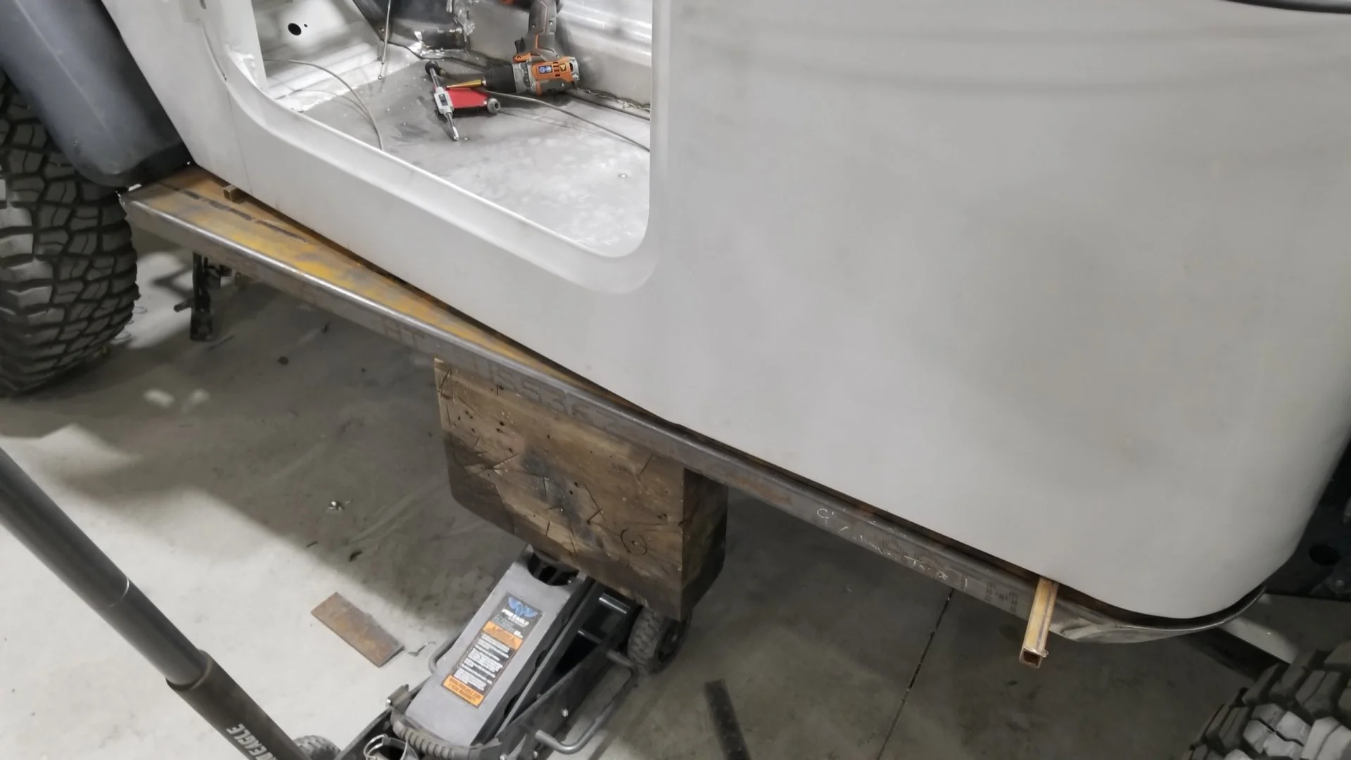

Let's build some sliders...
Typically, sliders are round tubing, but I had three goals with these.
1 - Protect the body
2 - Mimic the look/function of an OEM step
3 - Hide the frame. Since it's a 45 body on an 80 frame with a huge engine, it sits higher and exposes the frame, which I don't like visually.

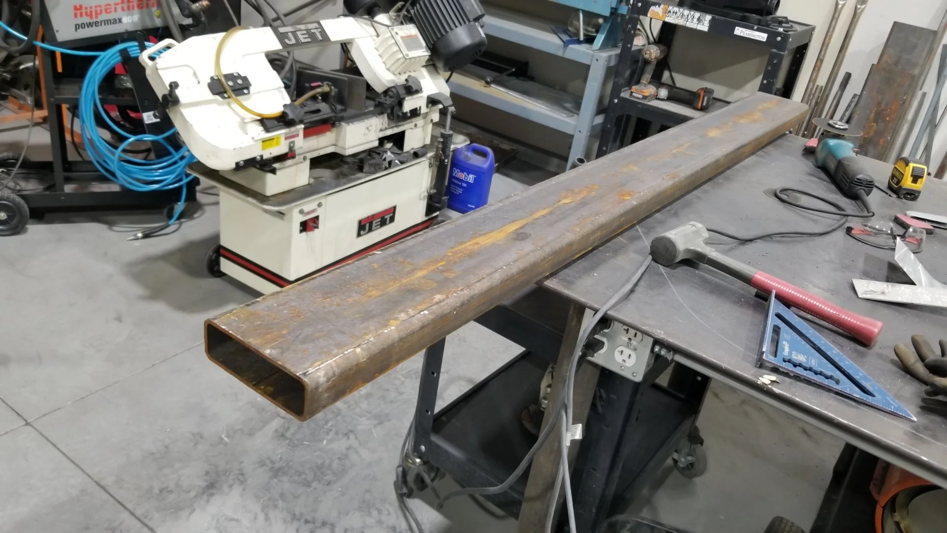

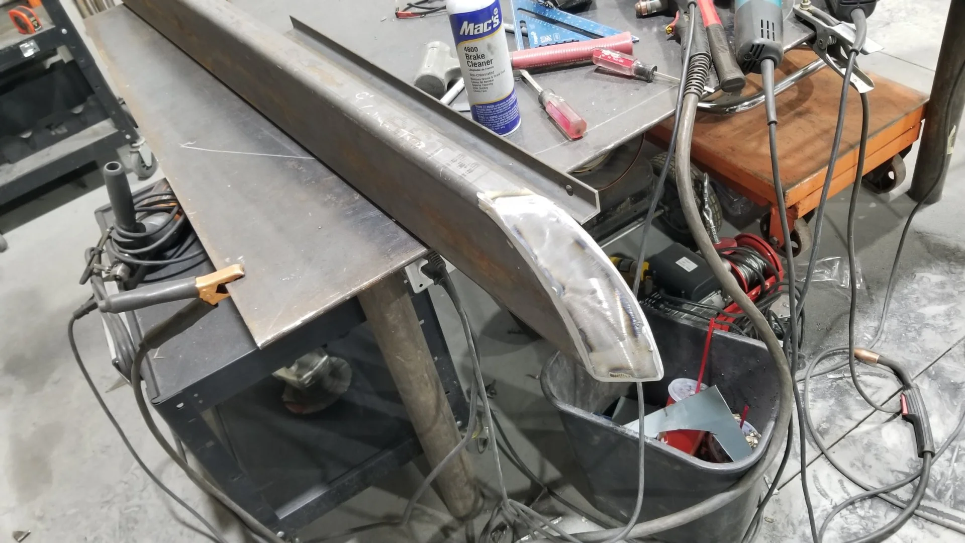

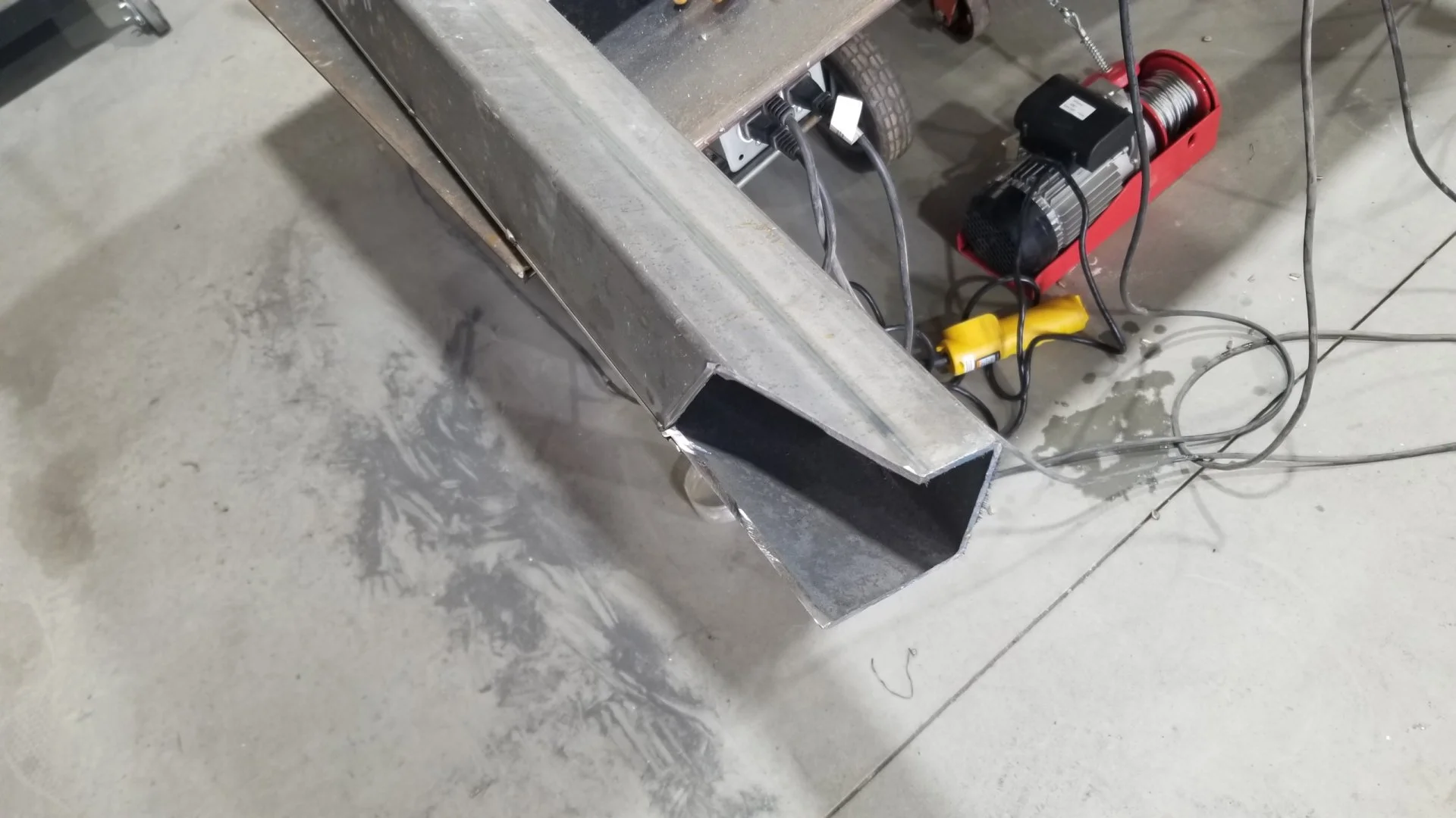

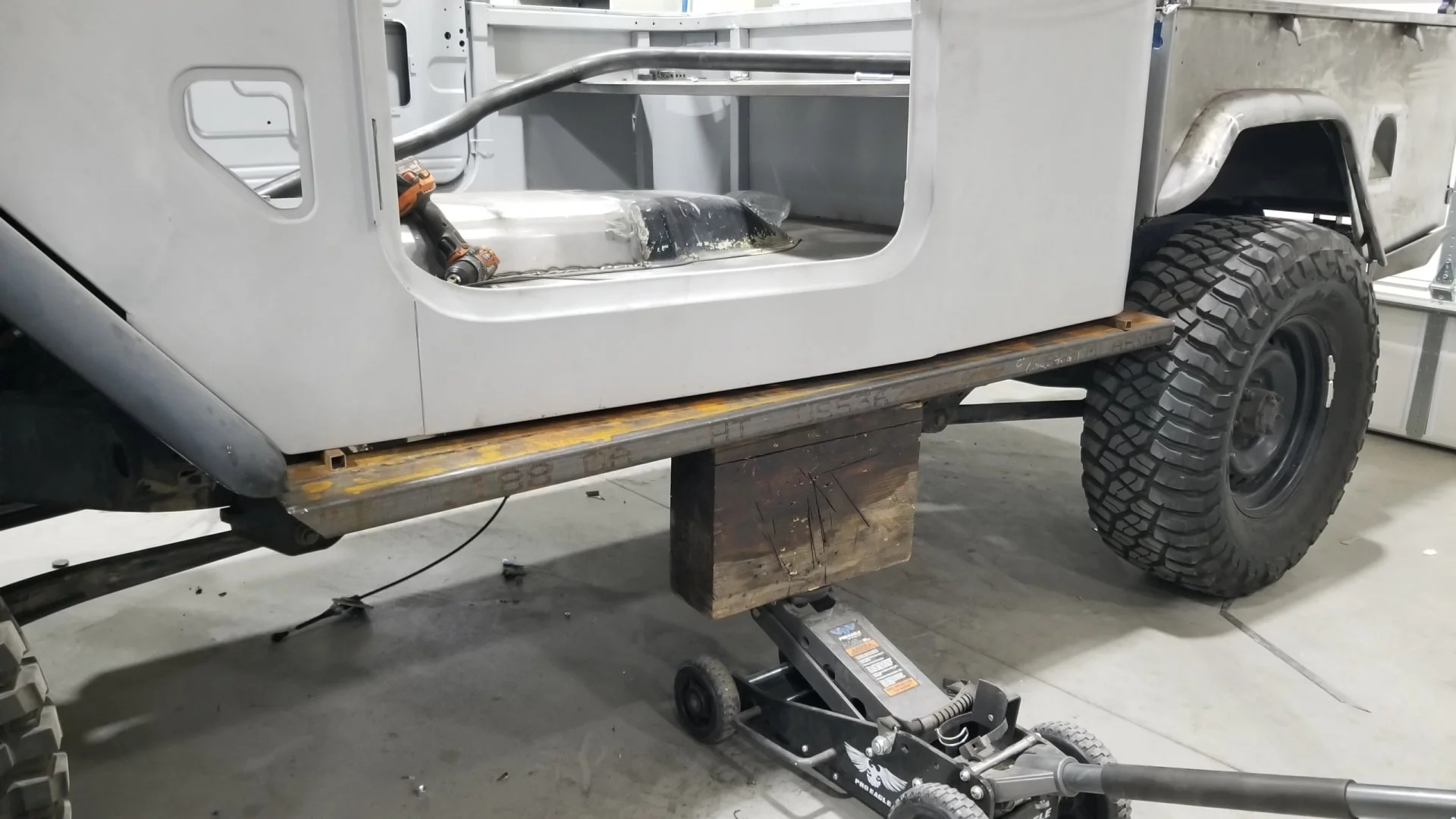

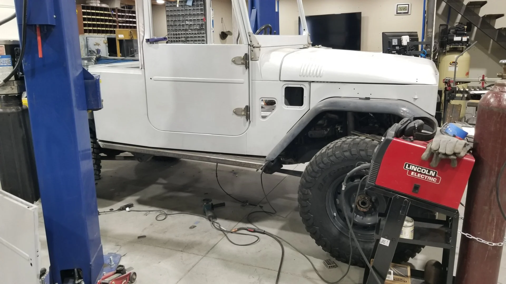

Start with 2x6 3/16 rectangular tubing -
Test fitting, measuring, and trimming -
Trimming and shaping -
Test fitting again -
Good enough for me... Time to weld in place -

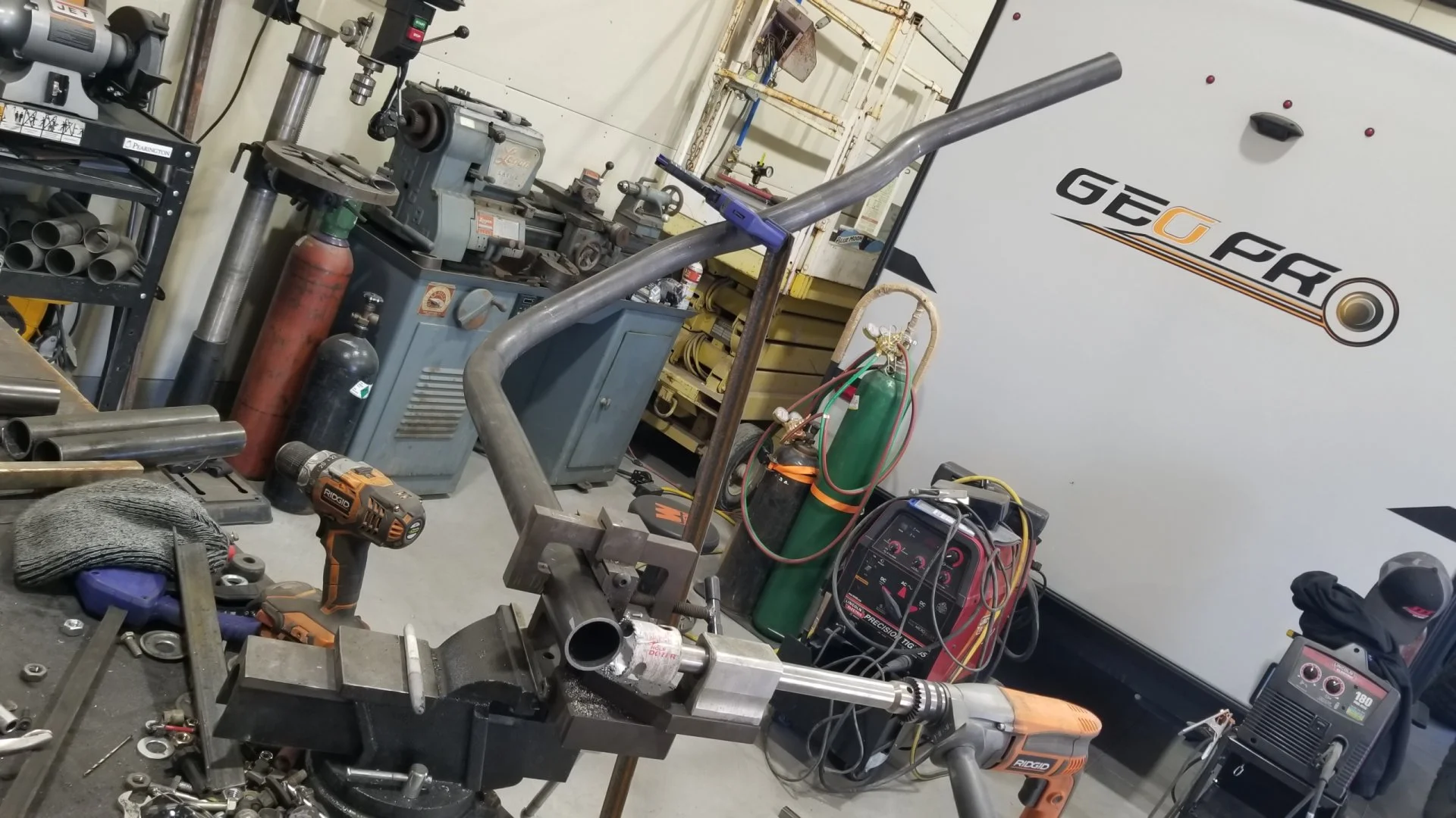

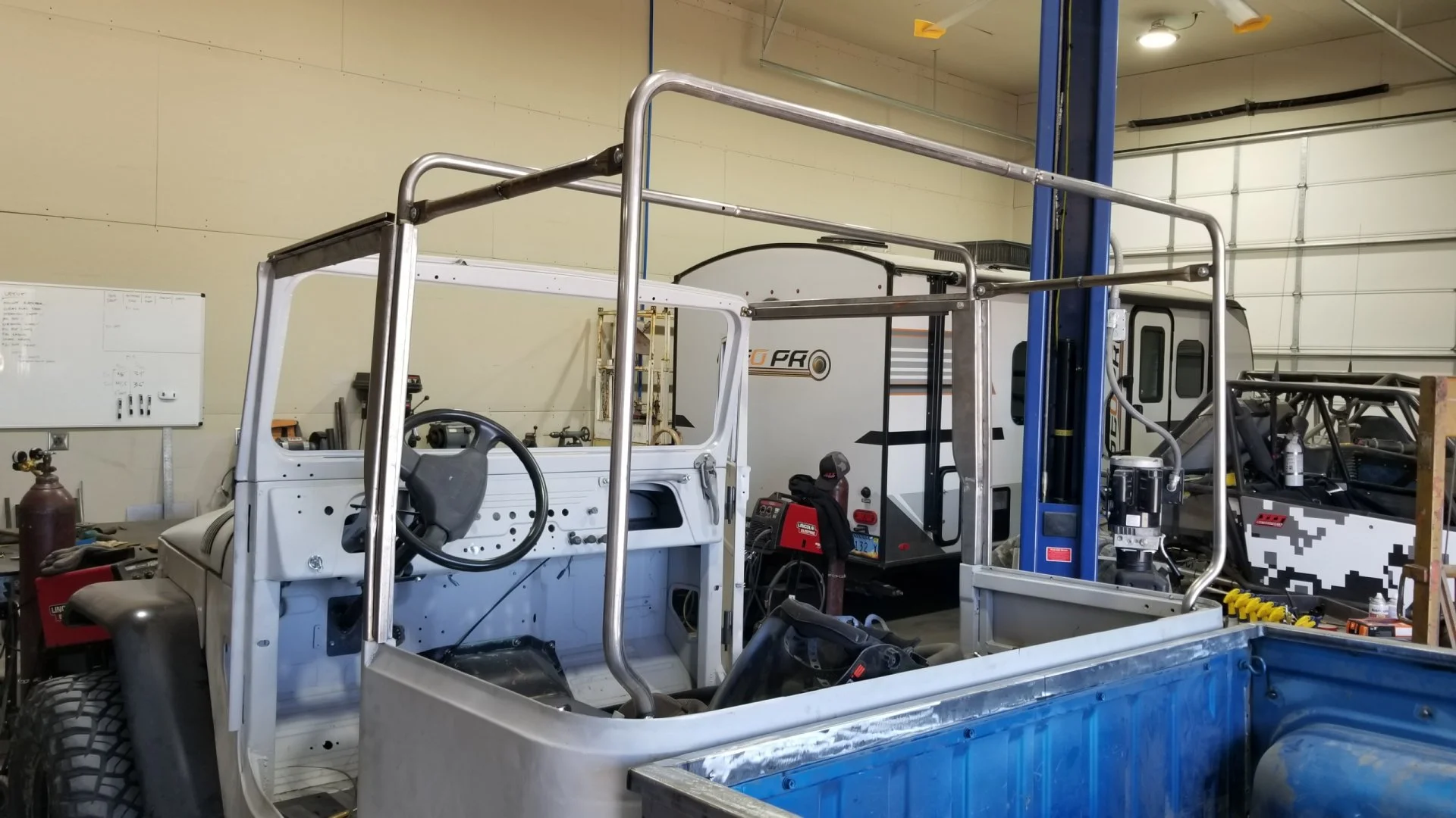

Next up... Soft top bows and frame. This wasn't quite as easy as a typical 40 because of the rear bench area in this 45.
First off, I had to modify the B pillar door frames due to the inward angle at the top of the doors.
All welded in and cleaned up -

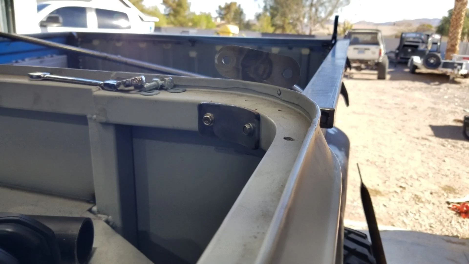

For the rear bows, the feet landed in the corner of the cab where there is no support. I was trying to leave the corners open for air circulation since the AC units will be under the bench.
After some measurements, I figured out I was able to use the two captive nuts in each corner instead of mounting from the feet -
Rear bow welded on -
Next I needed to shorten both horizontal supports by about 20" -
Soft top frame complete -

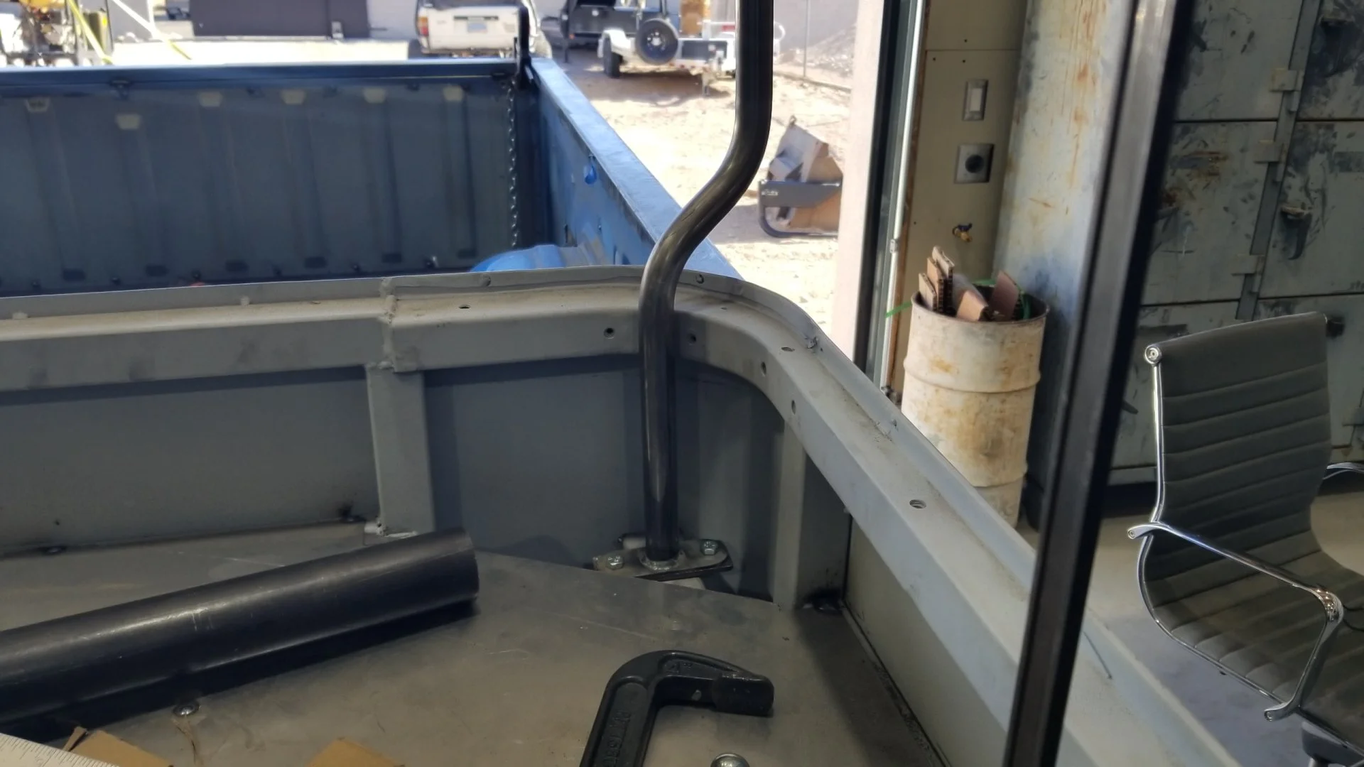

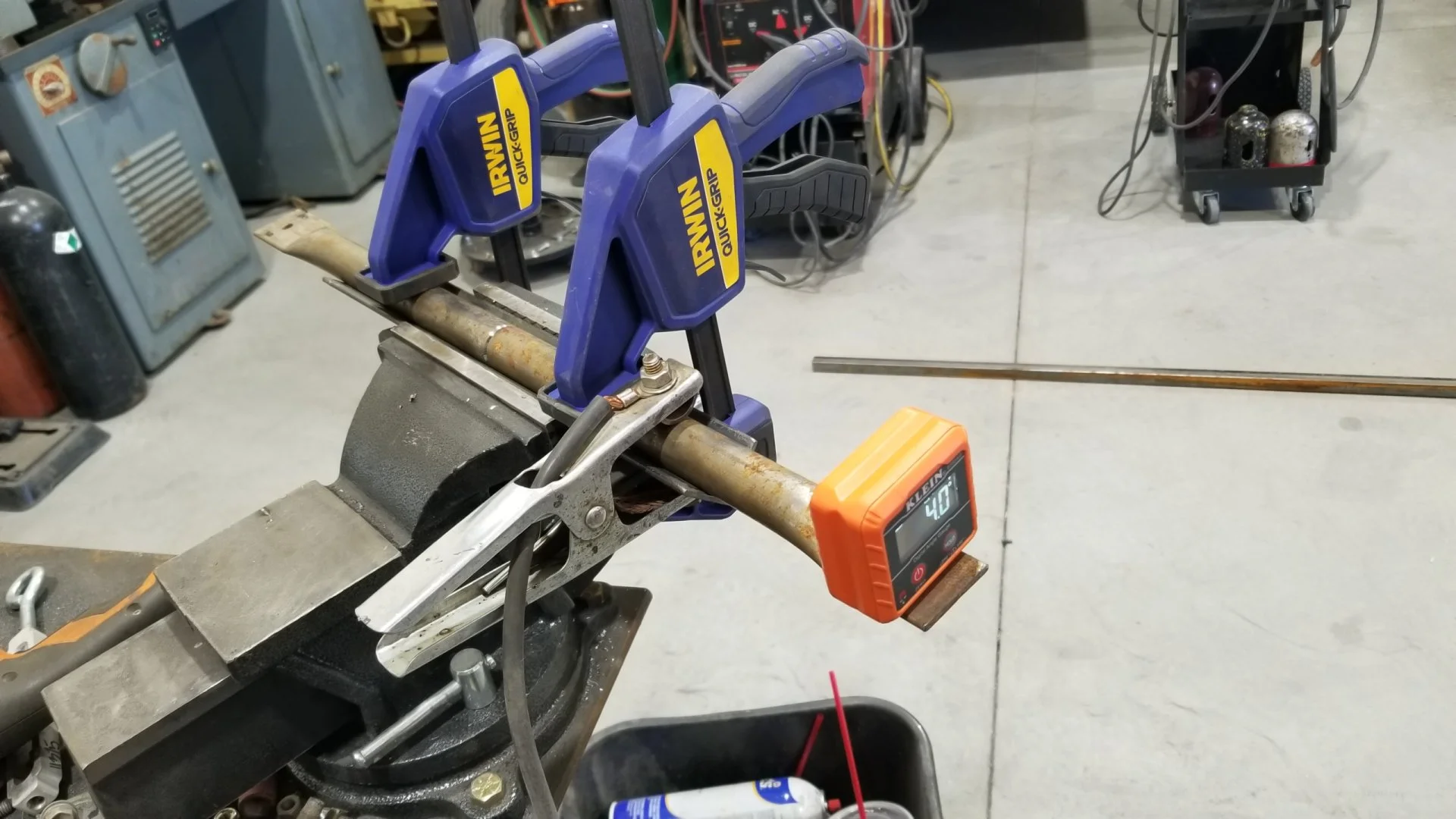

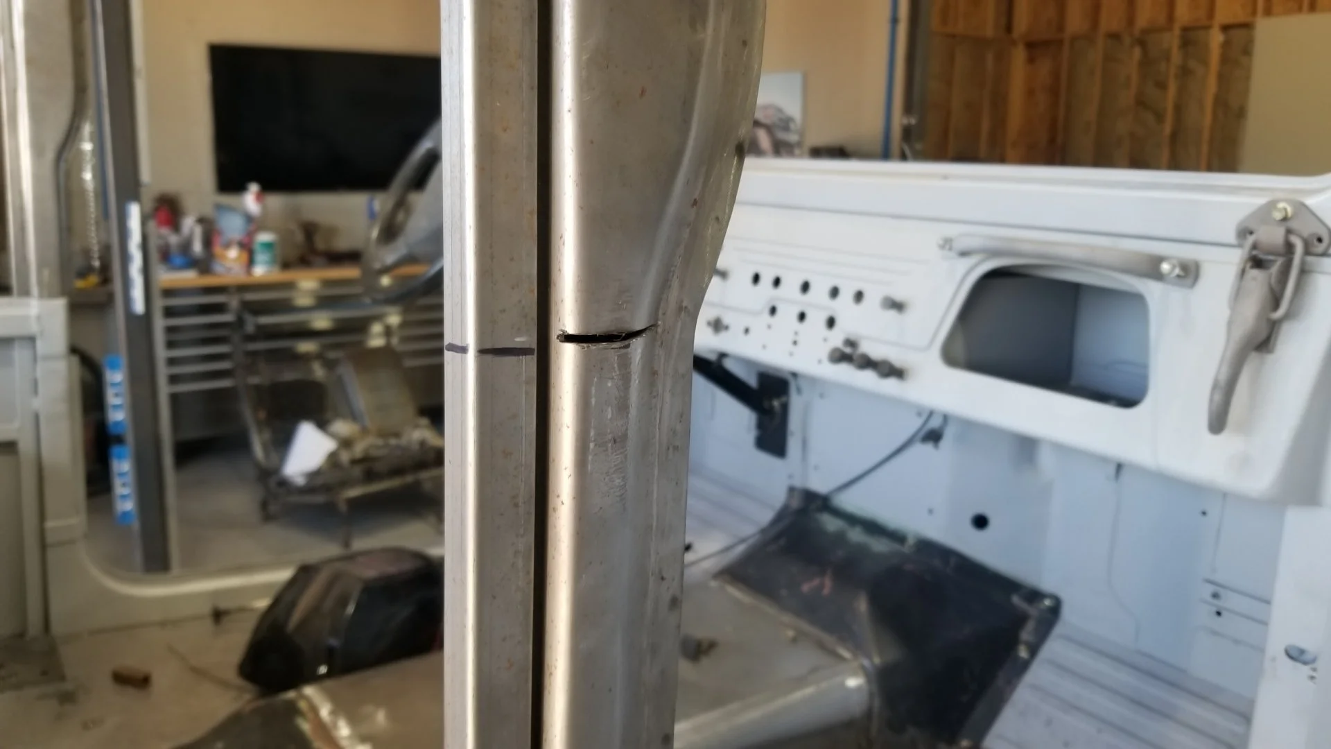

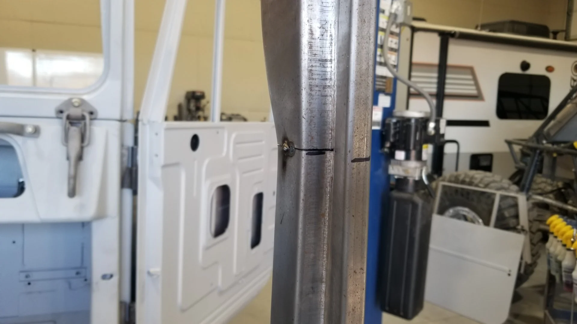

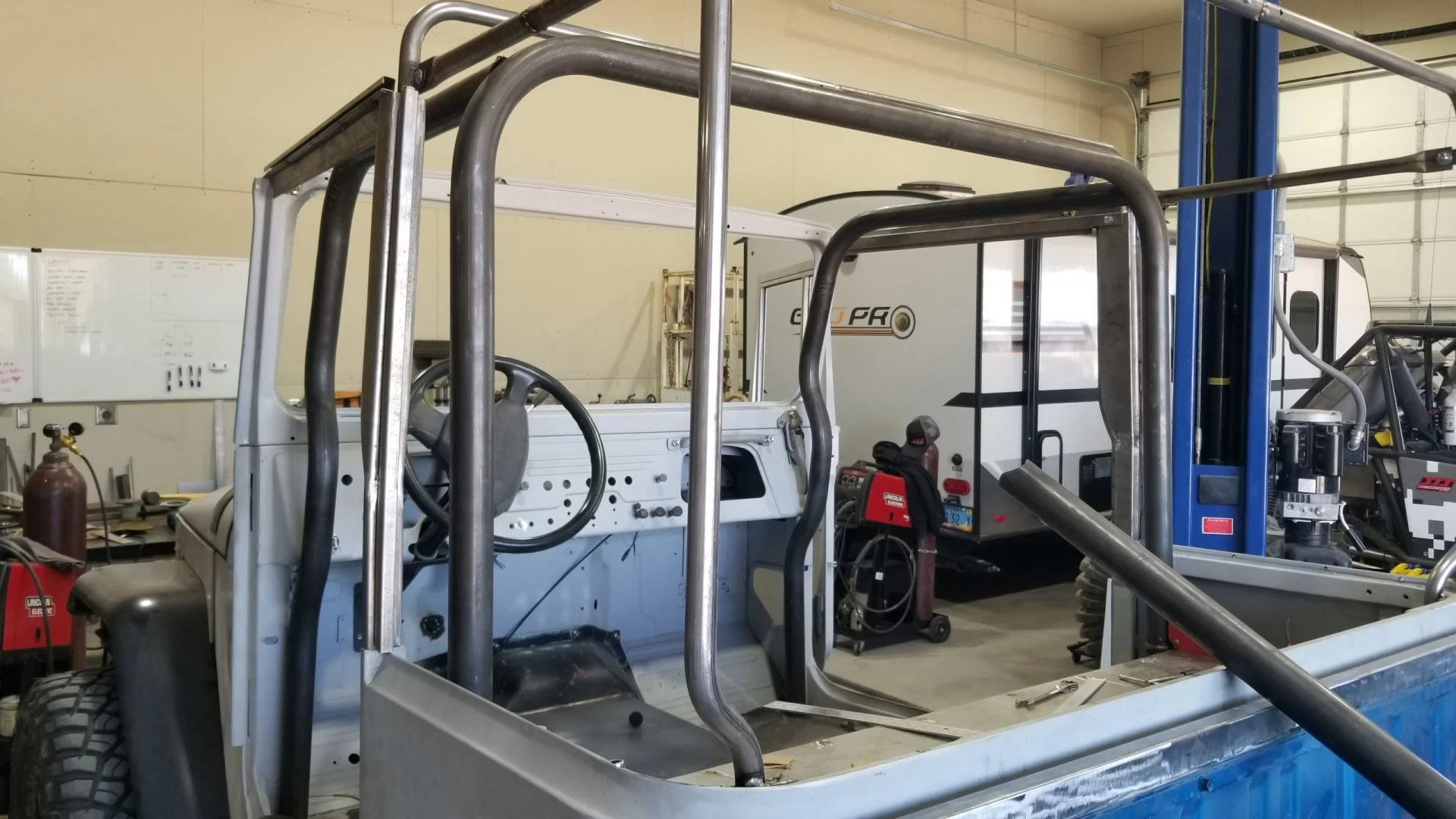

My last build used a Metal Tech cage. I knew I wanted one on this one too, but unlike the last one, I'd be welding this from scratch due to all of the one-off measurements.
@mrboatman was kind enough to let me interrupt his motor swap to take some measurements of a stock 40 tub so I knew how much I'd need to extend my B pillars.
Since I was going all the way to the floor and not a rear fender well, I needed to add 13.5" to each leg -
I sleeved each extension with 1.75" DOM and used a rosette weld for strength -

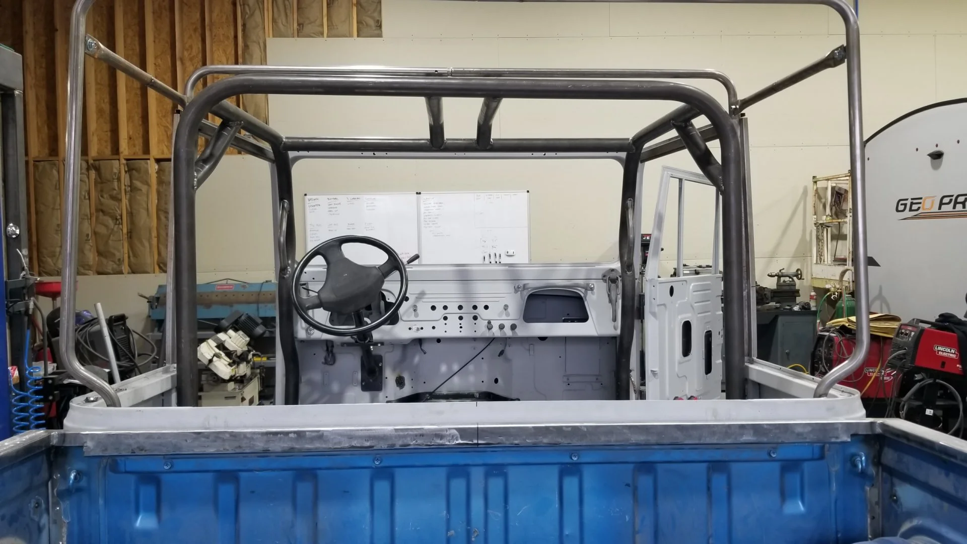

The welding isn't a big deal with the Metal Tech kits, but notching tubes is definitely challenging.
Starting to take shape -

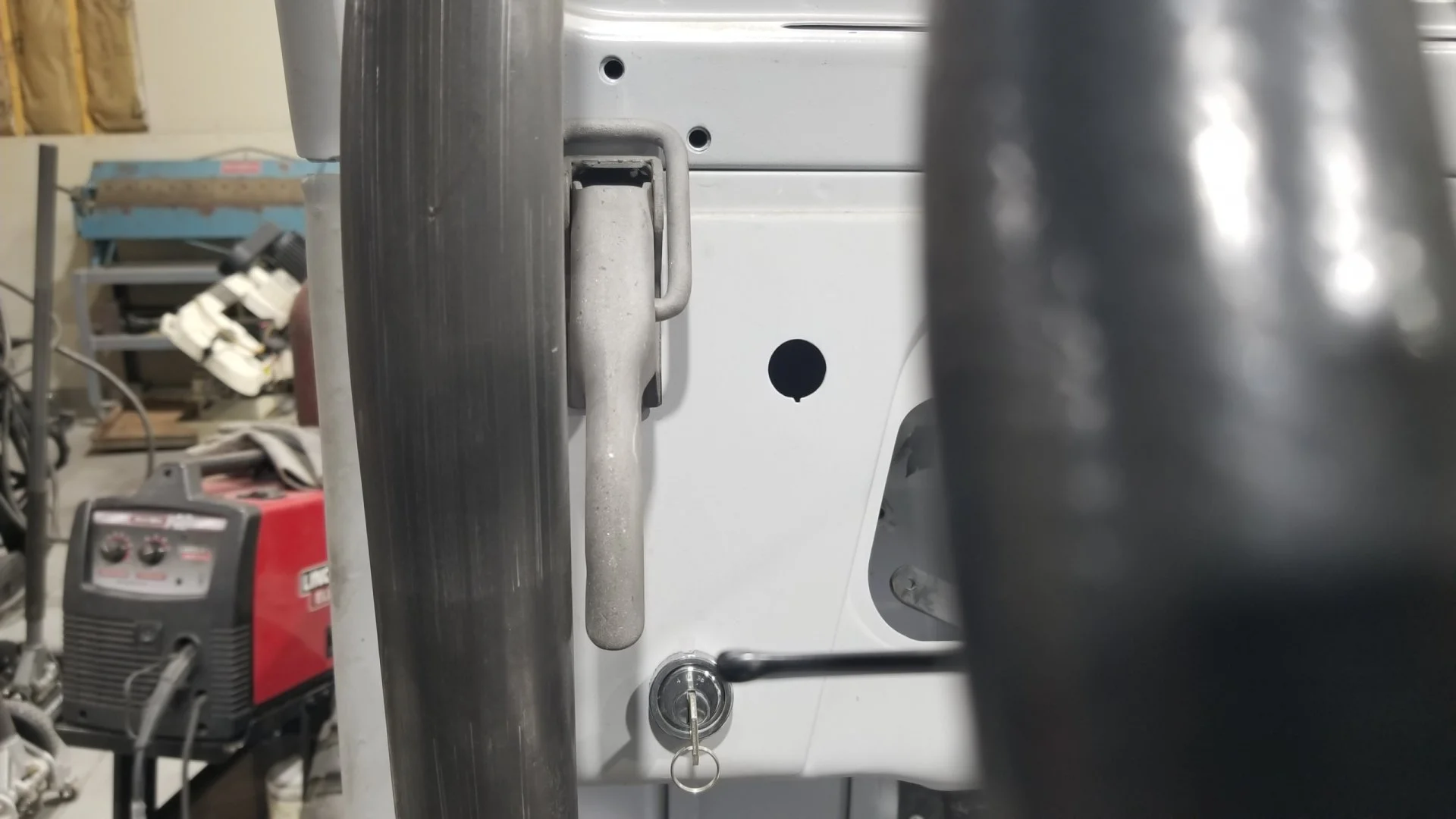

One of biggest bonuses of welding your own Metal Tech cage is the placement of the A pillars. If you have an early dash, a pre-welded kit will block the windshield fold down latches.
I was able to move mine out far enough to give myself 1/4" to operate the handles and still have my doors close no problem -
Everything done and welded in. All that's left is making the plates and frame tie-ins.

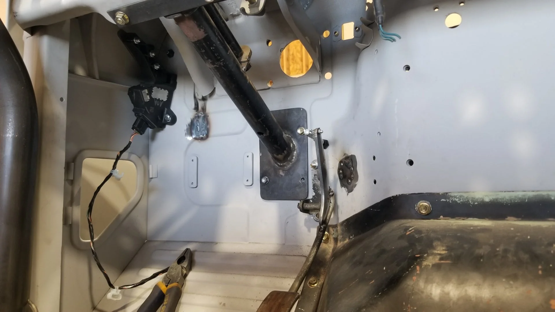

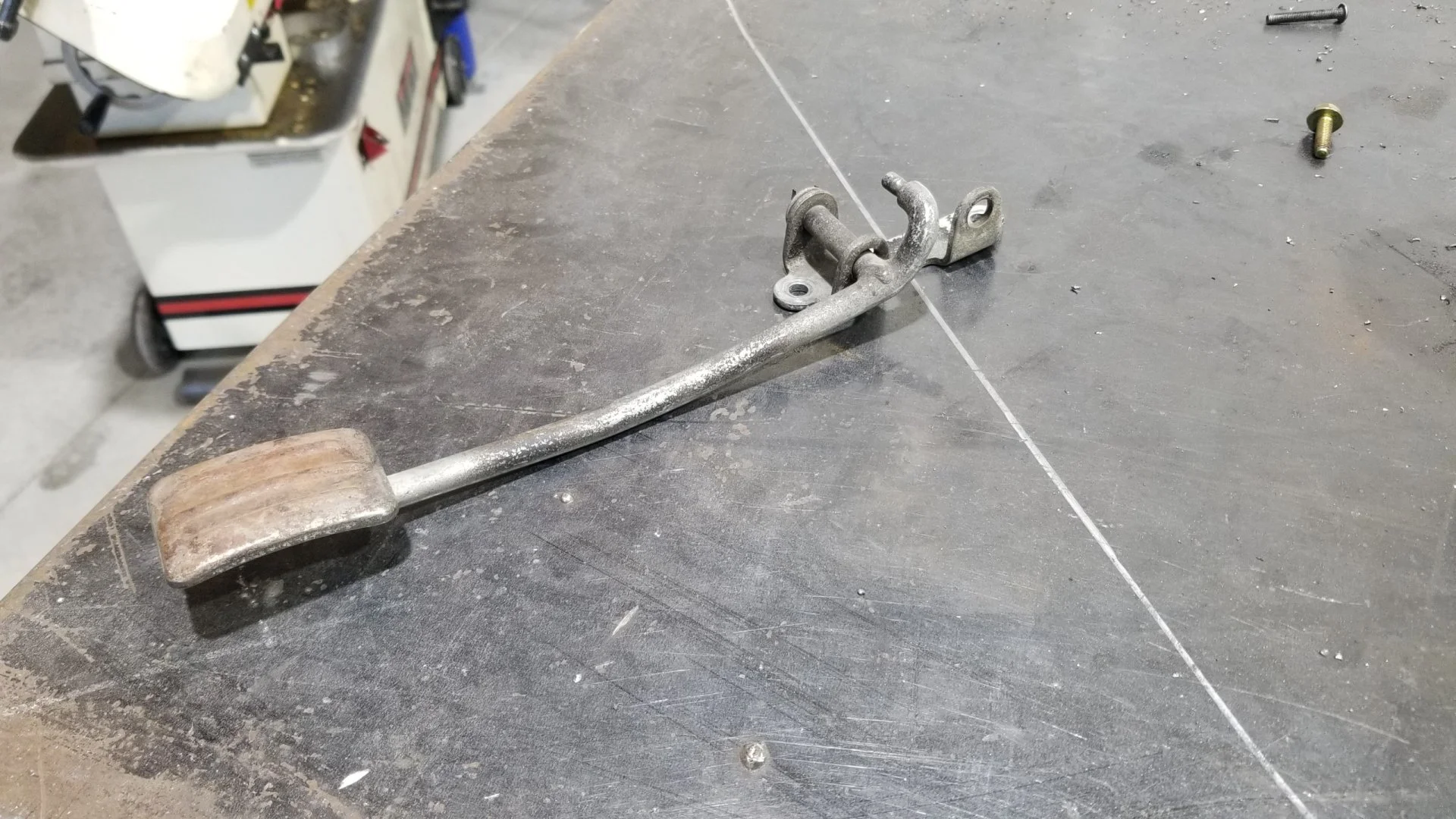

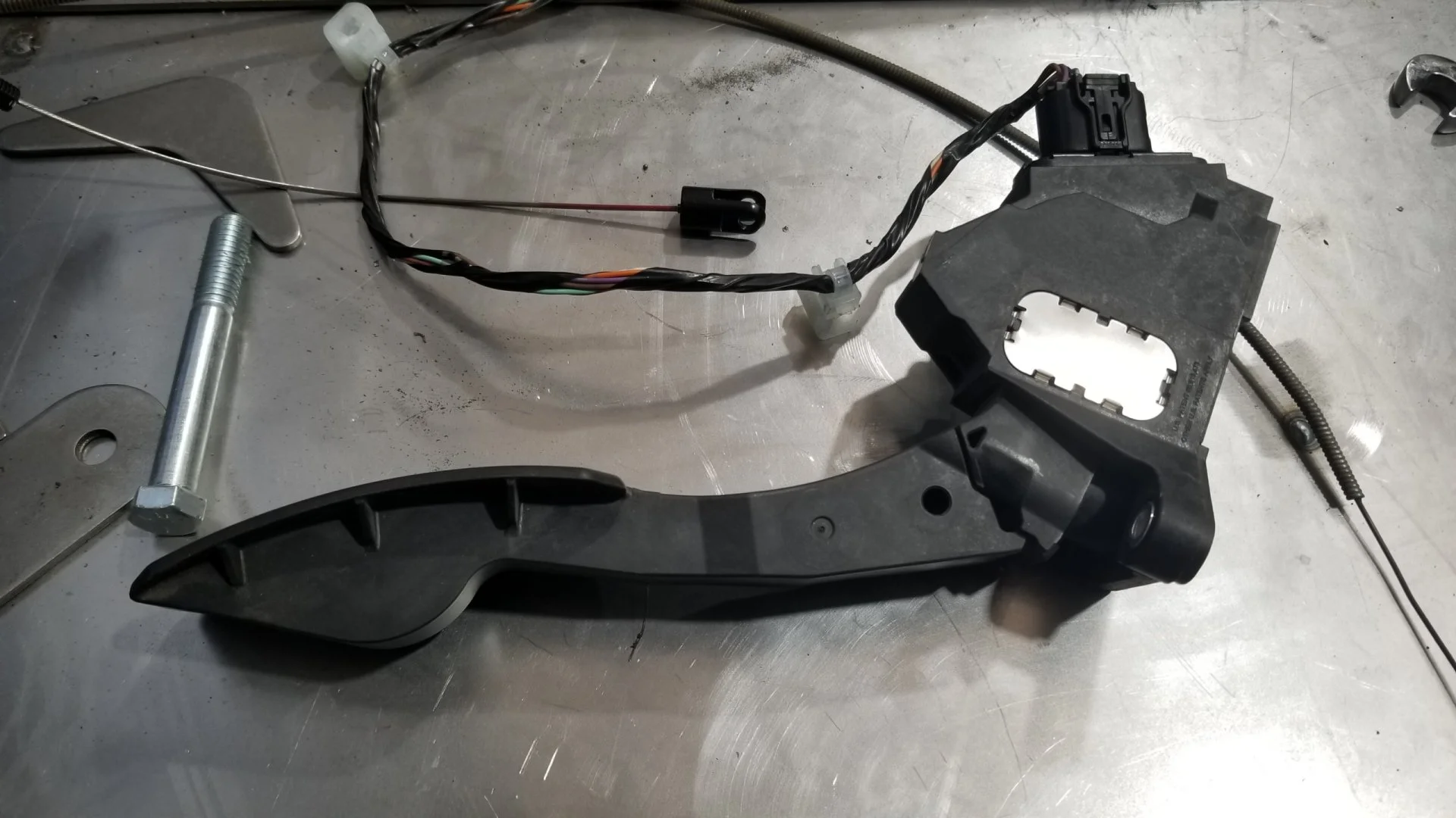

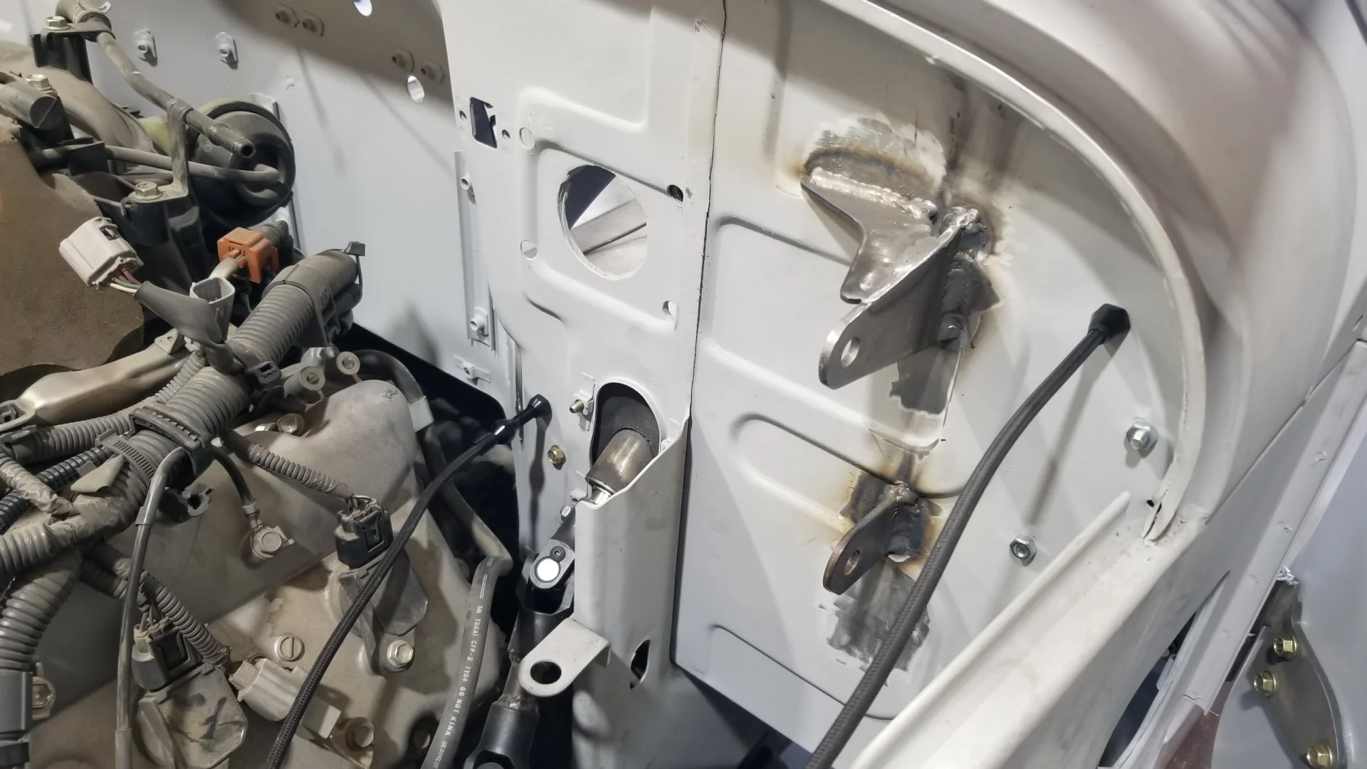

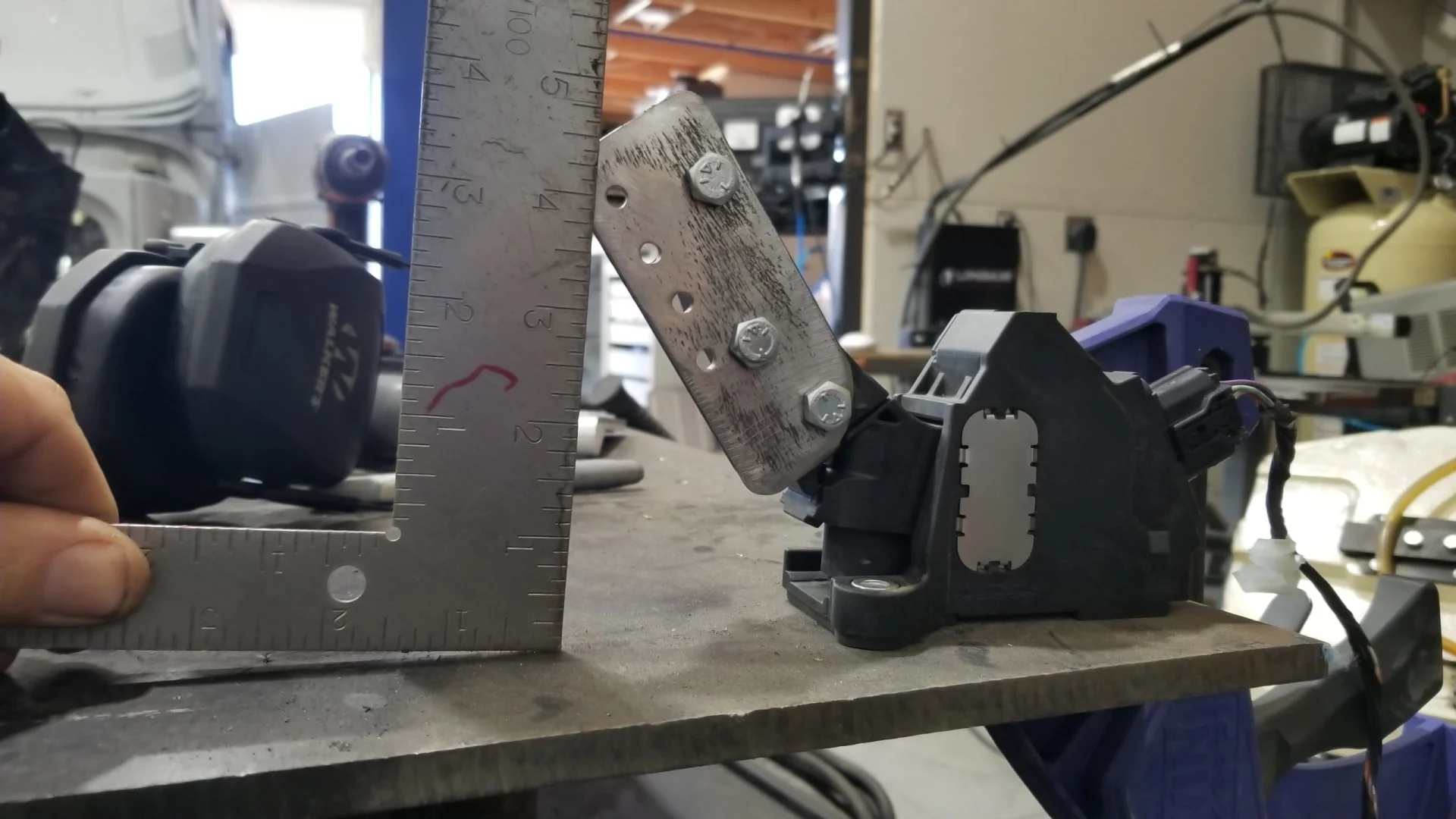

With keeping the theme on this build of old/OEM appearance and trying to conceal all of the modern stuff going in, I wanted to relocate drive by wire pedal.
The pedal had to remain mostly in tact since there are no screws or bolts holding it together. I really don't think Toyota wants anyone messing with them!
And of course the pedal I'm trying to use -

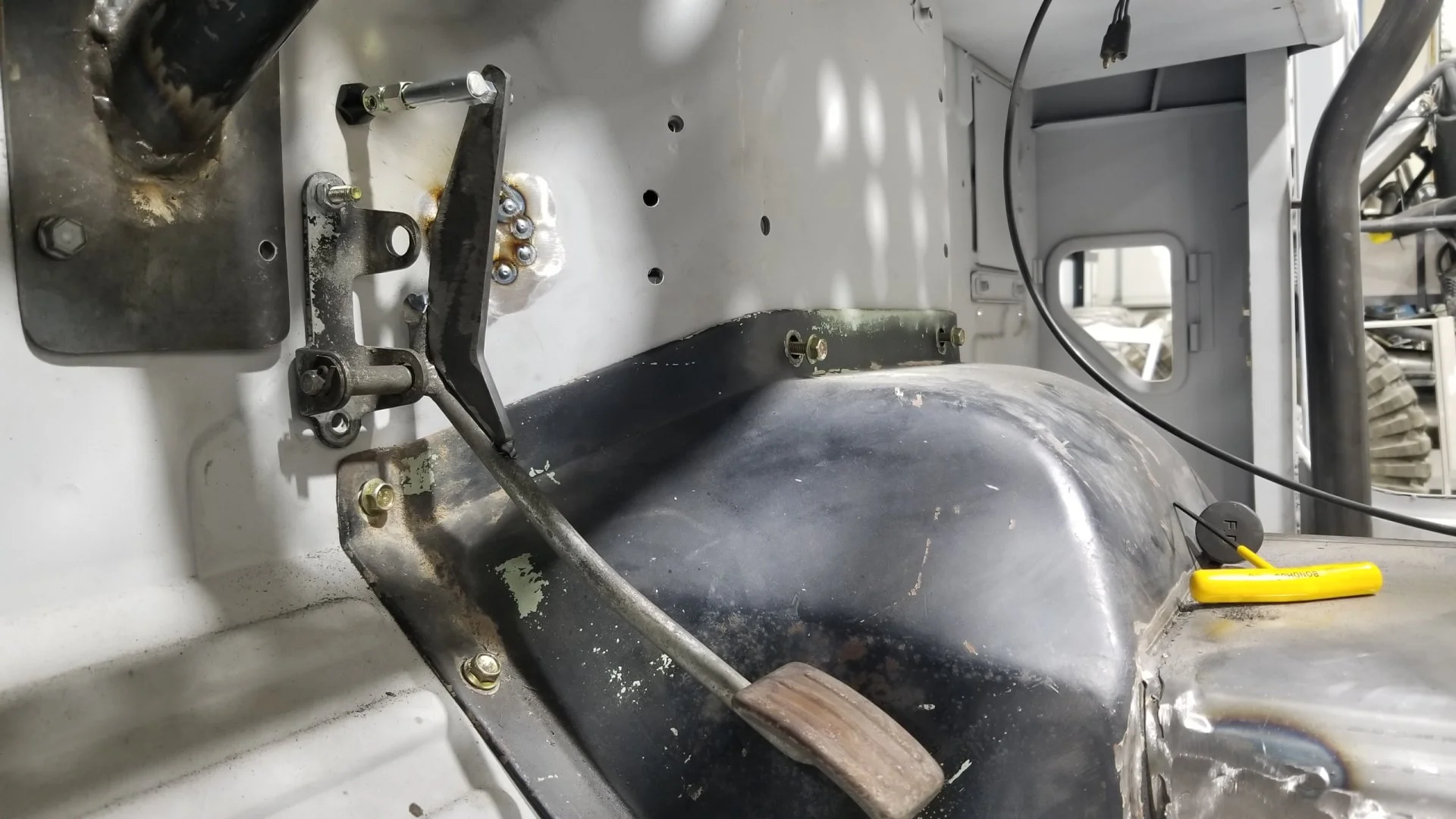

I had to cut out a bracket to make it more of a cable actuated throttle, and not linkage -
Bracket attached and cable mounted in firewall -
Modifying the Tundra pedal and trying different positions for the travel -
Tundra accelerator mounted high and out of sight -
The cable routed through into and back out of the engine bay. I may shorten it, depending on some other factors -

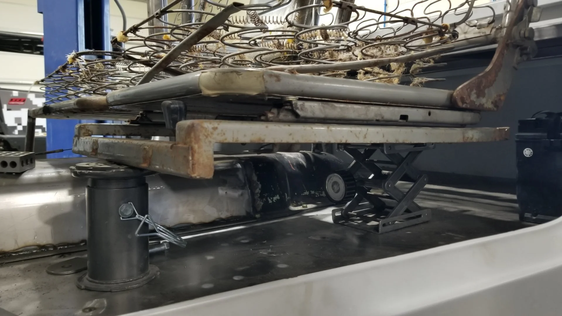

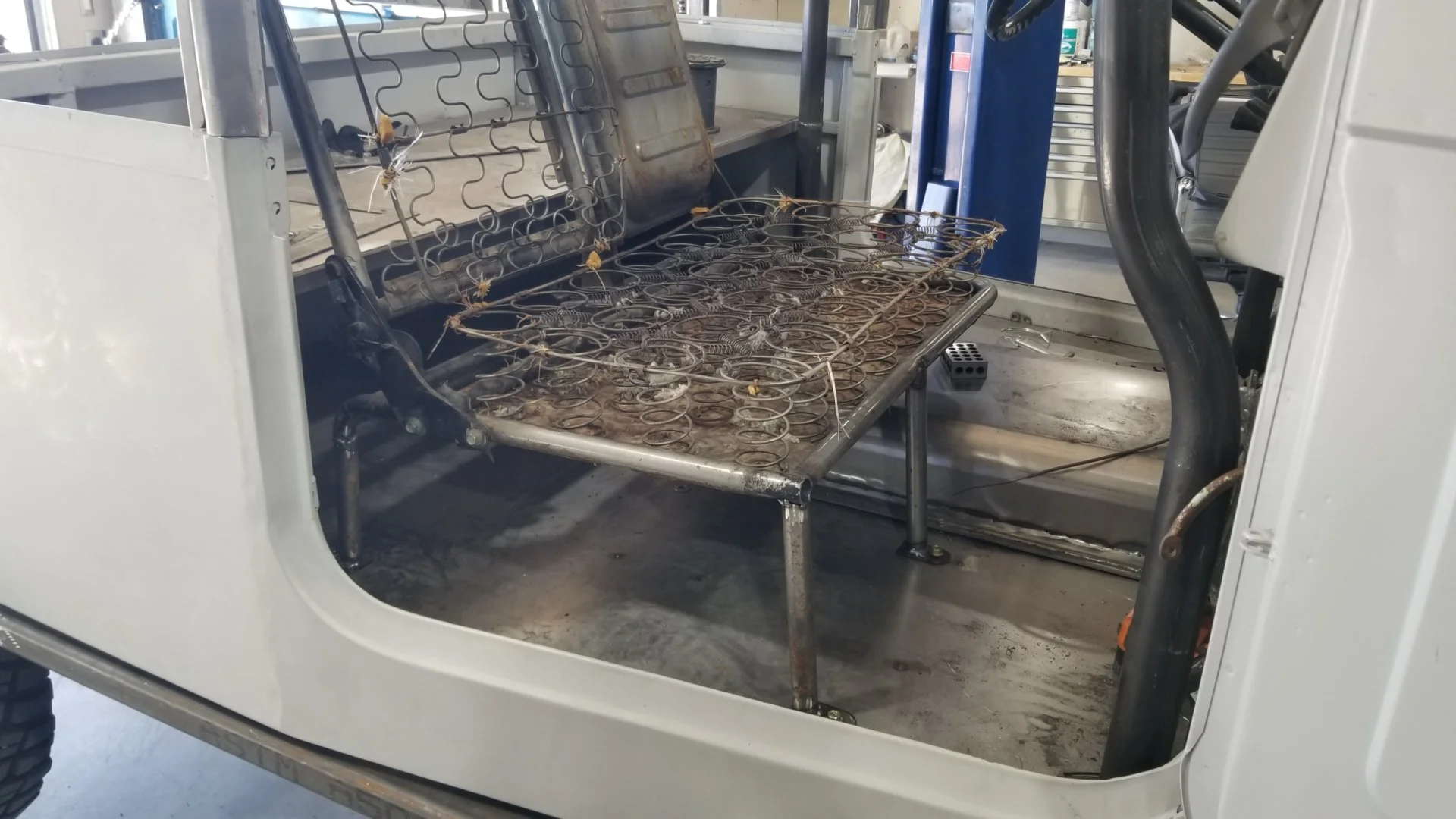

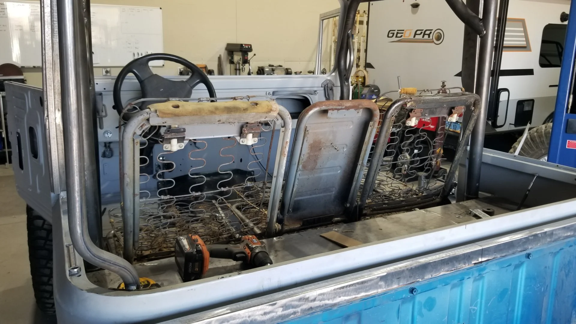

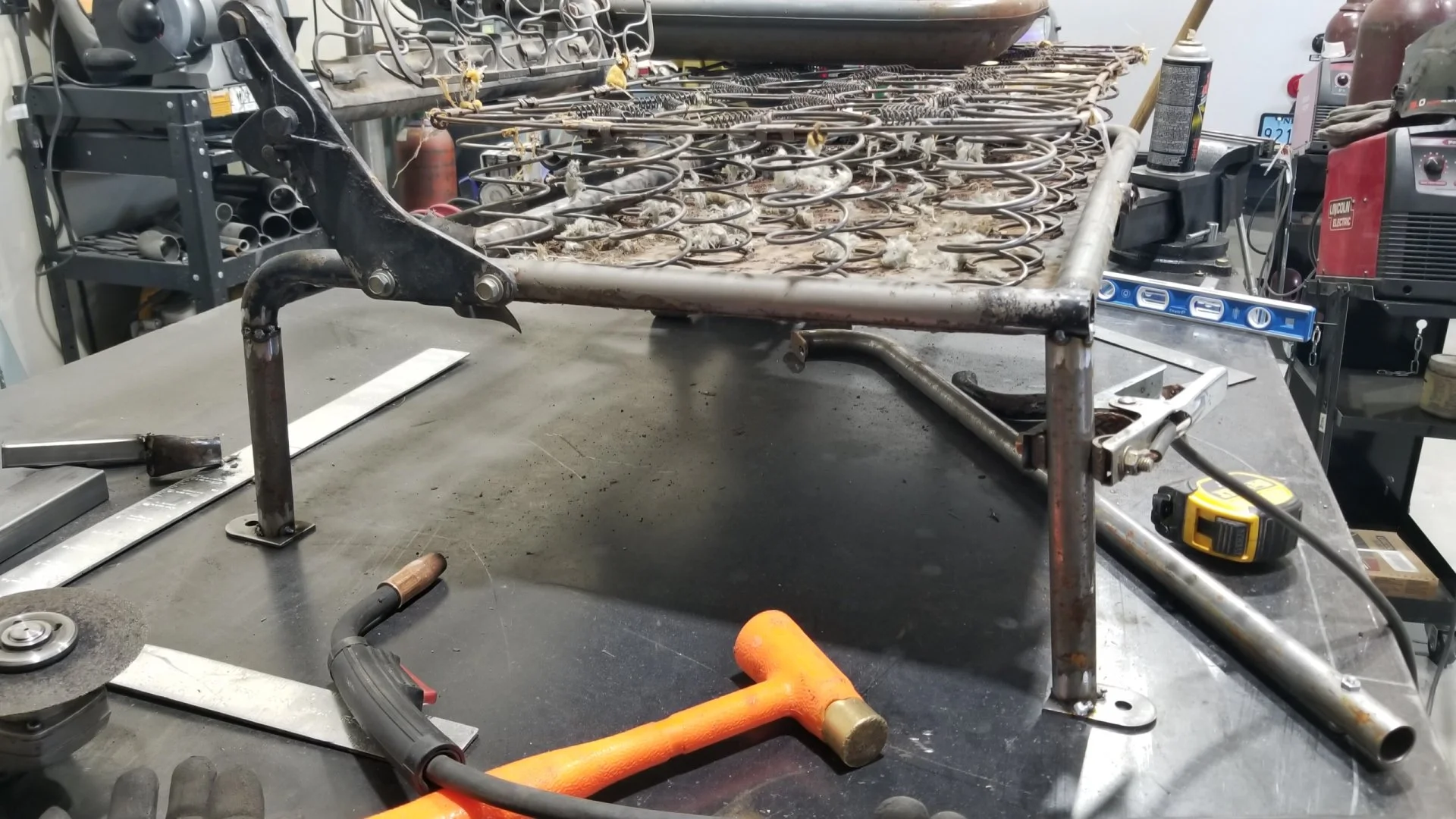

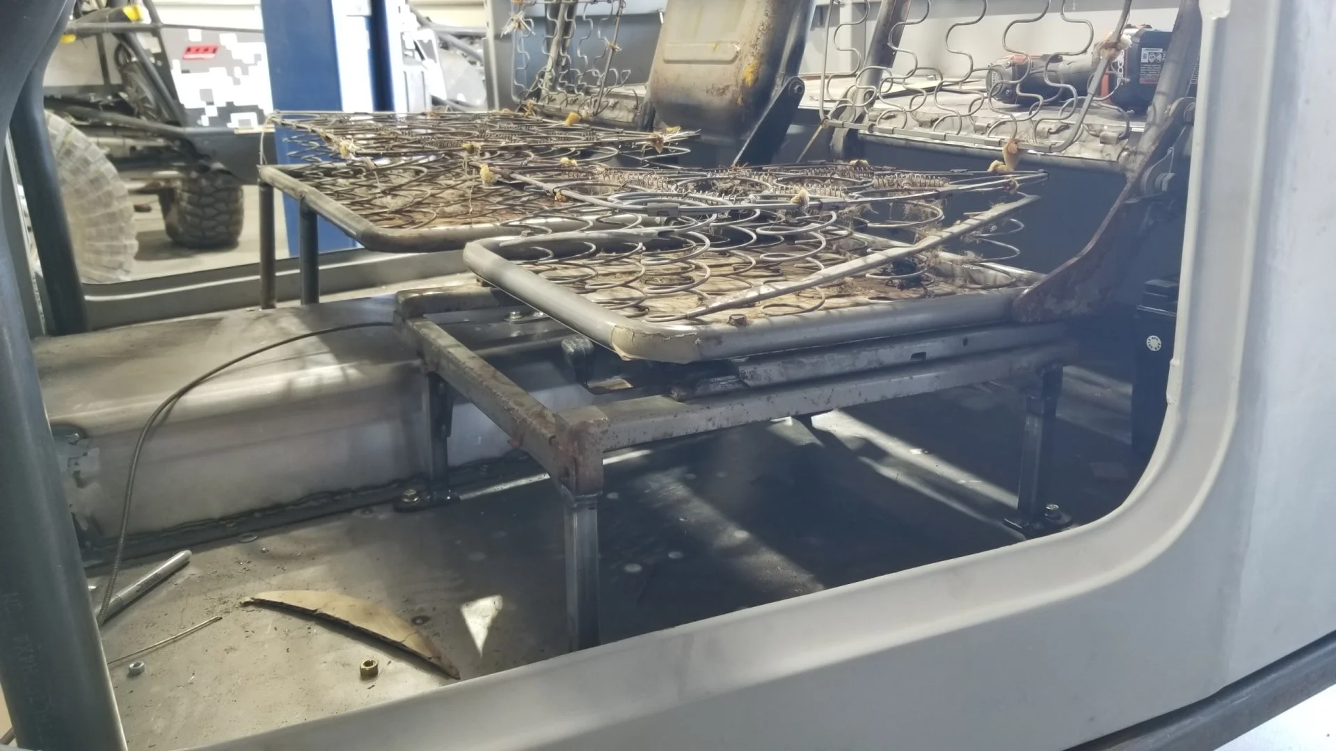

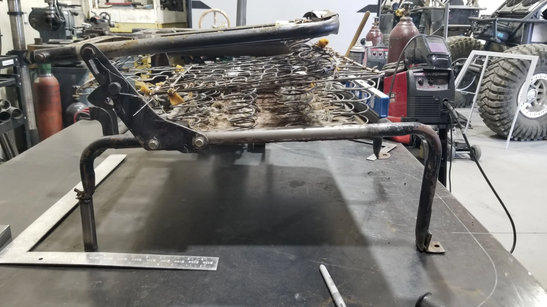

Seats are now mounted... Just like everything else attached to the floor, they had to be custom due to the flat floor and custom transmission tunnel.
One thing I did want to fix on the seats was to tuck the legs in since there is no longer a fuel tank under them.
I leveled the seats on the bench. I welded on a 4.5" leg on the rear, since that's how tall the step is behind the seats in a 40.
New front leg welded in. Notice it's straight down and doesn't protrude forward now -
Test fitting -
New transmission tunnel supports -
I would have loved to build and have an under seat storage like factory, but with as close the rear bench seat is, the seat can't tilt backwards/up. So it will be on legs like the passenger seat.
Trying to line up the driver seat with passenger -
Legs on -
Legs gusseted -
Both seats mounted. What a great feeling!

I'm assuming you will DIY the seats when it comes time. I just did the seats on my '69, and was not happy with how soft & springy the seats felt. The foam I had was good, 1.5" thick, probably a medium density upholstery foam. I just added 4 bags of poly fill in the passenger bench seat base and 2 bags to the drivers seat base, and it really firmed up the seat bases, but it still has enough give to not be uncomfortable. Great progress as always!
