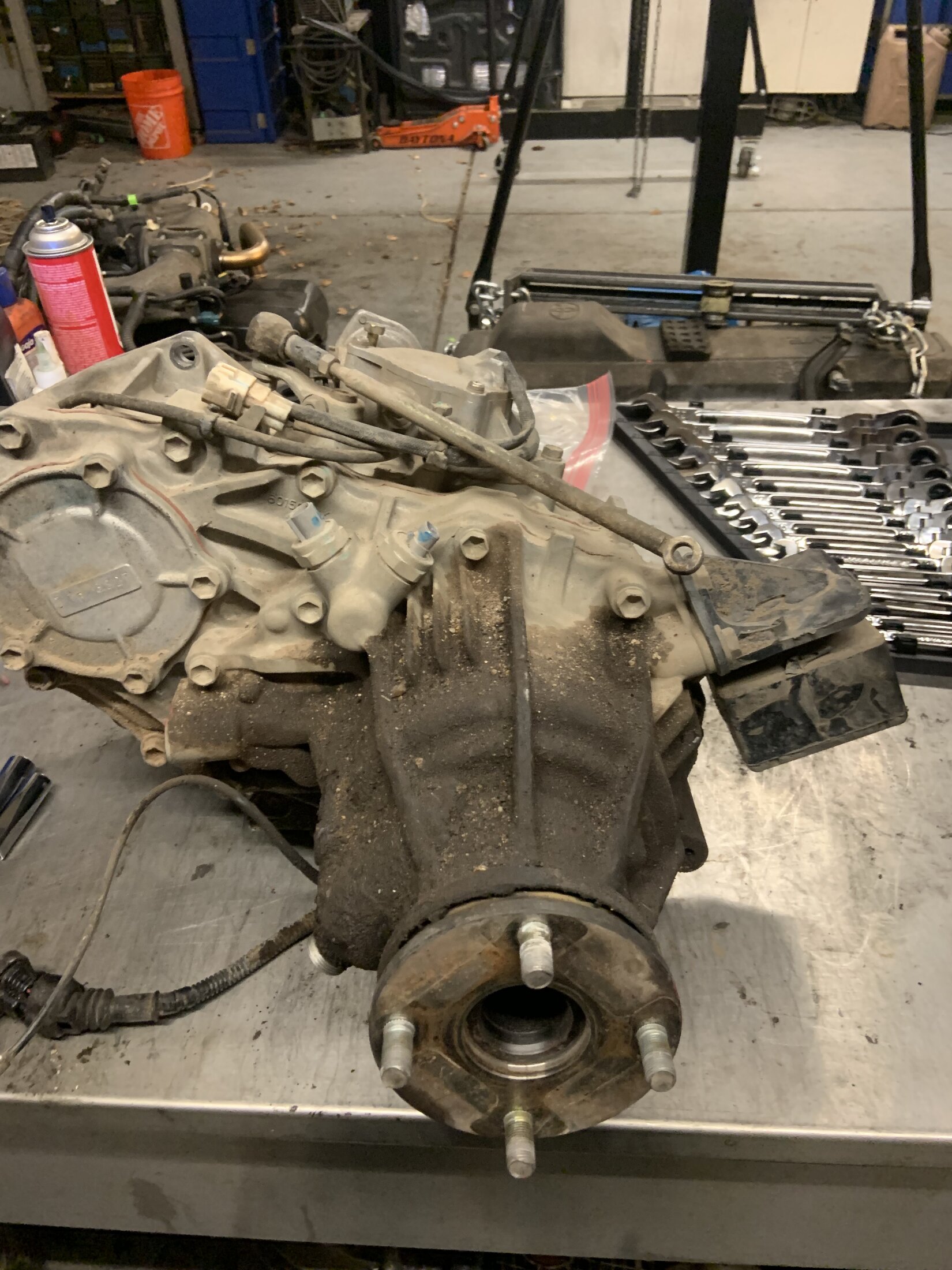

Time for a catch up. I built a spare transfer case up with 3:1 low range gears. If I had to do it all over again, I'd stick with stock gearing with this diesel. low range is almost too low for the majority of wheeling I do. Although it's great in the rocks!

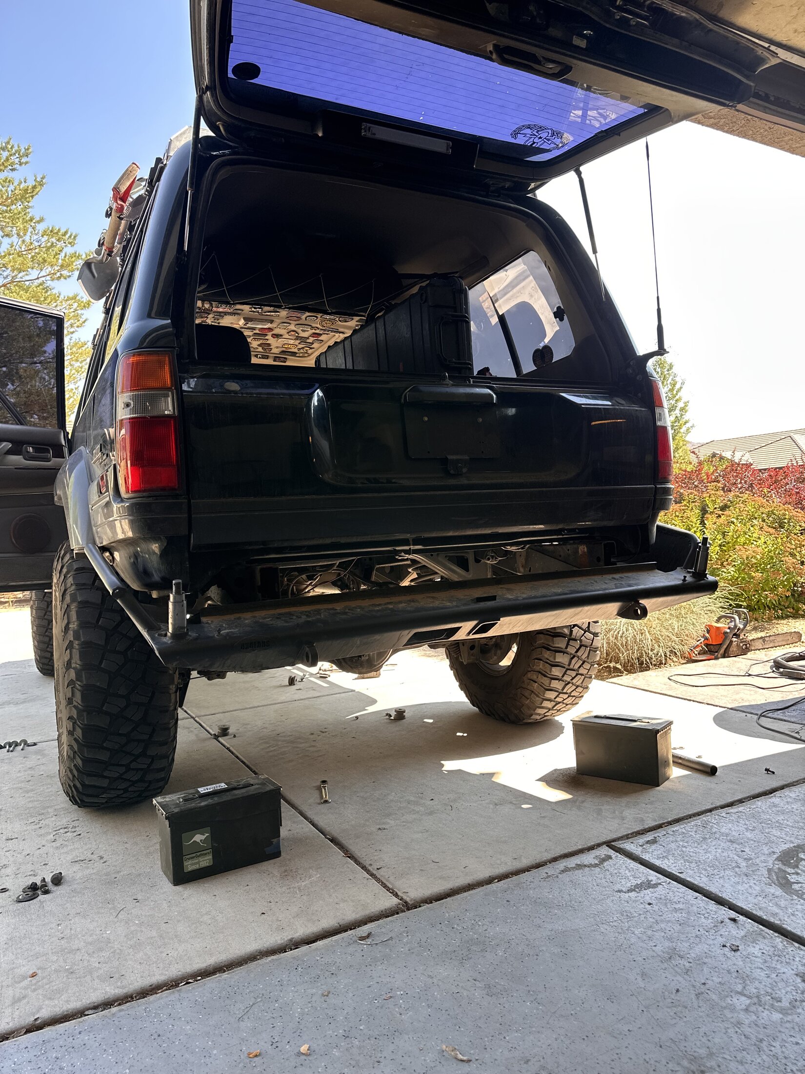

I ended up having to add a 1" body lift to get better clearance with the 37's under full articulation. It was pretty easy to install but I did have to partially drop the rear bumper to access the rearmost body mounts.

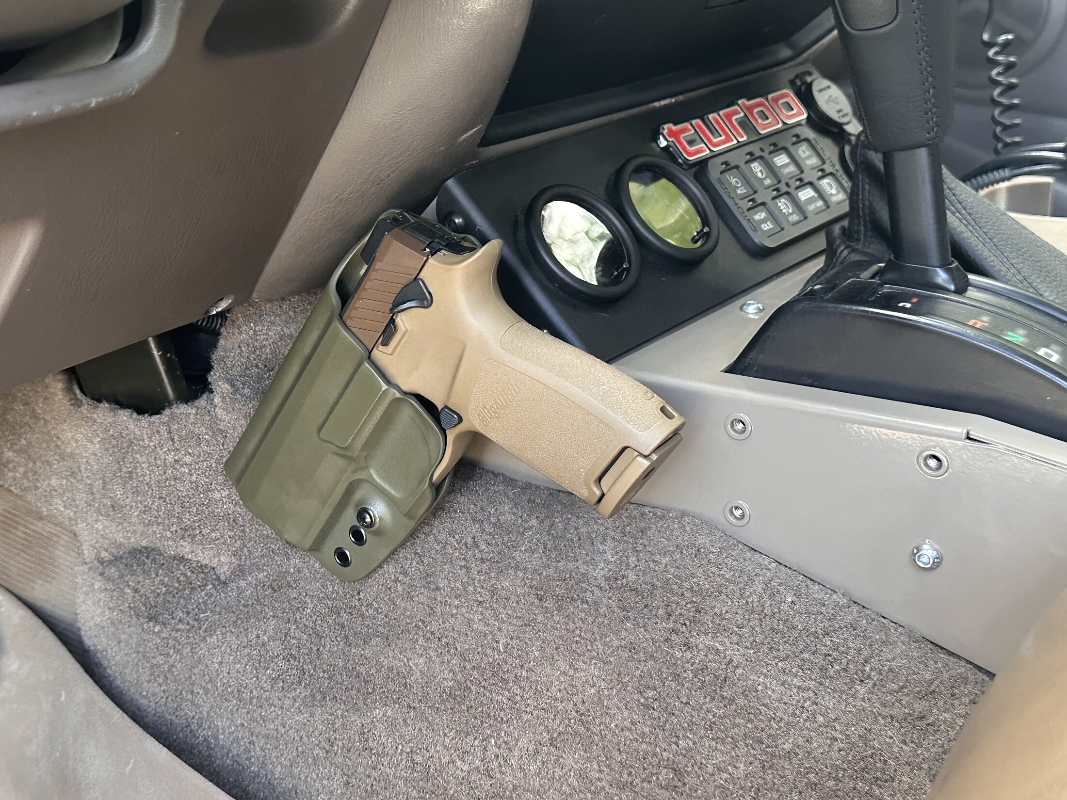

G-Code holster and RTO mount added to center console because I live in Nevada and you never know when a rolling street battle will go down.
