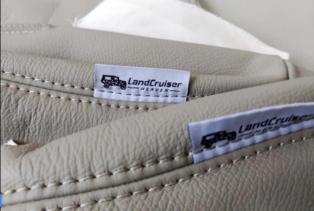

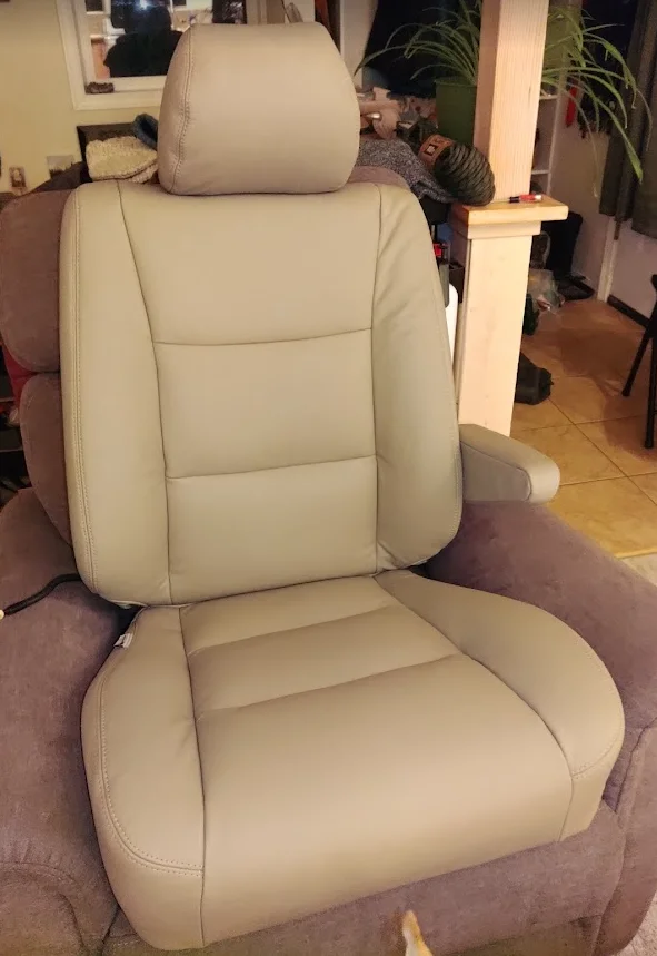

My goal was to refresh the seat foam as it feels like I'm sitting on metal. I decided to pull the trigger on new leather as well. I ended up replacing my driver and passenger seat leather along with the center console. I decided on Land Cruiser Heaven product. They have a laundry list of bad reviews but they all seem related to people who dropped off their vehicles for LCH to do the repair.
There are a few good YouTube videos out there already so I won't bother writing up a detailed how-to but the focus here is going to be more on the LCH product and if it's worth the money.
Verdict on LCH Product for 100 Series
Despite all the poor reviews on Land Cruiser Heaven (LCH) , I've had a great experience. Customer service was very responsive but note it did take 2-3 months instead of the estimated 2-3 weeks, I wasn't in a rush so no big deal. They claim the product comes from South America. They handle the import and send it along to the end user in the states. The shipment arrived in great condition and included everything needed to install except the tools.
All and all this is a top notch product and well worth the money. When it comes to leather replacements you get what you pay for. In all reality this product is cheap considering where it comes from and the leg work to get it here to the US.
I went with the 100% leather option and replaced the center console as well. The only complaint I can really think of is the lack of pre fabricated holes for arm rest, head rest, and seat frame.

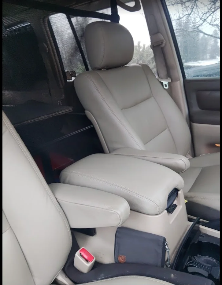

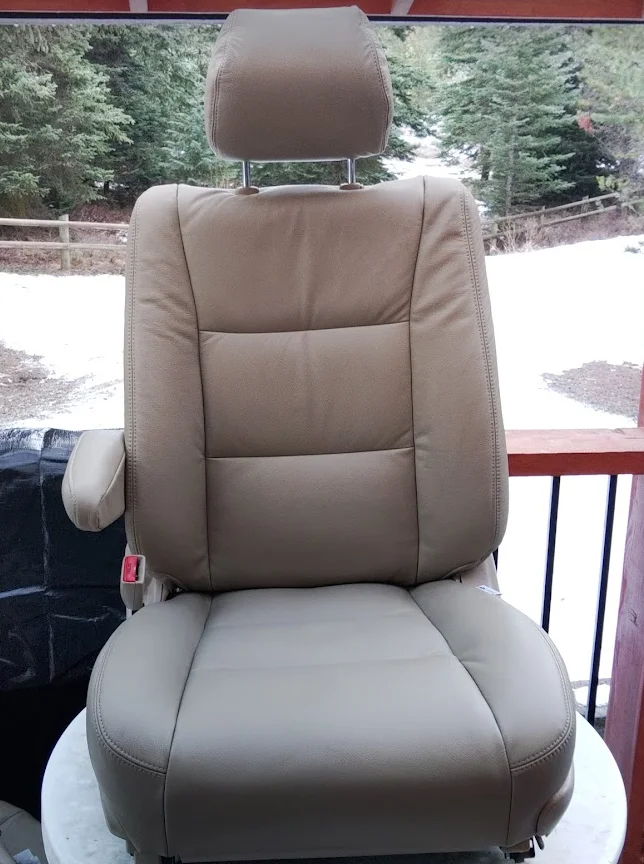

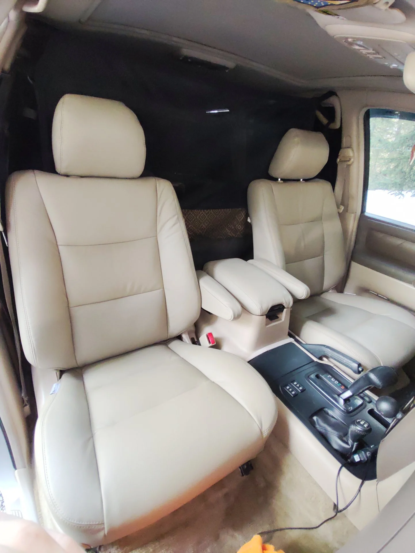

I finally got the leather installed and everything back in the vehicle. I'll take some final shots from the truck once we get some time. All and all, the LCH product is definitely top notch. You can see and feel the quality right away. LCH sent extra foam so I double downed on my seat foam and I'm happy I did. They are soft soft and plush to sit on now.
The biggest downfall of their product, the holes were not pre fabricated. This took some extra time and attention to make sure I didn't F*** it up. Also, It's hard to explain but they didn't include enough seat material on the sides of the bottom cover. This made it very difficult to get the bolt holes to line up.
The shoulder area does have a few wrinkles but to be fair it was most likely my fault / not installed right. I pulled the crap out of the leather and got it as tight as possible but couldn't get those wrinkles to go away. Is it possible their product wasn't cut right? Maybe...But that being said it was also the original foam. I did steam it back to life but I couldn't get them to go away. The wrinkles don't bother me too much...yet...
I'll add more details and pics to this thread when I have more time but the verdict for now is if you are thinking about ordering, just do it. Do it, and install it yourself. When it's all said and done and your hands are sore and bleeding you'll be happy you did.

They look really nice, great work!
Thanks. I was a little bummed about the wrinkles but I think that was due to my lack of install skill . Maybe they will even out once I ride around a bit.

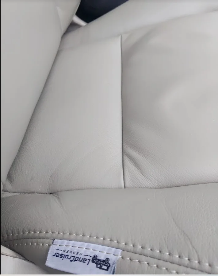

How are these holding up?

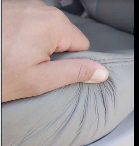

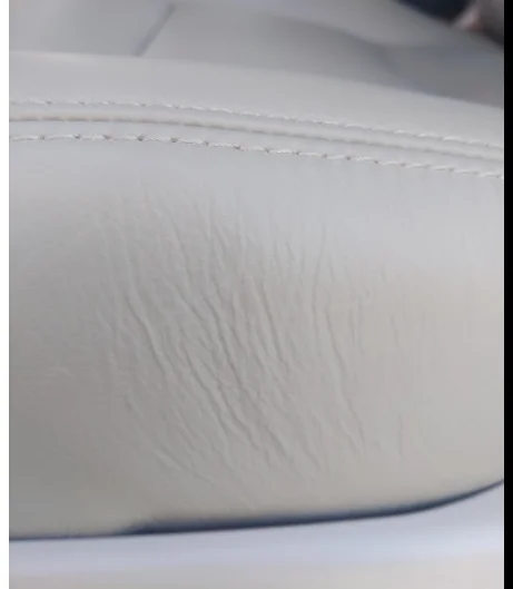

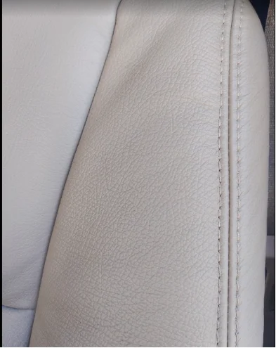

Long story short I think they are a good buy and they will hold up for a while. The leather is good quality but it's weird, certain parts of the seat lack the qualities of leather and seem a little less tough. Of course they told me everything is full leather but I kind of feel like these side bolsters are vinyl. Check out how wrinkly and weird they are when I squeeze it.
Time will tell how long they hold up but look at that material compared to the seat back which has this like tough leather feel and look to it. My dog pops his head over the seat shoulder area there and his nails constantly tear into the seat back area with no effect to the leather.
I feel like if something sharp or whatever pushed onto the side area that material wouldn't be as strong.
Interesting about the bolstering. I wonder if they use a bonded leather or similar on that section. I was wondering about the durability as well considering my dog tends to do the same thing. Any noticeable damage or wear yet?
Yeah so for what it's worth they have a build ID and claim they contacted the folks in SA who confirmed it's all leather. But there does appear to be a difference in the sides for sure. Only time will tell how they hold up I haven't had them for more than a year yet.
The weaker looking sides would be my only complaint, otherwise they seem like they will last a while. The stitching was really strong I pulled them with another person as hard as possible during install.
My dog sleeps on the front seat while we camp but I usually put a towel and some other layers down to keep him off the seat. The times he sneaks up onto them it doesn't appear to leave any marks.

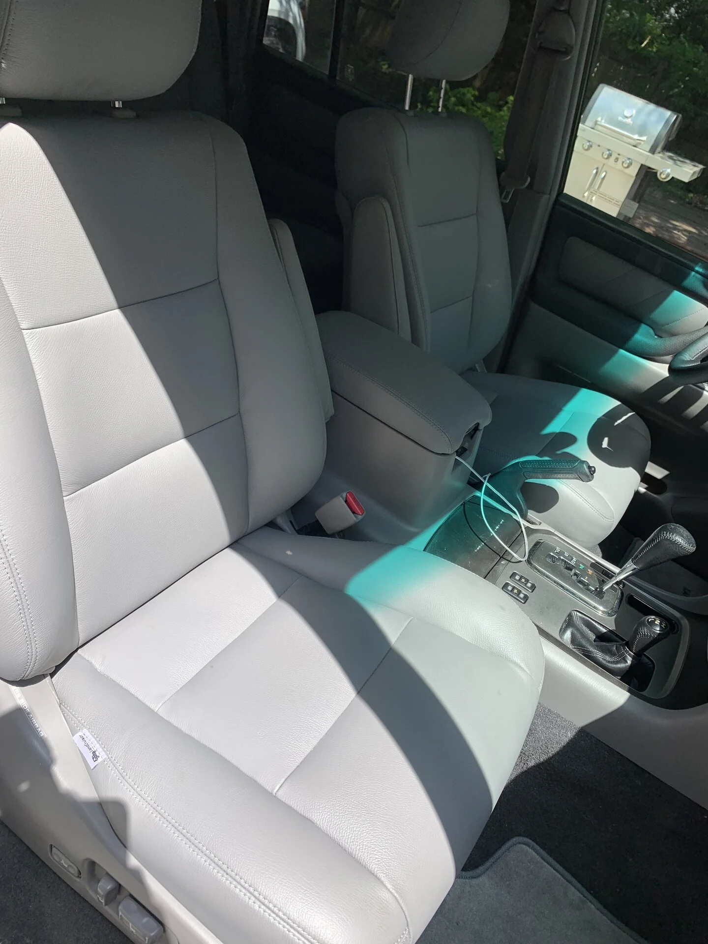

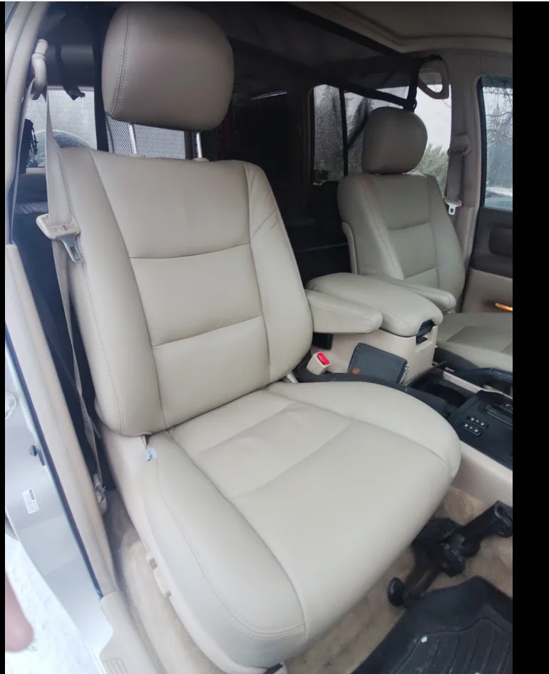

Here they are today
Look good bud,
It’s amazing what you can do with a set of strong quality wire cutters and some hot ring pliers.
Bet it feels great to drive again Hugh!?
Did your seat heaters work okay again?

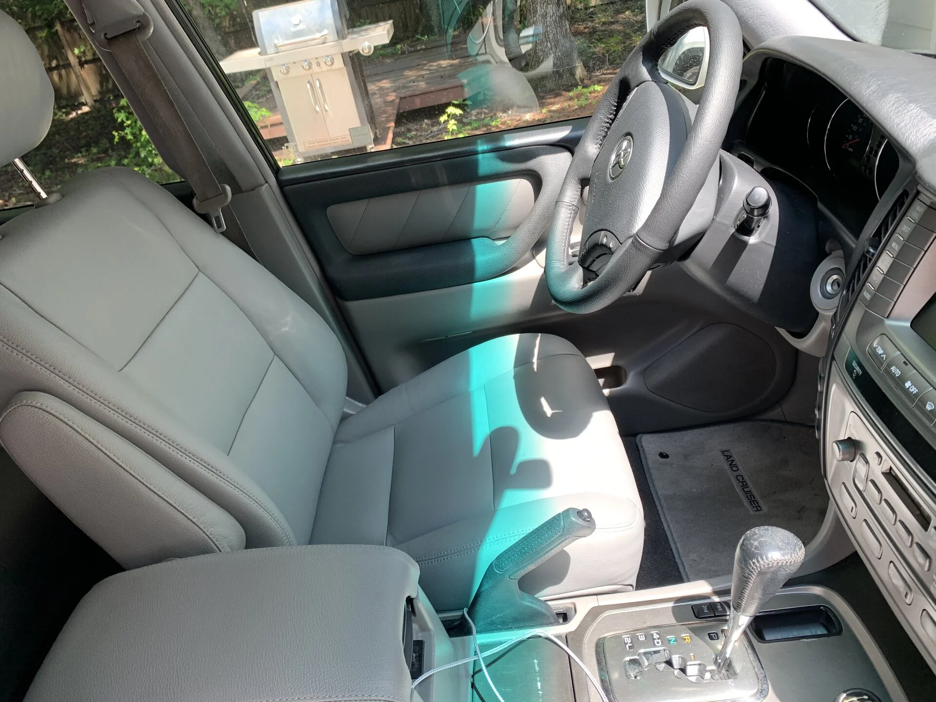

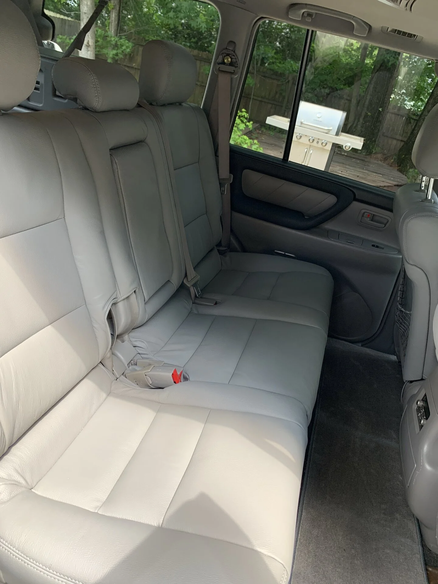

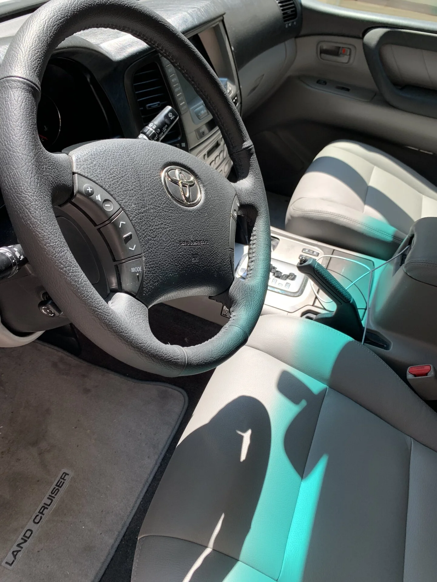

Sharing my recent experience with LC heaven seat covers. Im happy with the grain, consistency and quality of the kit. I ordered the front and middle row separated by 3 months but with the batch code provided the dying was identical. Probably shouldn't tempt fate but i was over budget. The real kudos go to the installer, (Craft in Myrtle beach). I was concerned with the wrinkling that ive seen posted in some other recovering projects, but after seeing their work im glad i had it done professionally. And the price was extremely reasonable. The installer ended up using the extra material included with the kit to cover the hard plastic seat backs. It was an oversight i didnt ask for that to be done however it turned out fantastic i cant complain. My driver seat bottom foam was replaced using OEM and the rest they plumped up with steam. Does it look OEM? no of course not but its consistent and the hide thickness looks to be durable. Time will tell.
View attachment 3356318View attachment 3356319
View attachment 3356317View attachment 3356320
