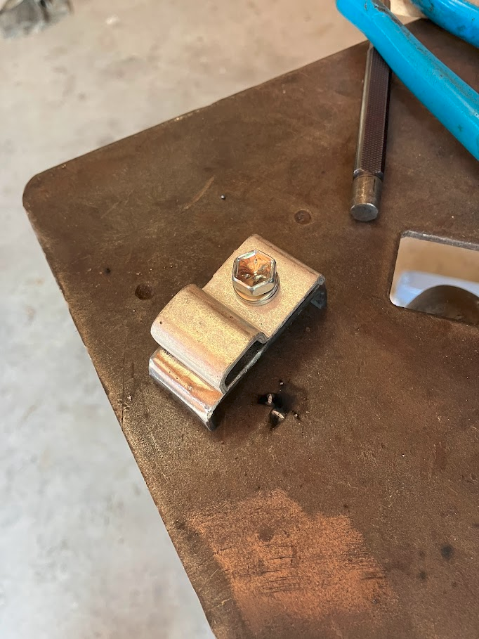

Shared the cable retainer right off, the nut inside is also snapped in two.
So I cut the hole thing off.
Fab up a new mount for the new retainer and welded it on
A little paint and done !

DANG Broski, Nice work but I think you need a high steer version for the brake cable. :p

You’re right about that brake cable, it been a thorn in my side from the beginning.
If you look to the left in the first picture you see the small skid I made for the swing arm after smashing it several times.
Second time I fixed the center retainer.
Really surprised it hasn’t happened sooner but if you look closely you see the cable is now kinked.
But it’s still working and we all agree got to have a E-Brake.
